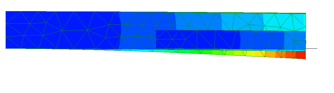

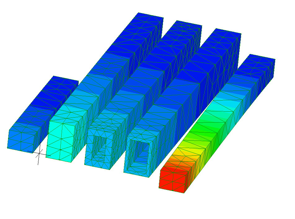

Doubling the panel thickness is similar to cutting the span in half. If you have 3/4 mdf spanning 12" with a brace in the center then you would want about 1.5" thick mdf spanning 12" with no brace.
Addressing weight; skinned sandwich or box/beam style construction will get you around 90% of the stiffness of a solid cross section. So 1/4" or even 1/8" ply over 1" rigid foam or honeycomb nomex or aluminum "should" get you the required stiffness.
