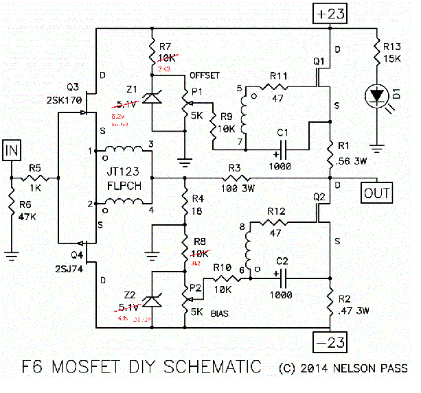

I am studying both F6 and M2x, willing to build one of them.
For the F6, i understood from the manual/diy build thread/Youtube video that you have to adjust some pot to adjust bias. 2pots to adjust, documented.

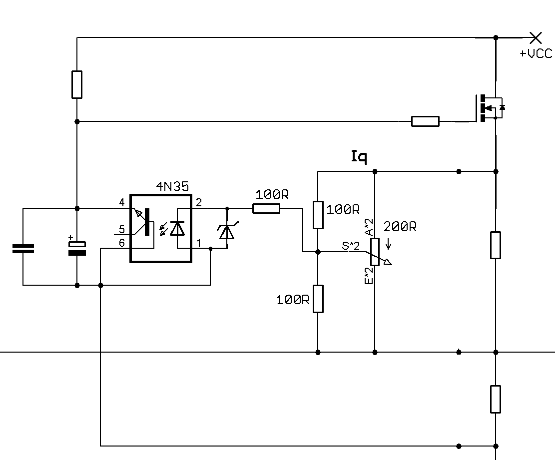

For the M2x, i didn't find much information if there is a bias to set or not and would like to check with you.
*On the schematic, the pot RV1 is mentionned as not mandatory / used for a bit of tuning only. [6L6 answered below= was wrong, RV1 is mandatory]
*Don't remember where but there was a mention of the bias adjusting itself automatically just by design.

M2x bias is set automatically.
RV1 is to zero the DC offset on the output. It is mandatory. (Also, use the “blasphemous heresy” values for more range in adjustment.)

if confusing to OP, just ignore this 🙂
just one of the ways to alter it

Don't be put off the F6 just because it needs bias setting.
It is a fantastic sounding amplifier, and I think quite a simple build. The MX2 will need a lot more parts sourcing for its daughter cards depending on which ones you build.
To bias the F6 all you need are 2 (or possibly 3) multimeters which can be quite cheap. (and a little time)

If building an F6 from scratch, pay attention to the "zenner mod" or use three green leds.
