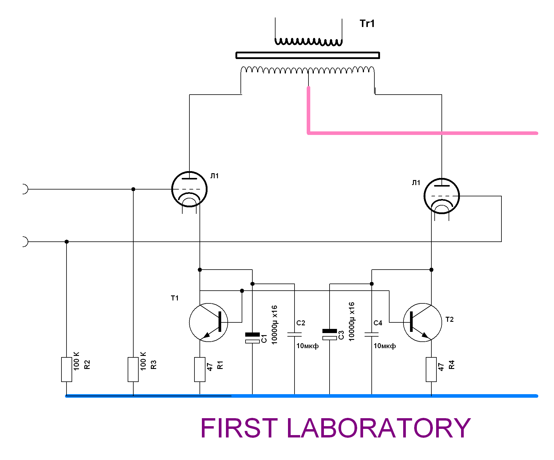

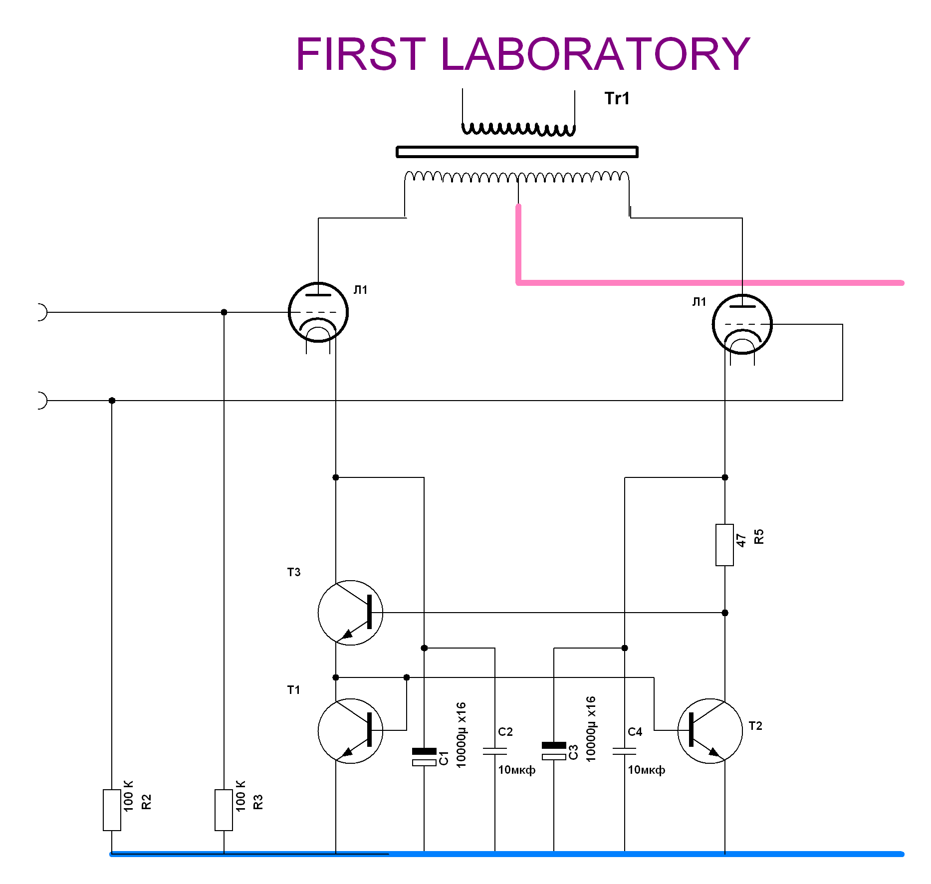

Dear Colleagues. Suggest improvement PP stages. Simple method to set current mirrors.
