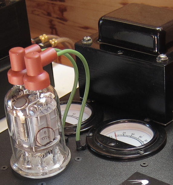

Resistance to change right in accordance with the specifications. For the type of lamp. On the left collector - gun cathode established positive potential. Potentials on the cathodes will be different, but equal currents.Hi Fedosoff. I am interested in trying your circuit. Is it only for class A or also for AB? How do you set the bias current in your circuit for different tubes and idle current?
