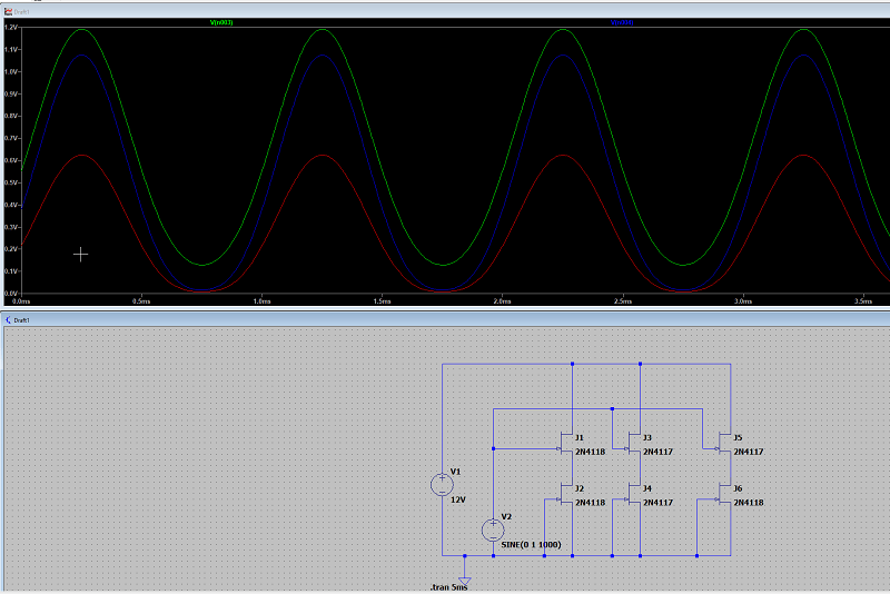

A quick LTSpice simulation of 3 buffers. Two pairs matched, but different Idss bins, the 3rd a mixed set
This shows that the matching of follower and source load matters more than anything else. The 3rd pair with mismatch has severe gain error and distortion

Awesome, thank you. But that is actually not the case of mismatch i meant. What i mean is for example these stereo pairs (upper/lower transistor IDSS):
Left
10mA/8mA
10mA/8mA
Right
10mA/8mA
12mA/9mA
Or could be anything else. But i assume that the lower transistor is always around 80 to 90% the IDSS of the upper transistor.
So basically a stereo mismatch only.
