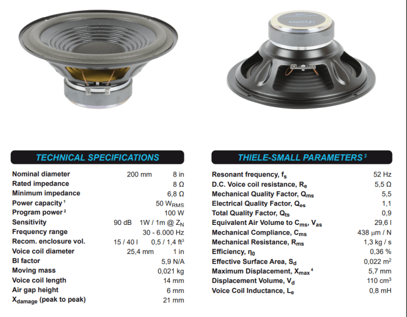

I have a pair of woofers that are 90db at 1 watt per meter.

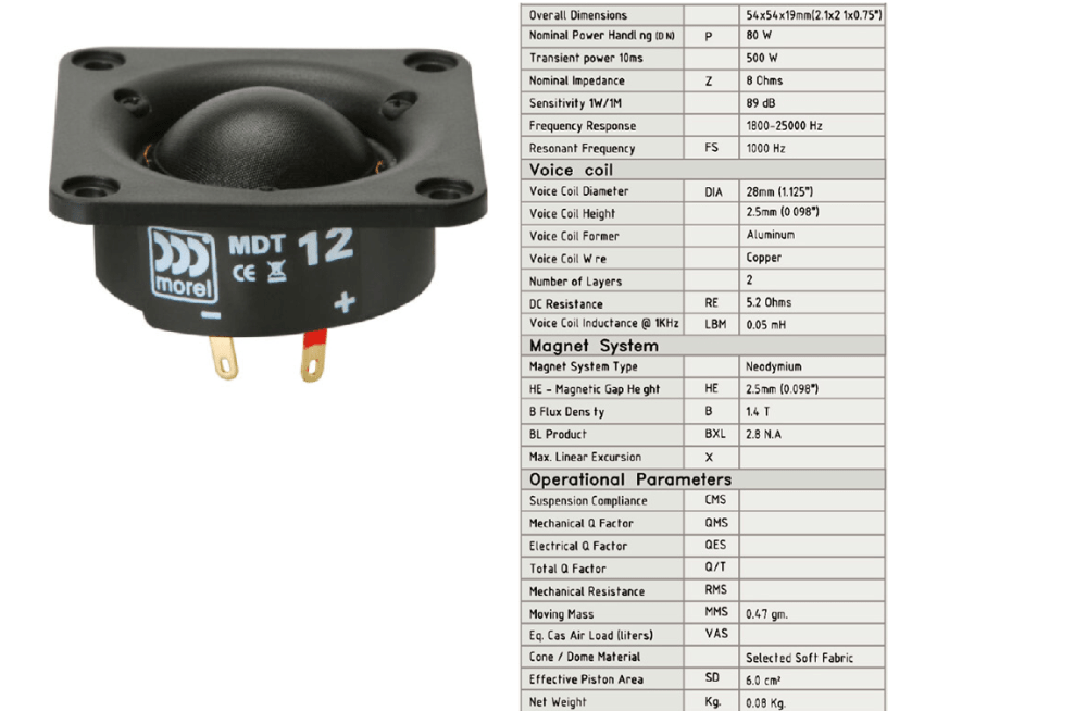

Right now I'm looking at thise Morel MDT 12 tweeters, and thinking they might be a good match for my woofers
The woofers Im using are Beyma BF-8R

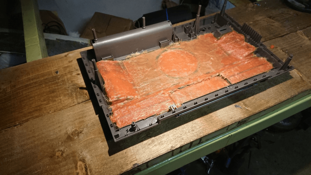

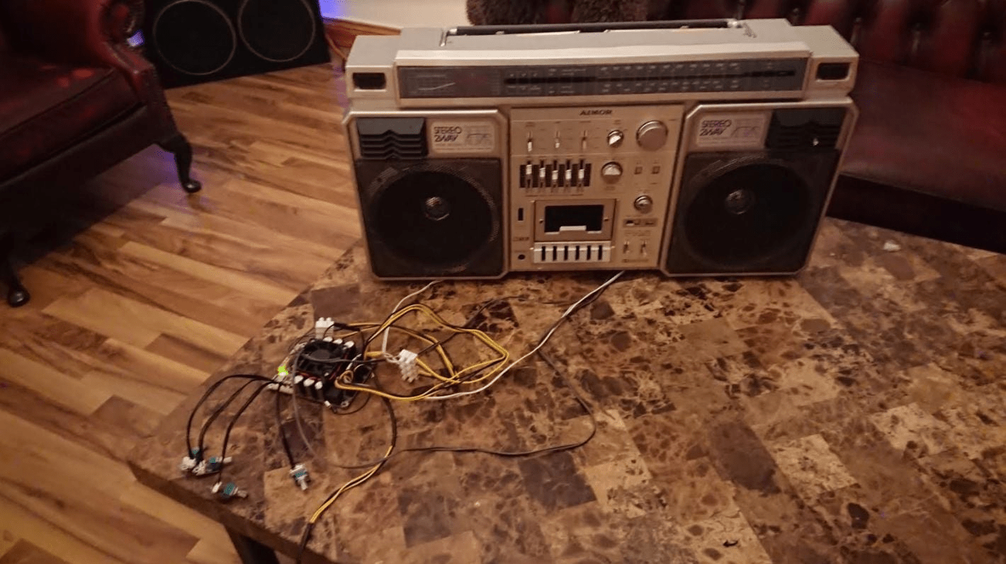

The speakers are in this housing. This empty housing has been re-enforced with fibreglass, the case is much heavier now and doesnt vibrate so much when the bass hits.
I'm using a wondom Jab5 amplifier, but i can't figure out the software on the damn thing, that would allow me to lower the volume to the tweeters.
So im trying to sort it out passively. I can set the crossover point using this board, but I cannot reduce the volume of the tweeters in relation to the woofers.

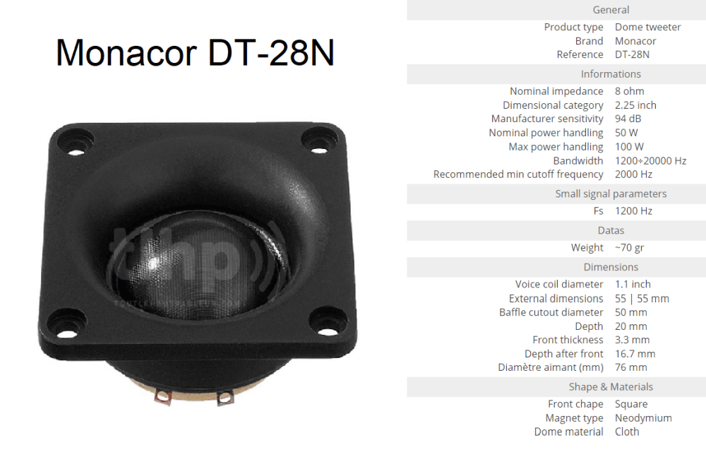

In the box right now, are two Monacor DT-28N dome tweeters, and they sound lovely, really nice, but they are too loud and the woofers are too quiet.

I have the Monacor 95db tweeter fitted to the box right now
I am looking for a replacement that will be a better fit, and I am hoping maybe the Morel 89.5db would be a better match for my Beyma 90db woofers.

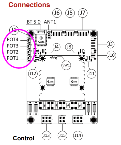

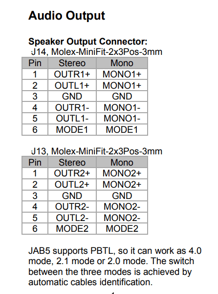

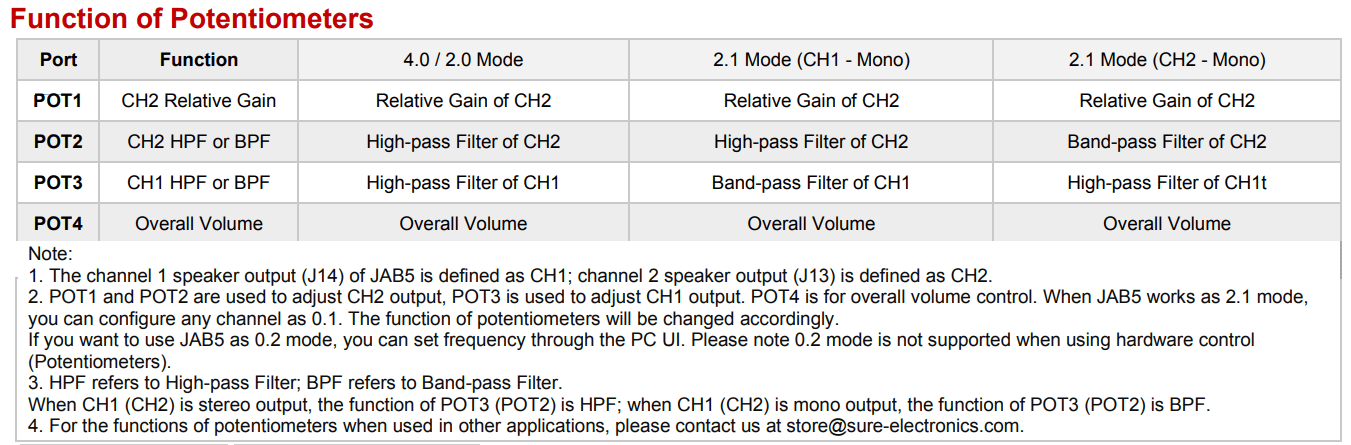

It looks like your amp module has ports for external potentiometers to set the volume (gain) of some of the amp channels. In your image it looks like you have those hooked up. Have you tried that approach?
If I'm reading this correctly, if the tweeters are on J13, Pot1 should adjust their gain.

If you stick to your present Monacor 95 dB tweeter, you can lower its sensitivity by 5 dB by wiring a 3.3 ohm resistor (R1) in series with the tweeter and a 10.0 ohm resistor (R2) in parallel with the tweeter, as shown in the attachment.
The resistors should be 5 W or 10 W ceramic wire-wound types.
This will produce better results than wiring a single 6.8 ohm resistor in series with the tweeter, although that is an alternative.

@mattstat yeah, appreciate you writing that man, but try as I might I cannot seem to get the pots to affect the tweeter level.
I stared at the diagrams over and over, I redrew the diagrams, i did my best to try and get it working multiple times but I was not able.
Now, before I sound all doom and gloom, I should say that the radio already sounds epic, like really really nice, just too much treble is all.

I've just noticed that the Monacor is rated 94 dB so I'll give you resistor values for slightly less attenuation:
R1 = 3.3 ohm and R2 = 12 ohm
(Alternatively, but less effectively, a single series resistor of 5.6 ohm)
