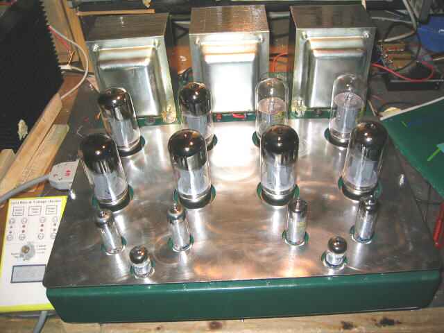

Yes...my power demands are somewhat different...That triple B+ switchable amp alot want to see....(photo here); B+'s can be selected for tube longevity (and different types) to select Pout's of 25W+25W; 130W+130W using parall-paired 6550's; or full wacker 200W+200W (>800W bridged) at 600V B+ with 8x JJ KT88's. That's the reserve headroom for my trumpet.... Note with boost mode switchmode technology the comparative size of mains tranny compared with each o/p transformer. Total chassis weight ca, 65kg.
For power transformers above 150VA, I'm against fitting soft start resistors in H.V secondaries due to risk of serious arcing assisted by winding parasitics resonating by failing fuse..
With constricted chassis space I wound the E&I beast (in centre) with a higher B max (1 to 1.35Twith a higher temp rise than orig) ....Drawback is that primary inrush current is higher and without prim start ballast resistor would annoyingly knock out AC mains currrent limit breaker and blow primary fuse. It behaves somewhat like a <soggy toroid>... . Trick is to select resistor rating, so combination of transformer primary winding resistance and of B+ cap(s) can charge up over several AC cycles. I can use a F3.15A fuse without popping on a 650VA transformer.

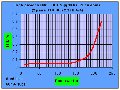

Yes Frank.......with brilliant spec...that will be the last of mammouth designs.....only a handful of well made tubes will take that slaughtering B+ voltage...... I will concentrate on preamps...and more humble things..enclosed small glimpse THD graph (if this comes through). I will ztry and get some soft start arrangemnts on this for others to get ideas.
rich

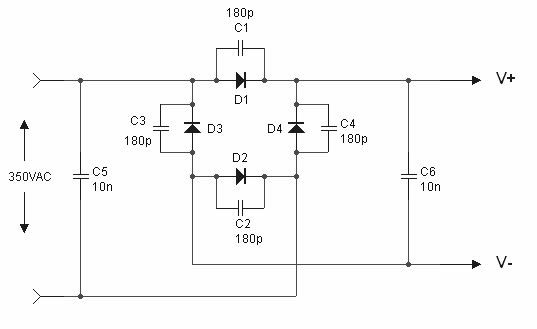

10nF snubber cap
Hi arnoldc
Maybe adding a 0.01uF 2kV ceramic cap across the 350V secondary before the sand bridge to reduce rectifier swithching noise. I know it worked miracles in my SS rectified tube preamp. Couldn't hurt. And no I aslo don't think 17 sec is too long. I would also change the first cap (470uF) to a lower value, say 220uF. Less chance of power supply ringing and your power transformer would run cooler. I'm guessing you take your power for the output section after the 5H choke, correct?
Cheers

Re: 10nF snubber cap
cogsncogs said:
Hi arnoldc
hi wayne, i've seen on some schematic that each diode is shunted with these ceramic caps. will it have the same effect as you described? or i can do both?
i used PSUD to model the power supply and i will surely try the 220uF. yes, i do take the power for the EL34s after the choke. i was planning to have another choke for the driver section sometime soon.
thanks wayne!
Re: Re: snubber caps
Hi arnoldc
You can do either or both or all the way around! Here's where a good dual trace 20mHz or better scope comes in handy. If you don't have one or can't borrow one use your ears. Try different combinations, it's different for each Pwr xformer, grounding scheme etc. I've attached a generic schematic. All caps are 2kV.
Wayne :)
