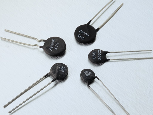

Just to be sure, the attached pic shows the kind of device we're discussing, an inrush current limiter (thermistor). Dan

So the next question for this DIY newbie is, where does one insert the 2 ohm inrush current limiter into the AC mains circuit in the 220? Can it be placed in parallel with the 5 amp slo blo fuse? Should it be inserted into the other lead that runs to the power switch? Is there some way to solder the item that involves the power switch? All help is appreciated.
Dan
Your amp has two Thermal Breaker switches, one attached to each of the two heat sinks. If you trace the wiring to these two switches you can discern that it is really a "loop" of the incoming AC supply. Just unsolder one of the two wires that goes to one of the thermal breakers. Then, insert the thermistor in series with the AC by soldering one end of the thermistor to the now vacant terminal on the thermal breaker and solder its other end to the AC wire freed when it was unsoldered. This will put the Thermistor in series with the incoming AC and by doing the wiring as described you can leave the thermistor hanging free in the air so it can cool as best possible.
Easier to do than describe. Keep your connections as short as possible but don't try to cover them with heat shrink tubing. The thermistor will get hot.

I have found several manufacturers of these thermistors, of various sizes and specs. There are some that are 2 ohm or very close (e.g., 2.5 or so) but their amperage limits vary a great deal. The slo-blo fuse in the AC circuit on the DH-200 is 5 amps but that means it may spike higher for short periods.
There's an inrush current limiter from Ametherm that is rated 2 ohms/5A, or should I go with higher amp ratings allowing for the sudden rush of current, in a 2 ohm or 2.5 ohm ICL? Some are rated/tested as high as 18, or 25 or even 35 amps for 2 ohm or 2.5 ohm ICL's. My guess is that the ohmage (my word....as opposed to homage, which is a different thing altogether) is the key spec, while one wants a little more rated amperage, but can the current rating be too high and keep the device from performing its function in my DH-200 application?

It is proper that you are concerned about protecting your amp and getting things correct -- the first time.
Some experts state that one does not need to worry about current limiting until the capacitance in the PS exceeds 30,000 uF. You are adding two 27K uF caps for a total of 54K uF. The inrush current is a very time limited event as the caps will be charged 30-50% in the first split second and their inrush current will diminish after that. Therefore, you only need a series resistance for a short time and in this short time not too much heat will be generated. Even most switches and diode bridges can tolerate a short for a split second.
Not only do the caps look like a short to the AC supply at turn-on so does a large toroidal transformer -- until its magnetic field is created. But, chances are you do not need to do anything for your amp if you have a newer switch rated at 25 amps. The early DH-200 amps had a flimsy switch that routinely failed. Later versions of this amp had huskier switches. The DH-220 has a huskier switch. You originally stated you have a DH-200 but later referred to a DH-220. Which amplifier do you have?
I routinely turn on a DH-220 with a pair of 27K uF in its PS and nothing has failed yet (fingers are crossed). I also use a pair of monoblock amps that contain 80K uF for *each* channel. This pair of monoblocks I turn on with a time delay relay that places a 50 ohm 50 watt resistor in series with the incoming AC set for the first 7 seconds . A thermistor is a "quick fix" but even when it heats up it still leaves a residual amount of resistance in series with the PS which could impede, ever so slightly, the ability of the PS to keep its caps fully charged during transient musical events.
If you have read the several threads here about all of this you have come to appreciate that inrush current limiting can be complicated or simple with no "best" solution for all applications. Here is my recommendation:
1. Make sure your power switch is rated at 25 amps and ignore current limiting, but be prepared to possibly replace a switch sometime in the future. Professional versions of the DH-220 (P-225/P230) have push on connectors to their switches so the switch easily can be replaced. Whenever I replace a switch I attach push-on connectors to the wires that go to the switch.
2. Use a CL-30 thermistor and rest easy. A CL-30 thermistor is recommended for your application.
3. If you use more than the pair of 27K uF caps hook up a time delay relay and very husky surge resistor which is switched out in a few seconds as the relay times out.
