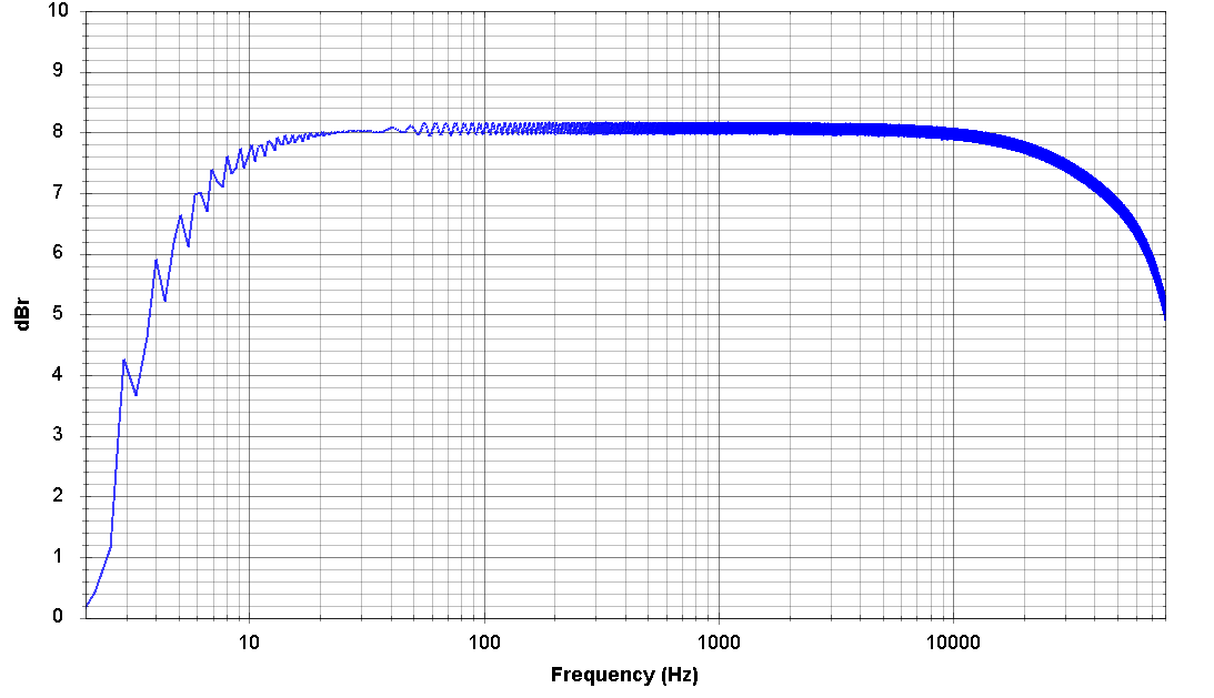

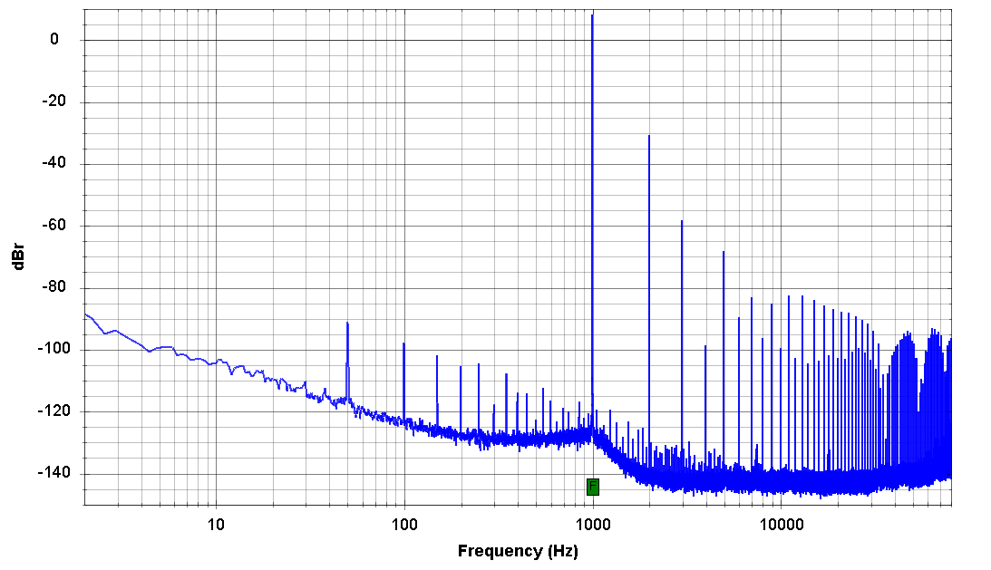

First, the frequency response. The drive level was set to -3 dB (with 0 dB being the threshold at which distortion begins to occur). The frequency response measurement uses a signal known as expo chirp (it provides a slightly sharper response line in the upper part of the audio band compared to the method based on white noise):

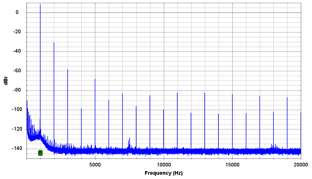

FFT analysis at a frequency of 1 kHz, signal level at -3 dB. Frequency scale shown in both linear and logarithmic formats:

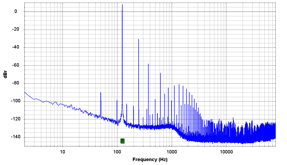

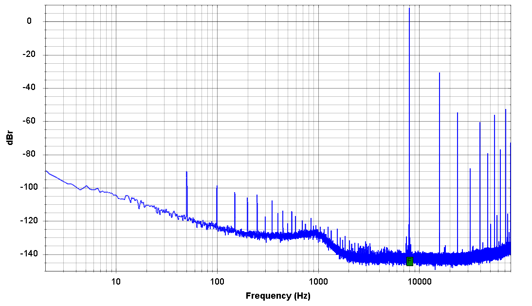

FFT analysis at frequencies of 125 Hz and 8 kHz:

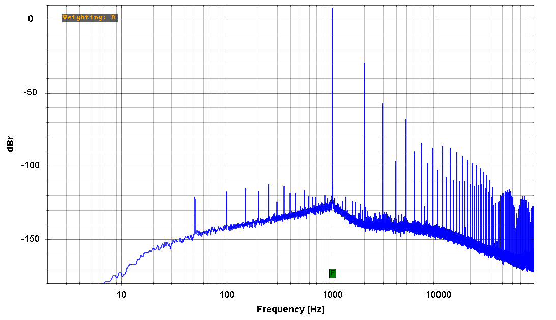

FFT analysis at 1 kHz and a drive level of -3 dB, using A-weighting:
The SNR value was 95.2 dB, and 105.3 dB when using A-weighting. These values were measured with a 1 kHz sine wave input signal at a drive level of -3 dB.

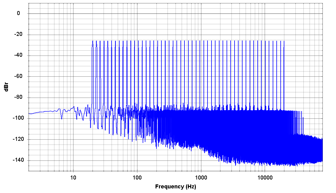

FFT analysis for a multitone test at a drive level of -20 dB:

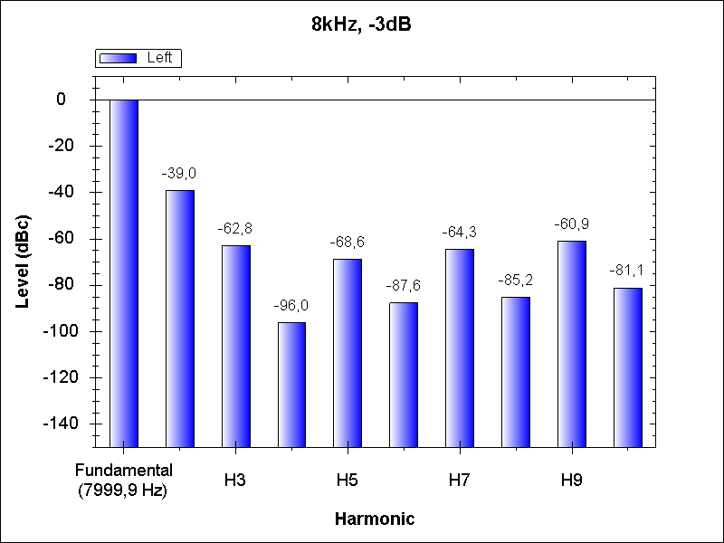

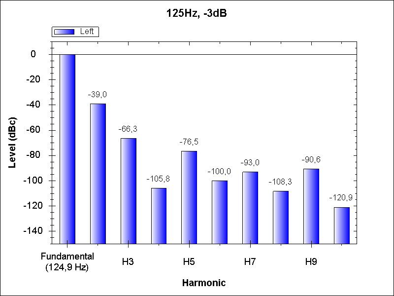

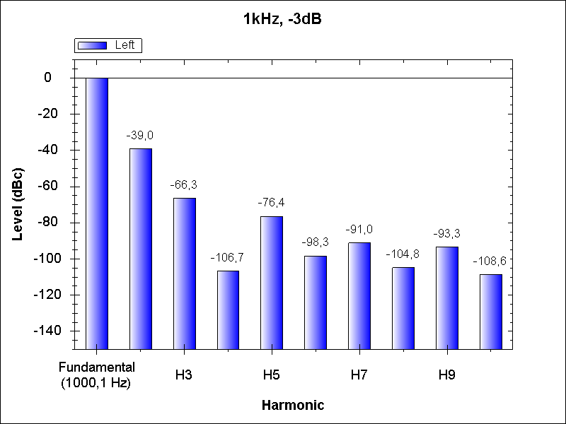

Time for THD values broken down by harmonic components, at a drive level of -3 dB and for the following frequencies: 125 Hz, 1 kHz, and 8 kHz:
The slight "notch" visible just below 1 kHz in the FFT analysis is, in my opinion, a remnant of a minor instability in the voltage regulation loop of the boost converter that supplies 54 V to the tube-based input stages.
I find it difficult to interpret the results of the multitone test conclusively.
As for the THD levels and the distribution of harmonics, a clear increase can be observed with rising frequency. However, the distortion is lower than the values specified in the TPA3126 datasheet (although the curve needs to be extrapolated as a parabola, since the sharp 24 kHz low-pass filter suppresses the higher-order harmonics).
Once again, I’d like to remind that the input stage is tube-based, which contributes additional distortion — notably, a significant second harmonic component is evident, which aligns with the design goals.
Now I'm waiting for the proverbial cold shower — or perhaps even a bucket of scorn poured over my head. I welcome all comments and feedback.

The distortion spectrum is a combination of distortions introduced by the Class D power stage with the PFF loop, and those contributed by the tube-based preamp stage.
An additional note: this is not at 1W output power, but rather at around 16W (i.e., -3 dB from maximum output).
The tube stage’s signature is visible in the relatively strong second harmonic, as well as in the third.
The power stage contributes primarily to the 5th and higher-order harmonics.
There is a clear pattern—odd-order harmonics dominate, which I believe result from the influence of the filter inductor cores.
In the simulations, ideal inductors were used.
The higher odd-order harmonics of 1kHz are at around -90 dB, corresponding to approximately 0.003%. For 8kHz are at around -60 dB corresponding to approximately 0.003%.
According to the TPA3126 datasheet, for 16W output power, the THD is 0.02% at 1 kHz and about 0.2% at 6 kHz (contains only 2, 3 harmonic!), based on measurements from the evaluation board.
Furthermore, the higher even-order harmonics are about 12 dB lower, i.e., below 0.0008%.
I would need to modify the test circuit in order to bypass the tube stage entirely.
Alternatively, I might experiment with changing the modulation scheme.
By omitting the second harmonic (and assuming its value equals the arithmetic average of the remaining even-order harmonics, i.e., -105 dB), we obtain a THD level of 0.005%.
This is four times lower than the value given in the datasheet, which is 0.02%.
The depth of the PFF loop corresponds to a reduction factor of 4.9.
In my opinion, this result shows good agreement with expectations.

However, I have a question regarding the multitone test result (performed at –20 dB drive level). I received a comment in response to the graph and would be interested to hear your evaluation of it.
Multitone Test Summary
A 51-tone multitone signal was used to evaluate the linearity and distortion performance of the amplifier under test, which includes a vacuum tube input stage and a TPA3126 Class D output stage with PFFB (Post-Filter Feedback). The drive level was set to –20 dB relative to full-scale output.
  • Fundamental peaks: ~–25 dBFS
  • Noise floor:
    • At low frequencies (~100 Hz): ranges from –92 dBFS to –120 dBFS
    • Above 2 kHz: significantly lower floor, reaching –145 dBFS
  • Spurious tones: Present between harmonics, typically no higher than –85 dBFS
  • FFT window used: Hann (fixed, not user-selectable)
  • SNR at –3 dBFS drive:
    • Unweighted: 95.2 dB
    • A-weighted: 105.3 dB
The noise floor shape above 2 kHz closely resembles the amplifier’s intrinsic noise spectrum, indicating a clean signal path. The slight rise of the noise floor at low frequencies is consistent with 1/f noise and the influence of the vacuum tube stage. The presence of low-level intermodulation products between tones is acceptable and expected given the windowing limitations and test configuration.
Overall, the multitone test confirms very low distortion, high dynamic range, and a clean spectral response, especially in the mid and high-frequency ranges. The performance aligns well with expectations for a properly implemented PFFB topology and high-SNR design.

The Multitone Test looks quite ok on the other hand. Did you do dualtone tests?

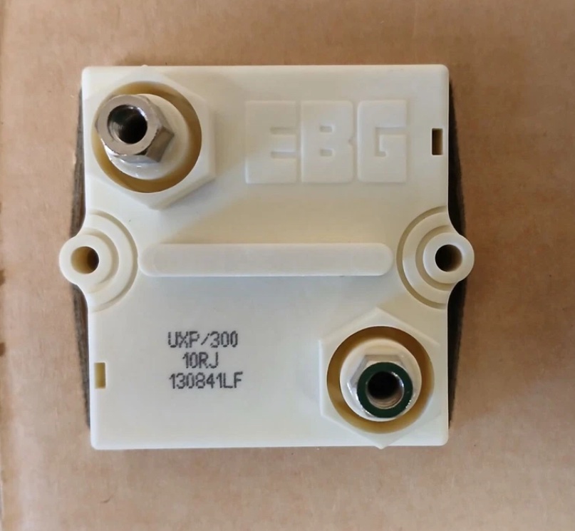

I had a different experience with the green wire wound resistors - big 100w ones were terrible and added significant THD to measurement. Best resistor is a flat thin film with heatsink capability made by EBC. These are 300W and can be found in 10ohm values on eBay for a reasonable price. They are absolutely the best - I get the lowest THD with them and coupled with a CPU cooler heatsink fins with fan, lets you drive them hard.
EBC UXP-300 is the model I think. They look like this:

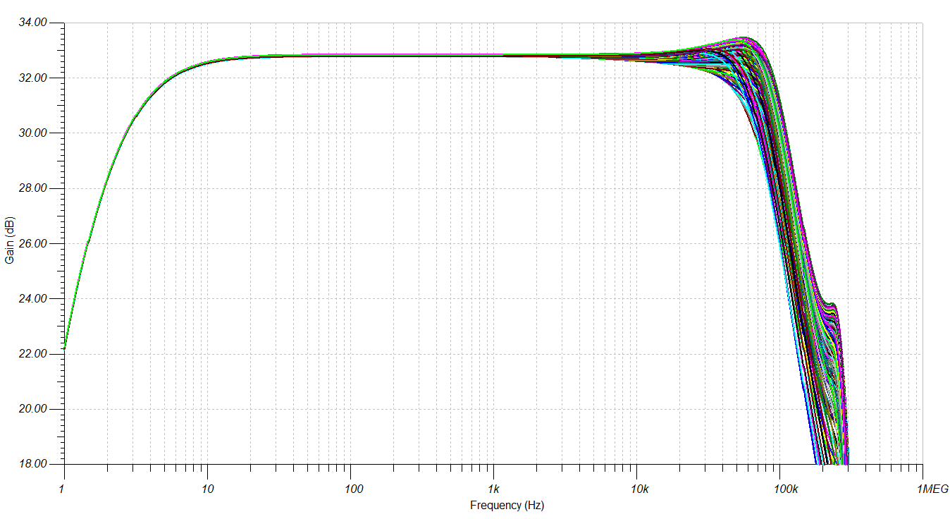

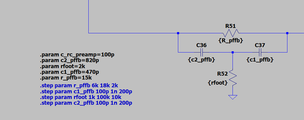

In the meantime, I’ve been working on a revised amplifier concept using a different tube – the 6N28B-V, a frame-grid subminiature dual triode with characteristics similar to rod tubes. This change allows a new topology: one gain stage, a split-load phase inverter, and op-amp-based buffers. Due to the relatively low B+ supply (around 50–55 V), tube-based cathode followers would not provide low enough output impedance for proper PFF symmetry when driving the TPA3126.
The updated design includes a minor frequency response correction in the preamp stage and slight tuning of the PFF loop components. Since loudspeakers are complex, non-standardized loads (composed of various R, L, and C elements), I simulated the frequency response over a wide range of RL combinations as a practical compromise.
The simulation used R values from 3.9 Ω to 68 Ω (E12 series) and inductances of: 1 nH, 1 µH, 2.2 µH, 4.7 µH, 6.8 µH, and from 10 µH up to 6.8 mH (also E12 series). This results in a wide tolerance band for frequency response. The worst-case -0.5 dB bandwidth occurs with L ≈ 30 µH and low series resistance, falling to ~16 kHz. For higher inductance values, the -0.5 dB bandwidth may improve, but a gradual gain drop can already be seen from 1 kHz upward. Things look better when considering the -3 dB point, which gives a more relaxed margin. See the attached graph and simplified schematic used for the simulation.
I’m fully aware that modeling the load as a simple RL network does not fully reflect the behavior of a real loudspeaker system. However, generating a meaningful tolerance field for frequency response based on actual loudspeaker realizations — even for a hypothetical "average" batch of typical two-way or three-way crossover designs — is not feasible within a reasonable time and effort. After all, where would one even obtain a comprehensive dataset covering the construction variants and crossover topologies used in commercial loudspeakers?
So, at some point, a compromise has to be made — even if it's not ideal, it’s a pragmatic approach that still provides useful insights into how the amplifier behaves under a range of reactive loads.
