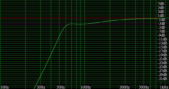

I'm confused, I thought you said this box gave you a -3db at 52Hz, what has changed?:xeye:

Sorry, the reply portion got cut off....
Ok here's what has changed. I reduced the box size to around 25 liters with a box tuning freq of 52 Hz. THIS has given me a
-3db point of 110 Hz. Previously the box was quite huge (about 40 liters) and Andy suggested that i reduce the volume and i also rechecked my calcs on SW and found that the volume needed to be reduced as well because there was a spike at around 50Hz ie., the box graph was not smooth as it should be.
But yesterday I was playing around with WinISD and SW and found that a box tuning freq of about 62 Hz made the box graph look much better with a -3db pt. at the box tuning freq of 65Hz or so. I dont know if this is good or if the tuning freq is too high to be practical. that's where i stand right now....
volume: 25 lt
Vas: 7.11
Qts: 0.38
Qes: 0.58
Qms: 1.09
Fs: 82 Hz
Hi Prash,
Ok I reread the thread and am now up to speed again!🙂
That tuning looks fine to me, and I can't see any problem, a quick look at Win isp online port calculator suggest that if you are using 18mm MDF, all you need is a hole 46 mm in diameter to tune to 62Hz, using the thickness of the timber as the port walls.

I am using 0.75 in MDF (which is about 19 mm). I have two ports each 2 inches in dia. (~50 mm each) though.
Ok, with 2x50mm vents each one should be 86mm long to tune to 62 Hz.
One thing you could try, although, I am not familar with any software that can simulate this, so it would be trial and error, is to try using staggered tuning.
This means tuning the two ports seperately to bring the f3 of the box lower. It might work, it might not🙂
Have fun...
