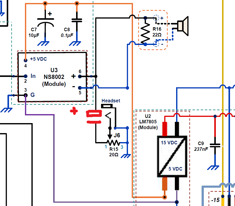

I've attached the NS8002 section as well as the "spec sheet."
From the literature for this device I am just not certain whether or not I can ground the speaker negative.
I'm starting to think I should not. Would there still be proper return if not chasis-grounded?

Neither of the output pins are to be grounded because the NS8002 is a BTL (bridged tied load) design that drives the load between the output of two amplifiers to achieve higher power from a low supply voltage. To ground either would place a short on that amp and likely destroy it.
https://en.wikipedia.org/wiki/Bridged_and_paralleled_amplifiers
The headphone feed can be taken from either pin to ground but must be AC coupled to prevent damage.
So (as the NS8002) spec sheet calls them the "Speaker Positive" and "Speaker Negative" should connect, respectively, to the positive and negative posts of the speaker without the latter being grounded. Can I not just keep J6 in parallel with the speaker as I have, just not chasis-grounding the sleeve post?
Were I to want to ground J6 what size (and type) cap should I use? I take it that the cap would be put in series between the 8002's pin 6 and the ensuing circuit, yes?

You must not ground either 5 or 6 as that could damage the IC. 5 and 6 have voltage on them.
It needs to look something like this. Also I don't think you need R16. It is just extra unwanted loading. The cap needs to be an electrolytic of say 330 or 470uF.

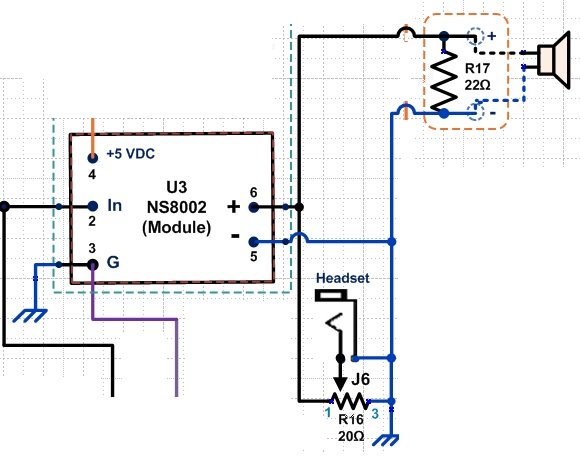

Well, it's been a little while and the circuit has evolved.
Unfortunately, a key component had to be changed and it probably cannot just be dropped in as a replacement.
Maybe if I were six inches tall and had the correspondingly tiny soldering iron I could deal with the miniscule NS8002 output module.
But I could not wire it up without shorting some of the connections. So I am now going to use a module that contains a TDA2050
and has screw terminal connectors. I've attached the TDA2050 spec sheet as well as the module info as provided by the seller.
(Those of you living in the EU will be happy to know that the ohm has now been replaced by the euro! I could make a living editing spec and info sheets coming out of China.)
Also, the low-pass filter is now targeting 159 Hz.
My questions are:
Do I still need C9? (If I had to guess I'd say that I do inasmuch as I do not see that the speaker negative can be grounded.)
Are my component values still correct?
Have I introduced any new mistakes?
Should I have my head examined for pursuing this?
The board looks to be a single rail version which means speaker negative and power supply negative are the same point electrically. So yes, C9 can be omitted because the output from the board is AC coupled and you have your R22 and R19 providing a DC path which ties the output cap to ground at all times.
