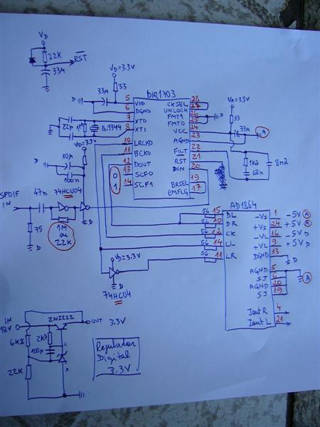

I have built a DAC with DIR1703 and AD1864 to play 44.1kHz 16bit CDs
My plan was to use the Current output mode for AD1864 into a I-V tube converter.
The problem: At Iout from AD1864, both channels looks very saturated.
Below, the scheme.
- load for Iout = 100 ohms
- all inverters 74HC04 at 3.3V
- R feedback for first SPDIF inverter = 22K ohms
Could someone point where is the error?
Could some of my ICs be damaged?

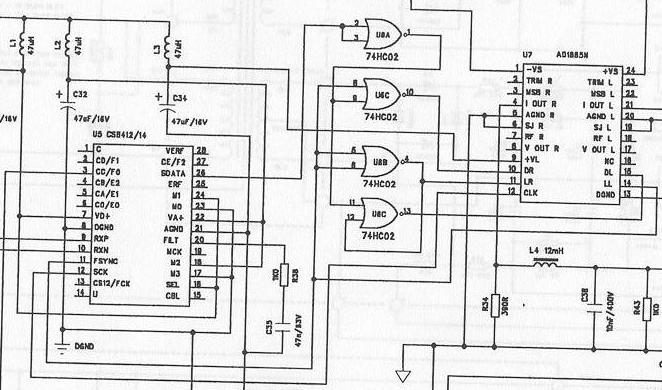

Yes. Shure it is the problem!
Is the delay circuit that one used in Audionote DAC 1.1 ? If not, do you suggest some scheme for delay circuit?
What pins in DIR1703 are equivalent to CS8412 FSYNC, SDATA and SCLK ?
I have IC 74AC02 on hand. Can I use it at 3.3V to make the delay circuit or do I have to use the 74HC02 ? Should I use 3.3V or 5.0V ?

hum...
looking at DIR1703 and AD1864 datasheets, I'm in doubt if "delay LRCK by 2 BCK cycles" will work.
From AD1864 datasheet:
- The last 18 bits sent to DAC will be converted to output when LL or LR goes to "0".
From DIR1703 datasheet:
- From graphs at pag. 13 and 15, it looks each LRCKO cycle (L+R data) has a fixed 64 BCKO. So, in theory, each channel has a "space" for 32 bit data.
So, AD1864 receive last 18 bit when LL/LR goes to "0".
If I have configured DIR1703 for 16-bit MSB first, right justified, AD1864 is receiving an undefined value for 1st and 2nd MSB for his 18-bit internal register.
I dont know if playing only 16bit Cds, I can put DIR1703 to output 24-bit MSB first, right justified.
Nor, if it works, I dont know if DIR1703 would convert 16bit data to 24bit correctly
ex: 1111111111111111 (16-bit) to
00000000111111111111111111 (24-bit)
or if the 8 MSB from 24bit word would still be undefined
ex: xxxxxxxx1111111111111111
Help!
Because of this, I think it will work if you delay LRCLK by 2 BCK cycle provided that dir1703 is in 16 bit right justified mode. The two smallest bits would be unknown, may be zero as they would be taken from the next data frame.
