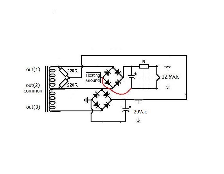

Hi all, I've currently at hand a transformer with three secondaries (all deriving from a single winding) for feeding two independand circuits: one for tube and the other one for S.S. I cannot treat it as it were center-tapped because voltage aren't balanced at zero (0-14-20Vac).
Furthermore, since I want to use a full wave rectifier (and not half-wave) I may have some trouble with resulting hum connecting respective grounds.
I found that with the below schematic, with elevated ground to heater's tube, no more noise comes out. Can anyone explain that or whether is there some error in my circuit? Thanks.
Yes, this probably acts like a "humdinger" as you say. In fact I noticed that connecting the two supply gound together a little hum comes out.
I have to say that the higher supply (the second, with 29Vdc) has a further voltage doubler in series. This one could influence the ground path, causing some instability due to the presence of floating ground.
I could rewind the secondary of the toroidal splitting it in two so I had separate AC lines, but it took too much work. Then I managed in this way.
At the momet the results are good for me, since also the low currents at stake (and less stress for diodes).
In a previous thread I followed the suggestion for a right grounding for the voltage doubler regulator and it seems to work. I'll try on a little nonstop working of the overall circuit and if everything is ok I think to keep like this.

Yes the silver/mica capacitors todady are as expensive as gold on looking around. I don't know 20-30 years ago beacause it's some years that I'm interesting to electronics. Anyway I agree a value under the nF range in order to attenuate HF frequencies, I use to go with multilayer ceramic being pretty cheap.
I suspect now there's a sort of magnetic coupling with the small tube because when approaching a finger hum increases, maybe a metal cage (cylinder) around it could help.
The radiation that is transmitted by the SMPS is being stored in your body --your body is acting like a radio aerial that is given out by your body and being transmitted to the sensitive tube.
If you are keeping the power supply then you have to screen any lengths of connection wire in your amplifier that would act as an aerial ,remember to earth the screening .
Yes I agree, then some tubes can be more sensitive than others because as for my experience they behave not all in the same way (tendence to microphonicity, inner materials etc.). Of course a driver tube will be influenced greater than a power tube.
The fact of shielded cables, in particular those bringing the signal path, is a good idea that I already used successfully in the past. Instead I never did this with the PSU cables, but with sensitive circuits maybe is a solution to be tried as you suggest.
