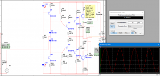

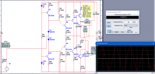

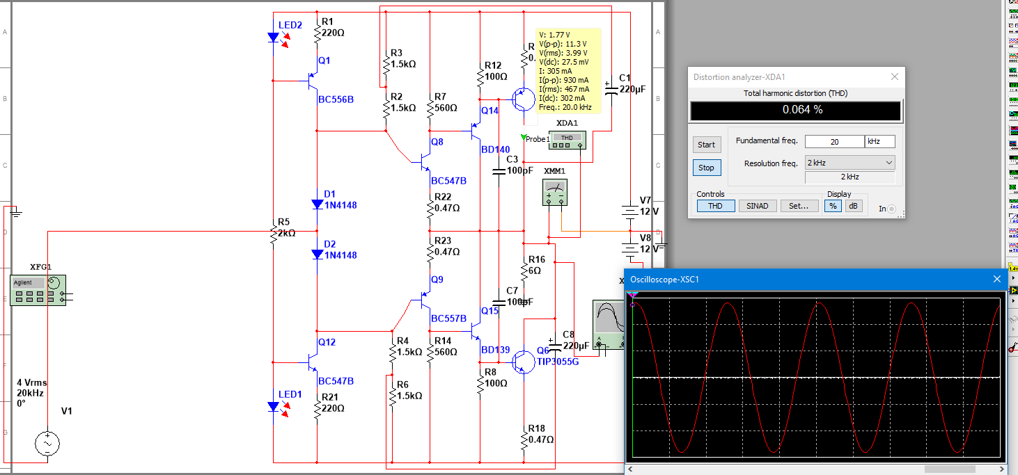

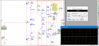

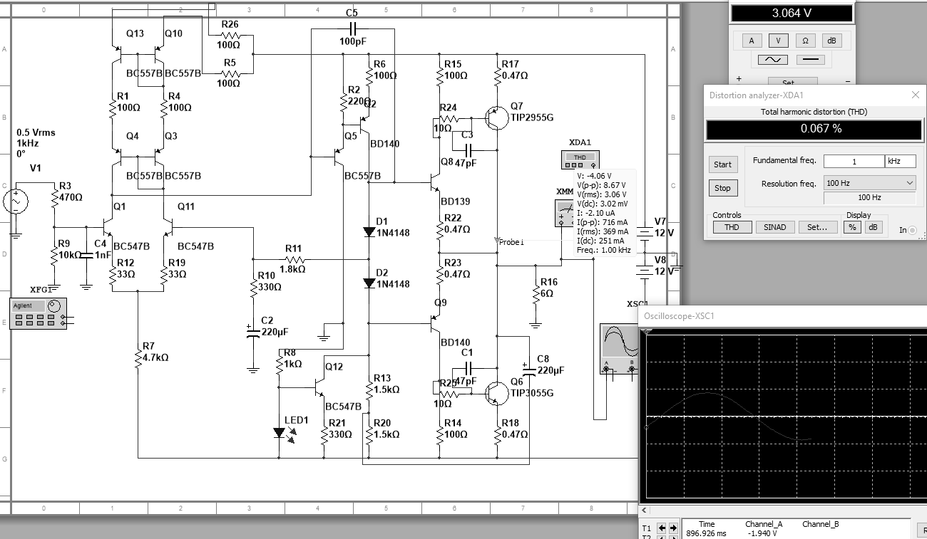

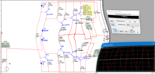

What about an output stage with a NFB in it ?
Look at the 1st attachment: No its not a whole amplifier, its only output stage which is monsterous and gives 0.004% @1khz, 0.05% @20k.
It works with the same distortion without bootstrap but its bootstrapped because its little better with it and because I like how bootstrap sounds.
Its biased at only 50ma current.
Nobody knows why Sziklai sounds better?
I found out why: because its the same thing as this and has NFB in it.
-because the driver transistors form an op-amp with two inverted outputs and the output transistors are the VAS.
Firstly, before this, when the idea came out, I tried this and realized that I reinvented the sziklai but nobody knows its an op-amp with output connected to its inverted in.
I liked it a lot but there was a thing that I didn't like: It was that the drivers weren't emitter followers. Then I came up with the idea for the darlington version.
Summary:
The sziklai gives low THD when bootstrapped.
The darlington version gives it with/without bootstrap.
> I would propose that a highly biased class AB design makes a lot of sense. It allows for the vast majority of listening to be done in the class A region..
I found out there is a very narrow region that lies us to think this is not true.
In this region higher bias means higher distortion. Also there is regions with almost similar THDs at 1 and 20 khz & regions with very different THDs.
Summary:
There is error in two of the attachments.
The bias is 800mA in them.
This is the correct one with 256mA bias.
The 2nd attach is with an Input stage to demonstrate the power.
0.009% @ 20khz !
The squares are without the input stage.
0.009% @ 20khz !

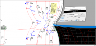

output stage:
- half-bootstraped and half-CCSed OPS.
- 0.008 @ 20khz WITHOUT LOAD
- 0.012% @ 1khz and 6 ohm (7th attachment picture proves this)
- 0.064% @ 20khz and 6 ohm
Maybe you think I needed to use 4 bias diodes because it looks like the drivers and the outputs form a darlington but this is not true:
Q8 and Q14 form a sziklai which is equal to a npn transistor with more beta => this npn forms another sziklai with the output one & u need only 2 bias diodes.
Iam explaining again that Q8 and Q9 form an operational amplifier, Q14 and 15 (the drivers) are beta enchancers and outputs are a push-pull VAS.
