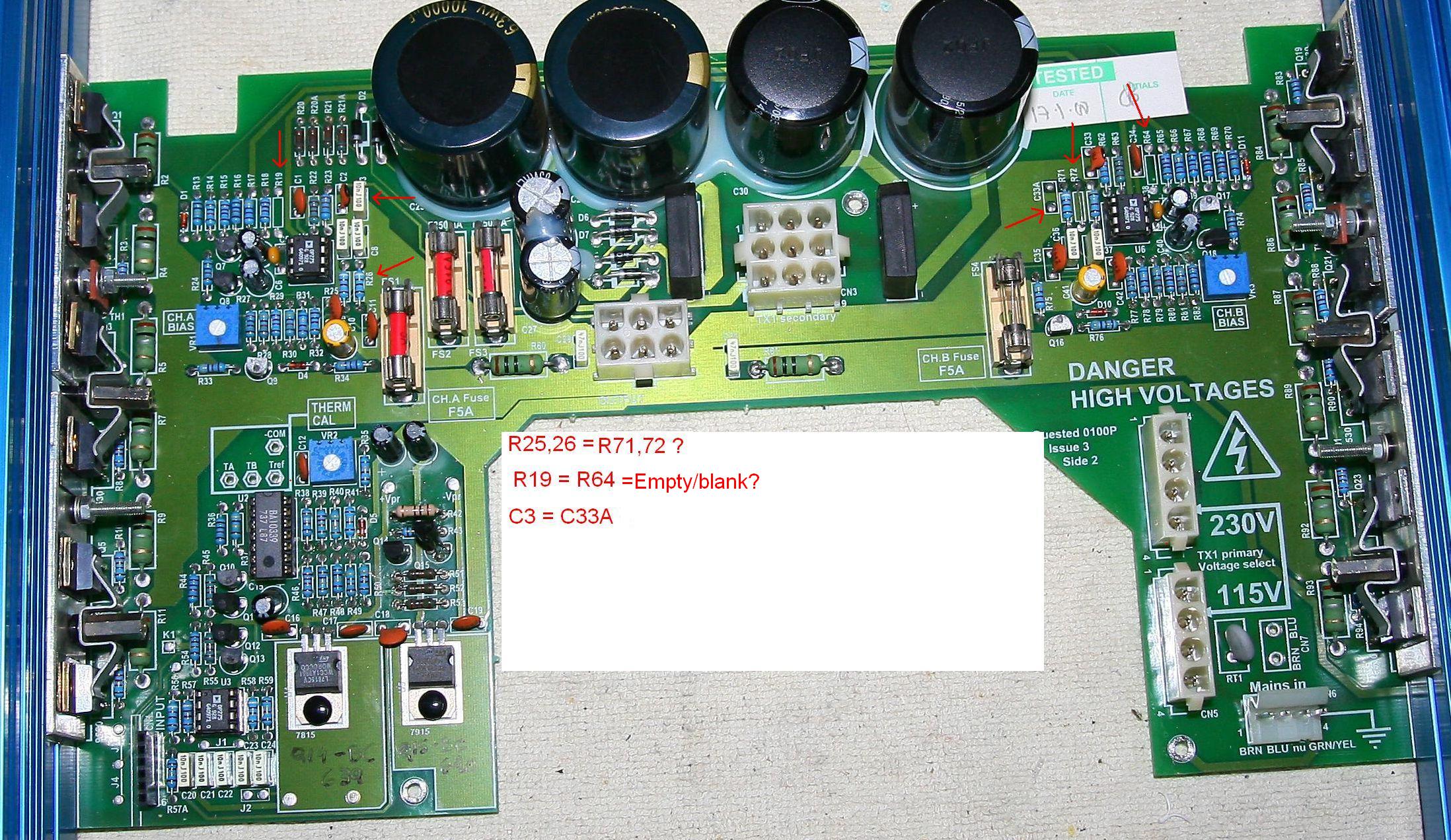

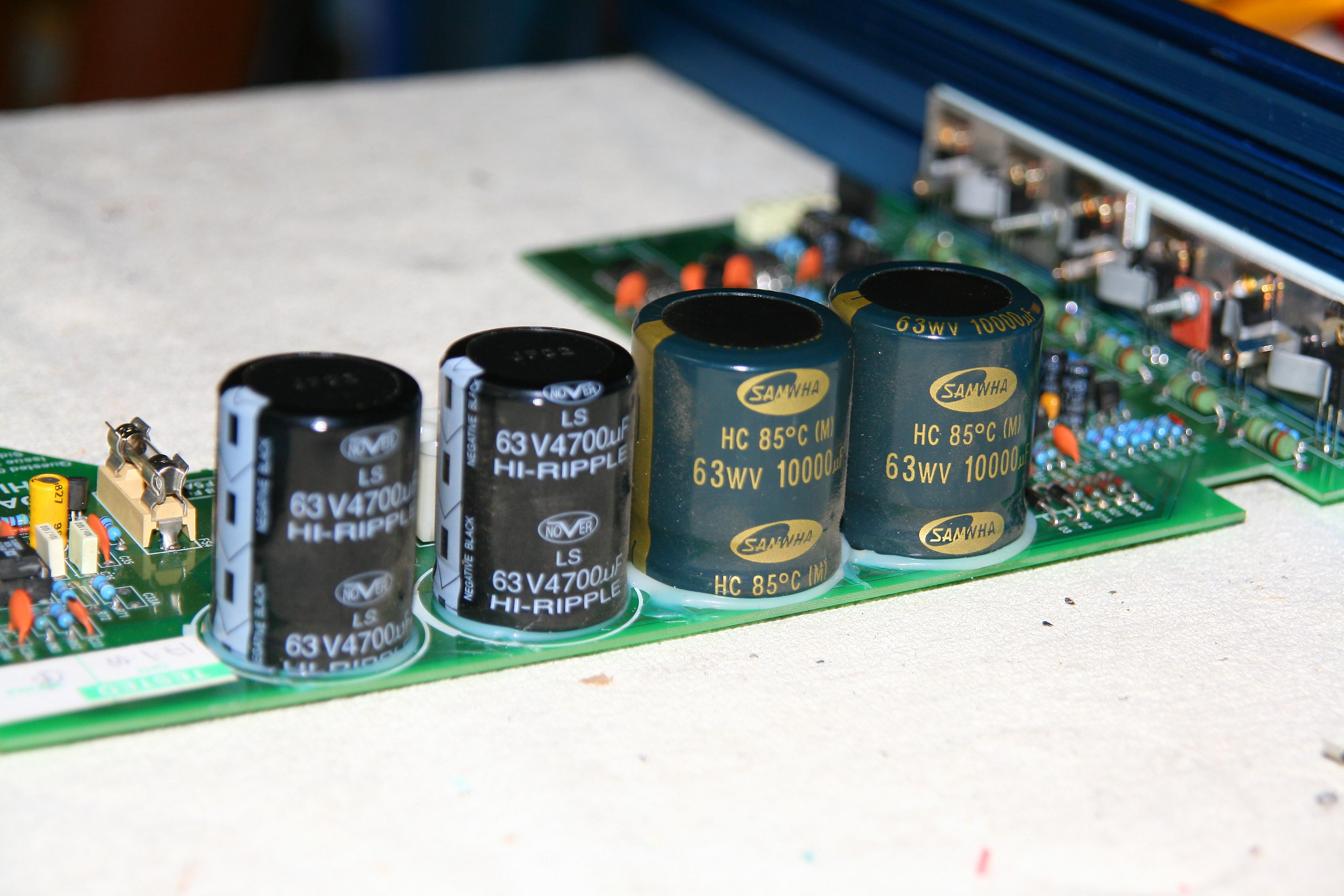

hi guys,
saw that there is some life here and i´m still sitting in front of some quested PCBs and a pair vs2108s. could you (scantos) or anyone else have a look at the power transformers? voltages and power ratings. it would be great bringing some life to these speakers.
cheers ropZ
