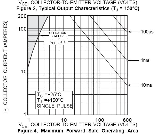

I have Designed an amp with N-channel IGBT APT100GF60LVR
600V 100A 300W IGBT ,,....if you look at the SOA it is EXTREMELY BIG.......

The main pass element is a BJT. APT shows no reduction at any voltage up to the 600V maximum.
I don't believe their specs for SOA.
http://www.advancedpower.com/Communities/APT/Products/100GF60_B2R_LR.pdf

Hi DJK,
Would you Please ellaborate more ,i cant understand your statement....
What type of reduction is to be at 600V...The SOA curve clearly shows reduction at 600V, Mind it their IGBT's dont Suffer from Second Breakdown Voltage...and I have tested them....
These are new Generation IGBT's , dont compare them with older types...

Most people claim FETs have no secondary breakdown, but this is wrong.
APT makes some special FETs for linear use that have better SOA than the IRF types designed for switching.
An APT type optimized for linear use that shows an SOA of 1.5KW on a non-repetative pulse, but only 100W at 500V on DC, going up to over 700W below 50V. This is secondary breakdown.
The IGBT parts will of course be worse. The curves are not shown for linear operation.
I have sent an e-mail to APT asking for linear test data, we will see what their reply is.
