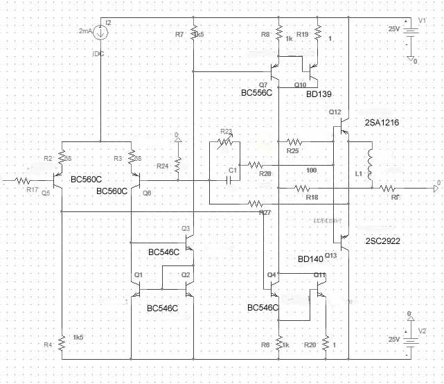

This is the test circuit schematics the class A has open loop gain of 24dB when terminated with 100 Ohms its Z0 has been measured - roughly 80 Ohms. The new elements are R23 R25 R26
R25 must eventually be a capacitor in parallel with R. L will be quite high about 50 uH. R23 compensates the series real resistance of inductor L.

Pintur,
Really I don't understand your statement.
Why a fast device can not be used after a slower class A stage ?
On other hand why the class A stage to be slower? Input capacitance on MOSFET at Vds >= 50V is very low.
Tibi
No it is around 1.5 nf for vertical and even more for horizontal. AND it depends in non linear fashion on Vgs. This complicates analysis in time domain considerably. In switching applications FETs are driven by push pull BJTs as the transition current exceeds 1 amp by far.

hahfran said:No it is around 1.5 nf for vertical and even more for horizontal. AND it depends in non linear fashion on Vgs. This complicates analysis in time domain considerably. In switching applications FETs are driven by push pull BJTs as the transition current exceeds 1 amp by far.
You mean vertical and lateral MOSFET. 😉
Verticals exihibit higher capacitance than laterals, but if you look at datasheet this is given at Vds=10V. As Vds is increasing, input capacitance will decrease significantly. Laterals have lowest input capacity. For example BUZ901 have Ciss as lower to 500pF at Vds=10V. This MOSFET can easily reach 300Mhz and his linearity is very very good even at low Ids.
As you may know, lateral MOSFET's are the most rugged devices.
In my opinion these MOSFETS are the king of output power devices.
Don't mix vertical MOSFET with very low ON Rds - used in switching applications - , with lateral MOSFET which are extremly linear devices.
Tibi

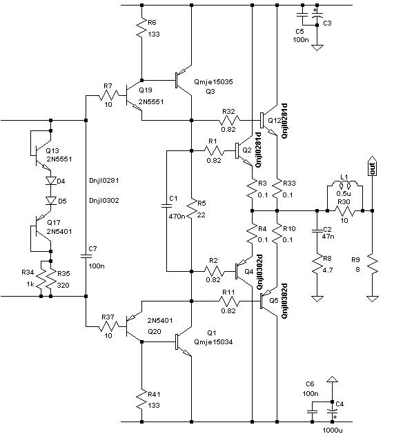

Hi Tibi,
here what Bernd Fritz Ludwig states in his paper "QUAD-405 Modification (and related stuff), version 1/2004":
- about drivers substitution:
"The 'upper driver' (TR7) is part of the 'class-A-stage', and it might thus be tempting to try an upgrade from the venerable RCA 40872 (~BD244D, 5MHz) to a faster device (f. e. Motorola's 30Mhz-MJE15031, MJE15033, or Toshiba's 2SA1930). But there is absolutely no use in this kind of 'update': At very low levels (and that is: everywhere outside the audio-range) the 'pre-drivers' (Tr3/4) alone determine the maximumspeed of the stage (via C11) -- and they are much faster than the driver itself. -- Further it would be a VERY bad idea to upgrade the 'lower driver' (Tr8) by a faster device since it is part of the dumpers, where high speed is rather unwanted (speed is even reduced intentionally by R37/L1/[C19] or R37/L4 [later]). So everything seems to be perfect with the 'cheap' and 'slow' drivers."
-about dumpers substitution:
"A state-of-the-art choice for upgrading might be Toshiba's recent 2SC5200 (or 2SC5359) which replaced the recommended SC3281 in ~1997 (be careful: by now most devices ed “Toshiba2SC3281” are just fakes - something like 2N3055s in TO-264-cases!). Motorola's improved copy, MJL3281A, seems to be still in production, and recently ON-Semiconductors introduced the MJL4281A.
They all have nearly constant dc-current-gain of about 100 from 10mA up to ~7A (with the older types gain drops from about 50 at 3A to less than 30). But unfortunately they are very fast (CGBP ~30Mhz) and thus not wholly uncritical. There is no benefit from increased dumper-speed here, on the contrary: if the dumpers open too fast, the class-A stage may be too slow (due to C8) to react in time.
Test for overshot with 1kHz square-wave. Usually ~1nF (ceramic) from collector to base of Tr10 (like C19 in some issues of the 405-1) will help already. (If you are lucky, C19 and R41/L3 are present on your board [sn. 9000 to 59000]; this will put you onto the safe-side anyway).
Motorola's MJL21194 and 21196 (a kind of improved 15024) are more conservative alternatives: they are not that fast (CGBP ~7MHz) and they show nice current-gain characteristics up to 5A as well (which is, obviously, more than ample, at least with double-output-devices). 'MJ' indicates TO-3 at Motorola, 'MJL' is TO-3P(L)/TO-264, so look for the 'L' here, since all are available in 'classical' TO-3 as well.
Maybe even some TO264-versions of MJ15003 are (or will be) available."
Otherwise what is the task of L1 and, in some versions, of L3 in the Quad original circuit? To increase the open time of the dumpers, I think.
Pintur
Hi Pintur,
I don't agree with all Bernd Fritz Ludwig statements.
I found a big sound improvement by changing BD244D with MJE15033 and later with FJP1943. These two devices are more linear and exhibit less miller effect. If I need a slow device I always prefer a fast one and compensate with a real capacitor.
And in QUASAR is no C11. 🙂
First QUASAR is a different design, but
"There is no benefit from increased dumper-speed here, on the contrary: if the dumpers open too fast, the class-A stage may be too slow (due to C8) to react in time"
This statement have no sense.
On the contrary. I fond that fast devices will make error correction bridge working in time - no more spikes. In fact in all these theoretical current dumping analysis, we work with theoretical components, which are faster than real ones. Get fast man ! 😉
Tibi

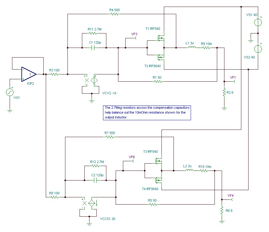

A simple SPICE simulation (such as the attached TINA schematic) will show that the performance using a voltage-amplifer or a transconductance amplifier for the Class-A stage makes very little difference to the measured performance.
I have used a VCVS and a VCCS for the class-A stages so that it's very easy to alter the voltage or current gain of the stage to perform the simulation runs.
I use two QUAD 405s with the original amplifier boards replaced my my own current-dumping design, and still think the this principle is still up there with the best when it comes to amplifier topologies. Peter Walker was a very bright guy to come up with the idea. It's just a pity that the original implementation was so poor.
