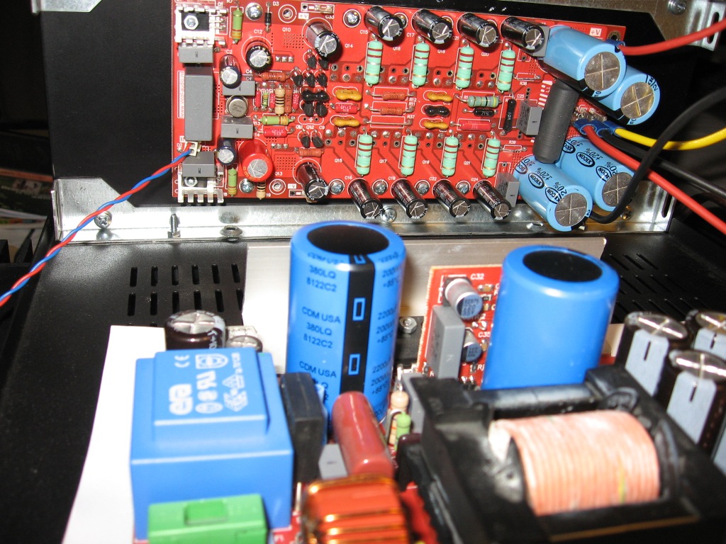

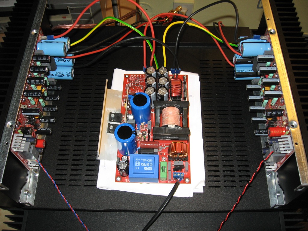

Thank you Hans !
My mods to SMPS80 as as follow:
- increased main filter capacitance to 4 x 1200u/200V Panasonic
- primary snubber cap changed to silver-mica
- output filter caps changed to 4 x 3300uF BHC low ESR
- output 100nF MKT caps changed to 10nF MKP
- output ferrite beads removed - these are too small and will get saturated
- 10ohm resistor between output gnd and heatsink

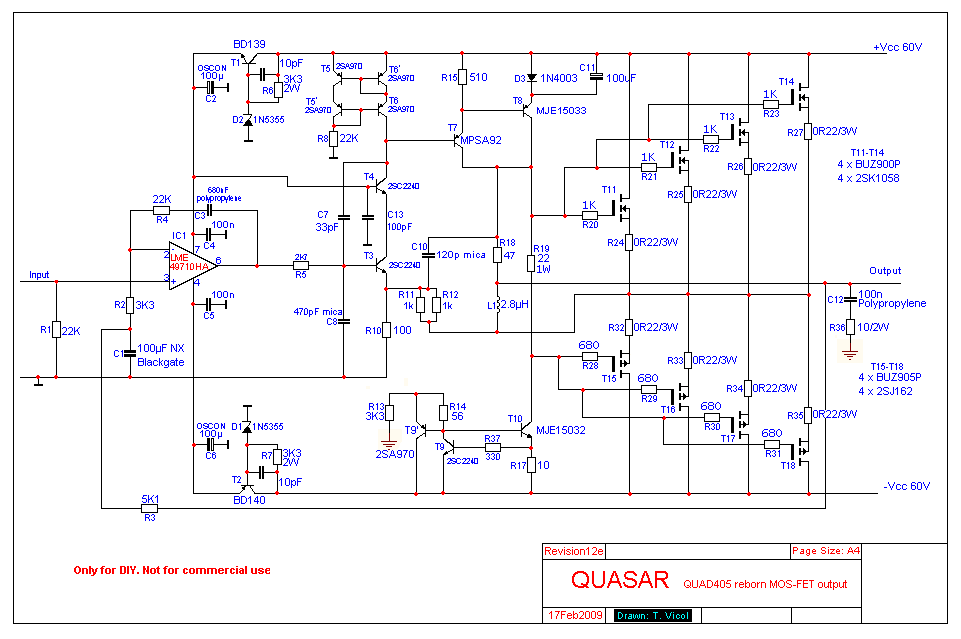

Schematic
http://www.vicol-audio.ro/products/quasar/pictures/Sch_Quasar amp v13_181009.pdf
For those interested in bulding this amplifier, I still have few boards.
Tibi

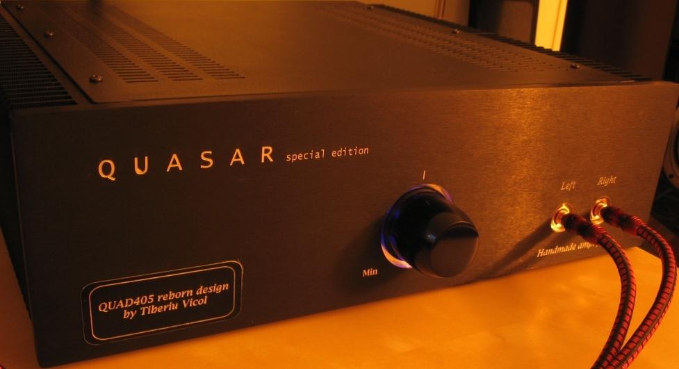

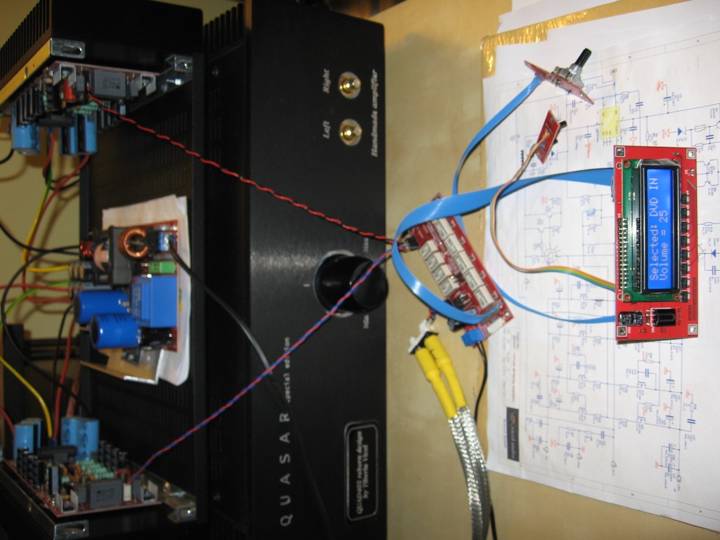

Quasar version 13i, powered by 1KW Quasar SMPS and with excellent R2R DanZup volume controller.
Mos-FET transistors are from Class-D (Semefab) and I must say that I´m really impressed by their performance. 🙂
Tibi
Tibi
