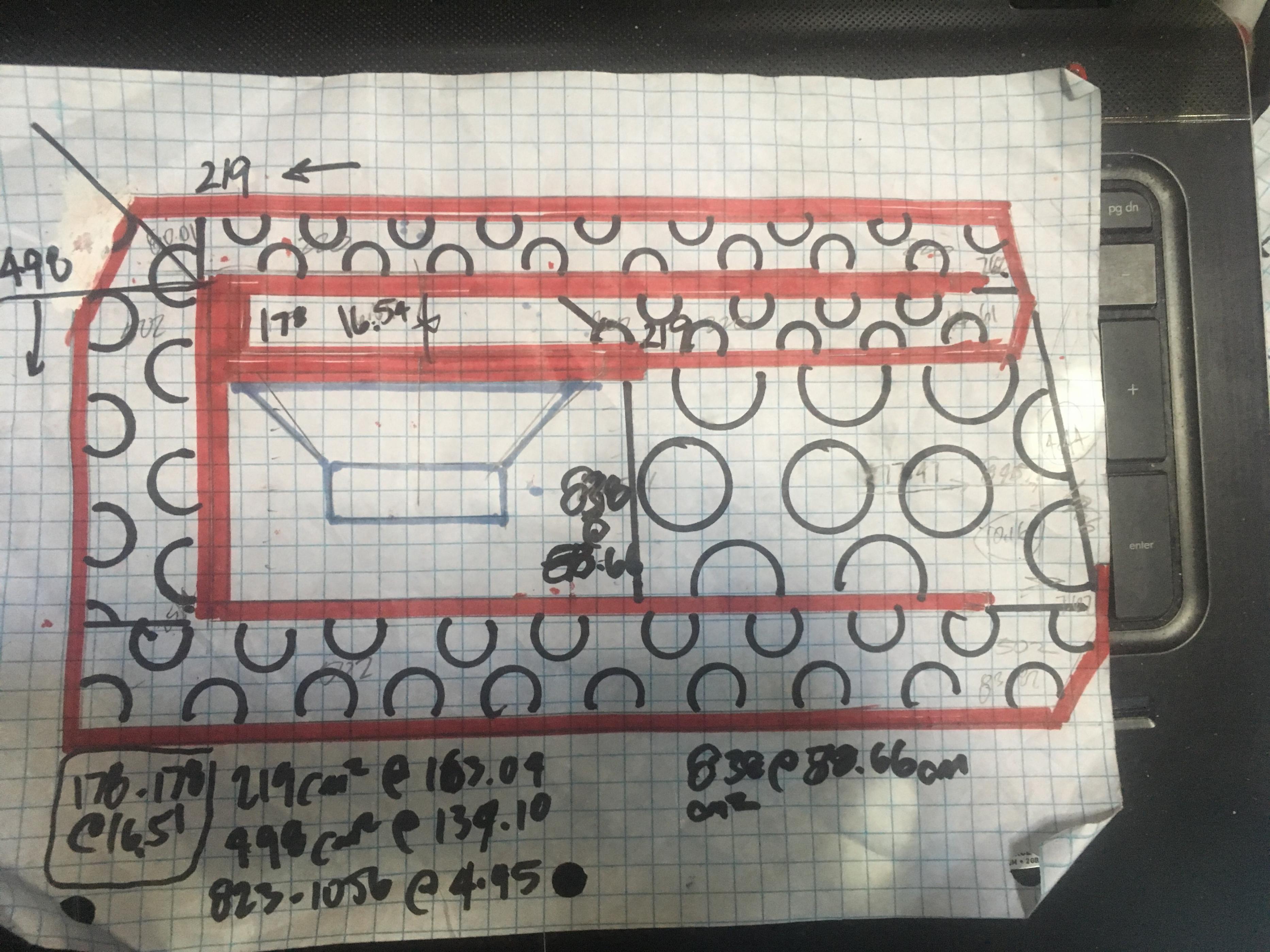

I started last summer basically making MLTLs with a brief combined exit where the motor side (direct radiator in this case) was in a rear chamber of no substantial length. After awhile that morphed into an expanding pathway much like transflex might illustrate. After that it’s a struggle between a tapped pipe or a ROAR/Paraflex depending on the Bl^2/Re.... I found MMJ by luck and he tossed me in his apprentice program, lol! A paraflex is brutal on the cone and it takes real motor force to push it around sufficiently to even work within a paraflex. Or a similar design without the short series exit I posted above. I have both vents set at their radius from a centerline between them if not briefly as one in the last segment of the Taped entry/exit. These are two 1/4 paths interacting which cane from a source 180 outta phase for Fb at the cone, from each side if it, then put through a qw path (or argueabky heimholtz in the case of done HF sections dimensions. to be zero at the exit or where they combine just outside the box...scocery and black magic while nearly kicking the deputy sheriff in the nuts when he cited you for trying to break the IRon law! Haa!

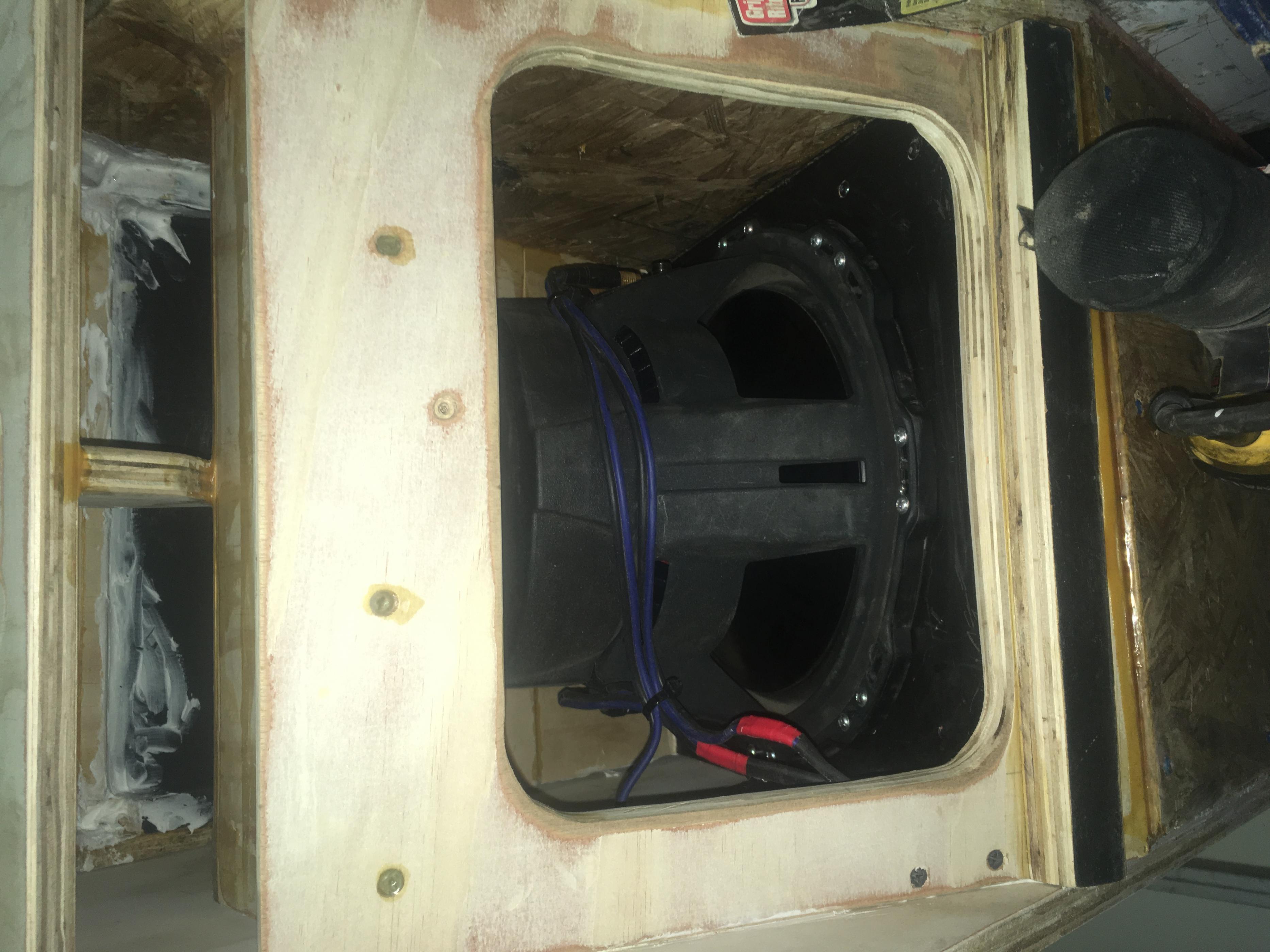

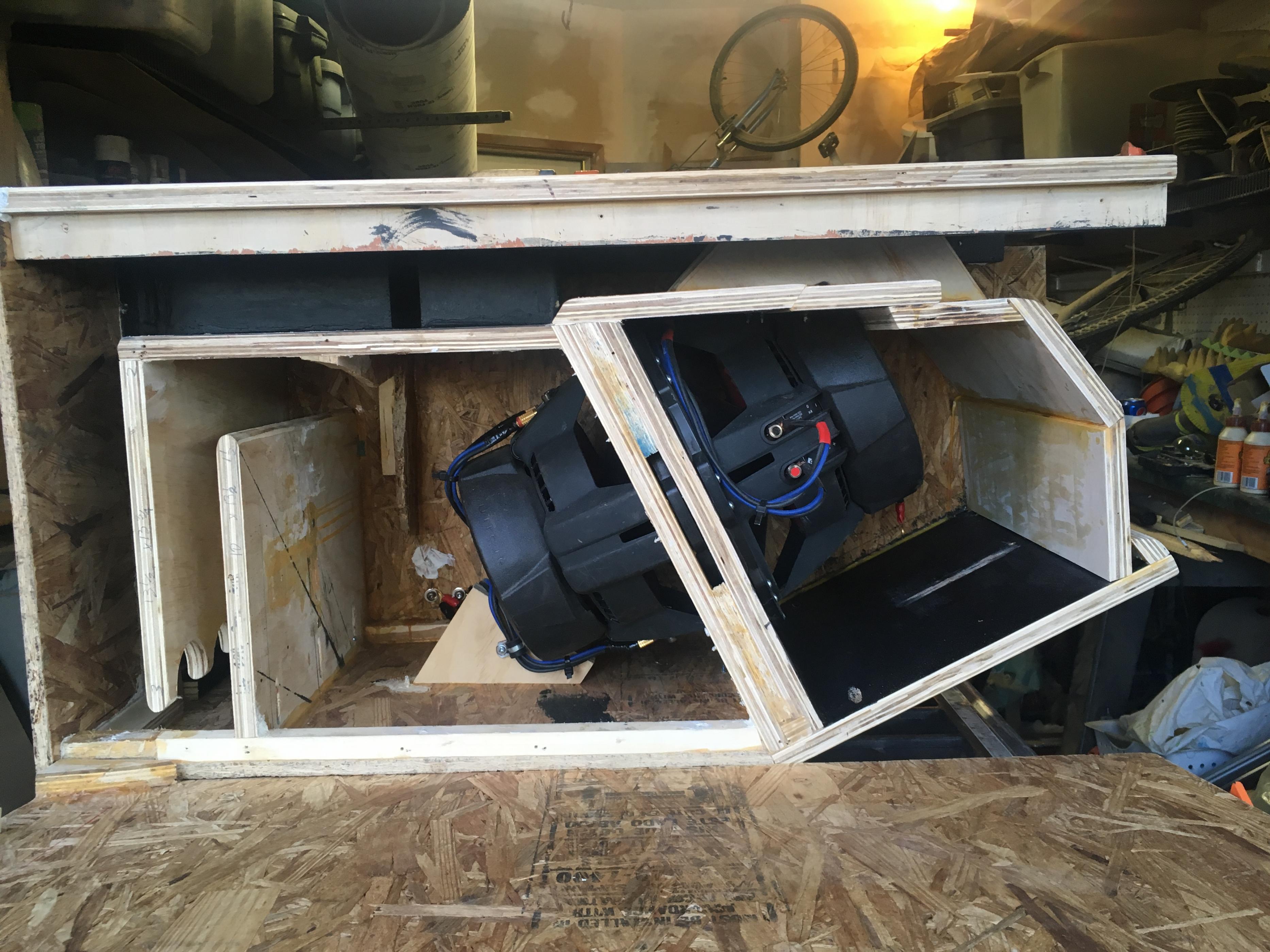

Here’s the isobaric. I think I used every piece of scrap wood around during covid to build a bunch of busywork designs while on ‘vacation’.

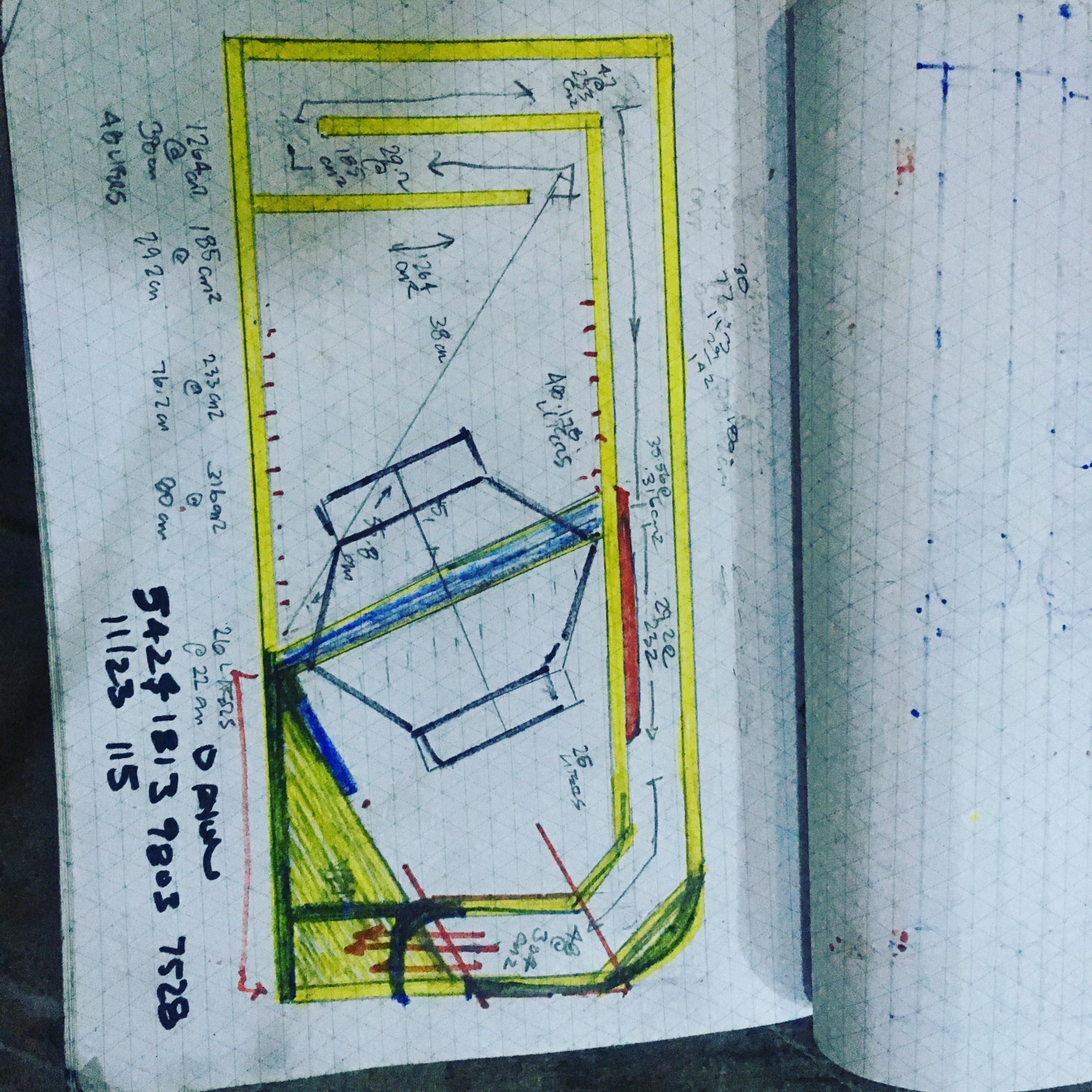

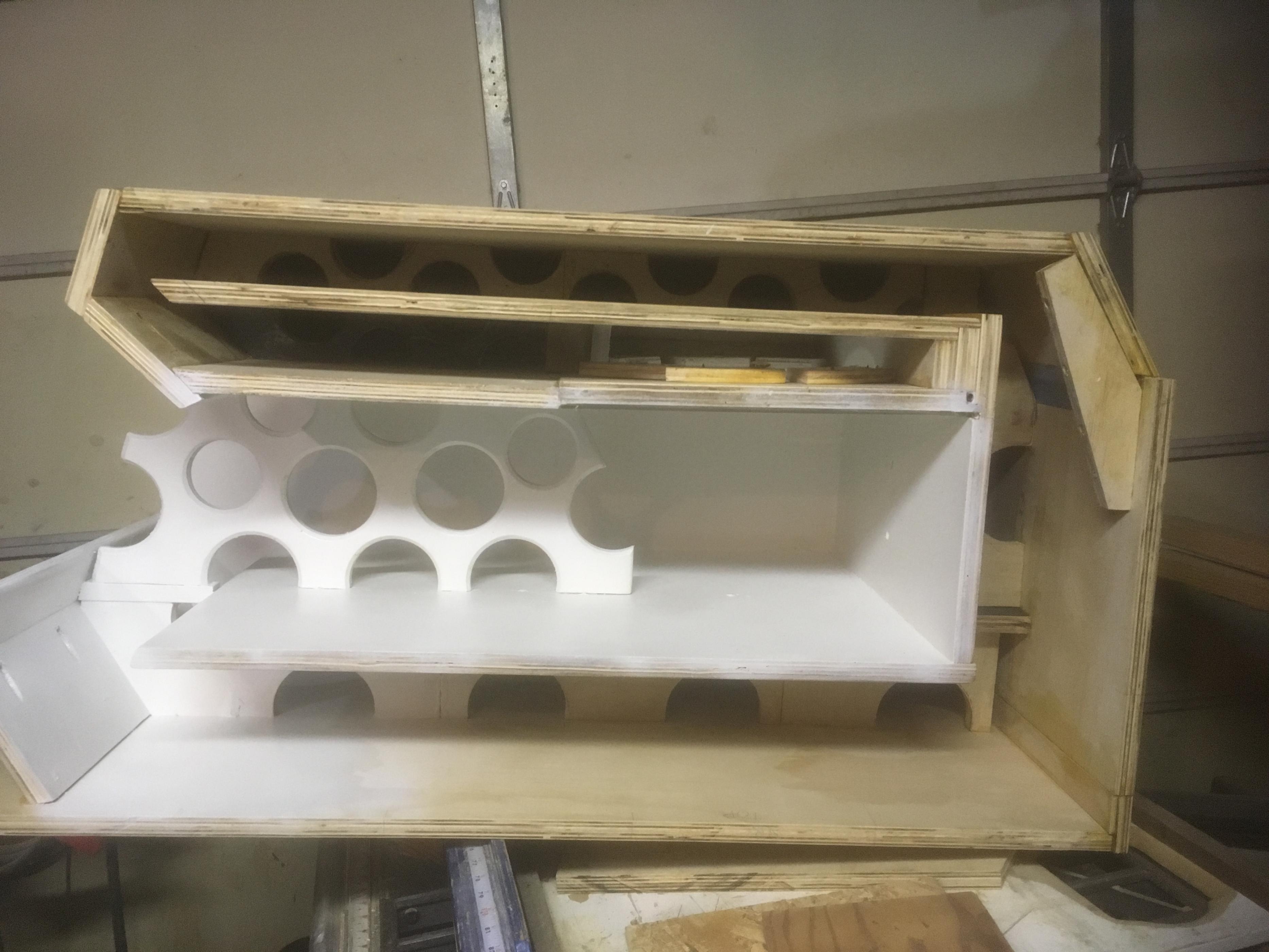

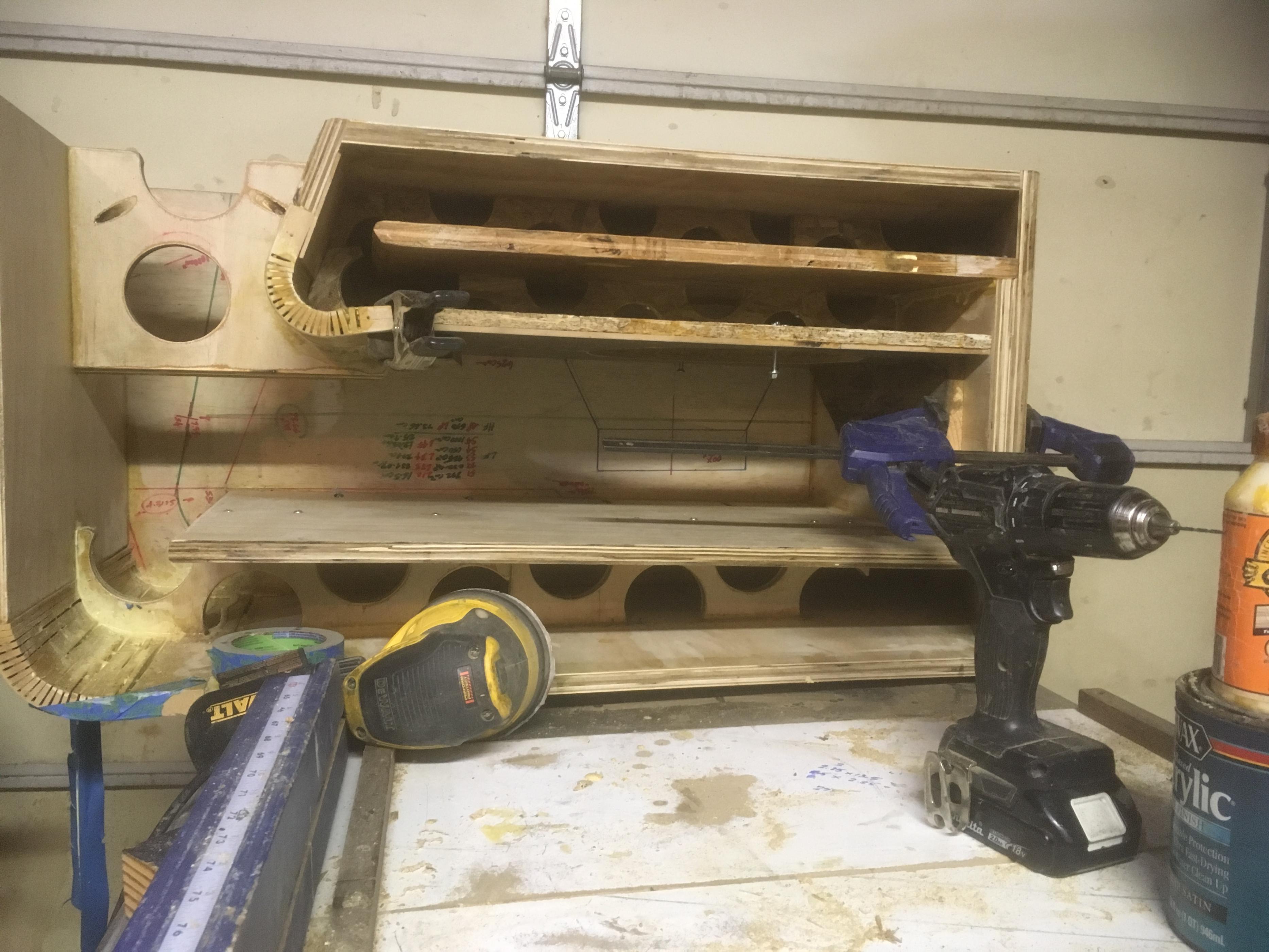

Current paraflex ready to be replaced with the large expanding path but similar version to exploit dB gained for volume used to its diminished return state for what I can struggle to use (400 liters) on the back patio or in a vehicle( lord help me)

Another paraflex I built with an alternate exit experiment. I’m totally into this design and the sound. Only left wanting a lower Fb, and that’s just an excuse to build more stuff as the isobaric already resolved that. So BIG and very FLH ish with Rez chamber is the idea now. And I’ve made enough sins to go OCD, it’s time to make the cut list(after I complete a couple things for 2.1 family /friend gifts I committed to for fun and at the happiness of ‘gift’ to others....

I need to measure isobaric so I can share my findings. I also tried to measure the TS parameters as isobaric but attaching the needed weight for Vas and MMd was not cooperating whatever I did (motor side of the drivers had no decent points for this essentially. And I dented an aluminum cone slightly trying pinching magnets inside and out...

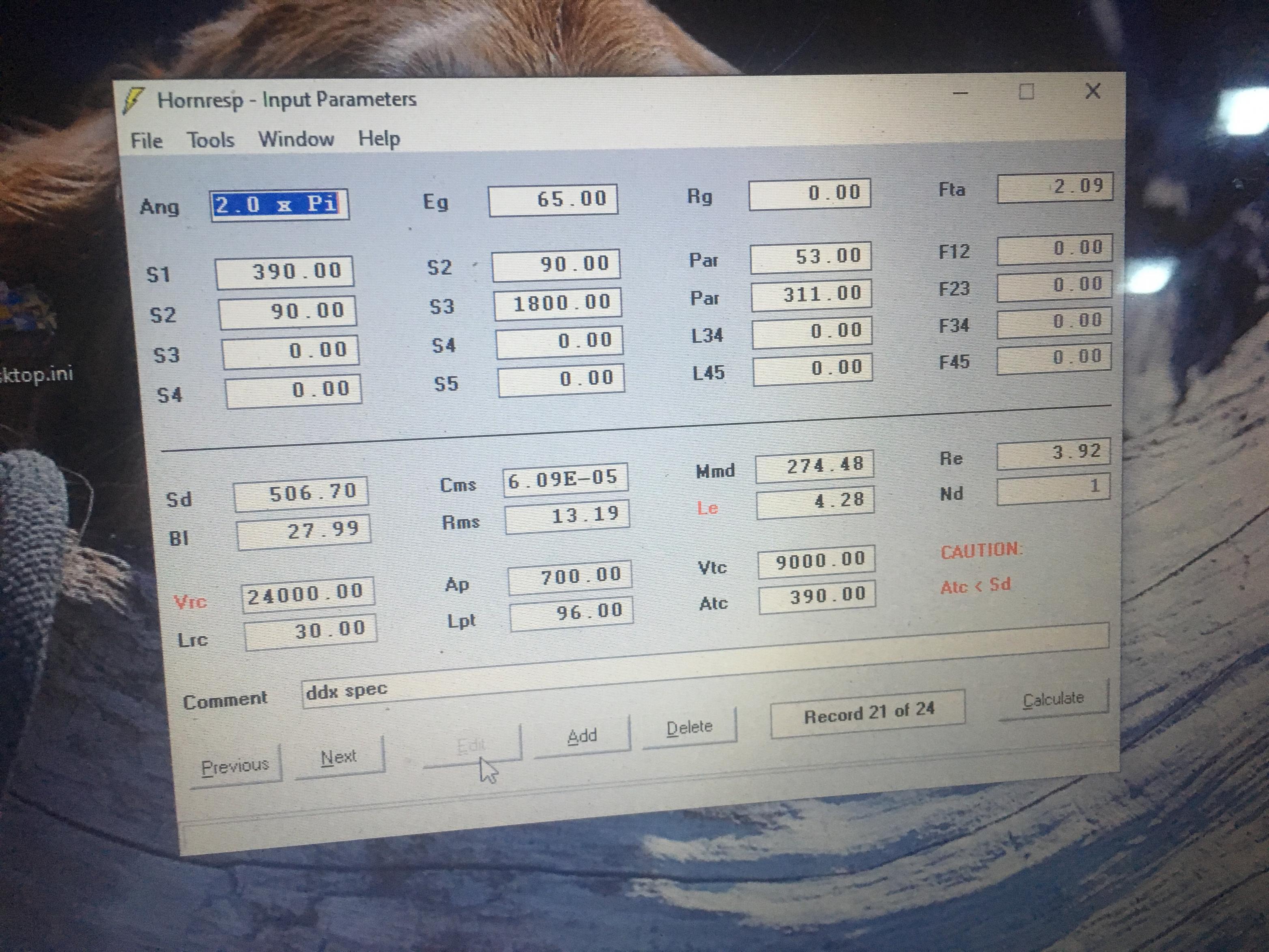

This is what I’m clogging up your nice thread for though and picking Greg’s big brain for any ideas or safe zones to stick with in designing/building this conjecture system of multiple actions and reactions from both ends of the driver and back again as pressure or velocity and node /antinode... etc, etc (hurts my head , lol).
I can juggle this around and get 31/32 hz and that sort of response in a sim not exceeding the Bl assumed close enough to be used at the Xmax figure.

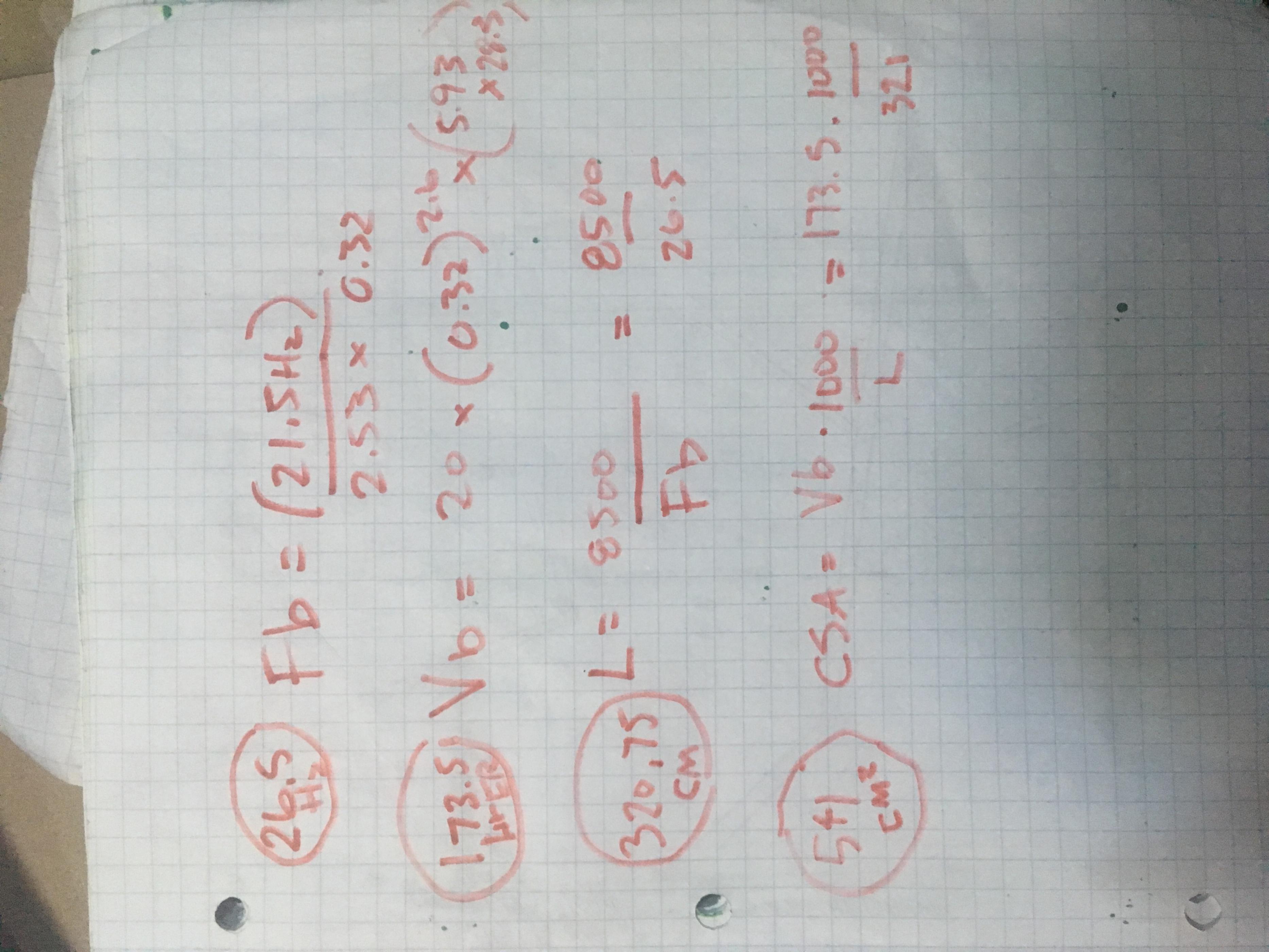

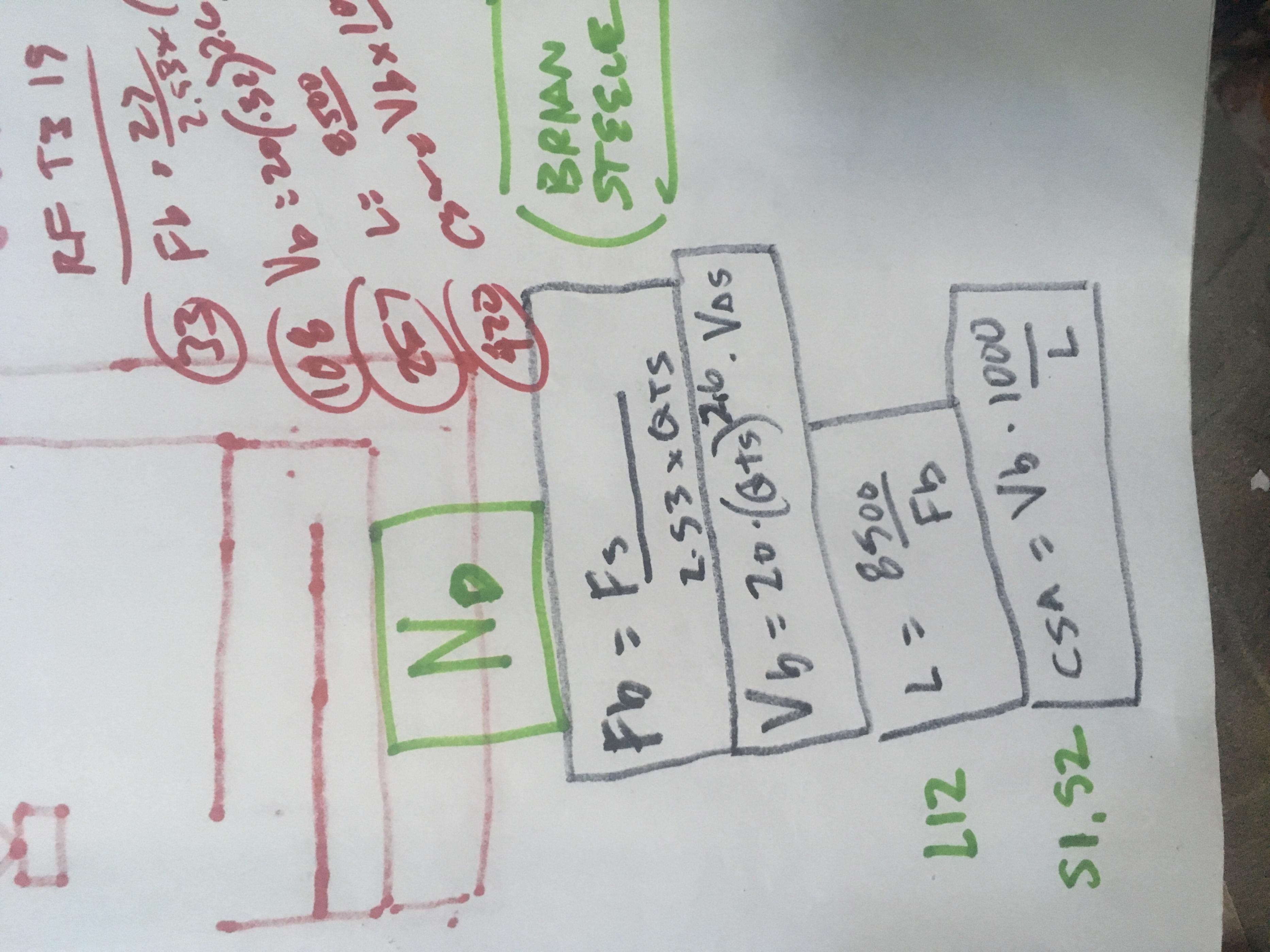

Yes! We can use Brian Steele’s Standard straight TL math and maybe let Greg have a looksee and an approval or suggestion if he feels it’s needed👍🏻

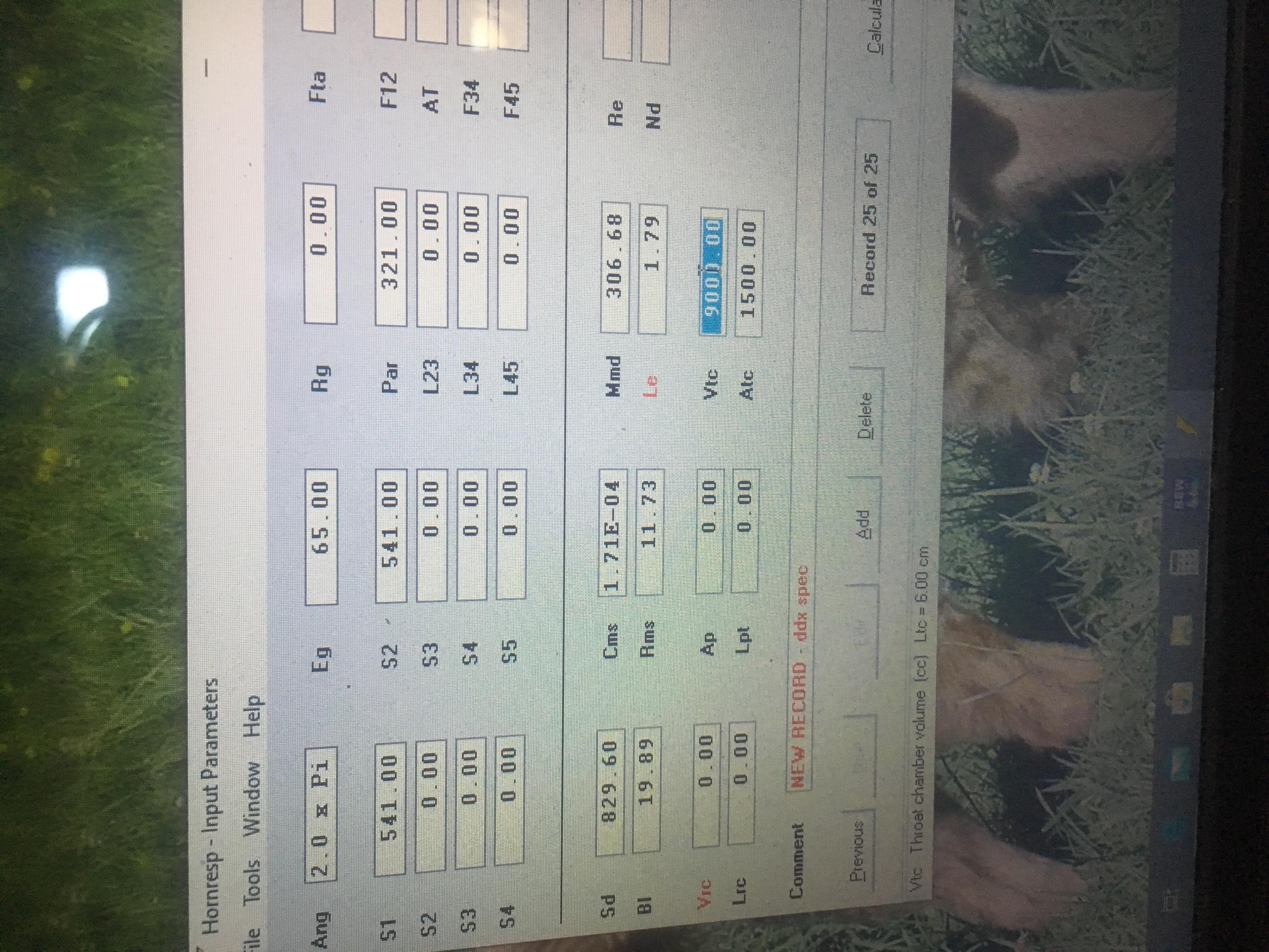

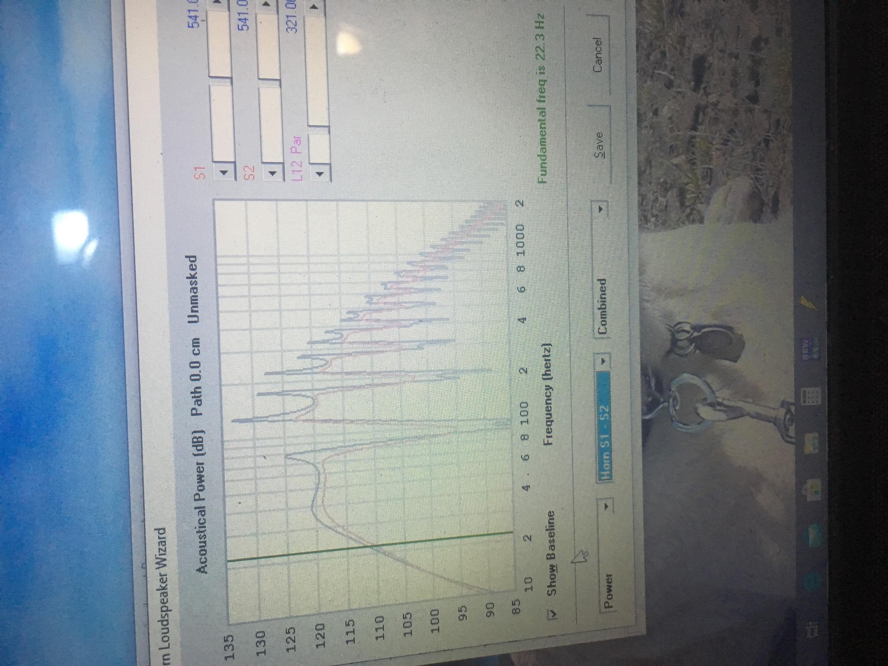

I need to add a small area to fit the big 15” driver. Since this is end fired I need to stick to the very end as any offset(even the radius of the driver basket flange) creates things only seen in a sim otherwise. So I bust down the 829 Sd into a diameter or basically give a 16x16 square inch shape room to fit with excursion
Or the surround shape and bulging parts on stroke clearance( a couple inches maybe, doesn’t need much of any but it’s gotta be done to fit this at the least sideways touching the very end (and slightly inaccurate for the amount of that offset btw if not end fired). We are motor side out essentially, but if you use the 16” or so and the 7-8” motor depth you’re way past 541 cm2.... this can be creatively fixed in several ways.. but whatever works to build accurate is the idea...
Here’s what we get: and red is with some stuffing added to the sim. Fs is 22.3hz, you can mess with the line shape and its length a bit and damp this as you prefer����. But for a plain no offset driver TL this is a great start to an easily tuned to taste subwoofer

You can fit the driver into the line a lot ways. Motor depths and/or diameter are needed to sim it all accurately is all... Brian’s math equation estimators and workbooks seem to be good stuff from what I’ve seen and used myself in the past 🙂
