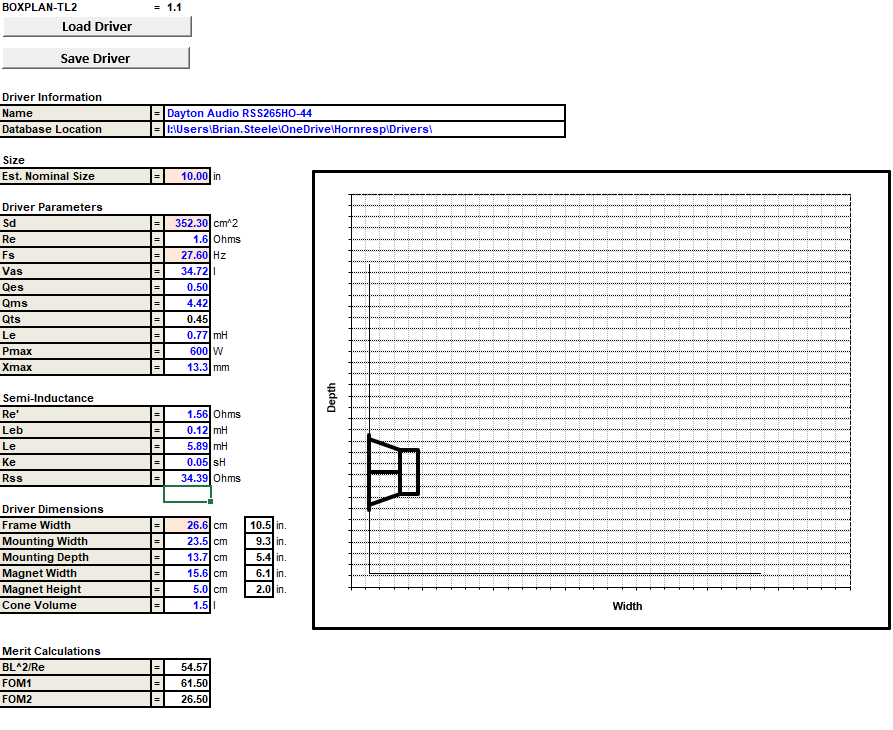

Qts is .45 and vas is 1.25 cubic feet. Would this work in this type of enclosure? Don't want it to be too big but could do tall and narrow. Depth im not too worried about either.

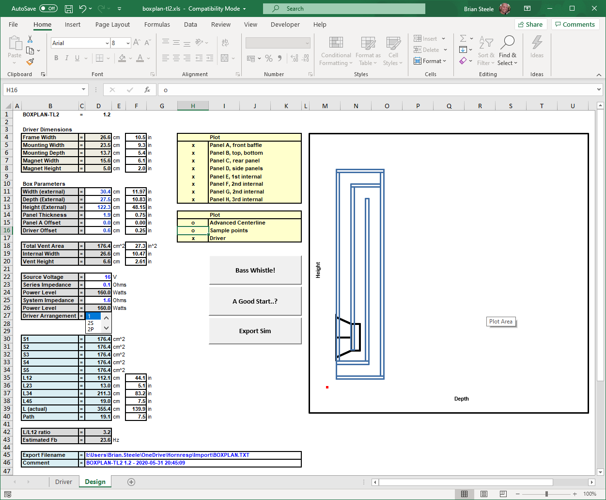

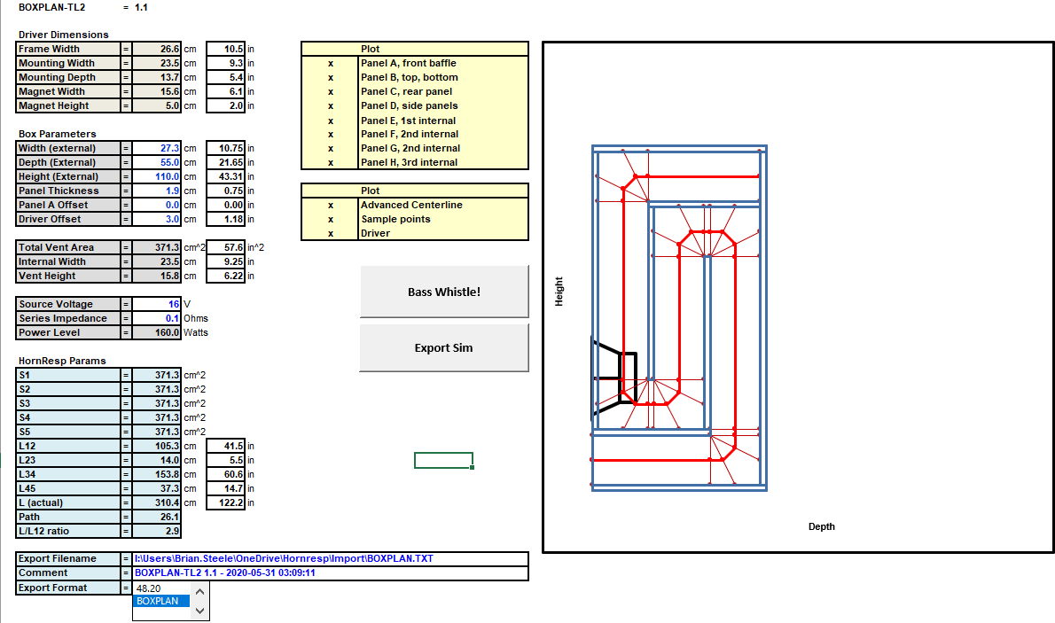

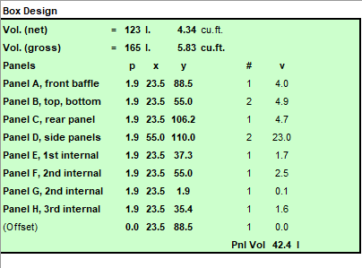

Looks like a decent candidate for an offset-driver TL.
Have a look at the BOXPLAN-TL2 workbook located at my website below. I was able to come up with a 4.25 cu.ft. (net) box, 50% stuffed, that has what seems to be a decent response.
The Subwoofer DIY Page - Horn Folding

Driver specs: http://www.daytonaudio.com/images/resources/295-463-dayton-audio-rss265-ho-44-specifications.pdf
Well, as a general rule, 4*Vas is a nice trade-off between size, power handling or ~139 L and looks good in a lightly stuffed offset driver ~20 Hz TL limited to ~100 W down low depending on the room's gain or 2x larger with 200 W for dual driver loading.
Generally speaking, multiple subs allow more in-room tuning flexibility, so really depends on the room and how flexible where they can be located related to the mains and listening position [Lp].
B0$3 has proven that a 2:1 CR pipe yields optimal driver loading in only ~62.6 L, but the trade-off is a much more rolled off bass with higher Qt drivers, though can handle 200 W and often can blend in better overall in smaller/high gain rooms, so maybe a pair of these would be best overall.
Attached sims assume an 80 Hz/4th order XO in 1.0 pi space.

Yeah, only had time to 'run the numbers', but thought it just a close fit and planned to check it later along with adding an end loaded version and it indeed needs a spacer to mount normally. Once again, metric caught me out.
Anyway, historically I've done these end loaded with a floor mounted driver box and a long vent tube that was 'close enough' to whatever CR I wanted or a 6" dia. [ i.d.] Vs 15 cm dia. ideal size in attached sim.

Apologies for delay replying; long weekend in New Zealand where it rained persistently right where I was.
Thanks Brian and GM for your replies and for the sims. I will need a bit of time to consider these.

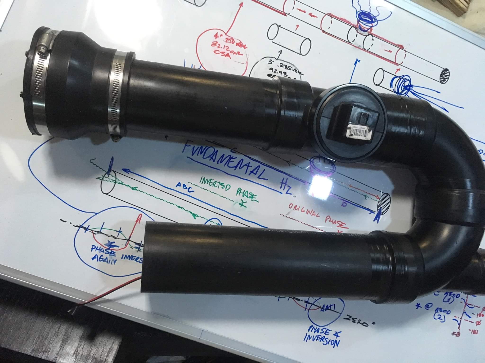

I have decided to go in a slightly different direction for my RSS265HO-44 Dayton subwoofer; still a transmission line but even simpler for construction purposes. No wood, only plastic.
I'm familiar with using PVC enclosures so have decided to stick with PVC piping for the enclosure. Go with what you know, right?
I intend to produce a mini clone of the Nelson Pass El-Pipo design.
I understand there are drawbacks to having the driver at the end of the line but it is really difficult inserting a driver into the side of a cylinder. I can do it with small full range drivers but I think it is impractical with subwoofers. Will use stuffing to try to minimise unwanted resonances.
So the question is: how long must the pipe be?
I'm not sure exactly how to go about modelling this to determine line length. I understand the MJK calc sheet is no longer available for free.
Is it simply a case of downloading hornresp and playing with that using the T/S figures I already have? Is hornresp available for Mac?
Also, I don't yet know whether to do a straight pipe or try to taper it using smaller sections of pipe as the line proceeds vertically. That might be phase two if phase one (straight pipe) works out and isn't ridiculously tall.
I don't mind inserting a bend in the pipe if it works out quite long or can lie it on its side which might make it easier to "blend it in" to the room.
I recall from the NP paper that a 6.5-inch driver results in a 6 foot pipe using 8 inch sonotube so Im guessing around 8 feet is doable using 12-inch diameter pipe?
Initially it would be easier for sure just to use a single section of PVC storm water pipe (or as the significant other calls it 'dunny pipe').
If one works as I hope it might I can use the other to reproduce and have a stereo pair. My ceiling height is 8 foot and 6 inches.
Once I find the line length is it then a matter of determining how long the section of pipe must be according to its diameter?

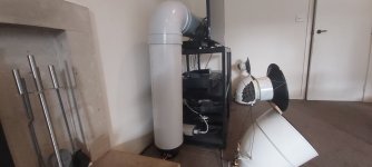

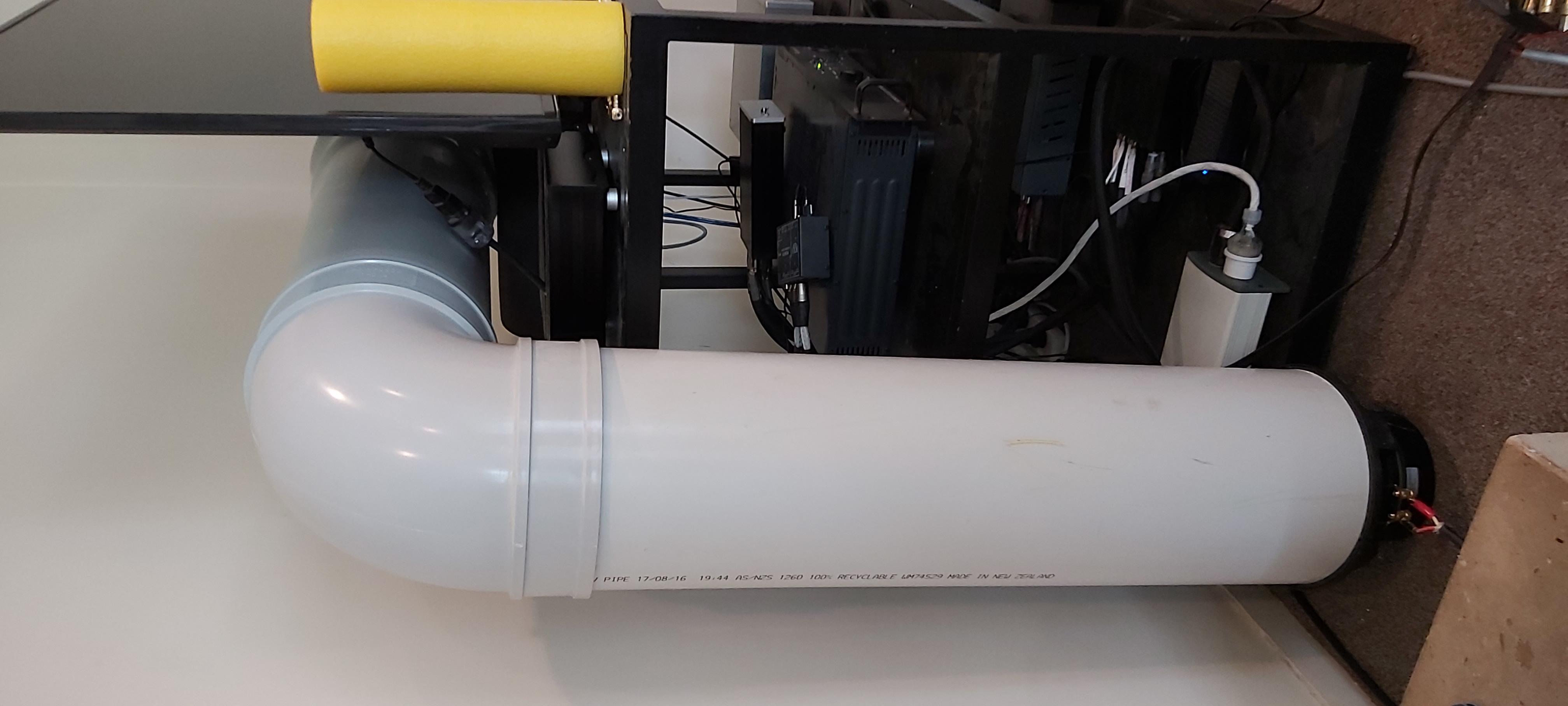

Oh my goodness. I haven’t had bass quality or quantity in my system before making El-Pipo junior. And there’s only one of them!
What I did was find what PVC pipe I had lying around and joiners. that happened to be 2x1m pieces so in total the line is 2100mm long, and the internal diameter of the pipe is 236mm. Handy that because the surround diameter is about 235mm or so. The Dayton driver fits just so with the magnet poking out and acting as a base for the upright pipe. There’s a 90 degree join at roughly the height of the equipment rack so I can hide the horizontal section of pipe in behind the TV.
I’m not exactly sure how long the line should be. But already the system is sounding pretty incredible. Definitely this is better bass than my ported 15-inch Dayton, thought enclosure size of that wasn’t ideal. I would like to optimise line length for the T-Line though.
Thanks for the help with this Brian and GM.

You’re barely hitting an Fb of 40hz with a mid 20s Fs and a Qts that might allow mid 20s or so. There’s smoke, but you haven’t seen the fire�������� Maybe Stick 160mm of 275cm2 ‘solid’ in the last 3/4 and see if you like it? It takes tuning down to about Fs without the peaky nature of the oversized pvc pipe at 40hz you have now. It pushes things at RMS power, air velocities of 22m/sec at the open end and Xmax near that level of input power and it’s intensely loud output level..

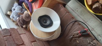

Cool project! I like plastic pipe stunts too. However, mines only a 4” driver at Fb 70hz in 45cm2.
I did a quick calc and I think I need more pipe, another 40cm or so to get down to 28hz and another 120 to get to 21hz.
Thx BW for the tip. I had stuffed the line from beginning to end so will try last 3/4 only. My partner said to remove the first attempt but when she eventually noticed this one she just sighed a little so will take that as mild positive reinforcement. Glad I cleaned the pipes better!
