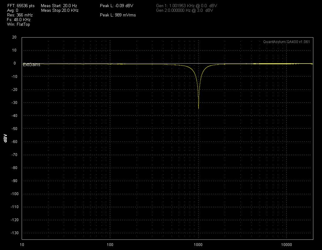

Synctronx you can do a frequency response test with the QA400.
Connect the QA400 left out to the input of your TT. Connect the output your TT to the left input of the QA400. Put the TT in bypass, if you installed a switch for this. Using gen1 set the frequency to 1KHz if that is what your TT is tuned for. Set the Gen1 level to 0dB. Click the FR button on the QA400. You should get something like this.
If the display is at -65dB or there about, hold the control key while left clicking on the dBV button. This will bring up a dialog pop up. Where it says input gain type in -65dB. Using the Ymax control adjust the scale to 10dB at the top so odB is visible.
Now with the ctrl key held down left click on Xlog button and set your frequency scale.
Never mind the Gen setup. You don't need it for FR.
Here is an example.
This shows the envelope of the TT.
Here is an example.

Hope you realize that the QA "wants" frequencies that are "in the bin"?
Off a little bit and the displayed results are not accurate.
QA is generating that. At least they think they are.
The notch depth is no where near what it really is.
Posting pics, notch isn't correct.
Result:
Set up manually tuned notch for -40 dB:
Prep for test no notch:
Prep for more test:
First test set up:
Result:
Prep for more test:
First test set up:

David, as the levels you recommended, w/o the notch
hooked up, when I press FR it ended up at 14 dB above
your screen setting.
So I adjusted the screen to show more just in case.
The FR is screwing up the notch, or the notch
is screwed up somehow. I measured each section
and they are set to 22Kohms.
It almost is acting like one of the capacitors is installed
backwards but that doesn't make sense. Somehow it is
inverting 1/2 the notch?

Then add 14 to the input value you have in there. If you used -65 then try -51. Do this until you have a 0dB reference or there about.
Result:
Prep for more test:
First test set up:
Just use the FR function to set it up.
For some reason QA scaled down. The scale changes with number of point.
Not what I was expecting. You can fix it with the extra gain parameter so at least it reads correctly. It's all relative anyway.

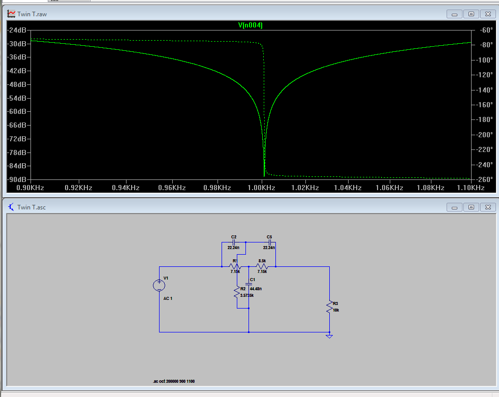

I got the values from the same place. Set the resistor and the cap to E96. Then use the spice model to test and trim the values.
Your curve looks like the two networks are not matched for frequency or amplitude. Do you have a cap meter? If the caps are not pretty close you will have issues like you show.

Demian, please tell me how we can be using the same value finder
for the TT notch. Even with teaking it.
My cap values are .01uF your cap values are 22.24nF?????
My resistor values are 22K - your resistor values are 7.15K????
or 8.5K on another resistor.
My ground caps is.01uF your ground cap is 44.48nF?????
The only thing that looks remotely similar is the layout.
I"ll get there eventually.
