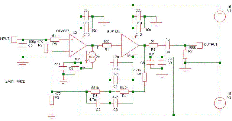

Quality phono preamp ?
Why not try this:
It is based on the phono preamp made by Thorsten Loesh and the original could be found at his homepage.
It sounds pretty good...
Thorstens homepage

Optical said:
oops i should elaborate, i need schematics..
soem feedback one ones you have tried out would be cool too.
If you want a basic circuit, you have lot's of them. I have made a couple of Excel files for calcuclating the RIAA network. Drop me a note if you or somebody else want those.
