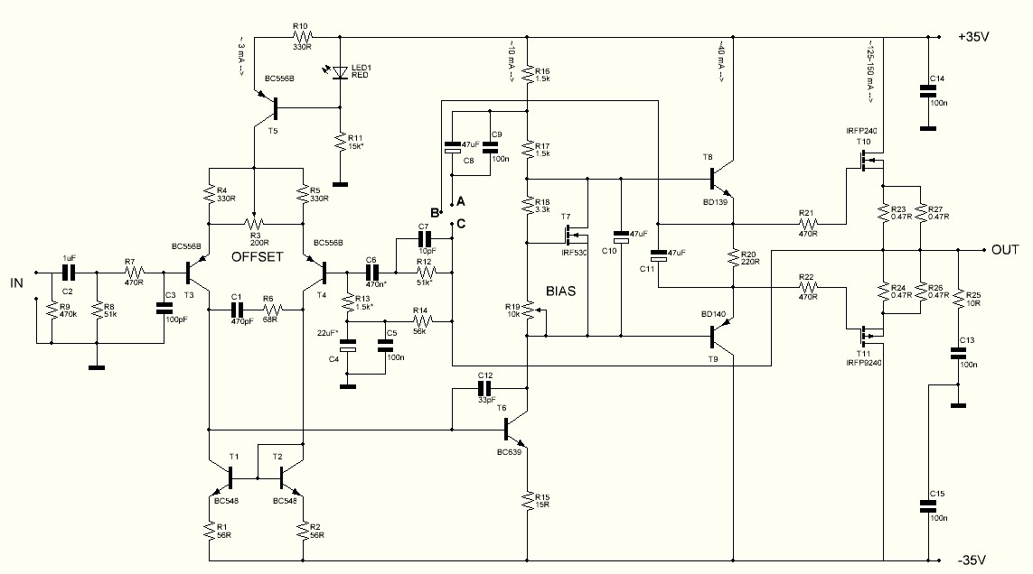

This schematic can be enhanced - design better CCS fir the input LTP and install drivers for the outputs. Now input capacitance of the MOSFET's is a big load to the VAS. Bias drivers at 30-40mA and will have a much better schematic.
On the picture is my home amp. Works perfect and sounds very well. Use it for an example.

Questions abaut your schematics
Hi astankov!
I have a few questions about your schematics:
1. What connects the points A, B, C ?
2. In feedback mode that does not have any error (resistors: R13 and R14)?
3. Who replaced mosfet IRFP240/IRFP9240, with bipolar transistors 2SC5200/2SA1943 what changes are needed in the schematic?
Thanks and cheers!![cheers :cheers: :cheers:](https://files.diyaudio.com/forums/images/smilies/cheers.gif)

Answering the questions:
1. I forgot to mention about this - when you connect A and C points bootstrap source is taken from the output and this is how the schematic works now it is something like "standard" mode. I was suggested that if I change the bootstrap source like to connect A and B points will have better results. Unfortunately never tried this and don't know what effect will have so I recommend to use the standard mode and connect A and C but you can try connecting A and B and see what will happen.
2. NFB schematic is correct it is obvious that is different than most people use. Values of the components marked with "*" depend from PSU voltage. Given values are for +/-35V PSU and if you want to use different supply they need to be recalculated.
3. Not sure what you ask but if you need to replace MOSFET's with bipolars like C5200/A1943 probably need to replace IRF530 with bipolar like BD139 and use different values for R16 and the trimpot R10. Also need to lower the gate resistors (they will become base resistors) to 1-2.2R and reduce value of C11 to 1uF. But all this is useless to be done - there are more and better schematics with BJT so you don't need to do that just use different schematic. Also I never tried to run this schematic with BJT so the given changes may result in problems and as I said before better use different scematic.

Hi astankov,
I think your diagram is too complex and not yet sufficient.
One should not compare guitar amplifier with hi-fi amplifiers.
A guitar amplifier needs:
soft clipping
Short-circuit protection
poor damping
A current mirror and a driver for the Mosfets reduce the distortion. From about 0.05 to 0.01.

Guitarists call their sound clean, if the amplifier clipping 0.2%. But most of them do not like the cold sound of a PA amp.
