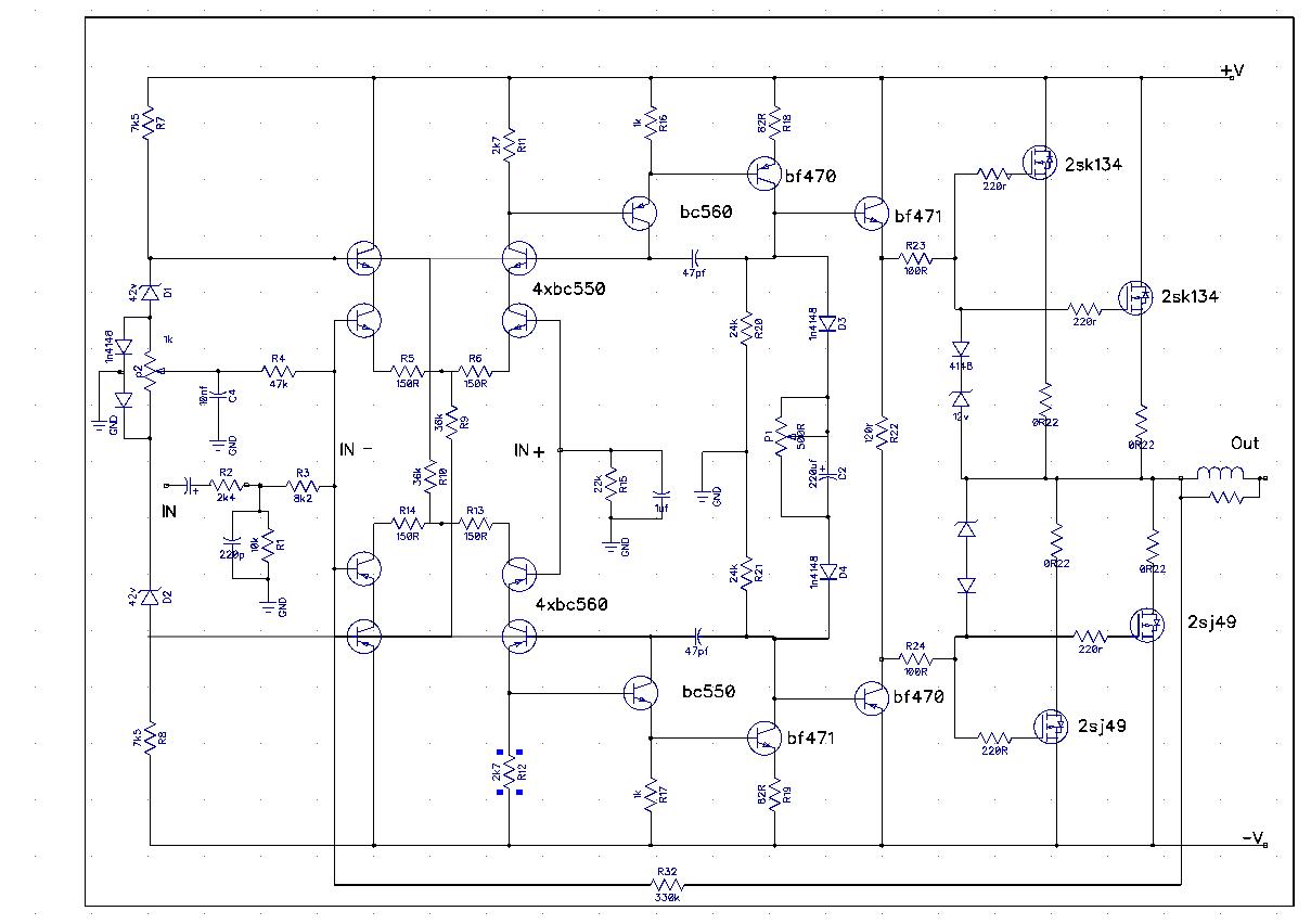

I reverse engineered this module.
You know what?
It sounds nice, dead quiet and stable.
It sounds a tad like an dh220 hafler but a lot more silent and with a better bottom..
I tried it on 50v rails. (Ithink 2x60V would be the right value.)
R8 and R9 set quiescent and offset. Actually 100ma per device, offset is 100mV with R8=R9.
All resistors are 1%
Q1 to Q10 are BC550/560
Video transistors are used as drivers.
I do not understand why C7 has a so large value, though.
What are C10 and P1 for?
Any comments on this schematic?

I realised i might be wrong about Iq and offset trimming.
Advice needed.
R8 and R9 are fixed values on this board. I (wrongly?) draw them variable as i empirically moved the offset by trimming one of them..
Cdoms were ceramics, i replaced them using silver micas.
Under 47pf Cdom and with no output zobel neither output self, it oscillates.
I forgot to say: No turn on thump.

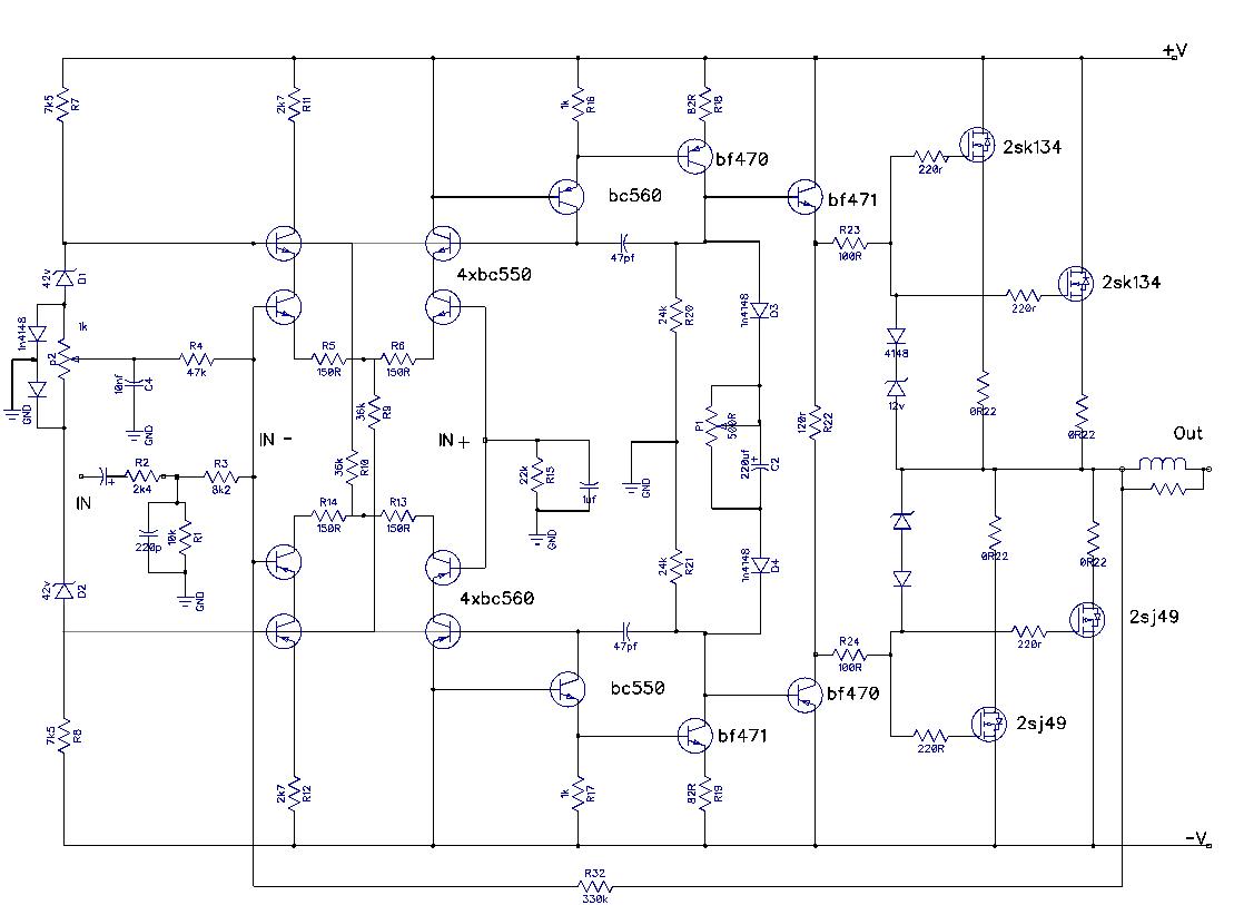

I have to apologise about the mistakes in the previous schematic.
After a deeper looking at the pcb , i finally draw a coherent schematic.
P1 sets the output bias.
I added a little circuit to set the offset: R4, C4, P2 and the two 1n4148.

Still a big error.
The loading resistors are ,of course, in the other collectors -positive input side- of the LTPs.
After readings about inverting amps, i realise the added offset setting circuit is unnecessary.
Adjusting R15 should do it.
I'll try it after replacing the LTP pairs by matched transistors.

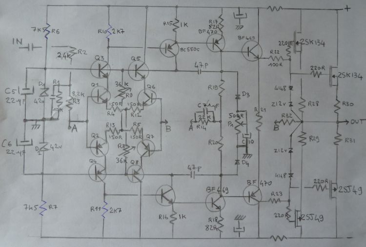

...Still are missing resistors 47R inserted in the rails for supplying the front end and relative decoupling electrolytics caps...
See the first schematic.

This amp is built on the basis of the Motorola application note AN 1308.
Plus
Front end cascoded.
Inverting.
Use of video transistors in vas and drivers.
Lateral mosfets outputs.
Vas more lightly loaded.
I am tempted to try Jfets in the input. (cascoding at 24v.) adjusting the tail current at 6ma and adjusting R10 and R11 to keep the same voltage drop on them.
R1 provide the necessary DC bias current for the inverting input,
though its value is not accurately computed as (R3 + R1)(R34)/(R3 + R1 + R34)
should be equal to R15 value (22K) so there is as little dc output offset as possible

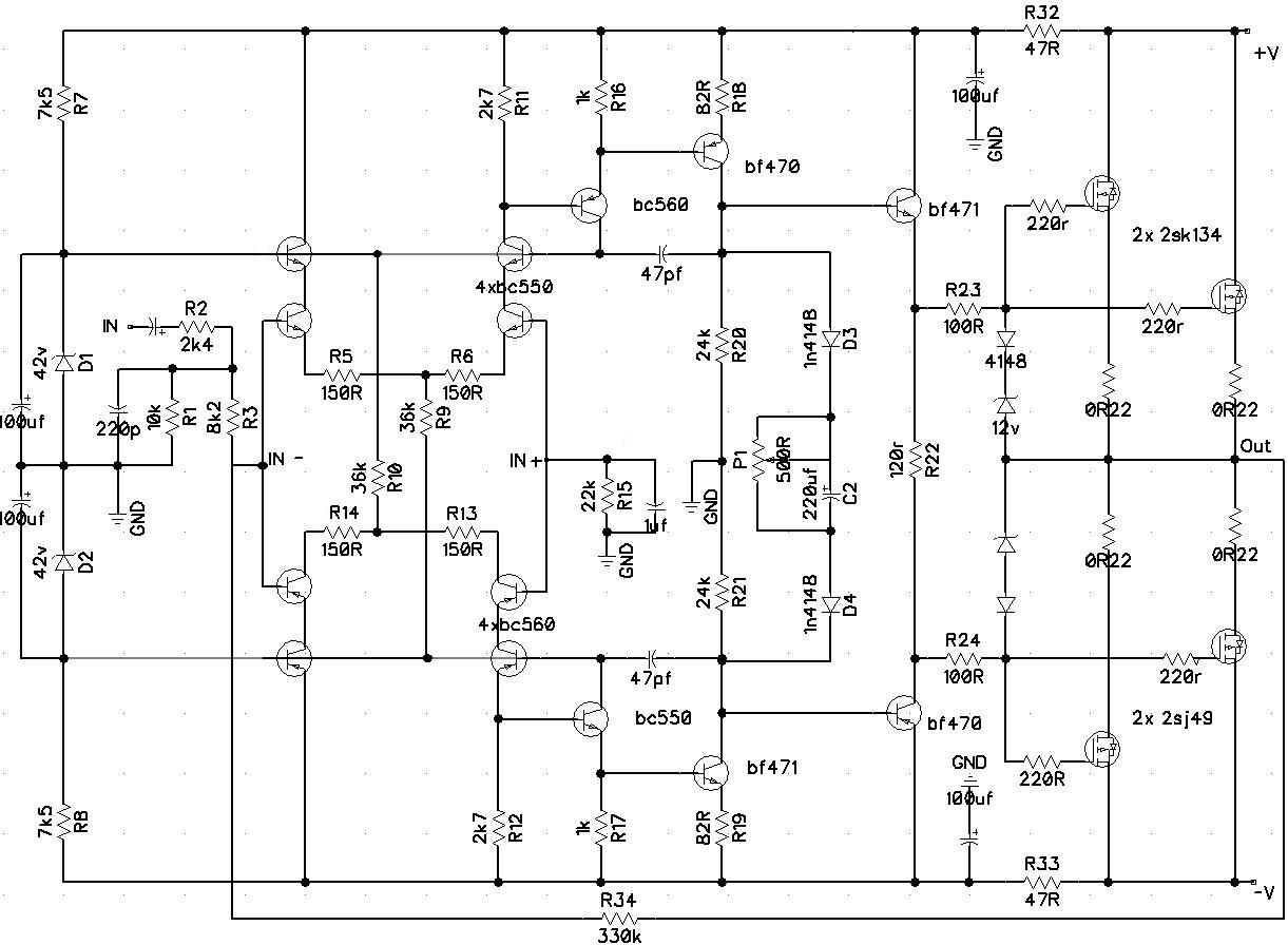

The compensation seems to be shunt if the 47pf caps are connected this way..
Compensation seems to work as there is oscillation with 33pf and none with 47pf.
I checked again the wiring.
Thanks for the formula.
So, total input resistor should aproximately equal R15.

Hi, Bobodioulasso
Yes, this is theorical value for R15, BUT dont change anything
in any value if you got this amp working properly.
As noticed by Upupa, the designer of this amp made somewhat
a "bricolage" as there s some flaws in his "design".
The most striking is that due to R1 connected to ground, the amp
has an internal DC gain of about 20, that is the dc gain is set by
(R34 + R3 + R1)/(R3+R1).
Adjusting R15 to its theorical value get the amp to going mad and
exhibit a very high output dc voltage..
For the time , this is was resulted of the first sims..
I look further a little later.
cheers,
Wahab,

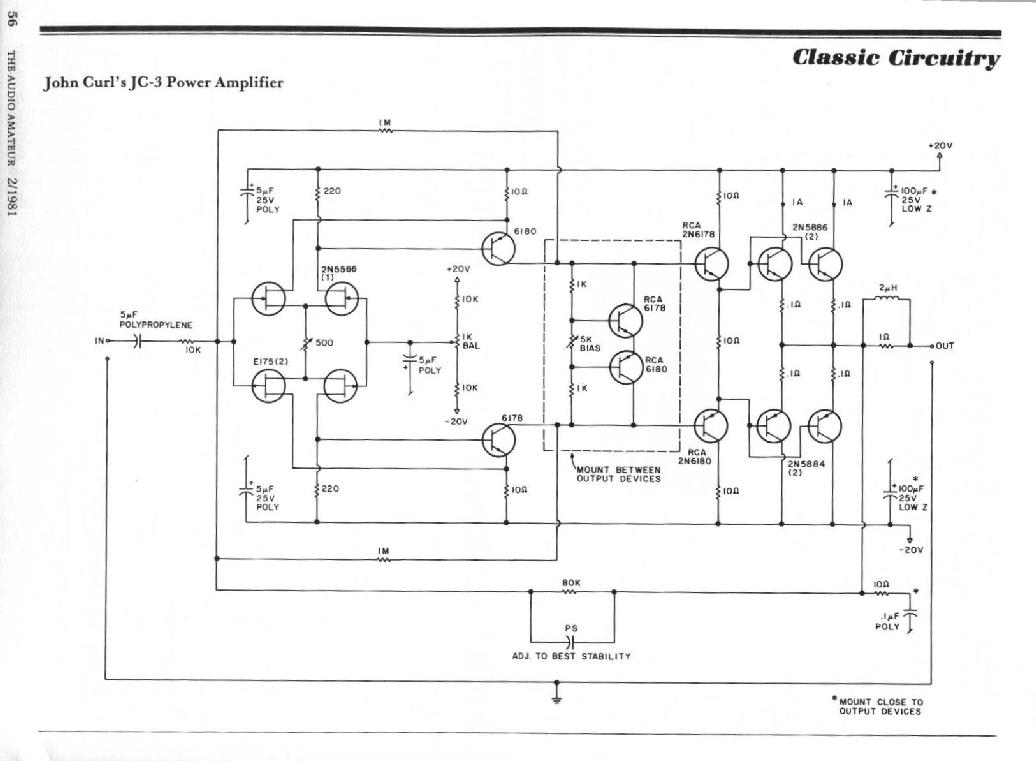

There is also a solution for offset setting as in John Curl Jc3 inverting amp.

John curl arrangement on the positive LTP input does not work here.
As it has proven to be working, I will stick with my previous little circuit for offset setting .

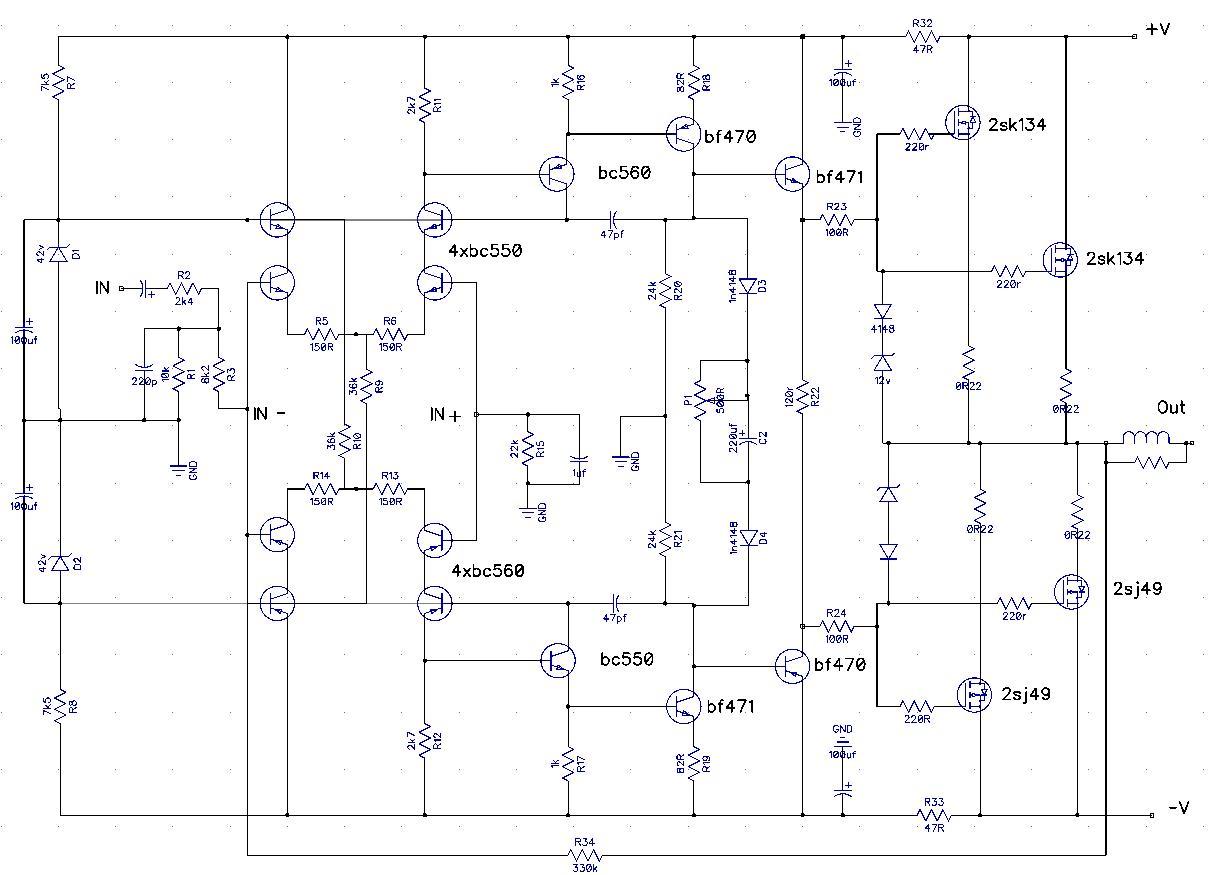

A more readable schematic.

Here some sims of THD and gain/phase response.
I simulated thd with 100PF compensation caps,
since there s instabilities with the original values.
Seems that according to the gain/phase graph,
something like 270pf should provide enough stability..
Changing the compensation to classical miller
does increase THD, but then, i didn t test with
the two 24K vas loading resistors removed.
Will take a look about it, but it will surely
not improve the numbers significantly.
Best results in matter of thd are achieved using
TMC compensation scheme provided the usual vas
collector path is connected rather to the following EF emitter,
as this unload the vas efficently...
Anyway, all in all, the existing shunt compensation
seems to be enough provided the relevant caps
are increased to more influencial values...
