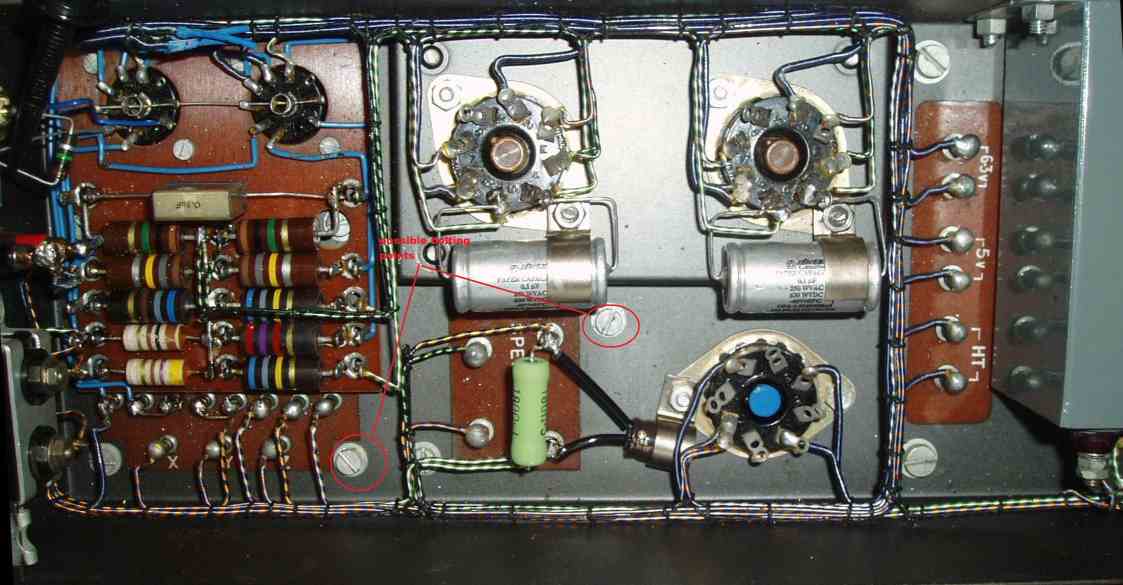

Hi Pred,
Do you have a circuit diagram? Sorry not to have a reference right now, but it is readily available. (Mine came from www.geocities, but I believe they do not exist any more.)
If so, then there are several further matters. Firstly about that hot resistor (R12). In your photos it still sits right under the choke - that will heat it up as previously said. You can either use longer leads and move it right over to the output transformer side out from underneath the choke, Or perhaps more practical, move it over to where the capacitor is at present (C5) or even closer to the rectifier socket. Get it away from right under the choke. You can instead mount the capacitor C5 straight over the tie-poins on the choke terminal board - you would have realised that those terminals are just convenient tie points; no connection to the choke inside.
Then second important point. It is frequently found that the two Hunts coupling capacitors C2 and C3 are leaking.
Thank you for the answer I will measure over the weekend (I hope). The two capacitors are not Hunts, they are Jensen PIOs so I think they should be ok.

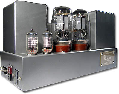

Oh, I didnt think about that, I just thought you knew 😱
I once had a pair of old renovated Quad II
One thing I notice is the painting, it looks brighter, somewhat fresh
And I notice something about the name plate
And I remember the metal work as being a bit more accurate
I look especially at edges on trafo potting
And those small screwing plates fore mounting bottom plate, did they use thos back then
I could be wrong tho
But theres a series number on each amp, so it should be relatively easy

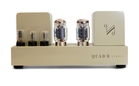

Ahh, seems the later "copy" looks quite a lot more different
Quad - Classic Series - Valve Amps - Quad II-eighty
And the original
d.c.~daylight ltd. — QUAD II Buying —
But looking like that they would be very rare, or renovated
Still, nameplates look slightly different from those I can find, they are all with golden bronze "look", and painted on their backside, and not see through
Though, nameplates could be renovated too

Hello all,
As you helped a lot I would feel embarrassed not to do a thing. So last night although tired from chasing kids all day, changing dippers I took some time to measure 🙂 I was more cautious than ever in my life, even one hand at the back 🙂
I found 336 volts on HT and 330 after the choke, so bang on. Ef86 grids are a bit off they are like on 103 and other 91. I think it is since they are not matched, Mullards are more older then Valvos. Before the capacitor on the anode of EF86 I have 121 and 110, not bad. Cathode resistor on KT66 is at 23.3 V a bit of so I have like 130mA for two tubes. I would guess that the 180Ohm resistor is getting hot and more resistive.
What I am worried about is blazingly hot 180Ohm resistor and for the moment I do not have a good idea where to fit it. I think that the choke is hot just by a chimney effect from this resistor since After 10-20mins it is so hot you can not touch it. Do you have some pics of your setups ? I took some and will try to prepare something and reread your suggestions to come up with the idea.
Second I measure 0.3V (around 250mV) on the grids of the KT66, is this normal? I know that the resistors are not going directly to ground so this is why I ask.
Finally resistors are off by 10%-20% I do not like it but will change when I have more time and find some good replacements.

I think those amps MAY have been serviced by Keith Snook. He does the same thing with the original name plates (rubbing the paint off the back) as shown at the bottom of this page:
QUAD II Valve Power Amplifier Modernising and Modifying
I can't tell from your photo but it looks like the green resistor under the choke is a 5W Kiwame job? In which case it is good quality, but might benefit from some kind of addition heatsinking. Failing that a heatsinked 180-Ohm wirewound resistor would be worth fitting for peace of mind:

Pred,
Some of your questions were answered in my posts #36 and #39, and others. As said, 6L6GCs could be used with advantage.
I looked at the 'DC - daylight" site. OK, the guy does say "modernising and modifying" but I prefer to just restore (refurbish, whatever). Using a Quad II chassis and components in another circuit no longer constitutes a "Quad II". If the wiring is quite different ... well, one can argue, I suppose. With due respect, the wiring of the worthy author of the above site was untidy. Did it make a difference to the sound - probably not. Did it make a difference to the character - definitely. I would not purchase his Quads.
But enough of that. The arguable R12-C5. Heavy weather is often made of 'the smallest dc influencing low frequency response (of the OPT); or effect of tube unbalance. May we just take a look at the original specs (1955 Quad booklet page 21): "Valve mismatching up to 25% (introducing 2nd harmonic) not to cause distortion to exceed 0.18%. Total distortion at 25 c/s not to exceed 0.25%.".
I have found that among some 30 6L6GCs or WXTs, the spread in plate current at 75mA was no more than 8%. Among EH 6L6GCs it was down to
6% and among 12 Tung-Sol 6L6GC-STRs, 5%.
I use a quite higher C5-value not for stability reasons. At maximum output the Ia will increase, even though one has class-A conditions. Under signal conditions a high enough C5 will simulate fixed bias conditions; tube data shows the improvement. That is why I use 2200µF (35V) for C5. (That is the one change I will confess to.)
Regarding R12 it was mentioned that you could move it to where C5 is situated at present, and mount C5 across the present tie tags. Keep R12 in the air; I use a 10W type which distribute heat somewhat more evenly because of its size. To repeat: Keep R12 away from C5 and from under the choke.

Can't sleep, I'll be regretting it tomorrow at work 🙁
was happy reading your replies. Well with GZ34 it will come to 24W a lot close to maximum dissipation, now I am not sure if I even should try it with my GEC tubes?
I was asking about some NOS 6l6wgb since they are cheaper (I guess guitar people can not use them). Did you notice much of a sound change with 6l6gc?
I saw some 180 thick film resistors that look like TO220 package. I thought it would be not bad to screw them to the chassis using rectifier socket, but I guess your examples are easier to implement... I see that resistors are not that expensive so I will have to wait some time to collect enough of "things" so shipping will not hurt. I will listen for the moment hour or so.
My worry about 300mV at KT66 grids is no more. I read dc-daylight site and he writes it is perfectly ok. So I will leave it for the moment, find some nice resistors and order them to replace all of them in the amp, just to feel more comfortable.

R12 resistor type
After looking into my amp I am now convinced that the R12 is responsible for the choke high temperature. I want to change it but am not so sure on how to approach this.
What I like a lot are thick metal film resistors like these ones, and are not sooo expencive, 12$ a piece.
Arcol NPR2 TO-221
and I look for the place to bolt them since they need heat sinking. I indetified two transformer screws that could be used for the job, like in my picture. What do you think about them?
I must add I like metalic ones wirewound but they seem heavy to be hanging from the leads for a long time. What types you guys use? Can someone send some photos just to have an idea?
Pred
Pred,
Arcol NPR2 TO-221
Pred
Hi Pred,
Very nice resistors indeed! We down here in RSA are not priviledged to have that kind of thing stocked locally. But it is unnecessarily sofisticated. I have used ww resistors similar to the type mounted there at present (a 10W version). There is also the possibility that a 25W Arcol might simply be used without heatsink, as the dissipation is about 3W only. Perhaps someone else can advise whether you could mount the Arcol without heatsink in this case.
If you do make that move, the best place could be the rectifier tube socket screw where C5 is situated at present. The contact area will be limited because of the limited socket tab area, but as said above. The screw (one of two) holding down the choke again brings heat a little closer to the choke, but not as seriously as before.
Hanging a 10W resistor by the leads is no problem. If you are worried, perhaps wind the leads a turn or so round the terminal before soldering. (And that little C5 shown in your photo, is rather scrawny. Try get a larger type, higher capacitance as explained before.
