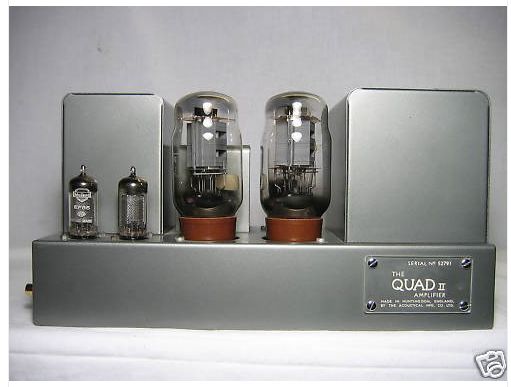

Hello all,
I recently become the owner of Quad II. I was reading most of the threads on this topic but still had some questions to ask. I did not want to open a new one so I decided this is the best to what I want to ask.
My quads are with all original tubes in great condition (checked on the tester, all 4 GEC tubes are around 60mA and Mullard GZ32 and EF86 are all in good shape).
But:
As someone noted after two hours of listening my amps (specially the choke) are very hot. I can touch the choke but I would say it is like 50°C. Also I feel that the power transformer is just hot (much less, I would say 45°C) but from the tubes near by, since this side is hotter then the other one.
Since there is no power switch I hope the amps were designed to work with these temperatures (hopefully even after 50 years) even for a prolongued amount of time. Do you have the same experinece? Is someone listening to them for more then 2 hours? Will change to GZ32 and 6l6 types without coke bottle shape change the temperature much?
Thank you in advance,

Hello,
thank you both on the answers. Well I am versed in electronics so I will remeasure the amp over the weekend (if I find time, 2 small children 🙂 ) and report to you. I want to change this awful rifa with some mkp that I have around.
I think it is the GEC valves and GZ32 (I like the looks of this tube!). The guy that I bought the amp from did some mods, well updates of the components. You can see on the picture that coupling caps are Jensen PIOs and that the cathode resistor is a 5W at least, I would say more like 7W. Is it far away enough? The capacitors are cerafines, I do not know what is the value. For the electrolytic he told me that he reformed them with slow rise of voltage, by 50V every hour. Resistors, except two are changed but this should not be a reason. I will see but I feel not comfortable with the heat. The amps are on the top of my hi fi shelf so they have plenty of space around and above them. The amp runs from 230V mains and I plugged the thinggy into 230-250 tap.
I do not feel I need more power, this is Switzerland, neighbours get disturbed easy 🙂 What is your opinion on JJ GZ34, is it reliable there are some guys on ebay selling them cheap and I would like to try. If I see the heat dropping then I would maybe try a pair of 6L6GC just to see the effect and if all is good to go and find some nos tubes, and sell GEC for a fortune (anybody interested 🙂 )

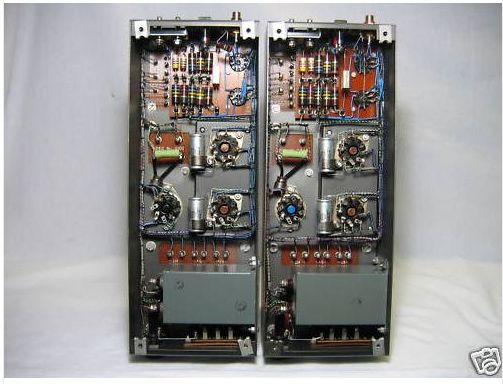

Here is the photo of the amp and any comment would be helpfull
Pred

Hi Pred,
Do you have a circuit diagram? Sorry not to have a reference right now, but it is readily available. (Mine came from www.geocities, but I believe they do not exist any more.)
If so, then there are several further matters. Firstly about that hot resistor (R12). In your photos it still sits right under the choke - that will heat it up as previously said. You can either use longer leads and move it right over to the output transformer side out from underneath the choke, Or perhaps more practical, move it over to where the capacitor is at present (C5) or even closer to the rectifier socket. Get it away from right under the choke. You can instead mount the capacitor C5 straight over the tie-poins on the choke terminal board - you would have realised that those terminals are just convenient tie points; no connection to the choke inside.
Then second important point. It is frequently found that the two Hunts coupling capacitors C2 and C3 are leaking. This is measured easiest by checking that the KT66 bais voltage is not significantly higher than 26V. It is difficult to measure the grid dc accurately even with a 10meg input digital multimeter. Easiest is to again measure the voltage over R12 with C2 and C3 connected, and then without them connected - the bias reading should be the same as you will guess. Obviously, if there is a difference, C2 and C3 will need replacement. (And here - though I may step on toes - please dispense with spending a whole lot on boutique capacitors. Polyester/polypropilene is quite satisfactory.)
For an initial test on heat generated: Take out all the tubes and leave the amps running for some two hours. Then replace all but the GZ32, and test again. Over both runs they should remain cool - luke-warm transformers. You might now attend to C2, C3. It would have been more direct to do the previous voltage measurements over R12, but you can also disconnect C2,C3 from the KT66 grids (pins 5). Running the amps that way; if they are cooler, would also indicate over-current in the KT66s as a result of leaking C2, C3s. (If you measue KT66 grid voltages, do note that there is about +0,6V on G1s - the grid resistors R7, R8, R9 are not going to common but shares some potential from the EF86 cathodes network.)
Then, should you replace C2, C3, it will probably be with ones without a metal sheath clamped to common. Those metal sheathes place about 18pF capacitiy from each G1 to common. Leaving that out is not serious, but if you have access to a 'scope and square wave generator, you will notice a slight overshoot on the leading edges. A rather better way to correct for the mentioned 18pF is not to replace them, but to do a phase advance correction over R11 - one places a 1nF - 1,2nF capacitor over R11. The results should be visible on the 'scope.
While this is already long: I mentioned that I often left the capacitors C4-C6 alone. They were still good, and it can be a schlepp to mount other types neatly. If you are of an industrious nature, you can replace the caps inside the tin and retain the original appearence. C4-C6 is a round double-C inside that square tin. With a hot soldering iron it is not much of a problem to unsolder/pry open the bottom of the tin - it comes off. The cap inside will be secured by some pitch at the bottom; not too much of a job to get it out and get the tin clean - I fear the lettering will suffer. Then one gets good enough modern smaller Cs to enable one to mount them back inside the tin. A sophisticated double C I used (expensive) was the 50µF + 50µF 500V made by JJ. With some patience and not too much heat (you say you solder for a profession!) the original appearance can be restored and the 'tin' resprayed 'machinery grey'.
As an engineer I appreciate the advantage of silicon rectifiers. But they also provide instantaneous h.t., and cathode stripping of the tubes is a practical danger - apart from having to deal with a peak initial h.t. surge.
To plead moderation: If you consult the internet, folks come along with wonderous 'tweaks', almost changing the design. Grid stoppers, fancy wire, fancy capacitors, twin RCs for the KT66 cathodes, goodnes knows whatever. I have restored my modest few, and I can assure you that none of such tweaks make a difference. One keeps the amp as close as possible to the original, which is mercifully possible in this case. If one wants a more fancy amplifier, one goes and buys something else. Peter Walker was not stupid, and used the design he did for a reason.
Sorry for a rather lengthy missive; these from my experience. (And I did find relocating R12 important!)
