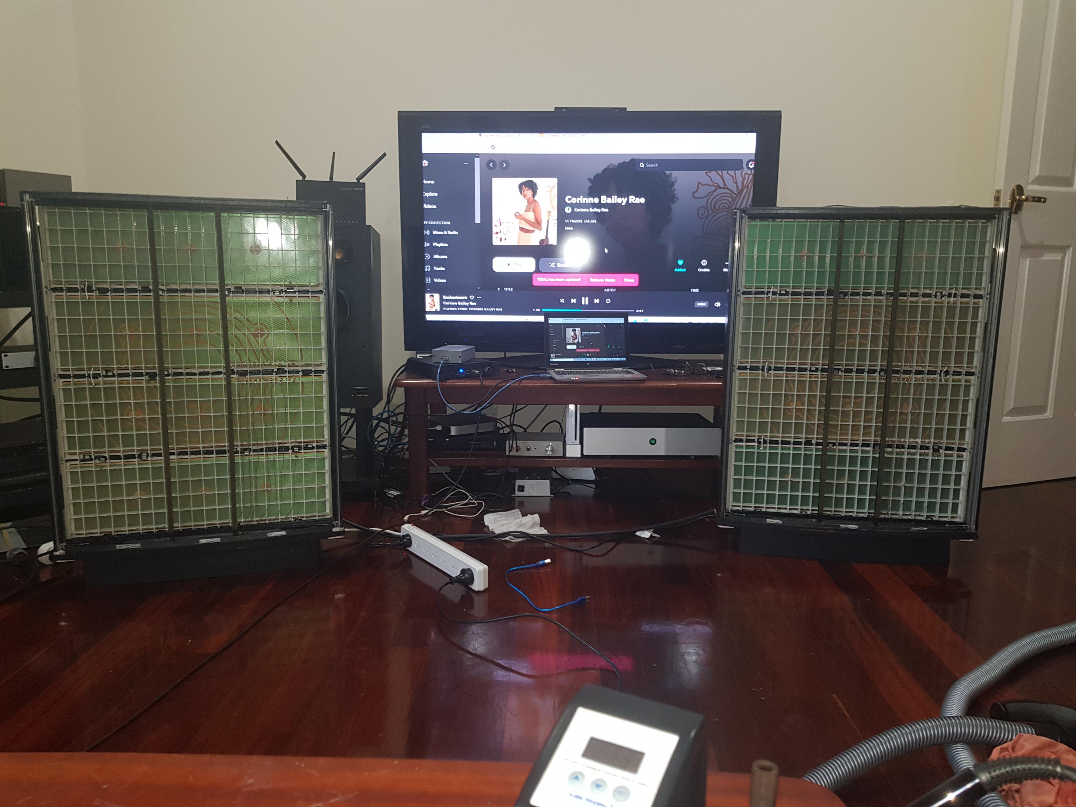

Progress
Finally got them going and they sound great.

I went and bought that $350 pair. They had the most sun-bleached grille cloth I've ever seen, and the clamp boards in both speakers were replaced, and there was the obvious signs of the previous clamp boards catching fire. There was a significant blast radius under the hood. They are all fixed up and working well now. Here they are in my shop with some Curly Maple wooden trim pieces I had made at a CNC shop.

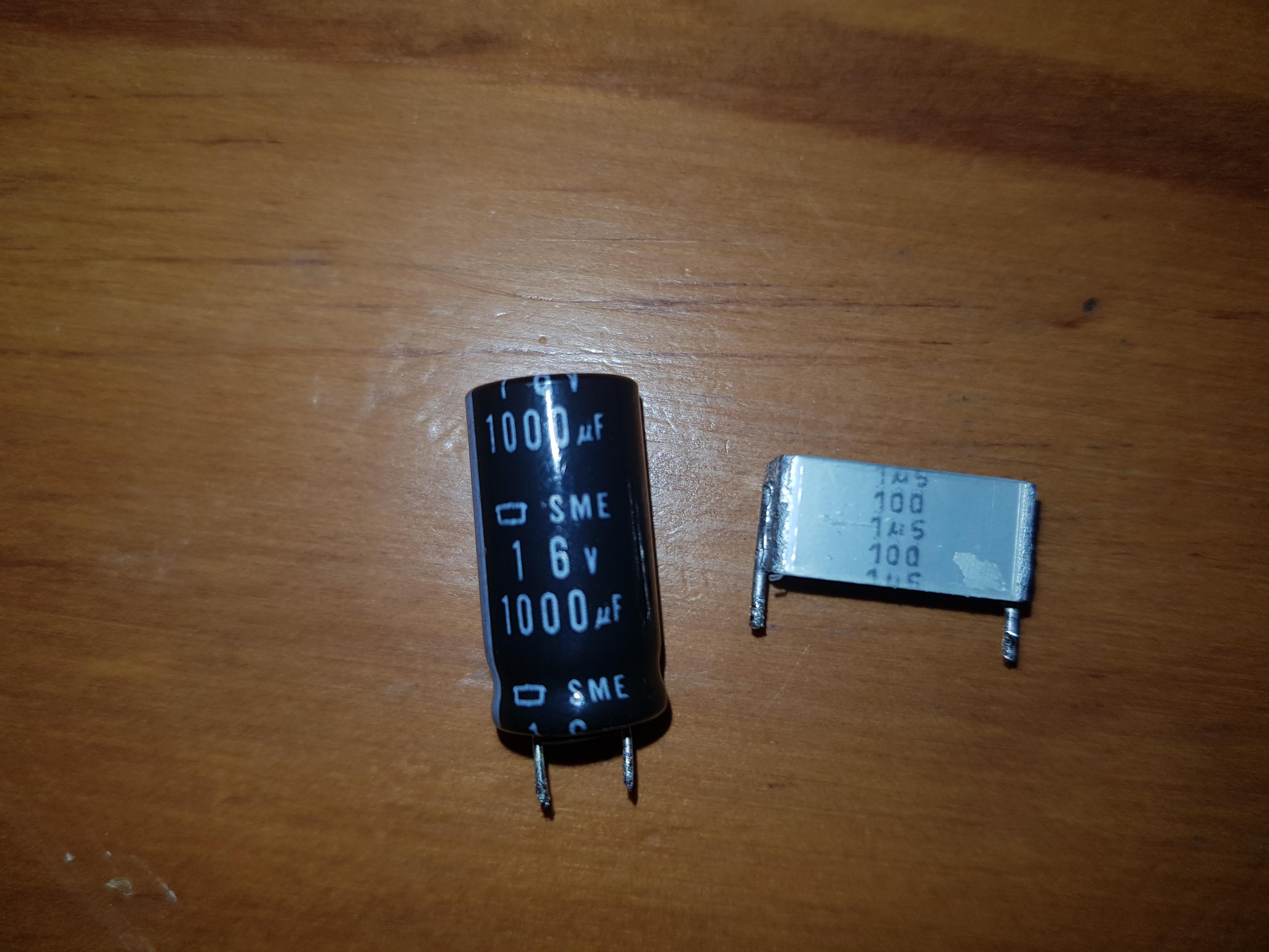

Well, I finished the second set of panels and all seemed good till I heard distortion from the tweeter panels of the second speaker. I examined the tweeter panels and noticed that a couple of the side edges weren't perfectly glued. Re-glued and re-diaphragmed and went on holday for 2 weeks. Got back and wired them up but the distortion was still there.
I then swapped out the entire set of panels to the working speaker and they play well. Checked with Rob and I opened the defective speaker clamp board. Looks like the previous owner had tried to do the same as the screws were partially undone. I had bought a pair of 1000uf/25V Panasonics from Mouser on my last order but since the caps looked fine I thought I would change them later. I have decided to change out C27 and C14 as well since its opened up.
I found one of Sheldons posts about adding an 8.2uf polyprop cap to input capacitor and have ordered a pair as well. Postage is a killer but I have no choice. Is there an affordable and practical option to 220uf input cap?
Suggestions on other possible causes for this tweeter distortion?

Check the 1.5uf cap in the clamp circuit. you can remove it and give a listen. The triac could be bad.

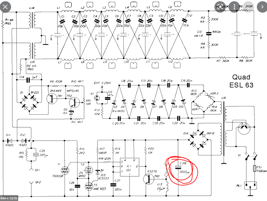

that 1000uF capacitor can make the clamp circuit hyper-sensitive and fire all the time. It's a good thing to replace. Here in the states, the DC supply runs at about 16v across that capacitor, and it's a 16v rated cap, so it's pretty heavily stressed. I swap them out with 25V 105C long life units just as a matter of course.
The cap I was referring to above is the 1.5 uf cap (C14 in the schematic just above) which is across the input transformers. I've had two of those be bad and cause distortion at normal or slightly elevated listening volumes. It's a weird looking square guy on the clamp board.

I finally received the caps I ordered. I changed C14, C28 and C27. problem solved and it sounds quite a bit better than the other speaker with the originals. I didnt add the 6.8uf cap across C25 because I stupidly ordered a 460v Vishay wich is a bit big and might need some planning. Maybe a 100v or so would have been easier.
Thanks for the advice everyone.
