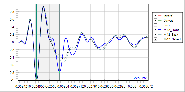

Lets assume that Mylar is somewhat reflective because this is what your measurements suggests. How would this translate to an ESL? When the dustcover is very close to the transducer then for most frequencies there is too little time delay for the reflection to mess up. It is like driving a single piece of Mylar with increased mass. So while the measurements show reflections the effect may be less worse in reality. Depending on exact geometry. There is high frequency hash in the decay plot of the quad63. Maybe part of it is due to reflection, I dont know, only by measurig a naked quad versus dustcovered quad we could see. So it is useful to discover that the Mylar does reflect, something I didnt expect.

Use Audacity to subtract one measurement from the other. This will give a delta signal that can be analyzed, and can be listenable.

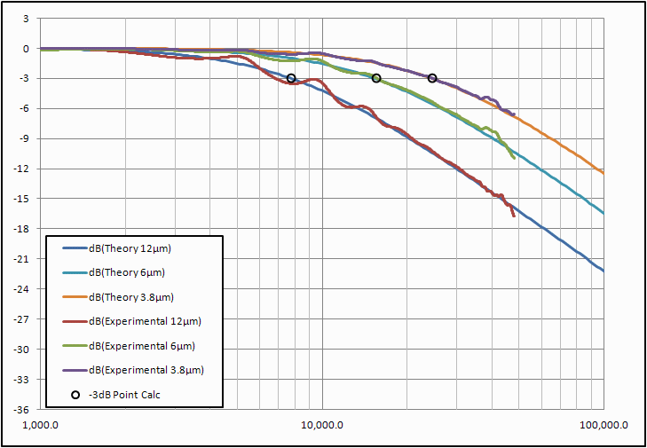

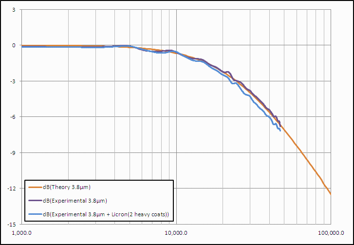

This is a great technique. I have used it in the past to measure the transmission of sound thru diaphragms. You can also use it to evaluate the mass of different conductive coatings. For my work I used an XT25 tweeter since it has flat response from 1kHz extending out to 40kHz. I measured once without a diaphragm, and then normalized all subsequent measurements with diaphragms in place by this reference response. Transmission of sound thru a diaphragm results in a 1st order LP response with the roll-off point falling with increased diaphragm mass/thickness.

Intuitively one would think that whatever gets reflected back must be the leftovers from what was transmitted thru, and indeed this is the case. The frequency content of the reflection shows a 1st order HP response with roll-off point matching the transmission response. It is a little more difficult to measure, but can be done by selective windowing of the measured impulse response to capture just the reflection of interest. All of this HF behavior and much more complicated combinations with stators, damping mesh, etc can easily be modeled using the techniques published in this AES paper:

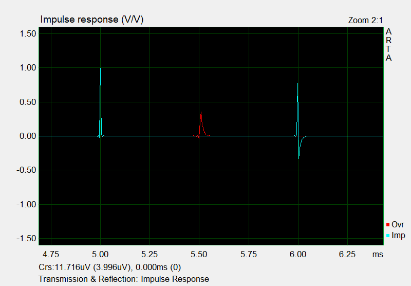

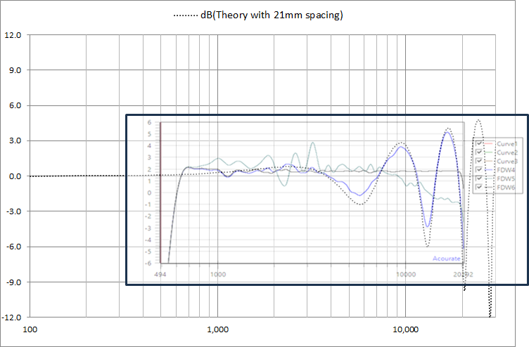

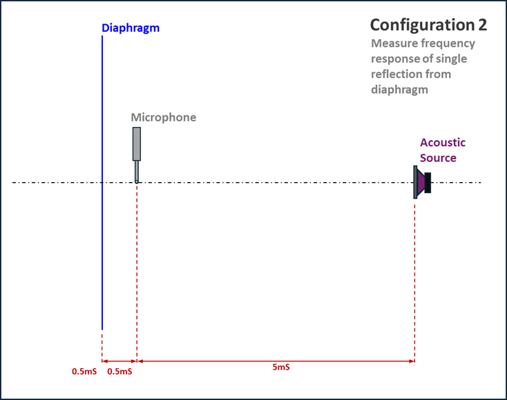

To illustrate transmission and reflection from a diaphragm, lets take a look at a slightly simplified measurement setup, starting with what Daihedz has been using in Post#11, but remove the reflector plate.
Here are the resulting theoretical frequency responses for transmission and reflection for a 6µm diaphragm analyzed at 192kHz.

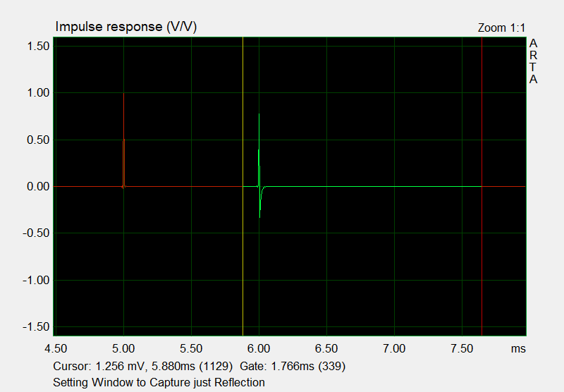

For the reflection case, here is the impulse response with windowing applied to capture just the reflection.
To compare the size/shape of the reflection and transmission impulses, I shifted the transmission impulse in time by 0.5mS for a better overlay with the reflection. You can see that indeed the reflection and transmission look to sum to the impulse test signal. Also note that the reflection looks to have higher magnitude than the transmission, but this is not the case as can easily be seen from the frequency response comparison. You have to be careful when trying to make judgments based on looking just at the impulse response peak magnitude…especially if using 48kHz sampling rate where the exact peak may not be captured in the impulse response. Note that this does not affect the frequency response, it just moves the energy elsewhere in the impulse pre/post ringing (ie Gibbes effect).

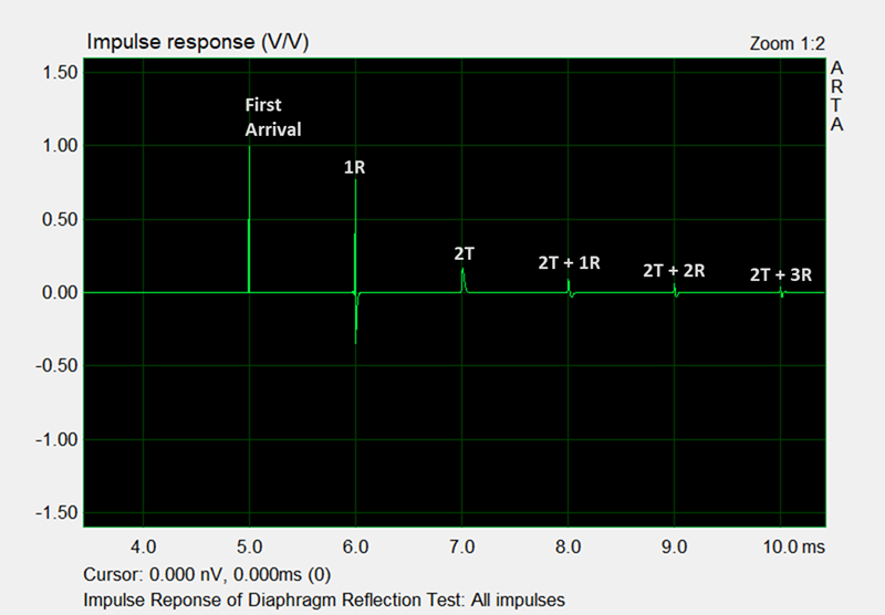

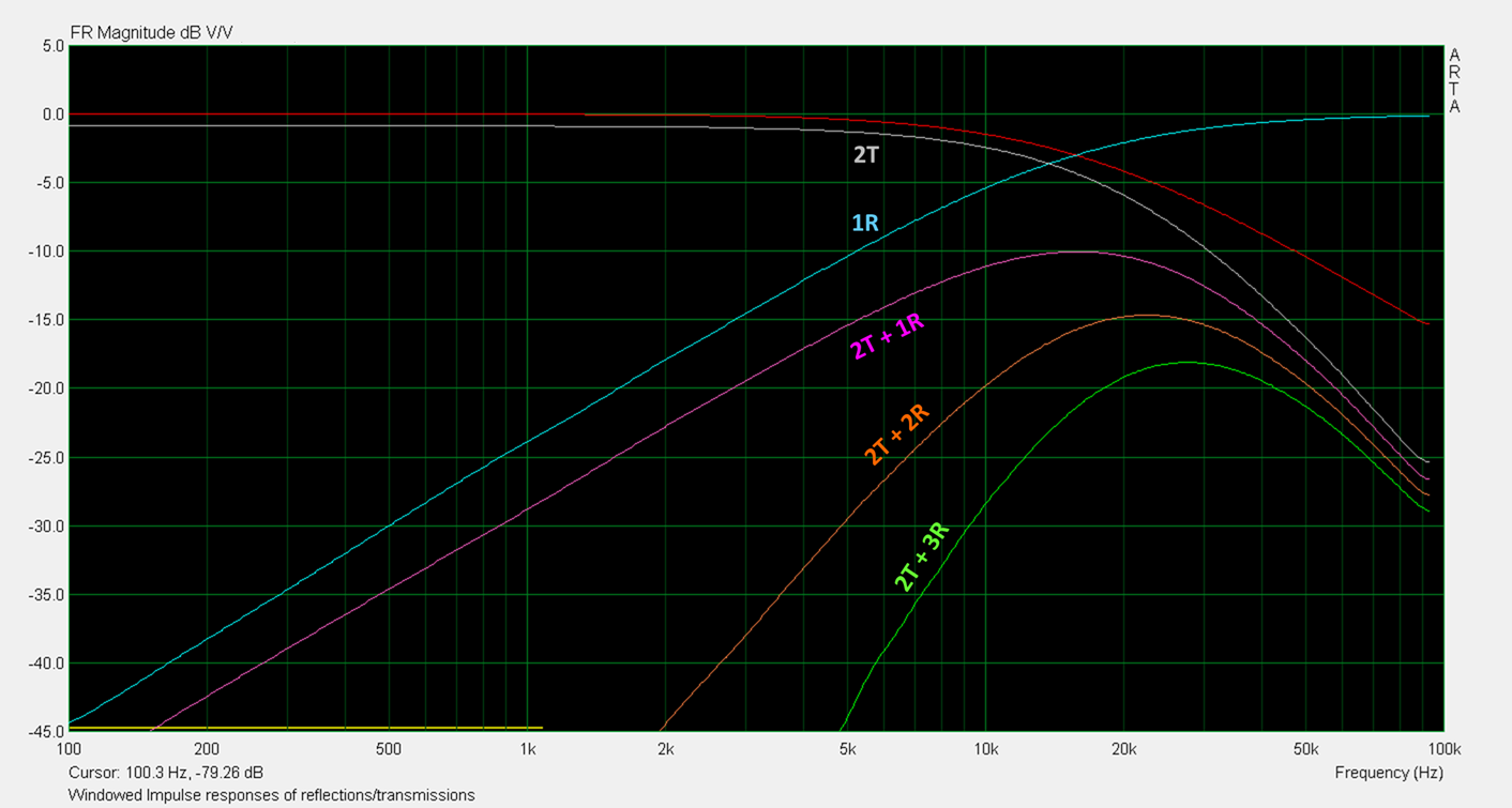

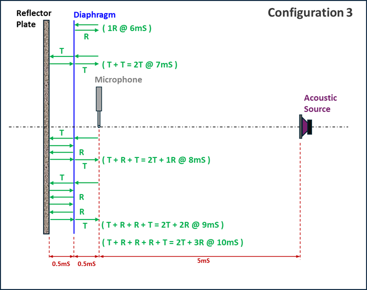

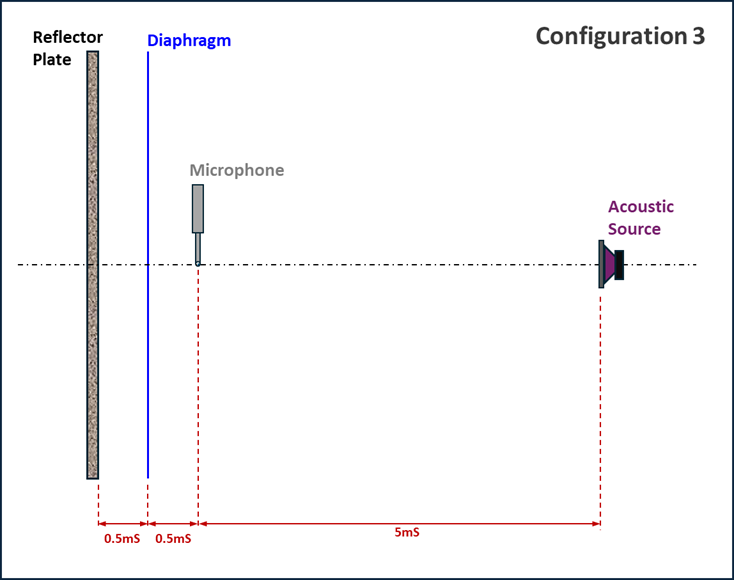

Returning to the measurement configuration Daihedz has been using. You can see that there will be multiple reflections arriving at the microphone after the initial impulse separated by 1mS. Each one will have traveled a unique path combination of reflections and transmissions which I tried to illustrate.
Here is the resulting impulse and frequency response for the first 5 reflections.
The 2nd and subsequent reflections have transmitted twice thru the diaphragm so the HF roll of is now 12dB/oct instead of 6dB/oct as for the single transmission example in the previous post.
Subsequent reflections from the diaphragm increase the LF roll-off slope by 6dB/oct for each additional diaphragm reflection.

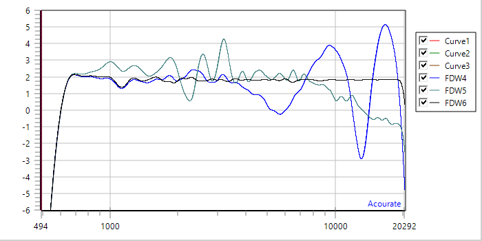

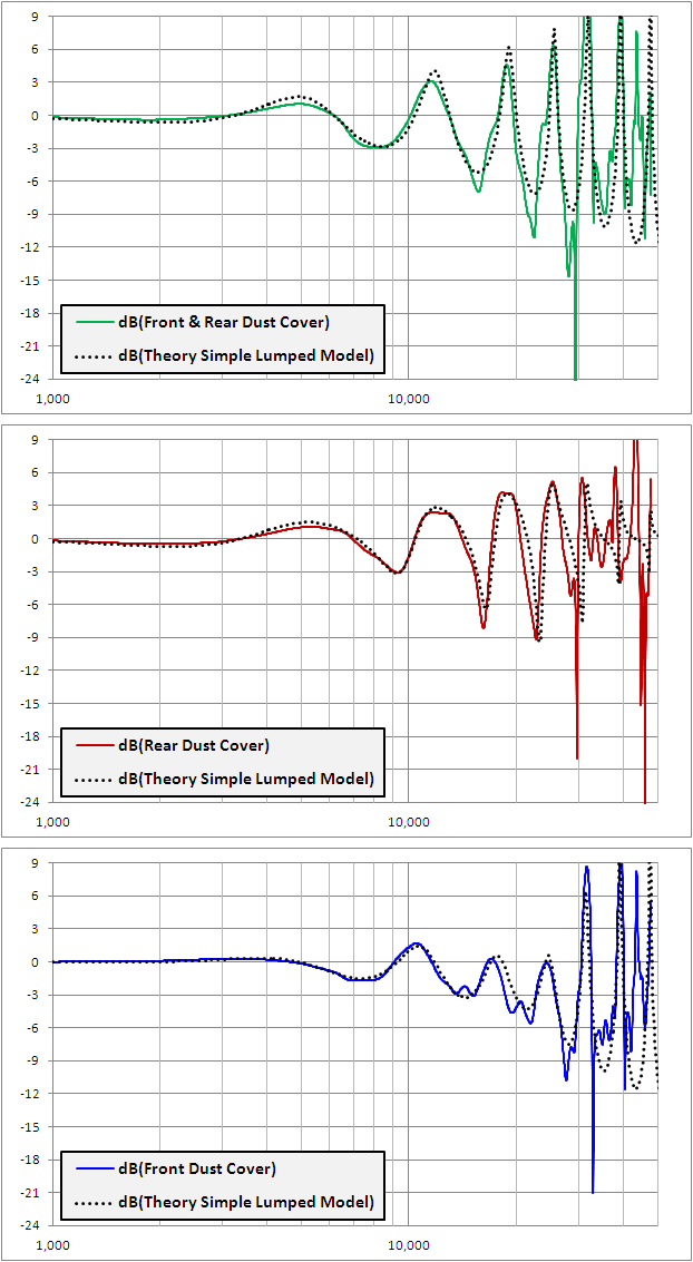

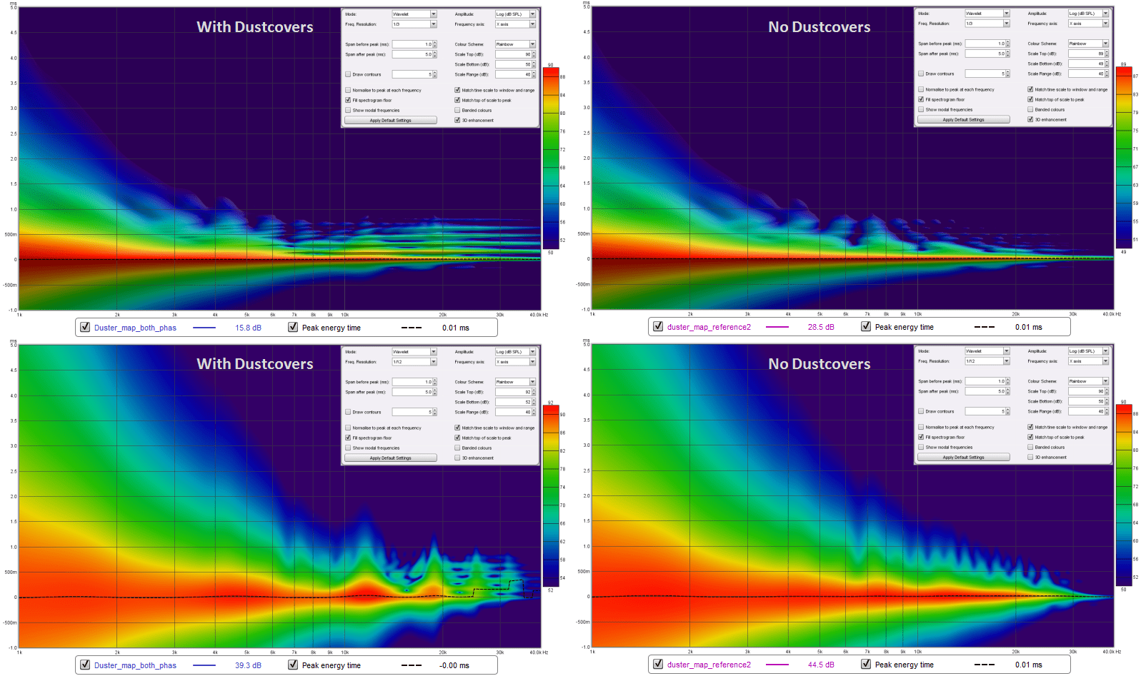

Not sure if you had seen it already, but I posted a comparison of with vs without dust covers in some other threads.There is high frequency hash in the decay plot of the quad63. Maybe part of it is due to reflection, I dont know, only by measurig a naked quad versus dustcovered quad we could see.
However this was for my personal diy ESL with 3µm dustcovers spaced about an inch from the stators, not an ESL63.
https://www.diyaudio.com/community/threads/all-acoustat-panels-can-give.282031/post-4551994
https://www.diyaudio.com/community/threads/esl-high-frequency-chaotic-modes.382598/post-6939879
The spacing between the dustcovers and the stators does shift the reflections in time(and peaks/valleys in frequency), but the general response behavior will be the same. I had asked in another thread if somebody could provide me the exact spacing of the dustcovers from the stators, then I could run the model to see the expected behavior for the ESL63 geometry. It was also suggested to build an FIR filter that could be used to "add" dustcovers in DSP to more easily A/B the effect.
Anybody know the dustcover spacing for the ESL63?
