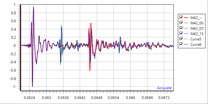

While tweaking a method to anchor the fixing/tensioning strings at the four corners of the film, I made a set of quick and dirty measurements with the Mylar 4.2 C film under different tensions.
On my actual iteration of the test frame, the film gets hold in place and eventually also tensionned crosswise diagonally, and the the frame allows for different amounts of tensioning. The tension is generated simply by adding the weight of a 1.5l PET bottle weighting either 500g or 1600g onto each of both of the diagonal tensioning string loops. If tension is applied, then a seemingly near uniformly stretched aera in the center region of the film gets built up.
Red: No Mylar film
Green: Mylar 4.2 fitted, relaxed and nearly without any diagonal tension
Brown (hidden by and as same as Blue): Diagonal tensioning with 500g weight
Blue (hiding Brown): Diagonal tensisoning with 1600g weight ... and inconsistently labeled, should be labeled M42_16 instead of M42_15
These are preliminary and partial results only. E.g. I did not yet assess the basic resonance frequencies of the films at the different tensions. Anyway, in terms of the 1ms artefact the result shows that it seems to play practically no role wheter the film is relaxed or tensioned. Furthermore, the two different tensioning forces show exactly the same artefacts at 1ms (f_res will be different).
What does this mean now? E.g. there is this the nice little story/idea/concept that a dust protective film will quasi compliantly move along with the sound waves, quasi surfing on top of the wave. And therefore a dust protective film might have no sonic impact. At least with this Mylar 4.2 C this is not true. Even the completely relaxed film shows a strong artefact which most probably will correspond to a reflection. And in this very measurement series, the relaxed film's artefact amplitude is even greater that the one when the film got tensionned. Aha.
There are two other aspects on this graph worth pointing to: The green graph's 1ms artefact peaks a bit before the brown/blue artefact. This is because while relaxed, the film was bending with a small convexity toward the mic. The other goodie is the fact that naked red 2ms reflex shows a higher amplitude than the green, brown and blue one. Logically: The reflected energy by the film will no more reach the reflecting plane at the back of the film.

what do You mean by ´unwanted artefacts´? As a quite soft plastic the internal damping of Mylar is already good.
Almost all -if not all- artefacts we see in masurement are due to the Mylar sheet beeing fixed and beeing stretched tight.
Which leads to a pronounced base resonance and hash from boundary reflections.
Those are afaik by far dominant.
What else do You suppose to see?
If You reduce for example the tension to almost nil, the base resonance vanishes.
If You reduce the hard clamping at the boundary fixation, You can reduce the hash from reflections.

My problem is that for me it is not easy to extract the most important conclusion from the shown results.
What is the conclusion from your tests, exactly, regards the desireablilty or not of dust covers?
The "problem", if we d'like keep on speaking of problems, is the fact that you are slightly too fast.
These already published graphs stem from preliminary tests, as said, intended to set up and refine the testbed for a series of "real" comparative tests for different films later on. And it might be that by comparing then the properties of all the film brands and types, that a rank list from best to worst might emerge from the tests.
I published these preliminary tests in the hope to get some feedback/ideas for constructive details and/or for further variants of testing all these film samples. So for me, this part of the whole story still belongs to the brainstorming/construtive tweaking phase.
I hope my tests in the end will help to better understand the physical properties and the best practice uses for different films. That's all. For dust protecion as an example. We all know all the relevant properties of titanium, aluminium, magnesium, beryllium for use in our tweeters. How much then do we really know about the physical and acoustic properties of different films variants?
