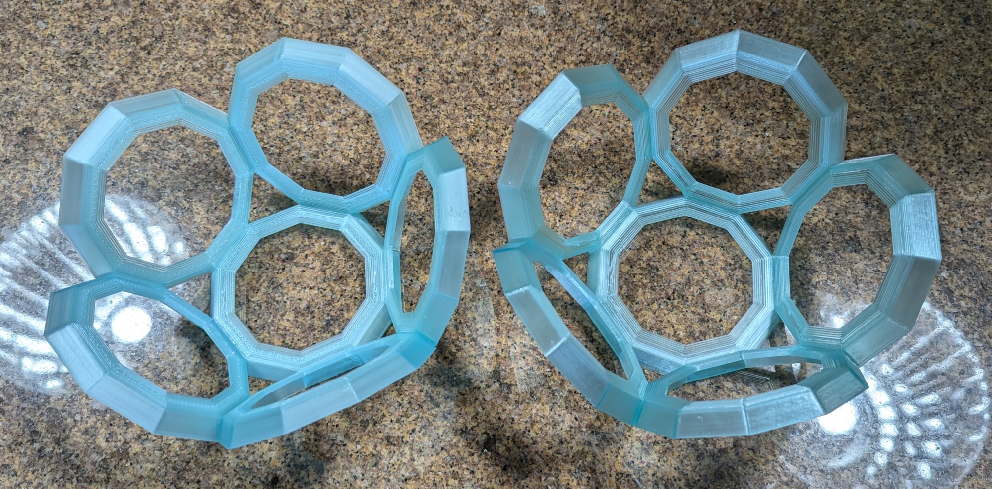

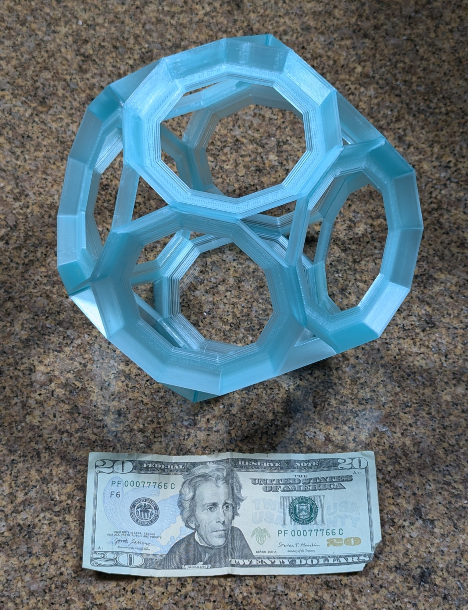

3D printing can be used to make grids to hold stators and diaphragms, and even structural elements of electrostatic speakers. Last August I started a thread about making a "spherical" ESL by printing the pieces of a truncated dodecahedron. Life and other projects got in the way of that project, but I foresee it coming back to the front burner soon. I printed some scaled down test pieces to see if the printer could print the angles accurately enough and yes, it did:
The prints are PETG, and they are solvent welded together using ethyl acetate while held in a printed jig that ensures accurate alignment. My intent is to make each of the decagonal parts about 250 mm across. I'm still not sure what I'll use for stators- I was looking for a low cost source of perforated steel or aluminum, but hey, maybe I'll print them with embedded wires!
Like almost all my projects, I will be blog posting on everything that does and doesn't work, and sharing CAD and STL files in case anyone wants to try it for themselves.
