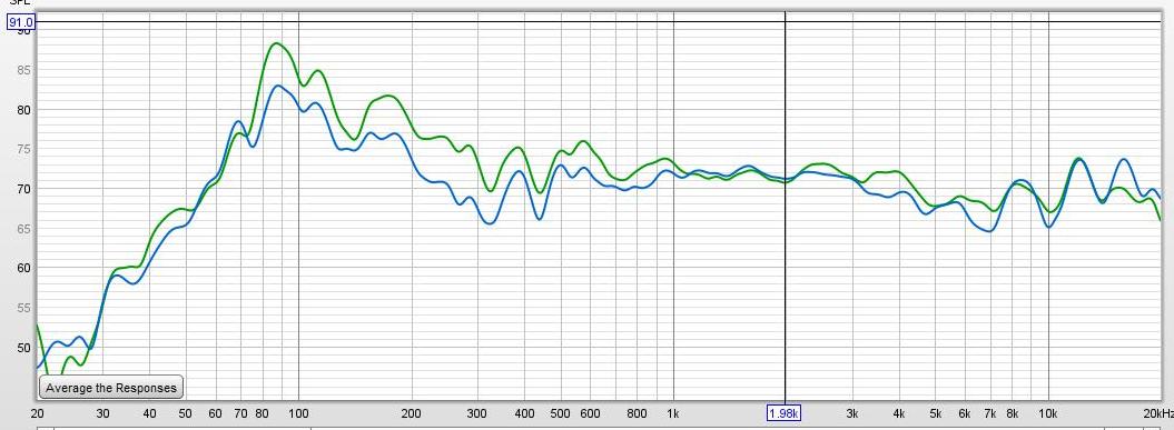

I purchased my rebuilt Quads some months back. Unfortunately, I feel that one of the speakers (left speaker) has a crossover/phase issue. It is about 2.5dB down compared to the other speaker. Also, I have to use them with one speaker connected electrically out out of phase in order to sound in-phase!
According to the seller they have had new OTEC bass and treble panels, 2 x RBT57 EHT boards, 2 x CLP57 clamp boards and 2 x transformer component update.

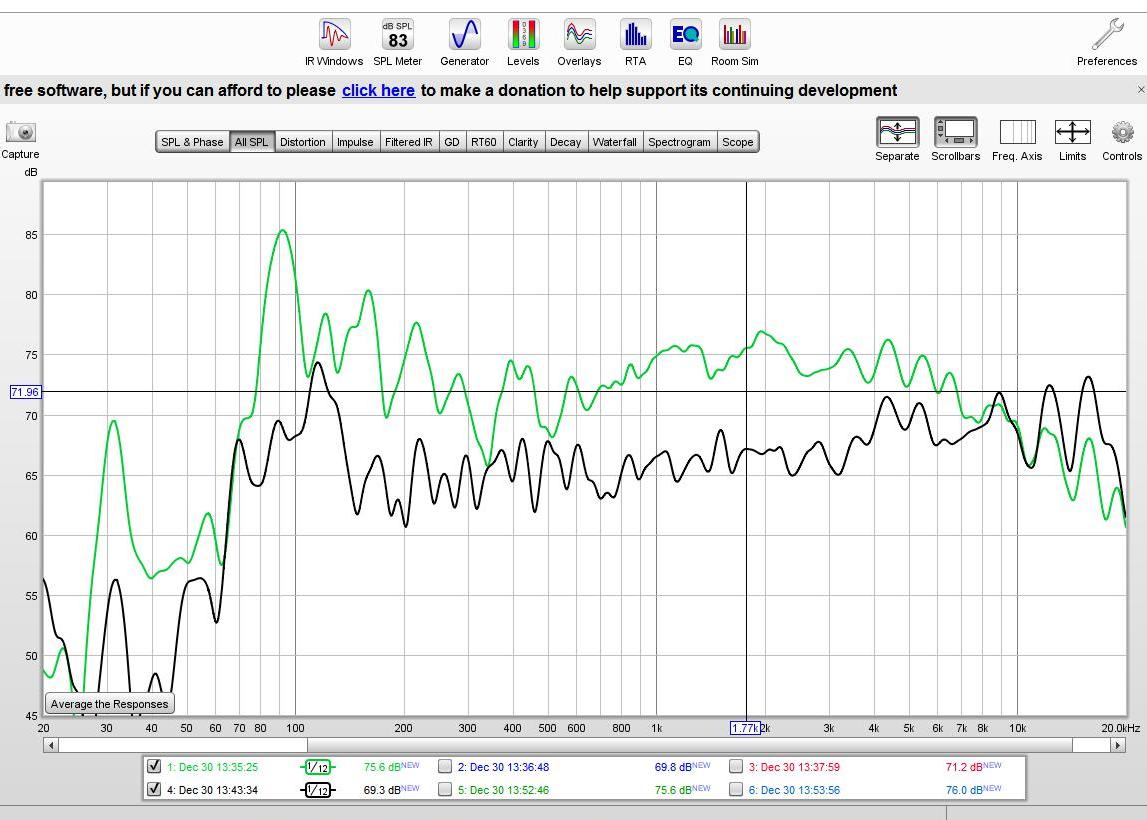

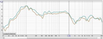

My REW measurements using the UMIK mic at listening position about 11 ft from the Quads shows the response curves when measured separately as in graph 1, Red trace left and blue trace right-hand speaker.

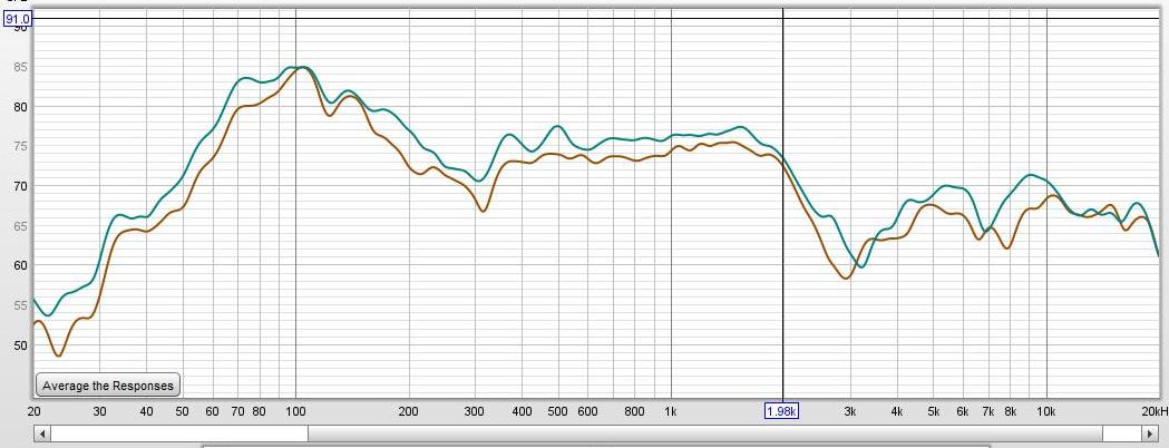

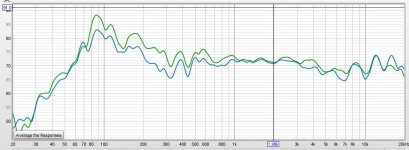

Graph 2, shows the response of the two Quads measured together. Green trace is electrically out of phase but sounds in phase. Note the increased roll-off at the treble end compared to the curves in Graph 1, indicating some cancellation I think? This makes me wonder if the crossovers are mismatched?
When both Quads are connected electrically in phase (black trace), the response is looking good apart from a slight rise at the treble end. Unfortunately, they sound very much out of phase.
When listening to pink or white noise at listening position dead centre of the two speakers, I only have to move my head slightly to the right or left and the sound becomes slightly brighter rather than the other way round, Also there is a bit of phasiness going on.
Despite my concerns, the speakers do sound very nice indeed. But being a bit of a fusspot, I do like to have things as perfect as possible!
Actually, I use the Quads with a pair subwoofers and Audyssey up to 150Hz to smooth out the bass.
I would appreciate if someone could advise me what the issue might be. (if indeed there is one!)

It would be good to get proper phase information at fixed distances. Since you are using a UMIK you'll have to make special arrangement for that.
Have you looked at the impulse and step response for each speaker and/or each panel?
If you put the mic close to the individual panels, you may get enough discrimination to see them individually while driving the whole speaker.

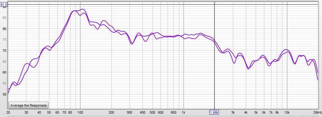

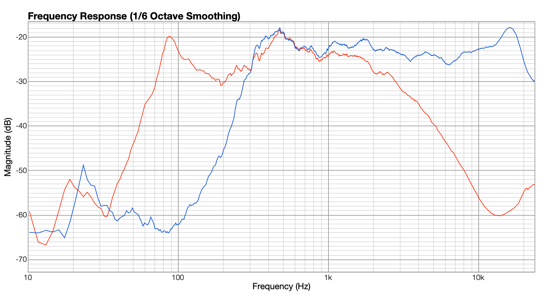

The speaker panels have very shallow roll-offs and it's super easy to get the front and rear segments of the treble panels out of phase. The differences in the 300hz to 1khz range and then coming together give me pause. Here's what the treble panel and bass panel responses on their own look like to get a feel for how they would interact:
Here's what a typical center and outer vertical sections of a treble panel look like (the center section peaks at 20Khz):
Keep in mind these are fairly closely mic'ed, and only driving one panel at a time, so you it's non-trivial to relate this directly to what you are measuring but you get an idea of what's going on in the speakers. I use measurements like these as quality control for all my rebuilds. Be VERY wary of anyone who doesn't do extensive measurements of their work. The original panel plastic is often distorted from decades of relaxing, and there were large variations between different production eras of treble panels. So I often see speakers in for a rebuild that have one replaced treble panel that never matched the other.

The front and rear aren't different segments, but rather, the middle strip (of the three vertical strips) is a segment and the other two are tied together as another. So it's a three-way speaker of sorts. My front and rear comment is because the original quad wire color choice is poor for each segment. There is a pair of blue wires for the outer segments and a pair of brown wires for the middle segments. There is no indication which of the blue or which of the browns in the front or back of the panel. So it's easy for an installer to get them wrong.
I am not sure if there is something wrong, your plots seem to show that there is an issue. It would be ideal to measure both speakers in the same spot in the room and the exact same distance from the microphone. But in my experience you shouldn't be seeing diffferences like you are in the response. Also you notice something clearly not right with your ears, which is a clear indication of a problem. Since they are much mess sensitive than measurements for absolute issues.

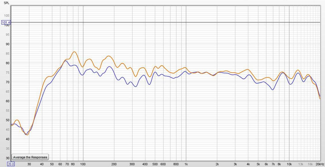

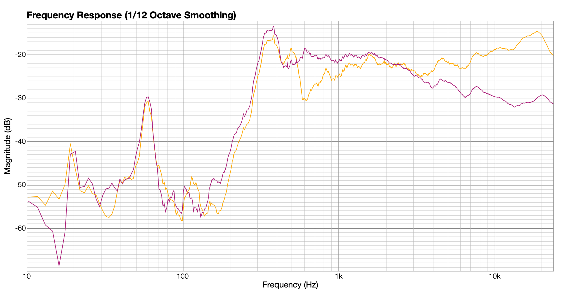

Hi Sheldon. here is the plot of each speaker taken at 1m in the same spot. It is the dip in the 200-300Hz range of my left (blue trace) speaker that concerns me most. Perhaps the bass drivers are a bit down in efficiency on that speaker? Obviously I use the speakers with one wired in reverse to correct the phase. I can live with that. Despite all that, they still sound very nice. Whether the crossover components are out of tolerance I don't know.

Sure looks like the woofer is too low in output. The tweeters matches up well.
Seems to be a valid measurement.
IT seems like you have two possible problems. The first possibility is that your panels are somehow bad, and that's why the bass appears lower on one speaker. But that doesn't explain why you have to invert the phase of one speaker to get a solid stereo image (and I'm betting it's not all that solid). If you really had weak bass panels, you'd know it, one speaker would sound thin and instruments like acoustic basses would not sound centered.
I'm betting that you have panels that are more or less just fine, and there is a wiring problem. Do you feel confident enough to take the backs off the speakers and unscrew the input transformer and flip it upside down? You can then check one speaker against the other to see wiring differences.

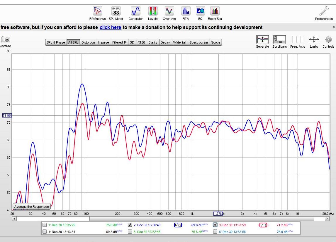

I've just done some more measurements so please take a look and let me know what you make of them.
Graph 1, shows both quads at 1m in the same spot. Both speakers fully charged over night. Left being the blue trace.
Graph 2, shows the the left Quad with left and right bass panels at 30cm.
Graph 3, shows the right Quad with left and right bass panels at 30cm.
It is clear that the right Quad bass panels match up very nicely.
