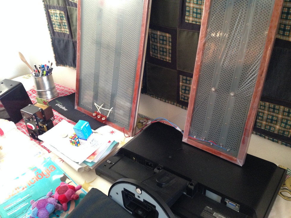

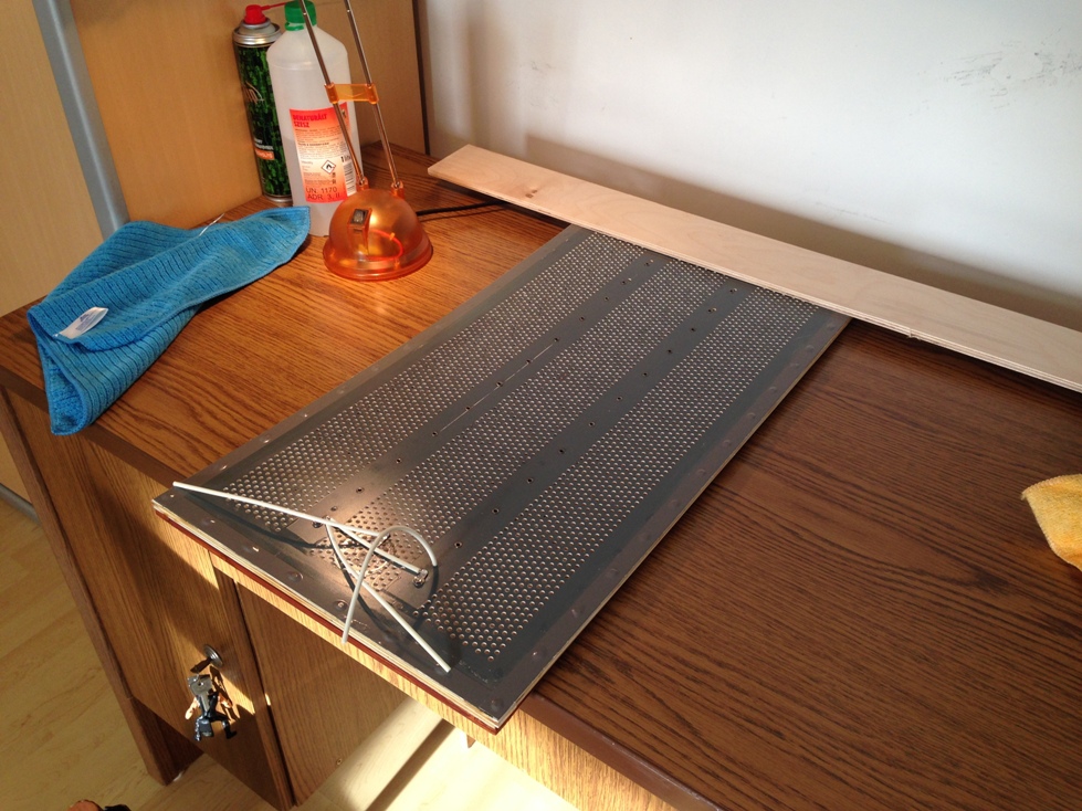

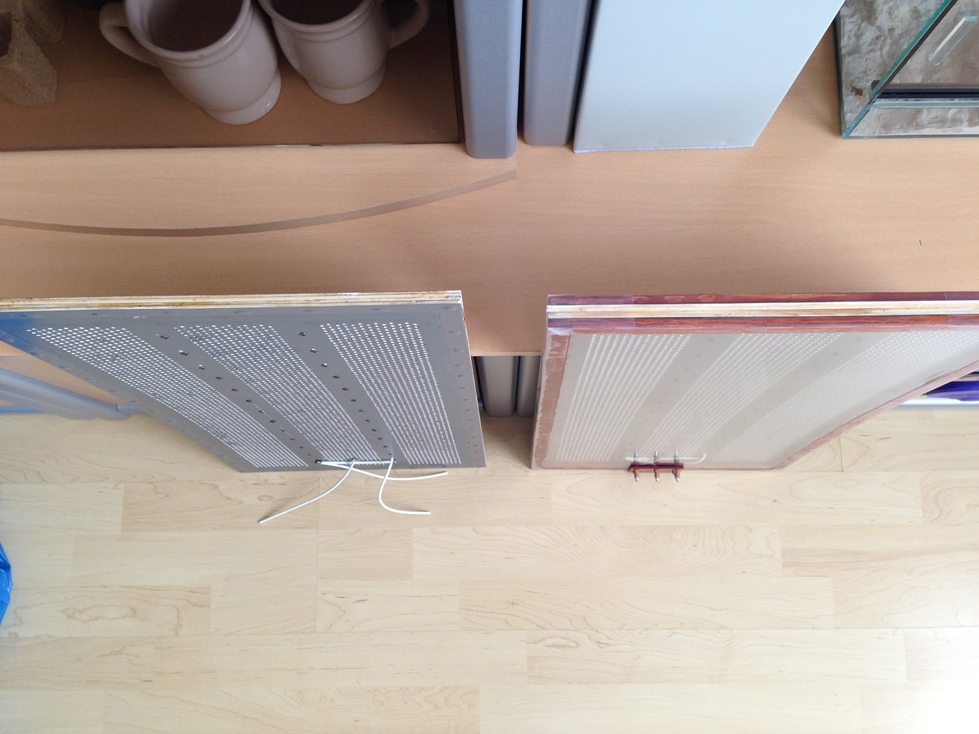

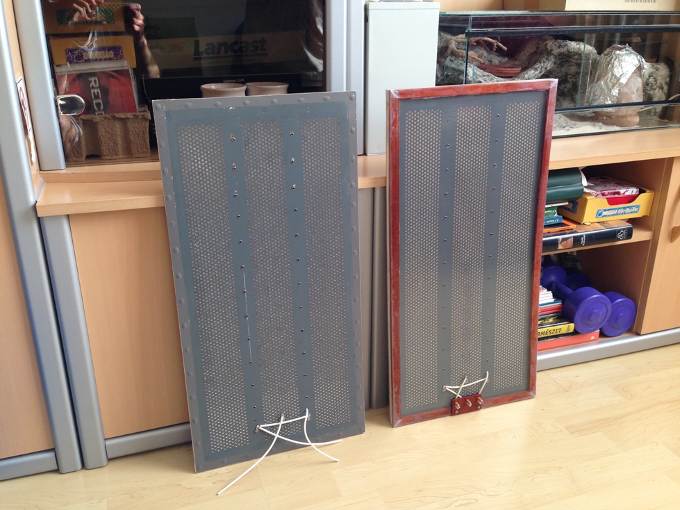

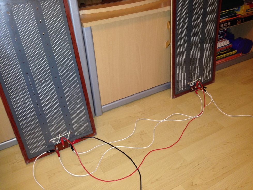

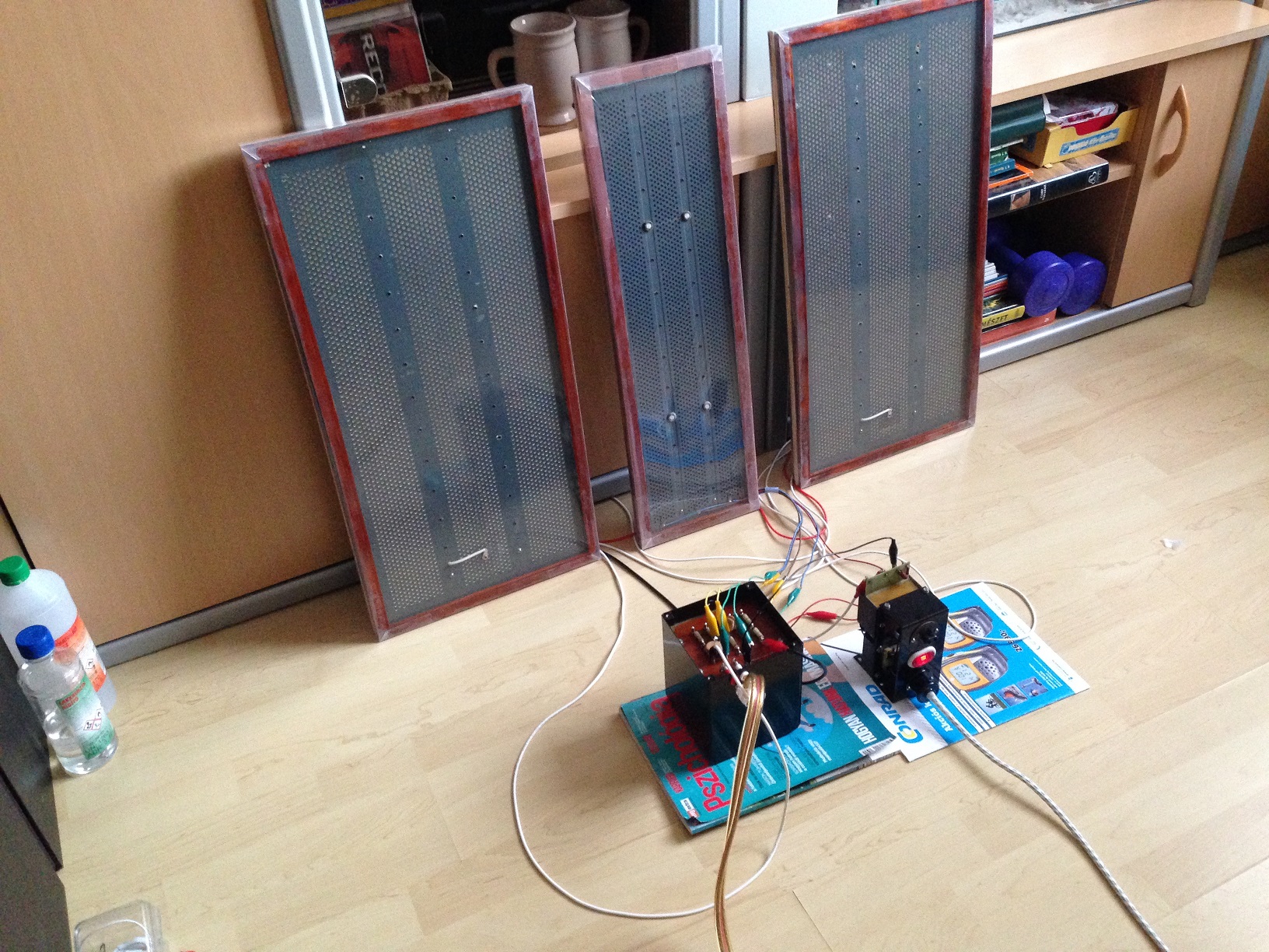

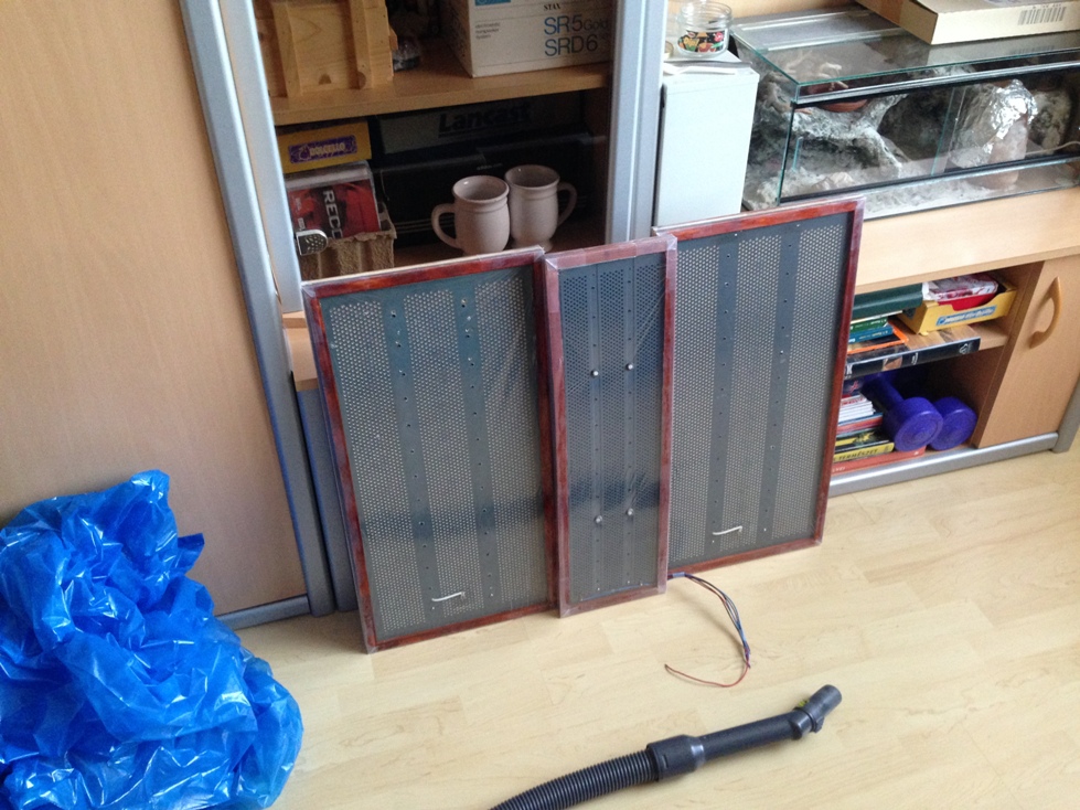

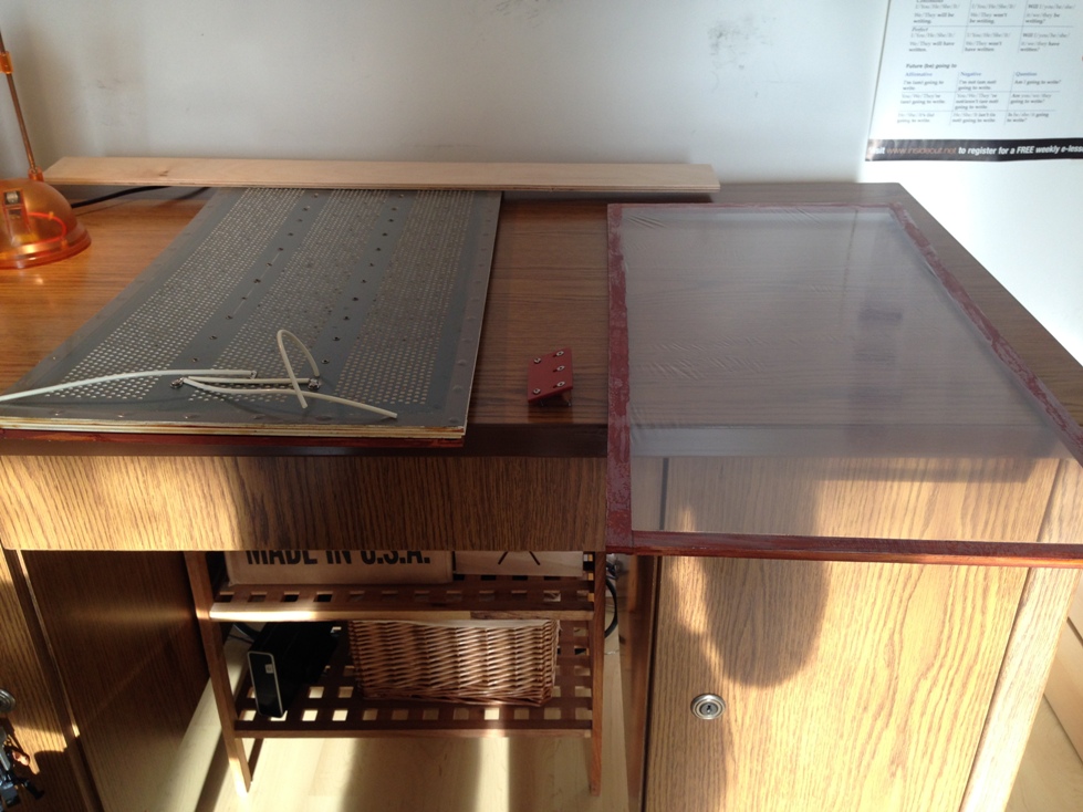

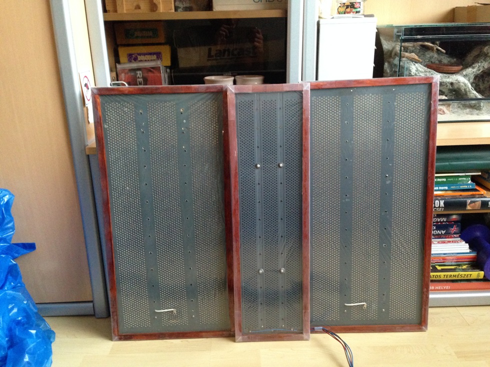

The initial test sounded O.K. without any pop or crack, but next time I have to listen to them very carefully. I am afraid that the conductive aquadag (?) on the stators must be even and the thickness should be permanently the same all the surface of one stator. I redoed it with this silver defogger, but I am sure that the repaired fields are not the same thickness as the factory standard, so it may interfere with the even magnetic field and cause distortion, I am not sure, who knows?

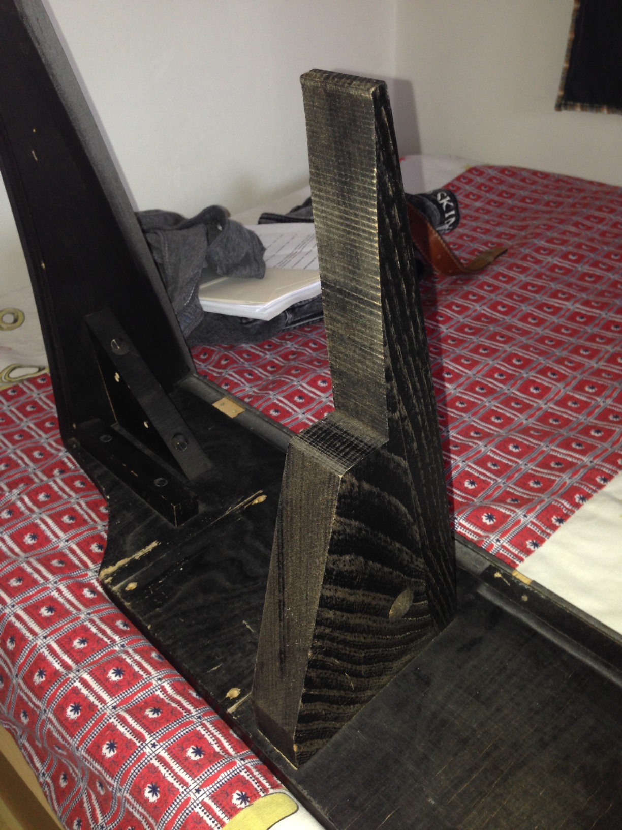

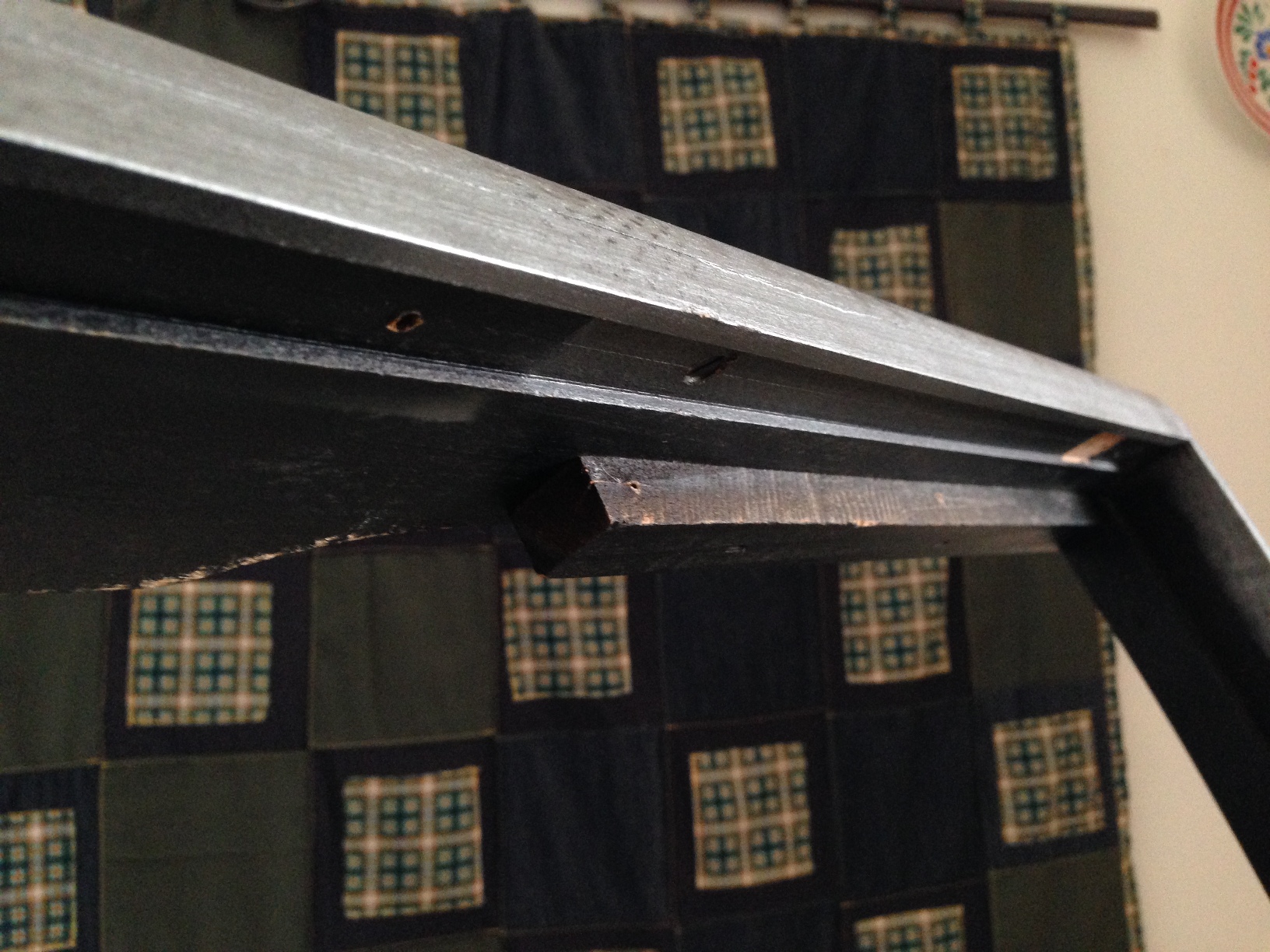

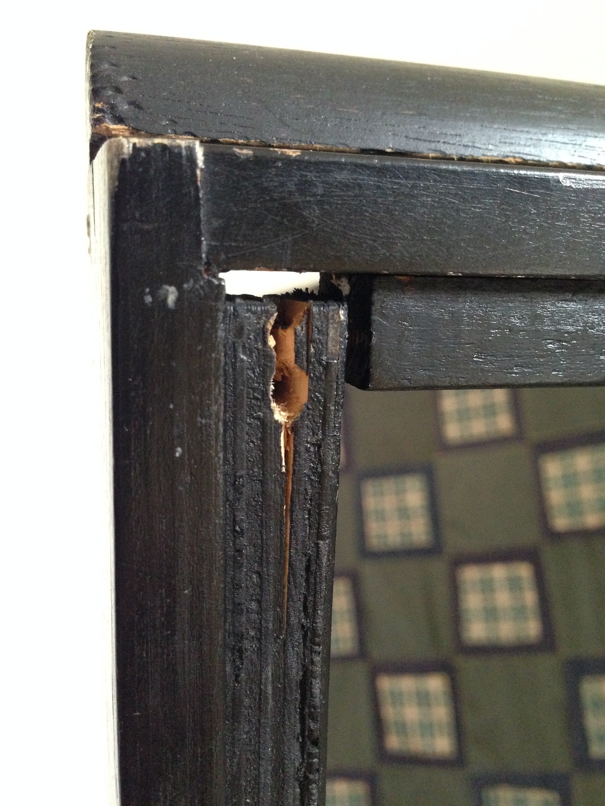

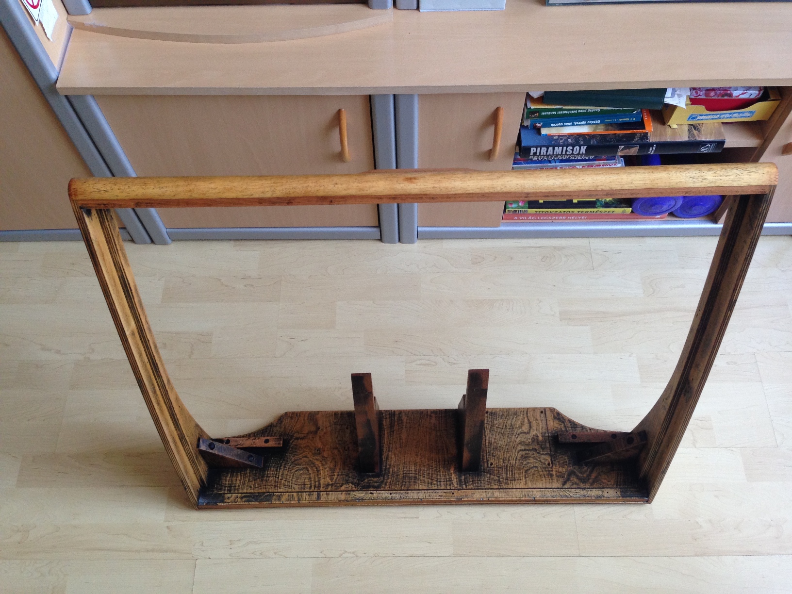

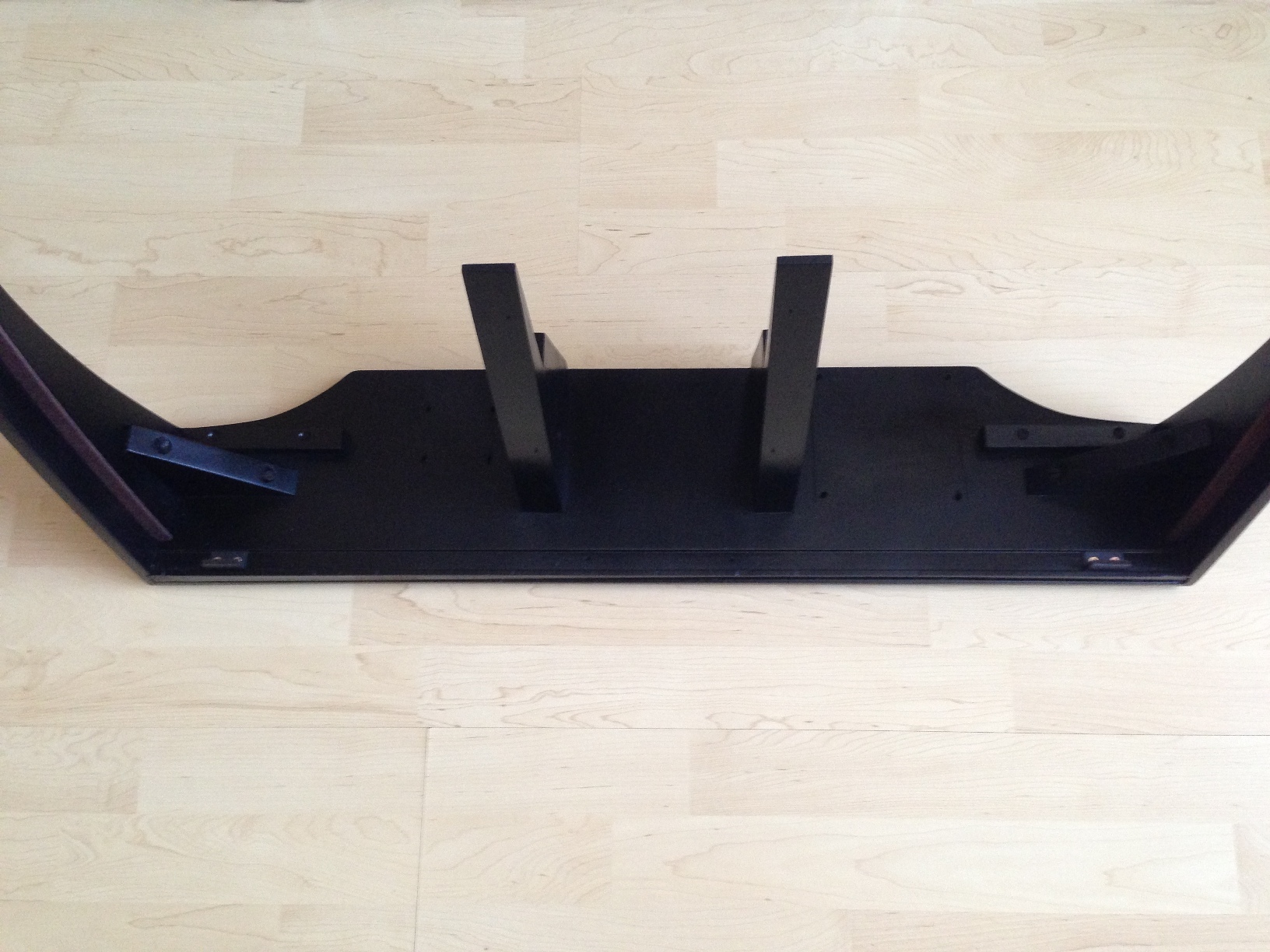

Frame
Messing with the frame

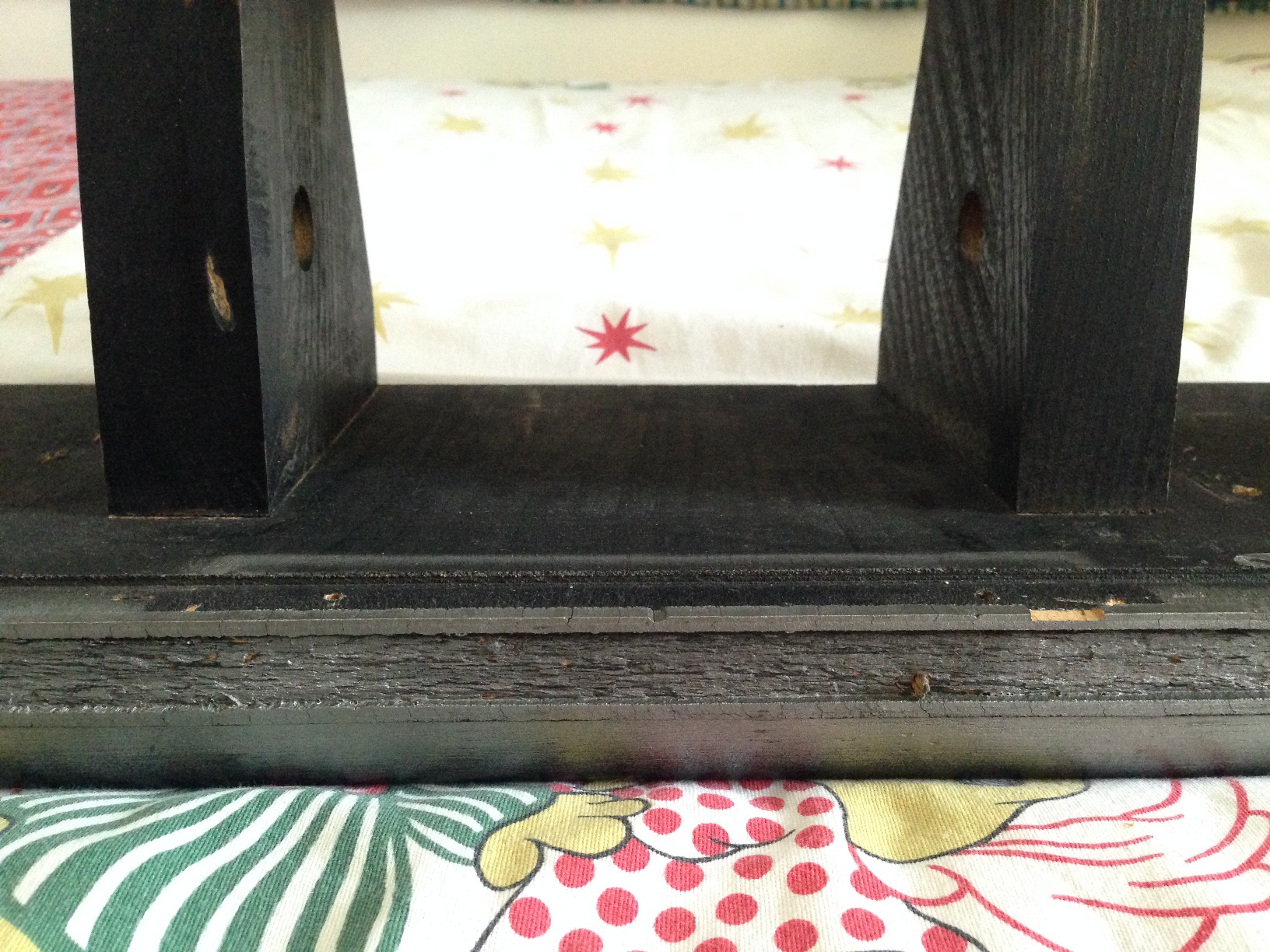

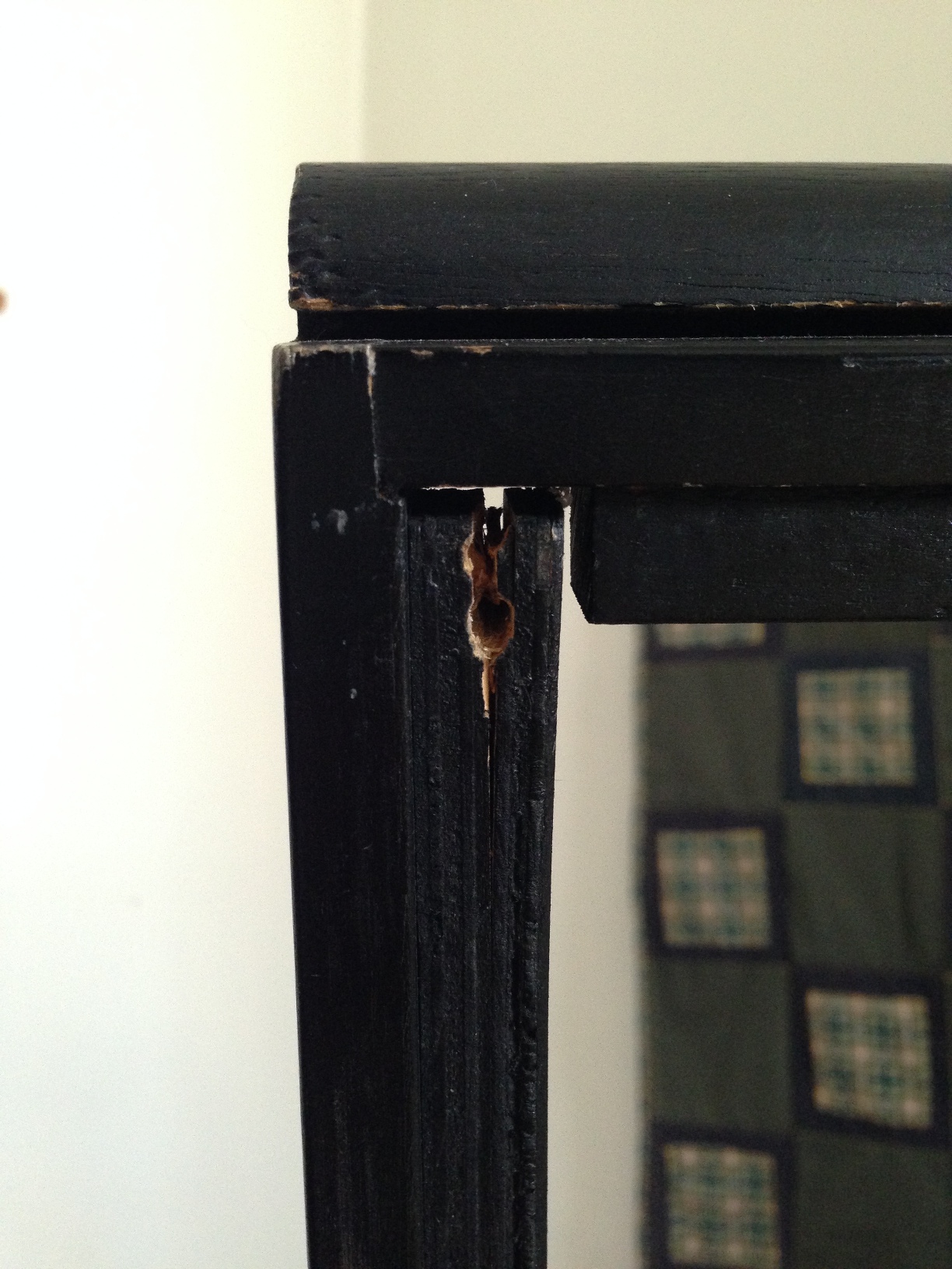

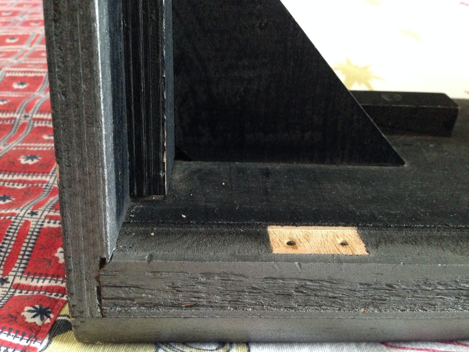

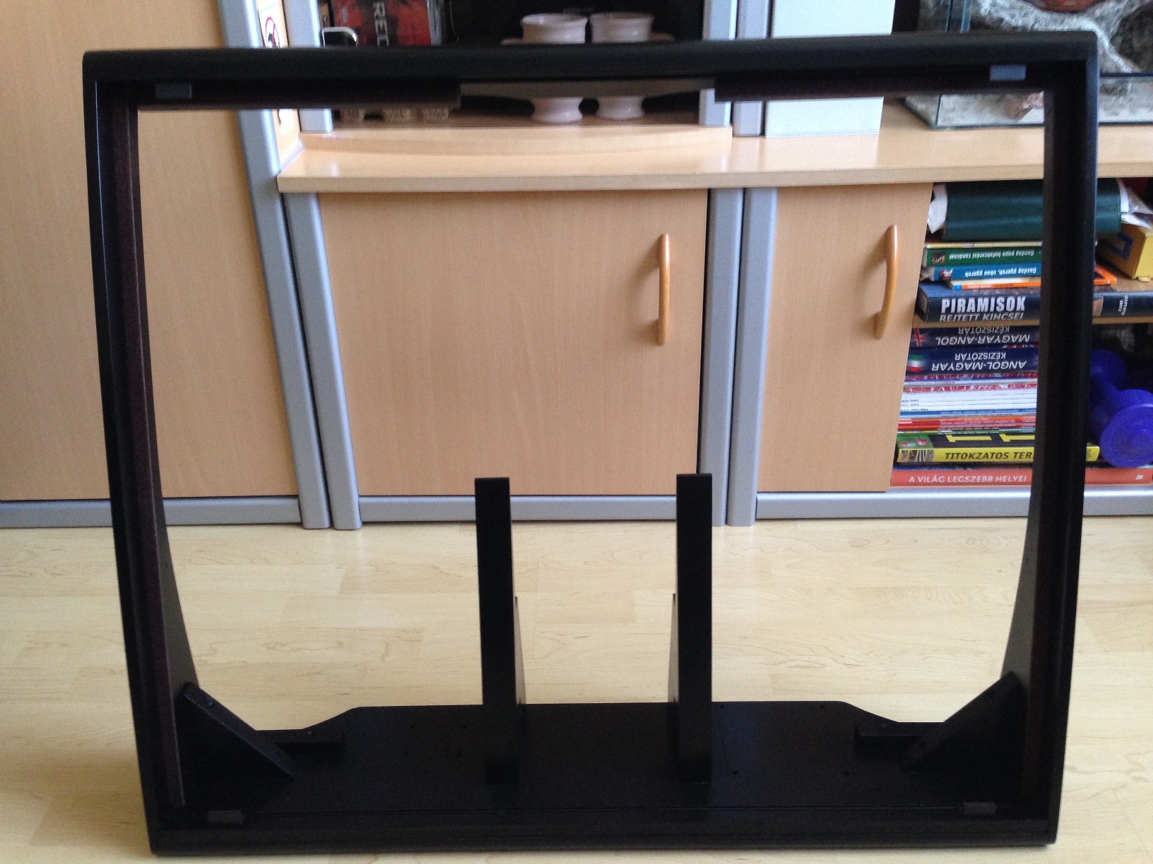

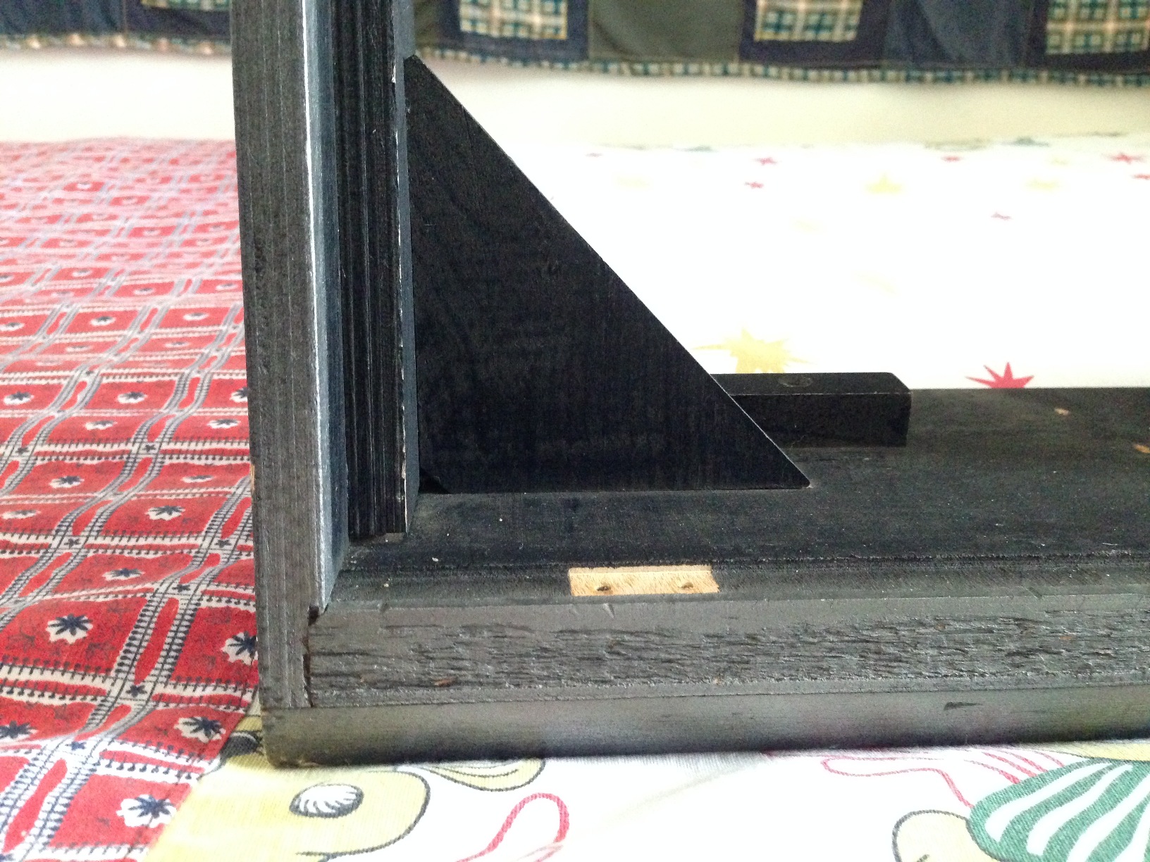

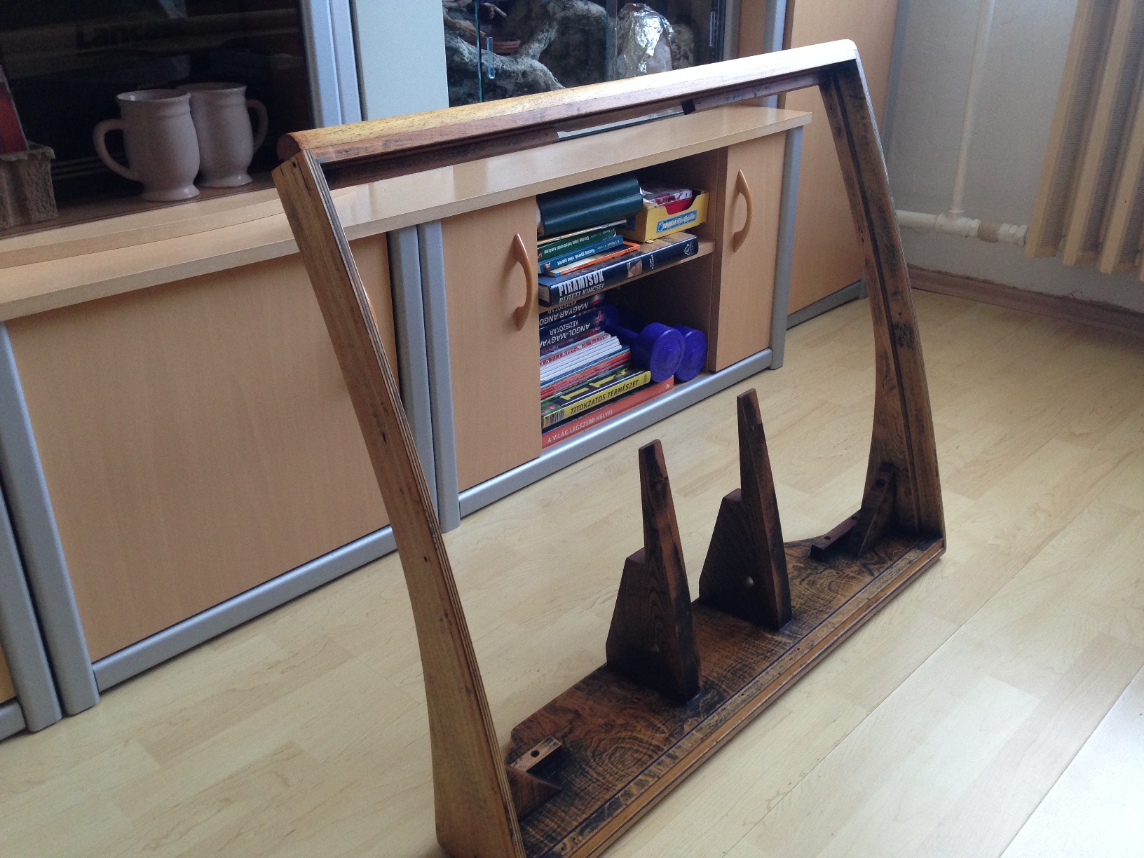

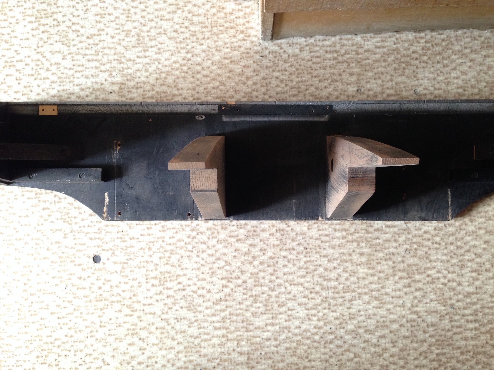

Frame

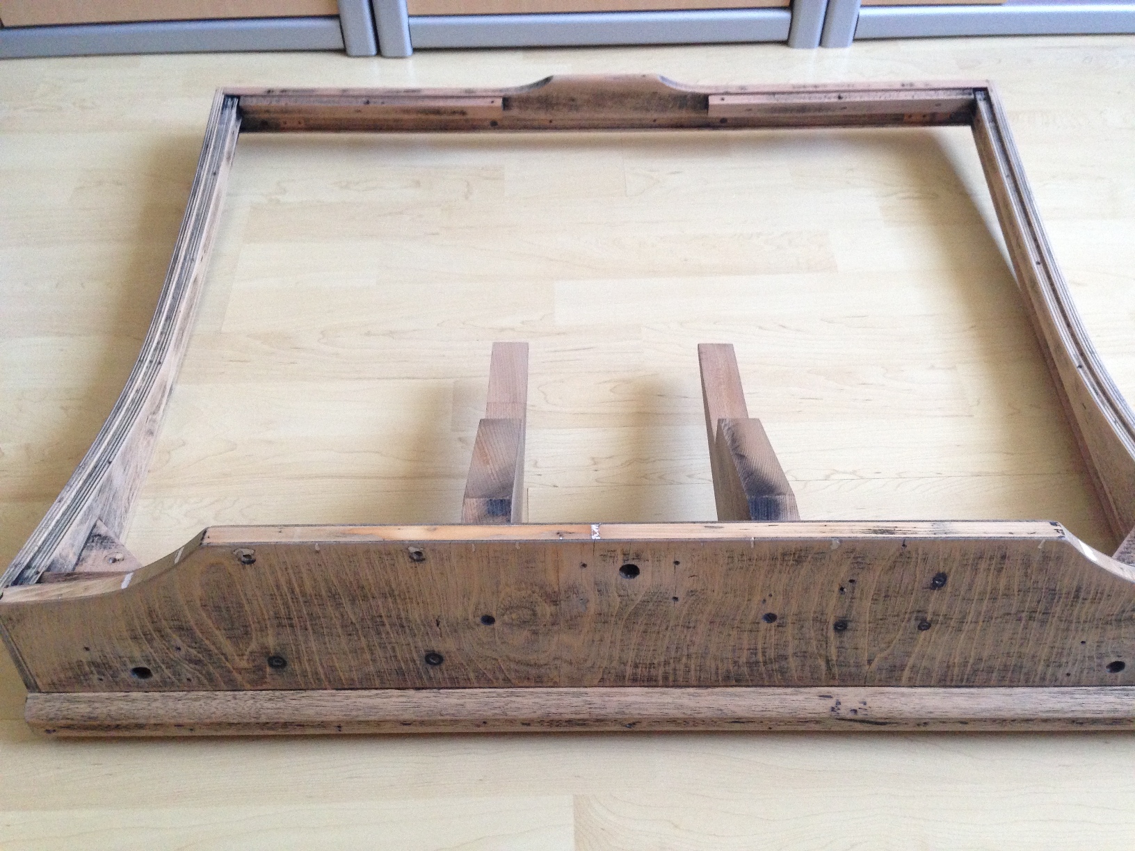

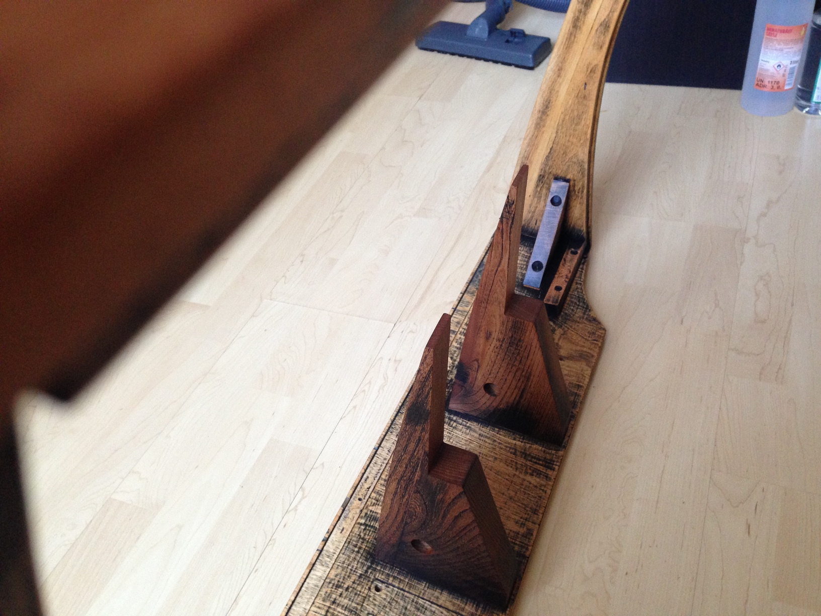

I've found out that the frames bases are made out of different wood until some time when that swapped with MFD. The latter version also has narrower handle at the top.
My speakers' serials are 20721 and 20728, at least, they are some way identical cosmetically, but I am not sure if they are really from 1968 or it's just the back grilles those are 'matched' by the previous owner(s)

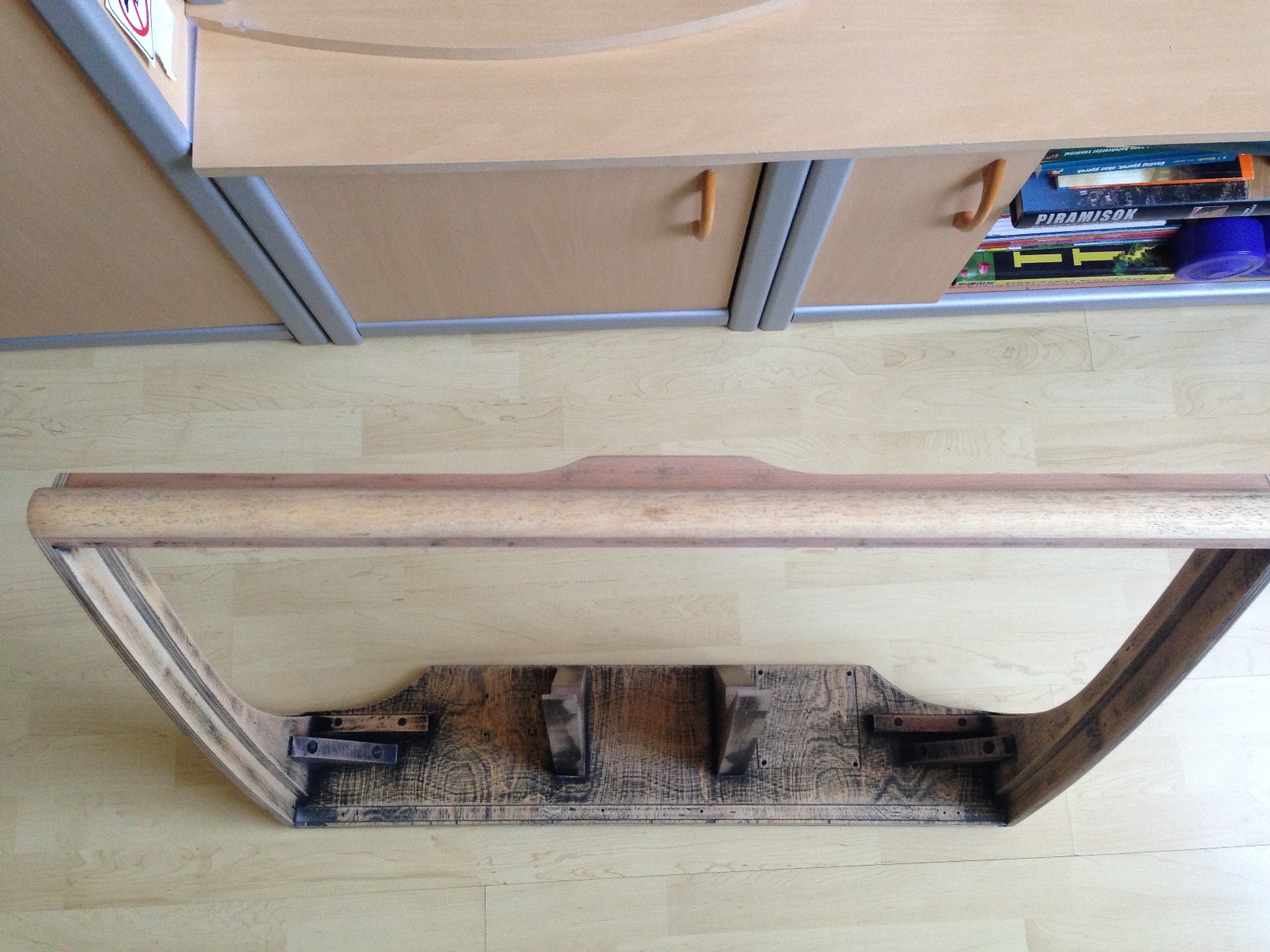

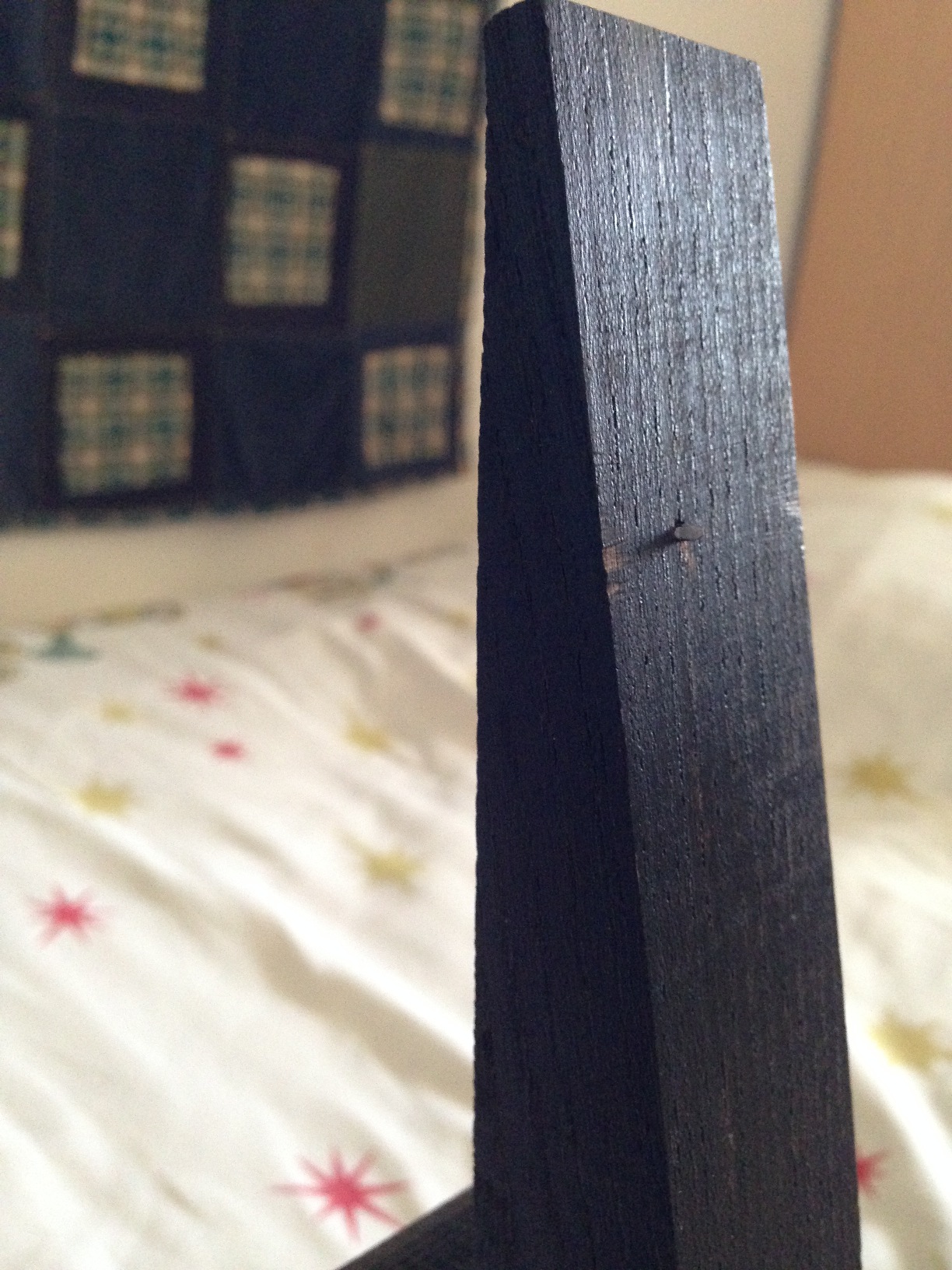

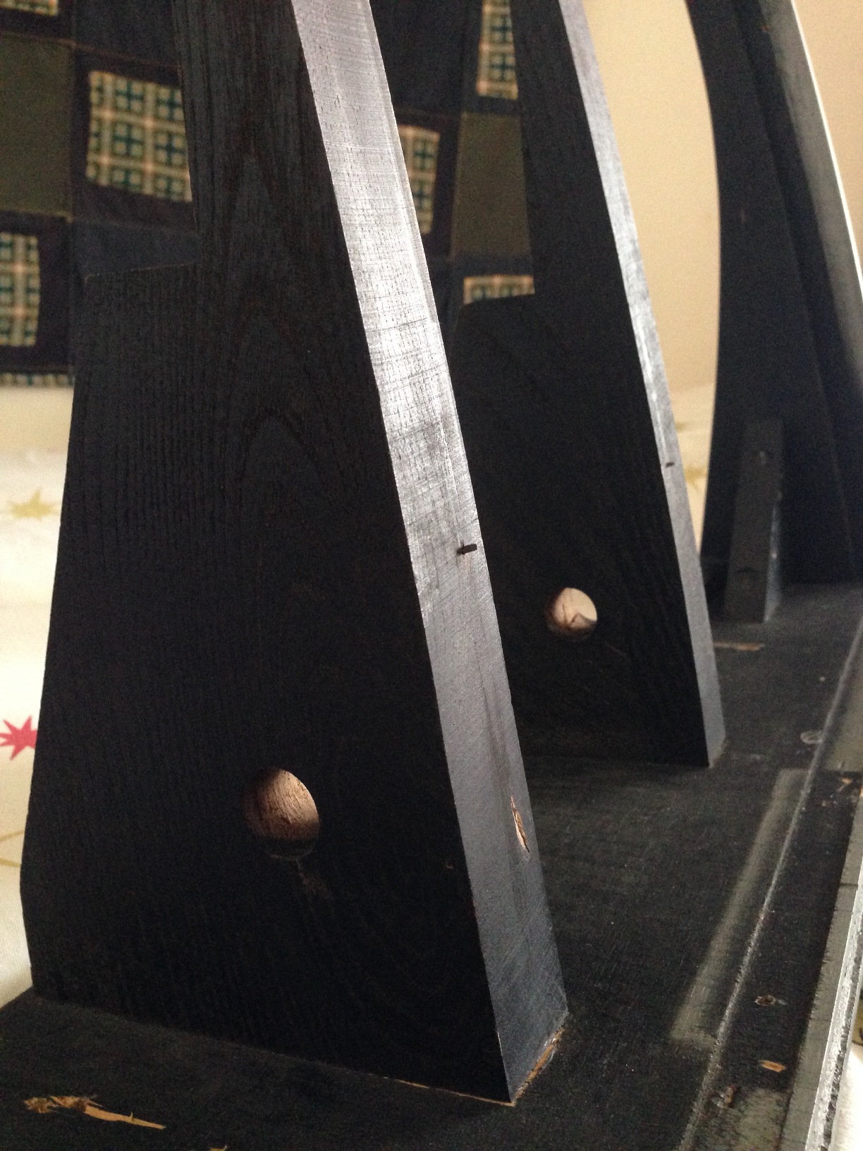

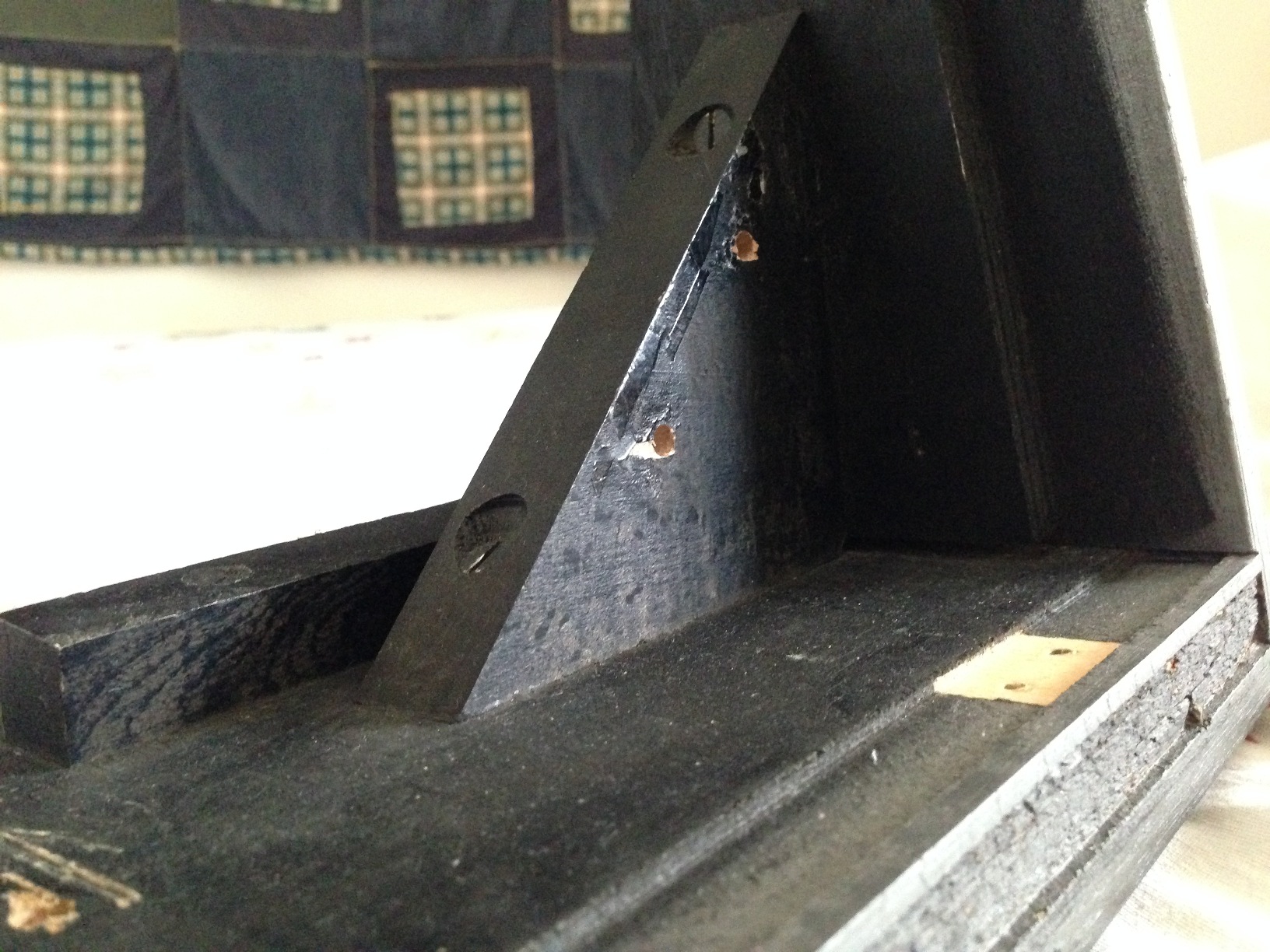

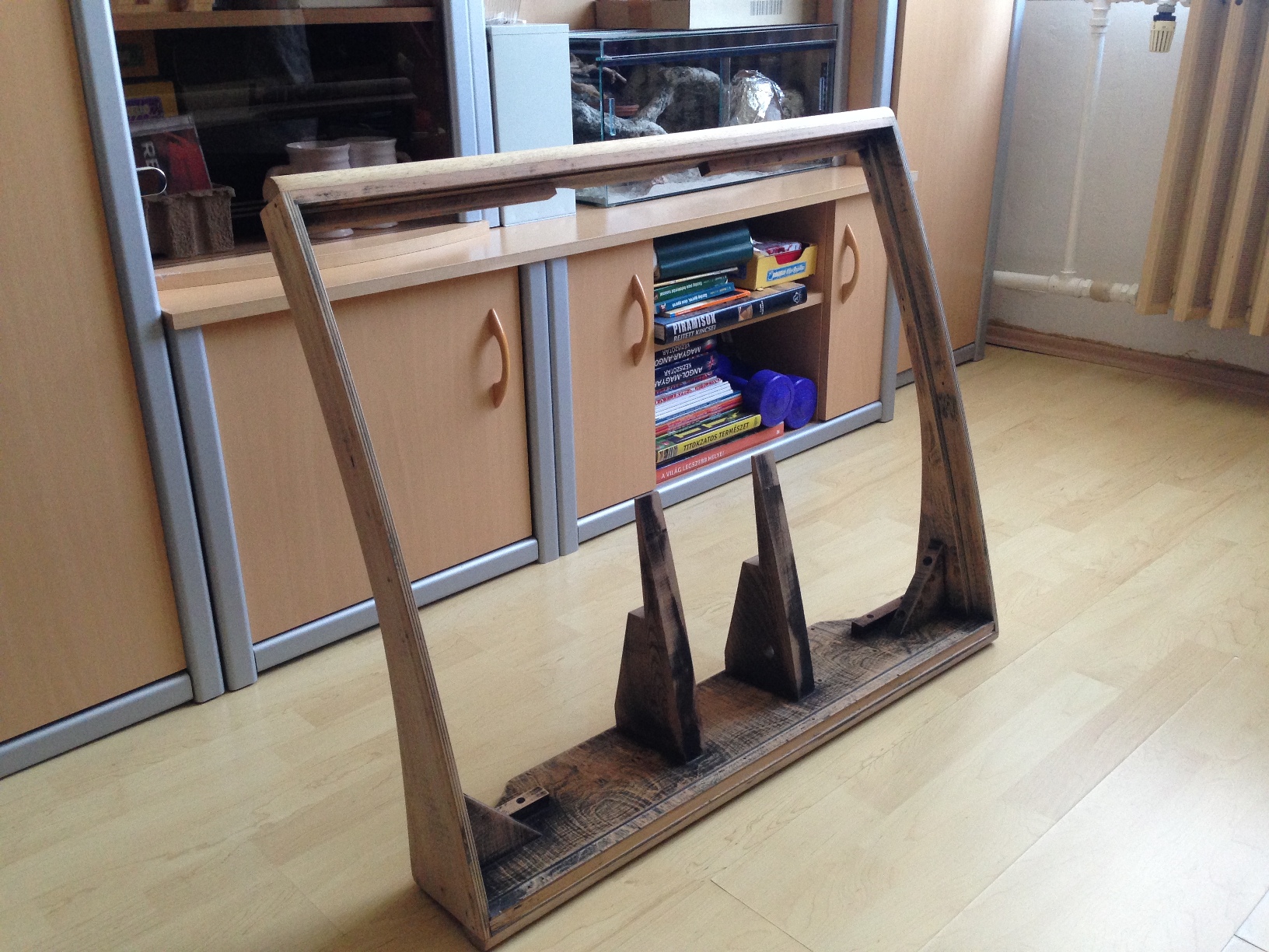

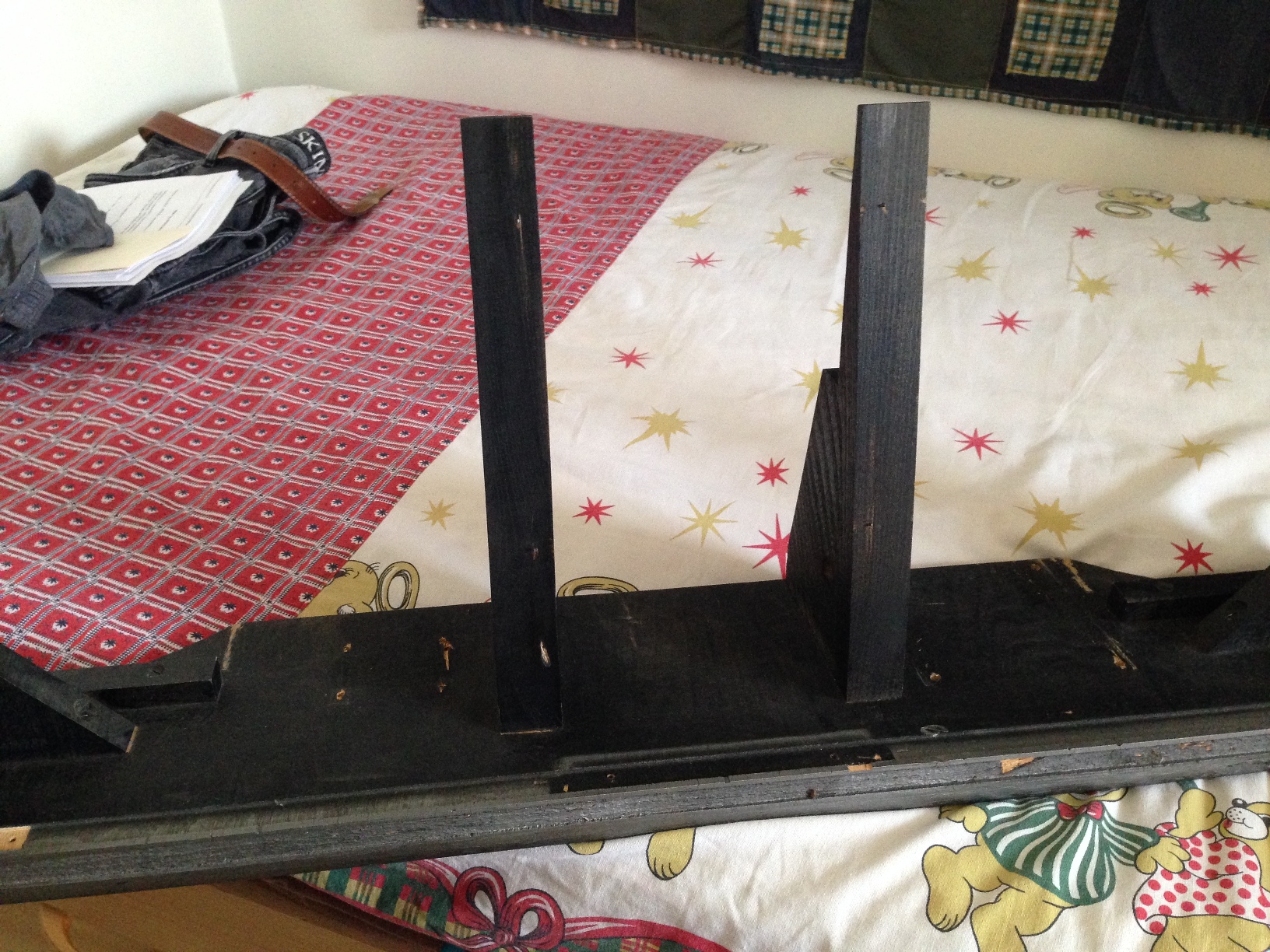

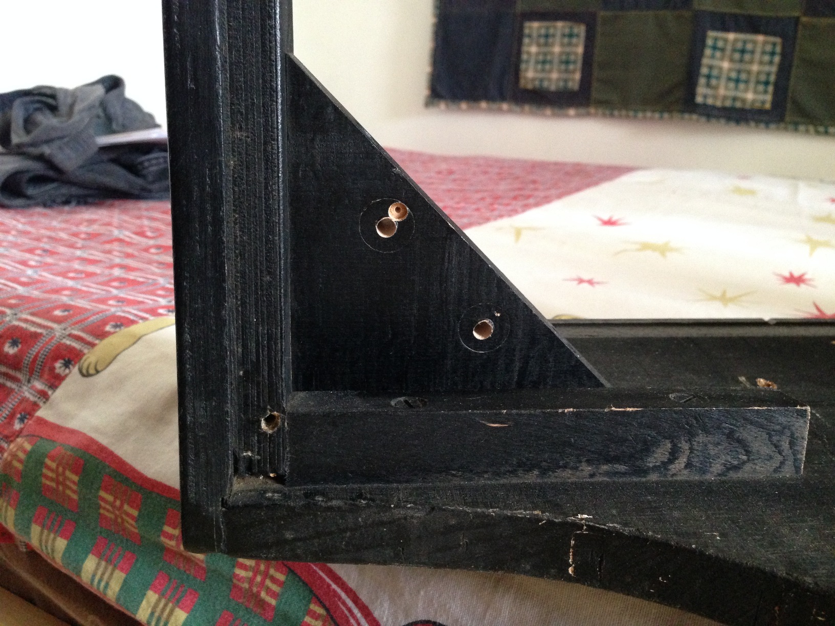

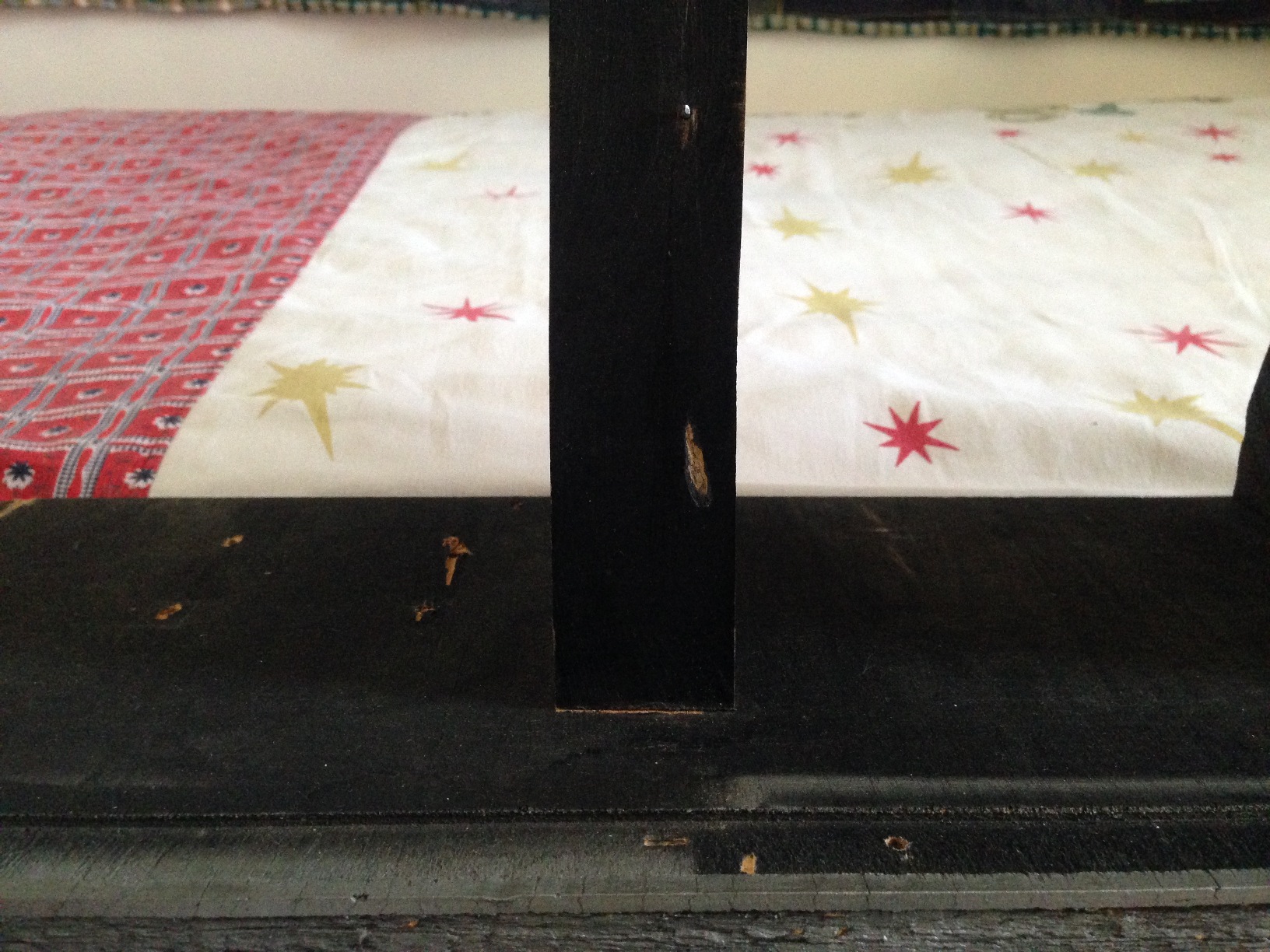

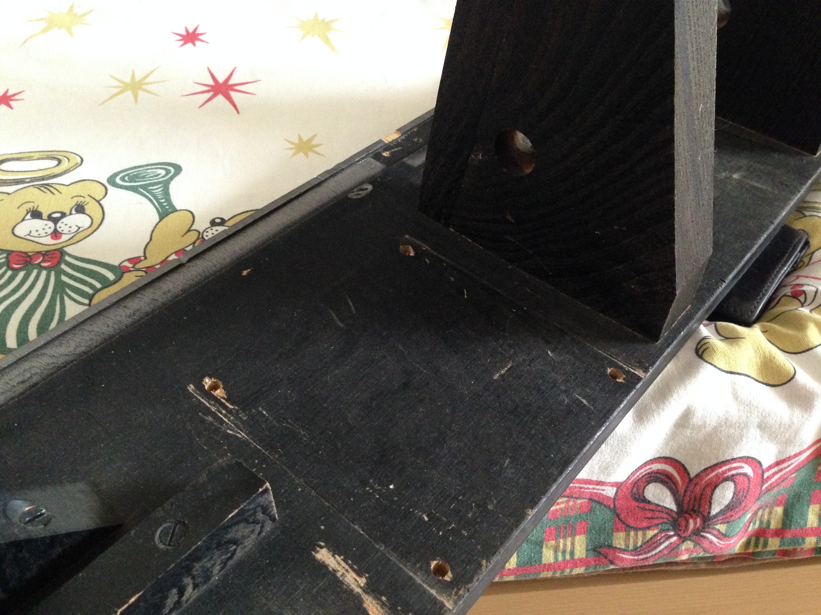

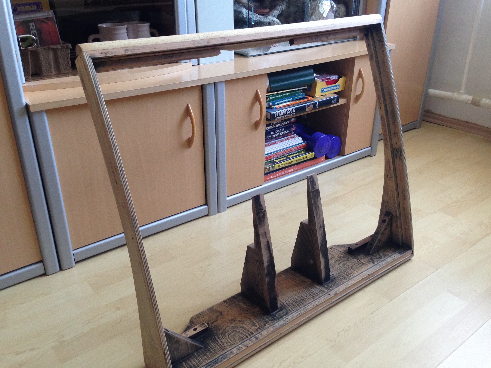

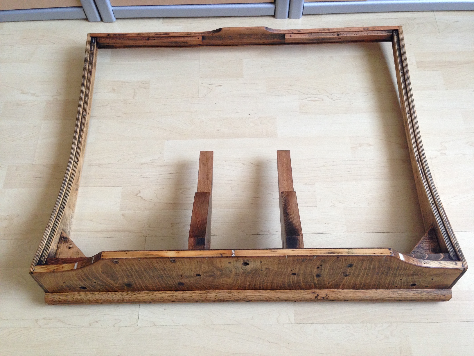

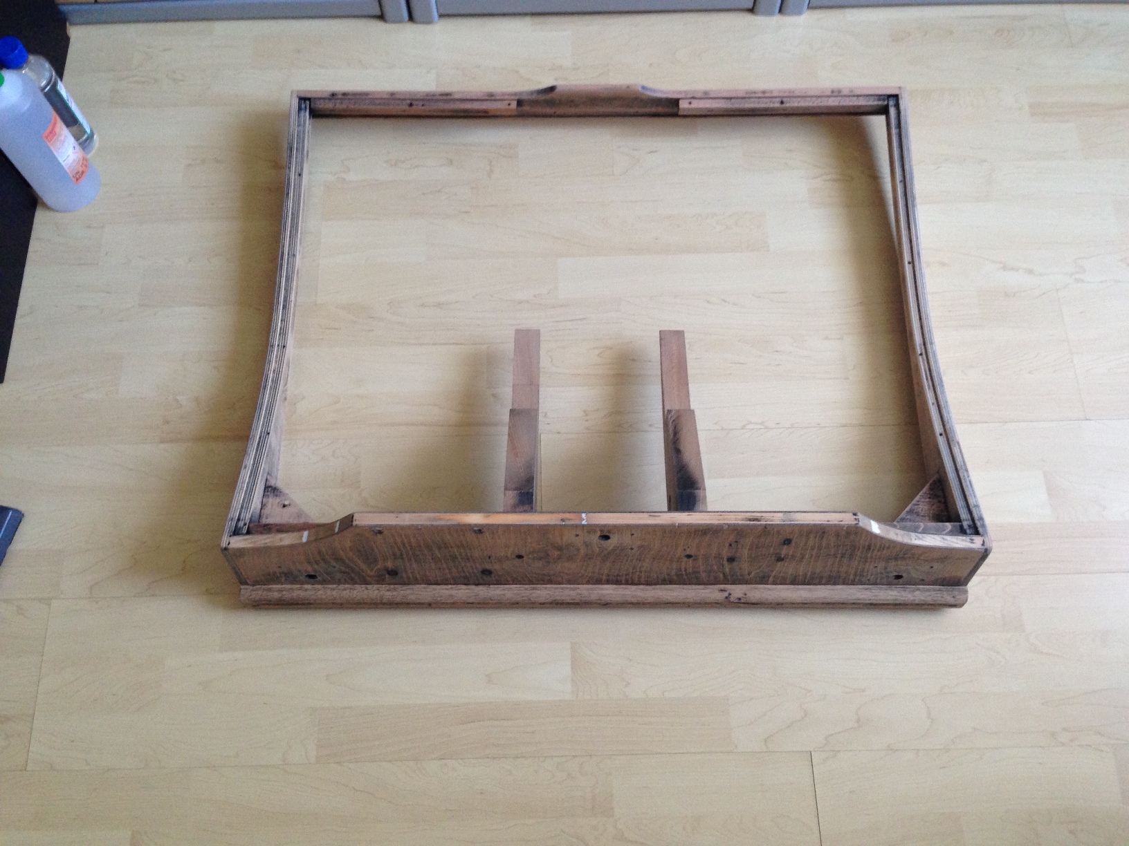

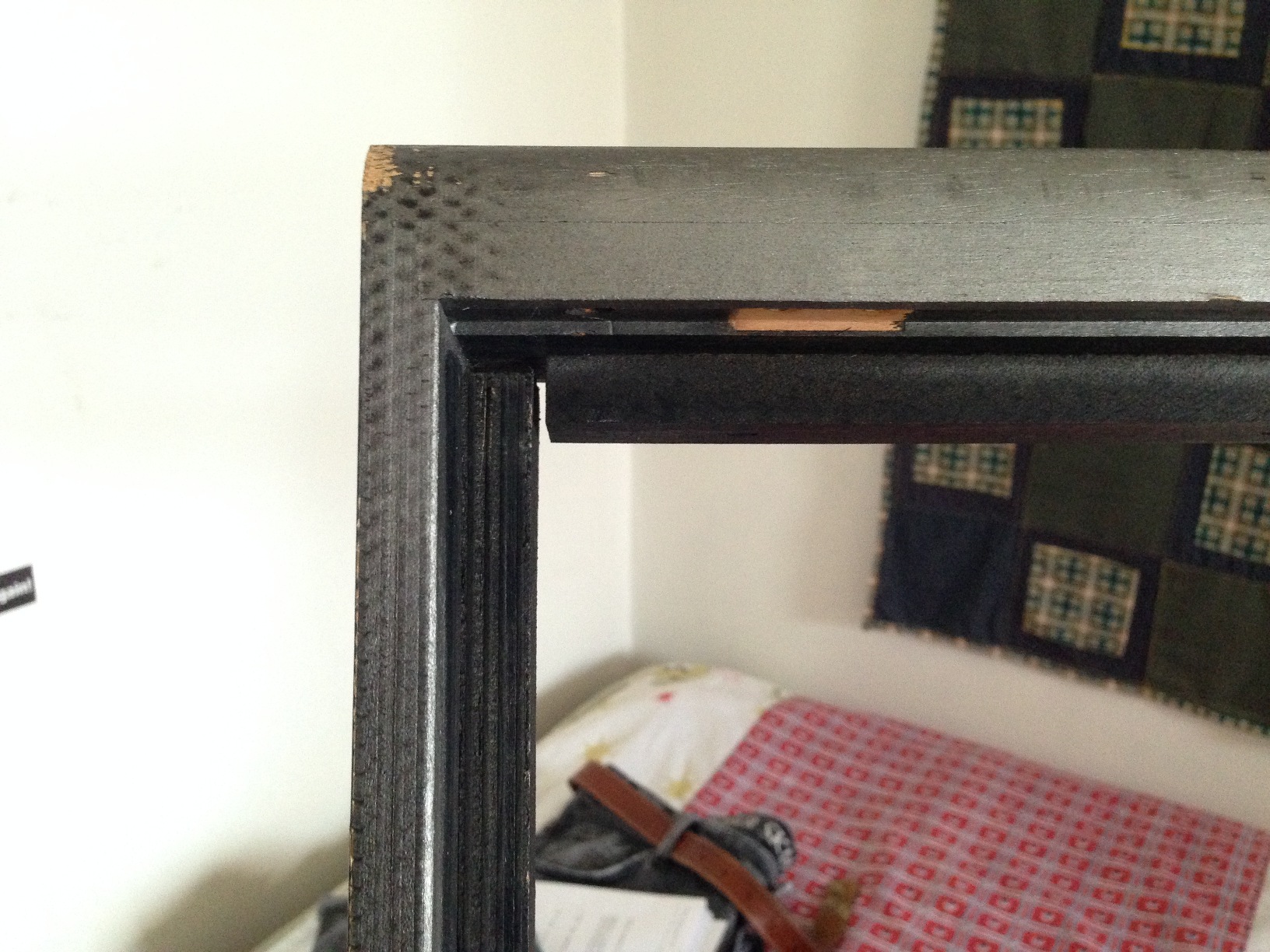

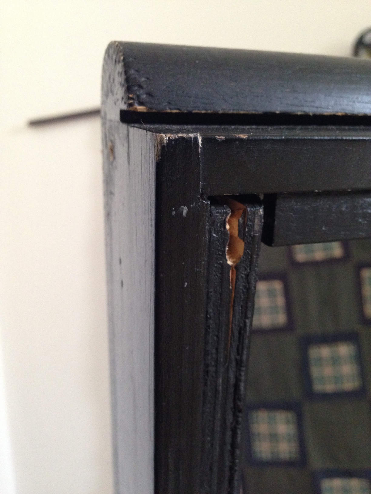

Frame

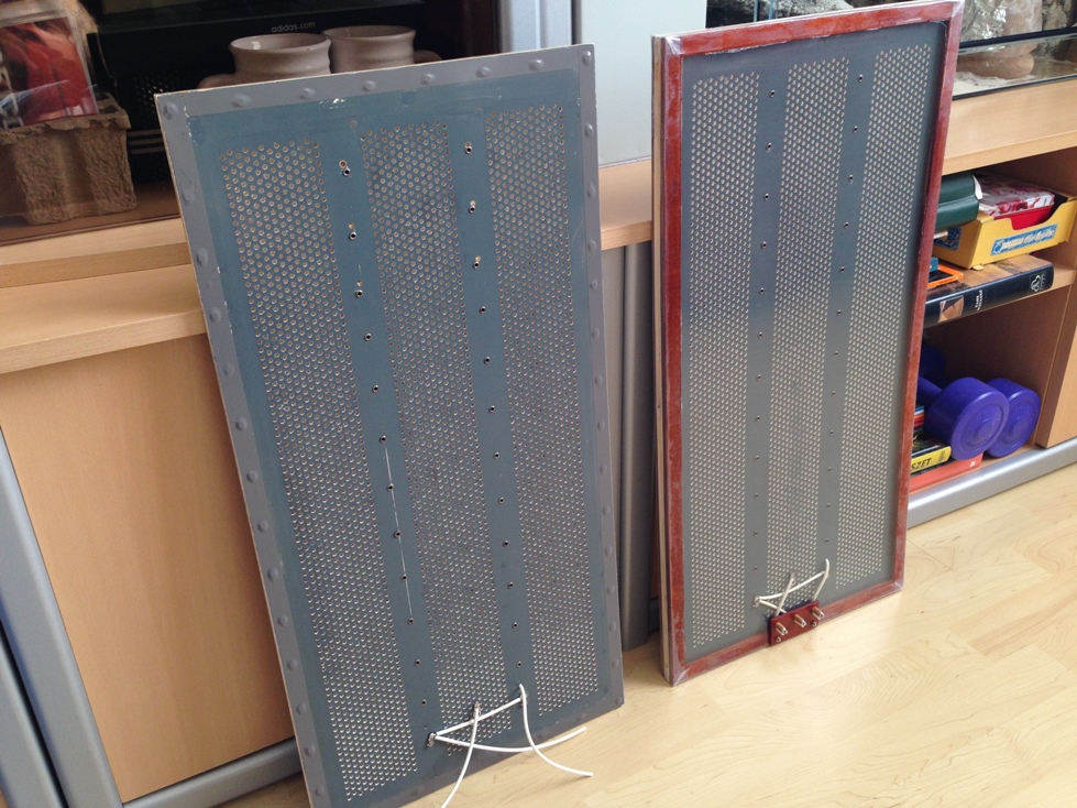

More pics of the untouched frames

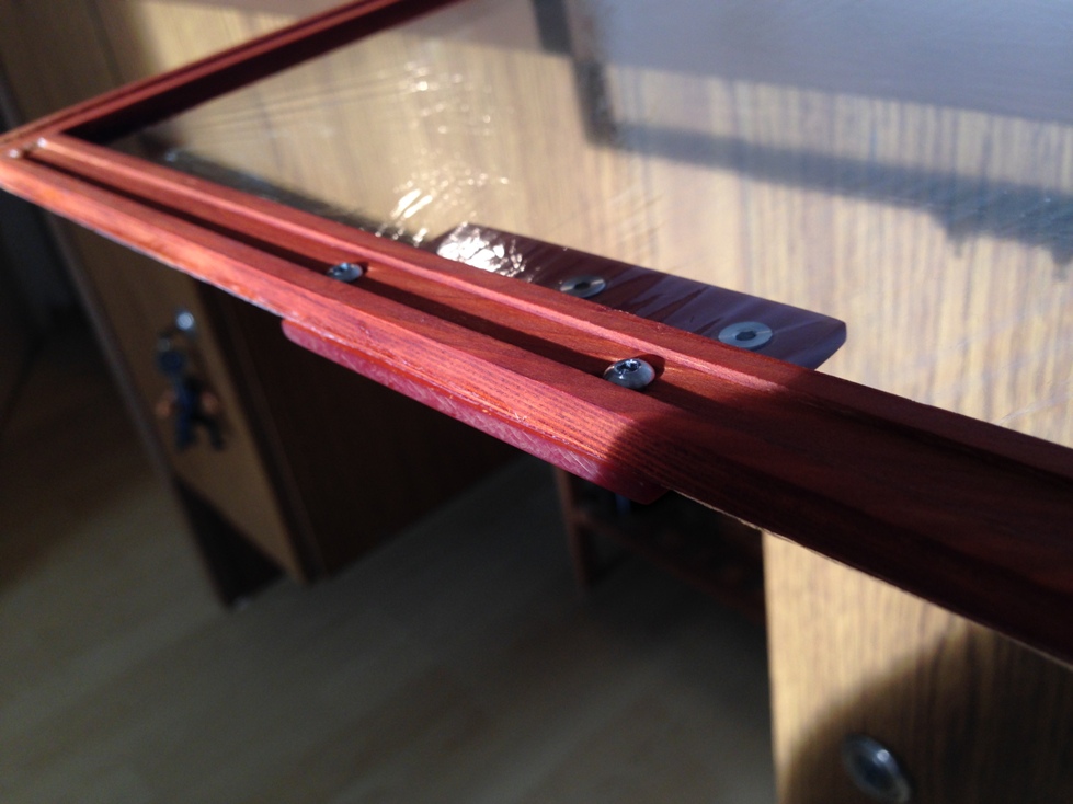

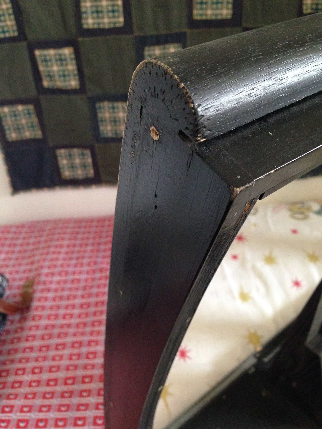

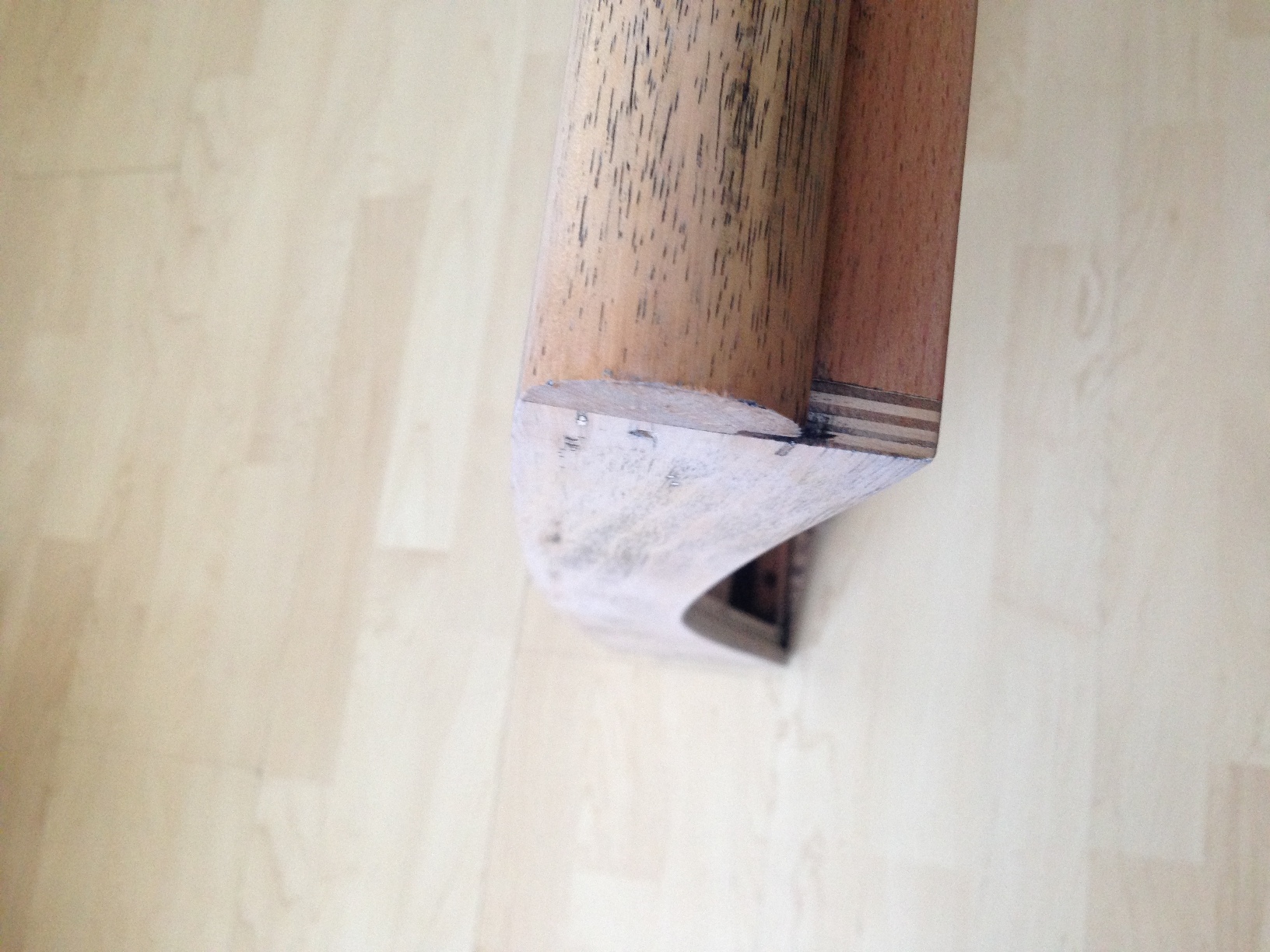

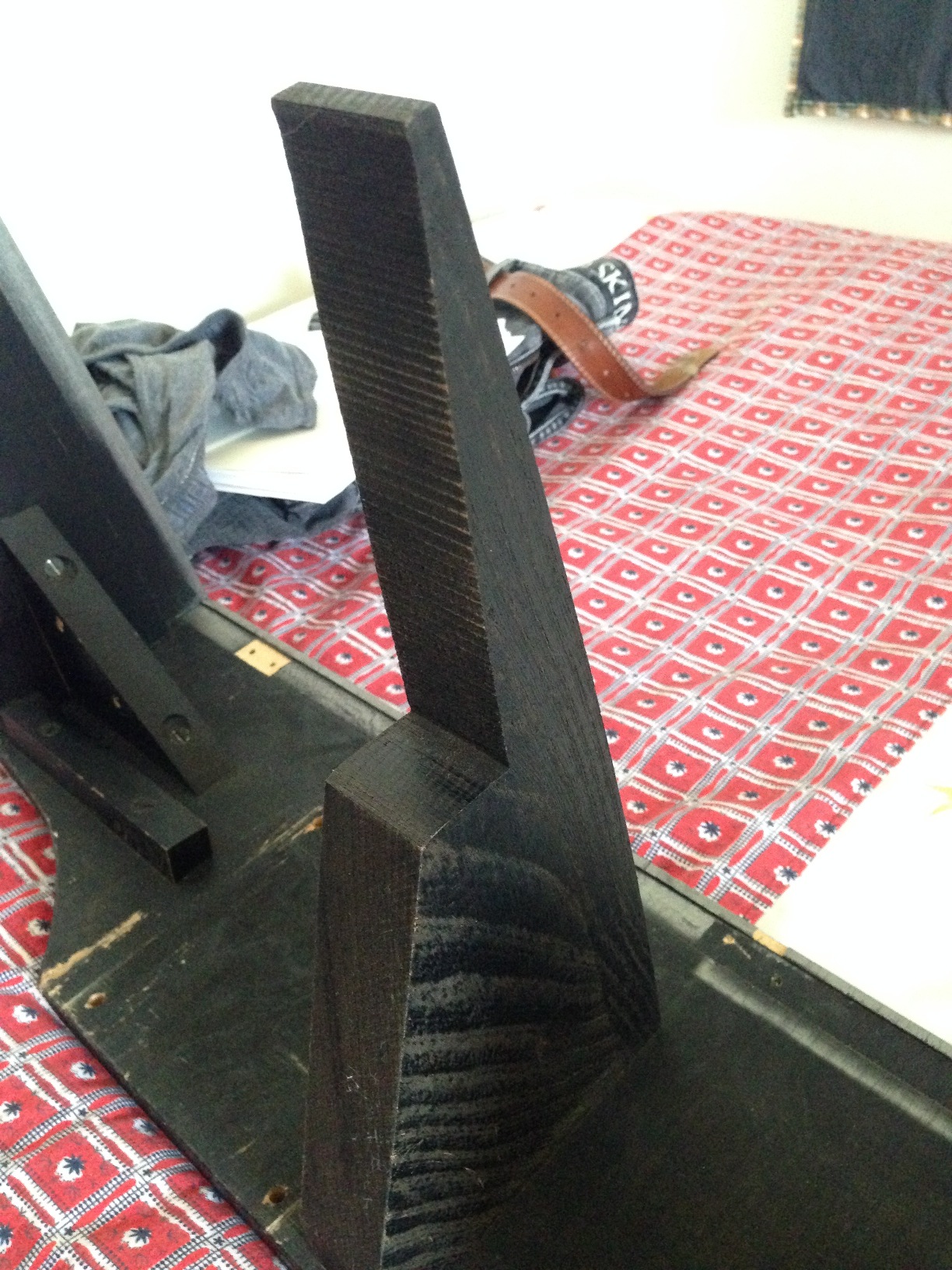

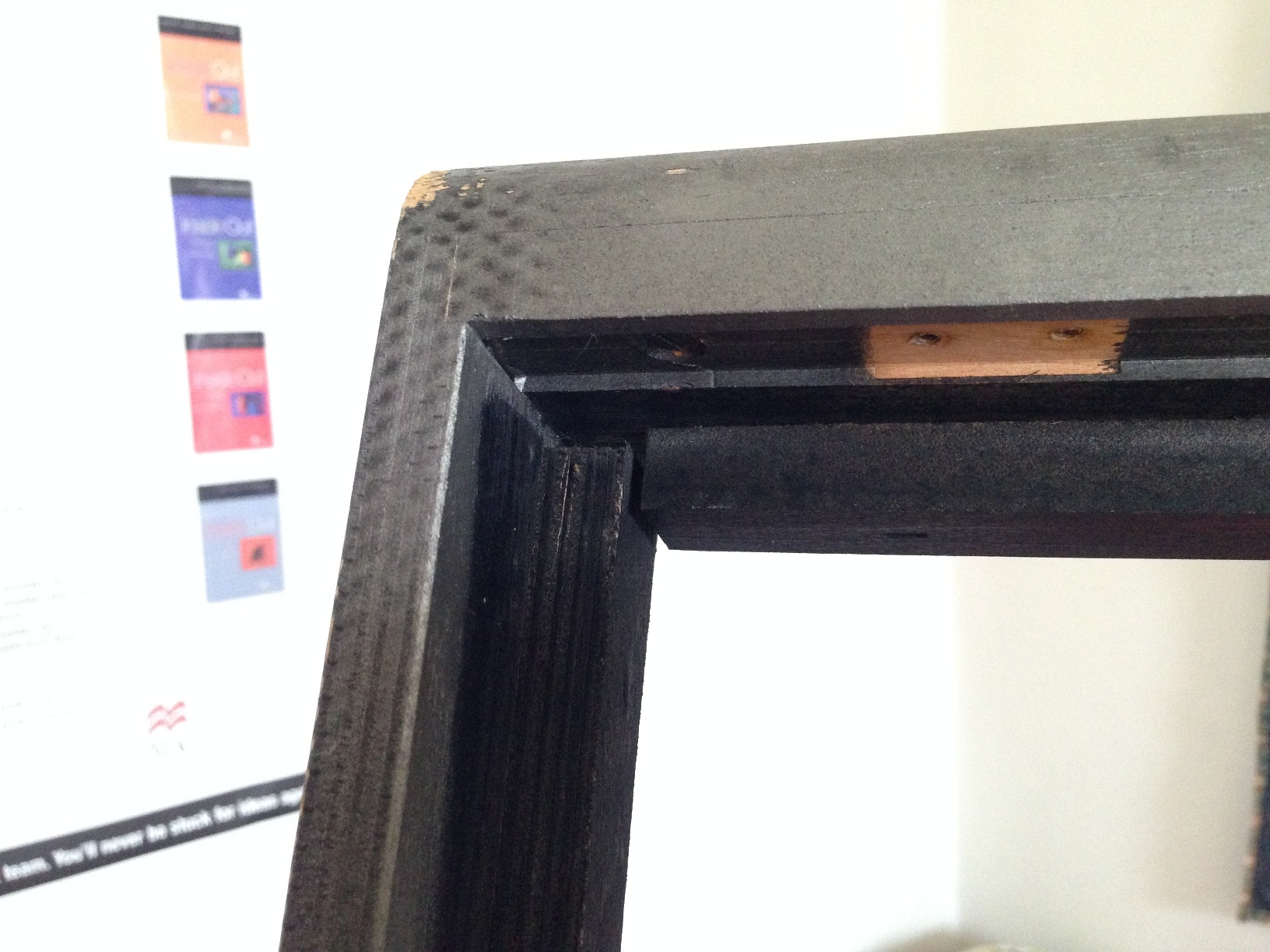

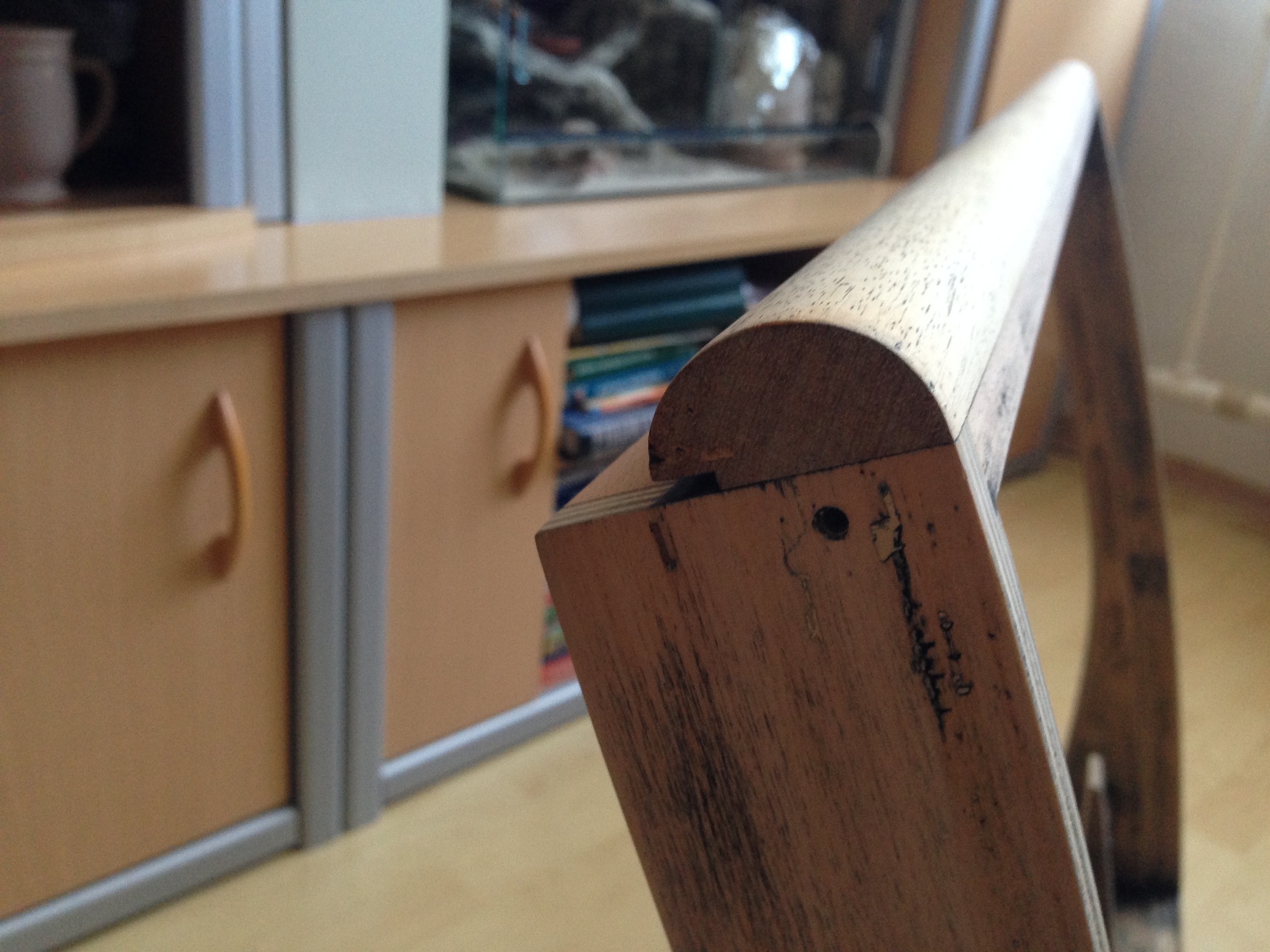

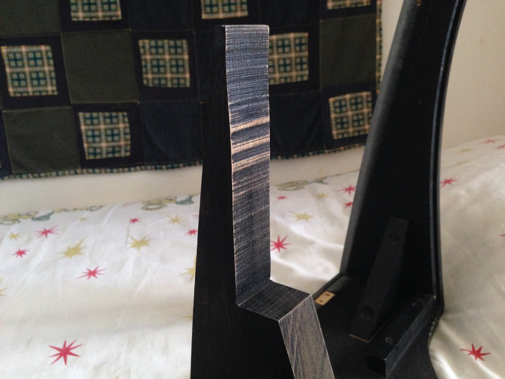

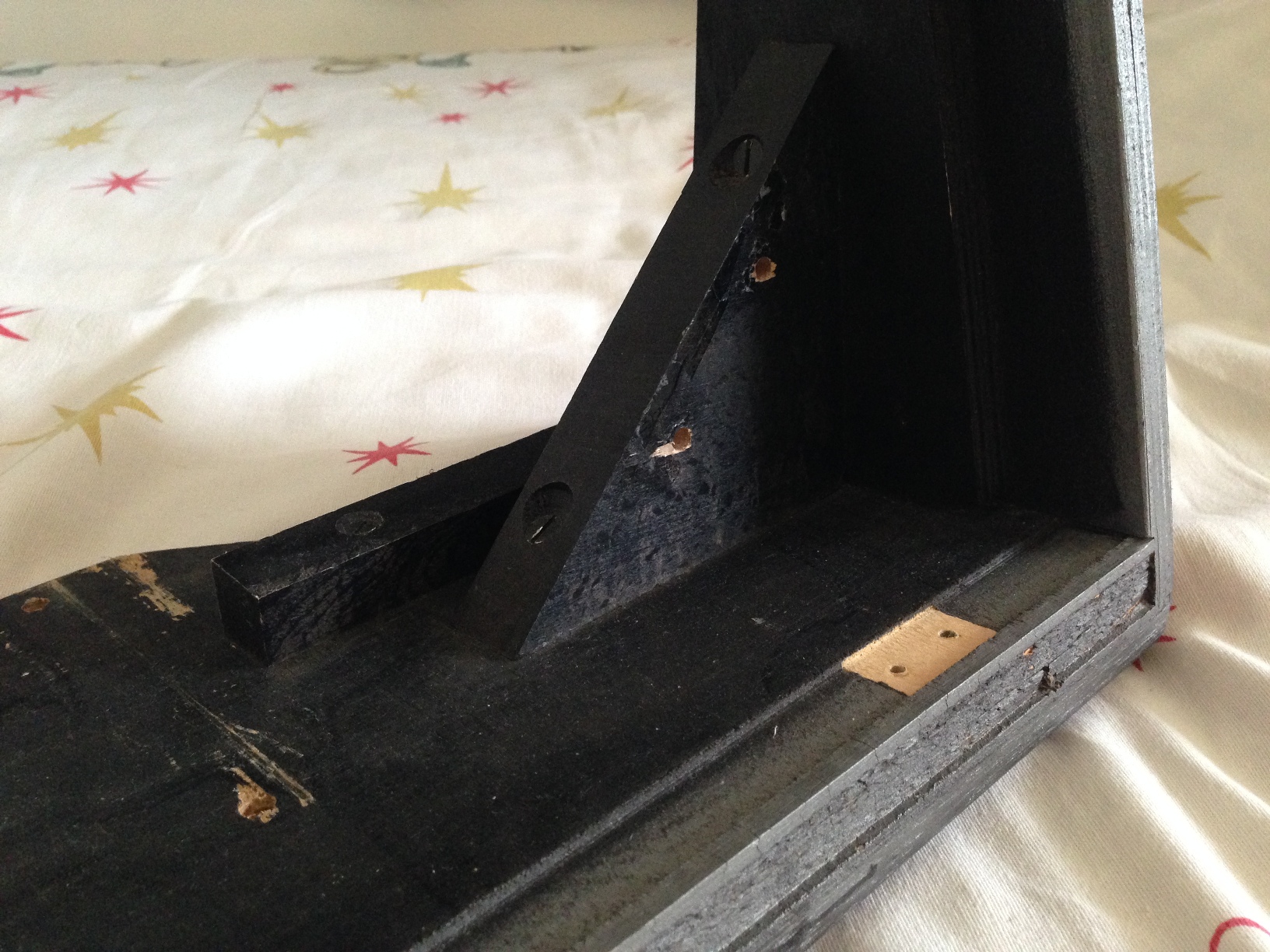

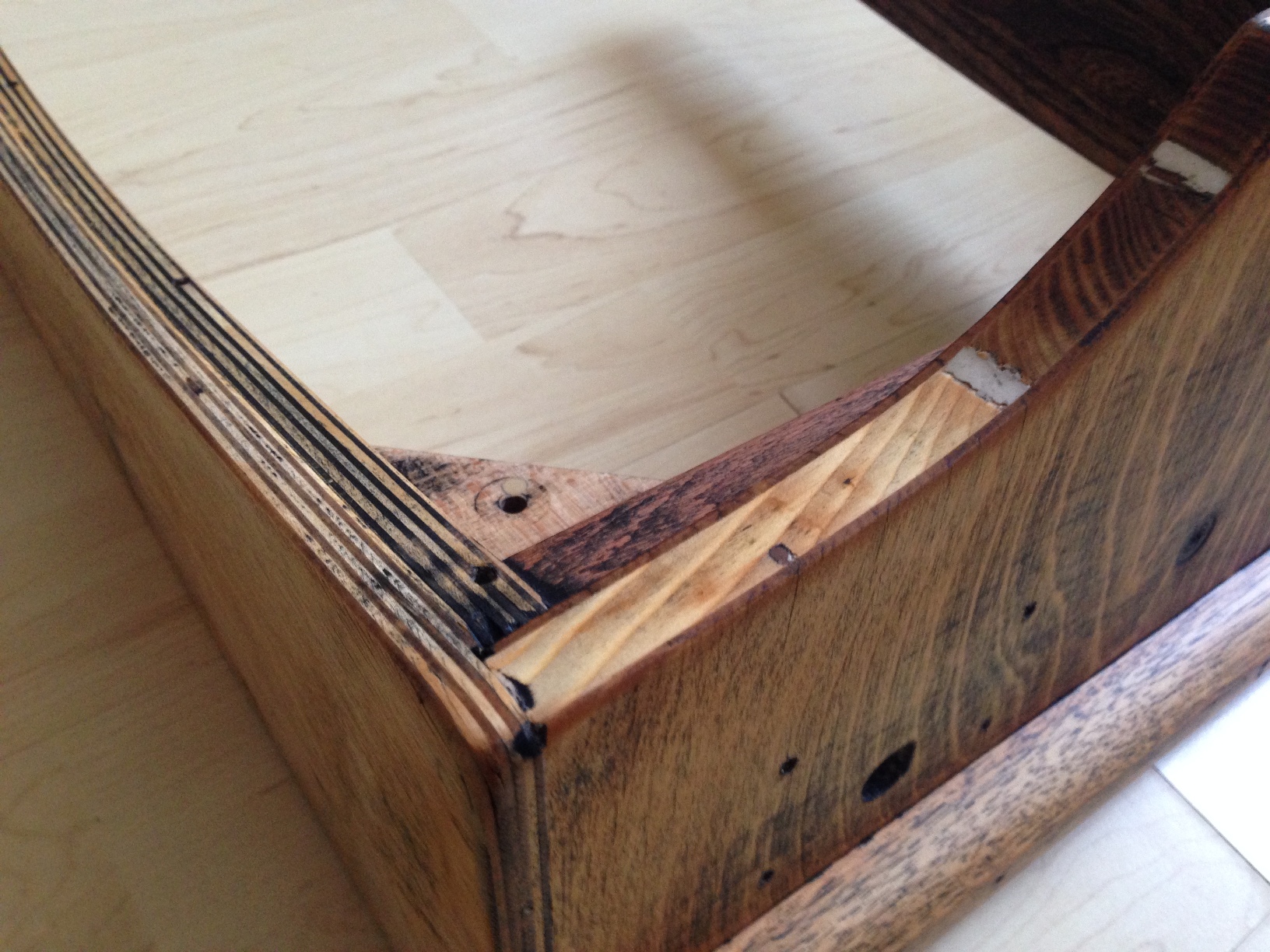

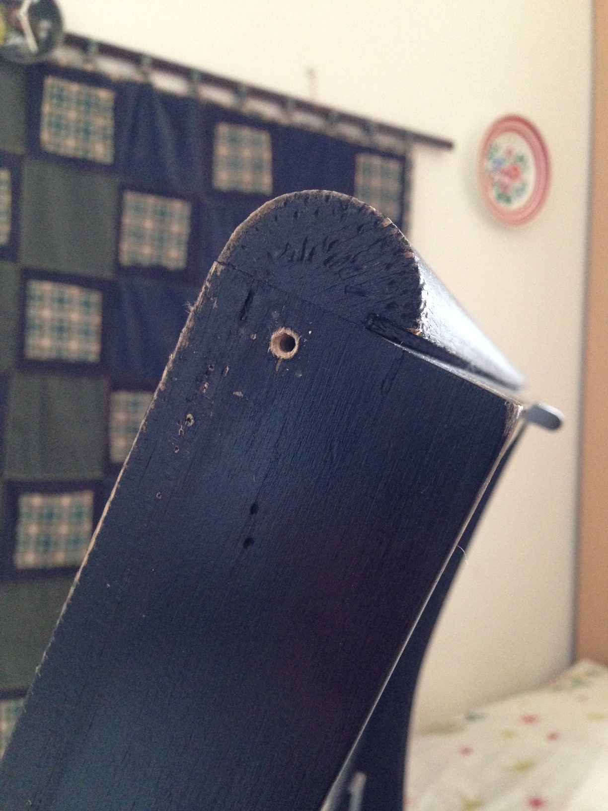

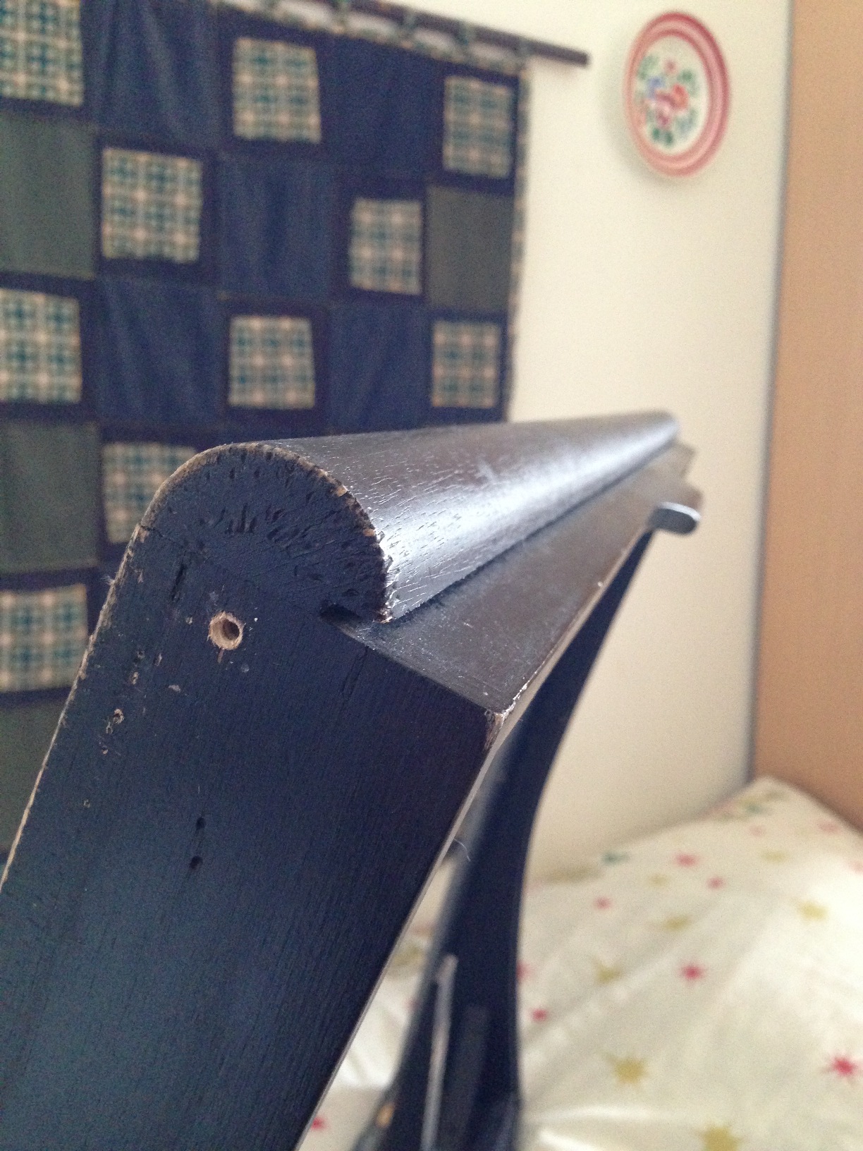

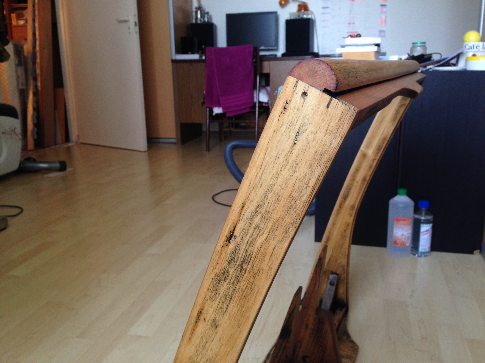

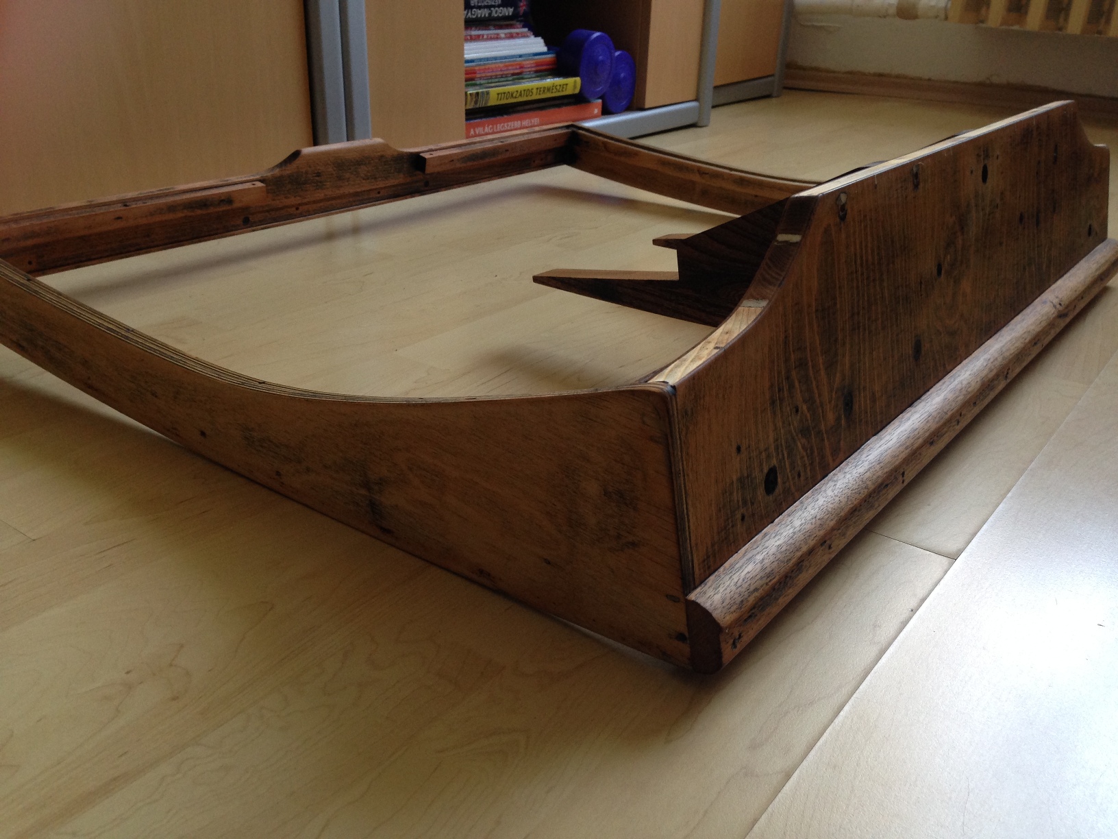

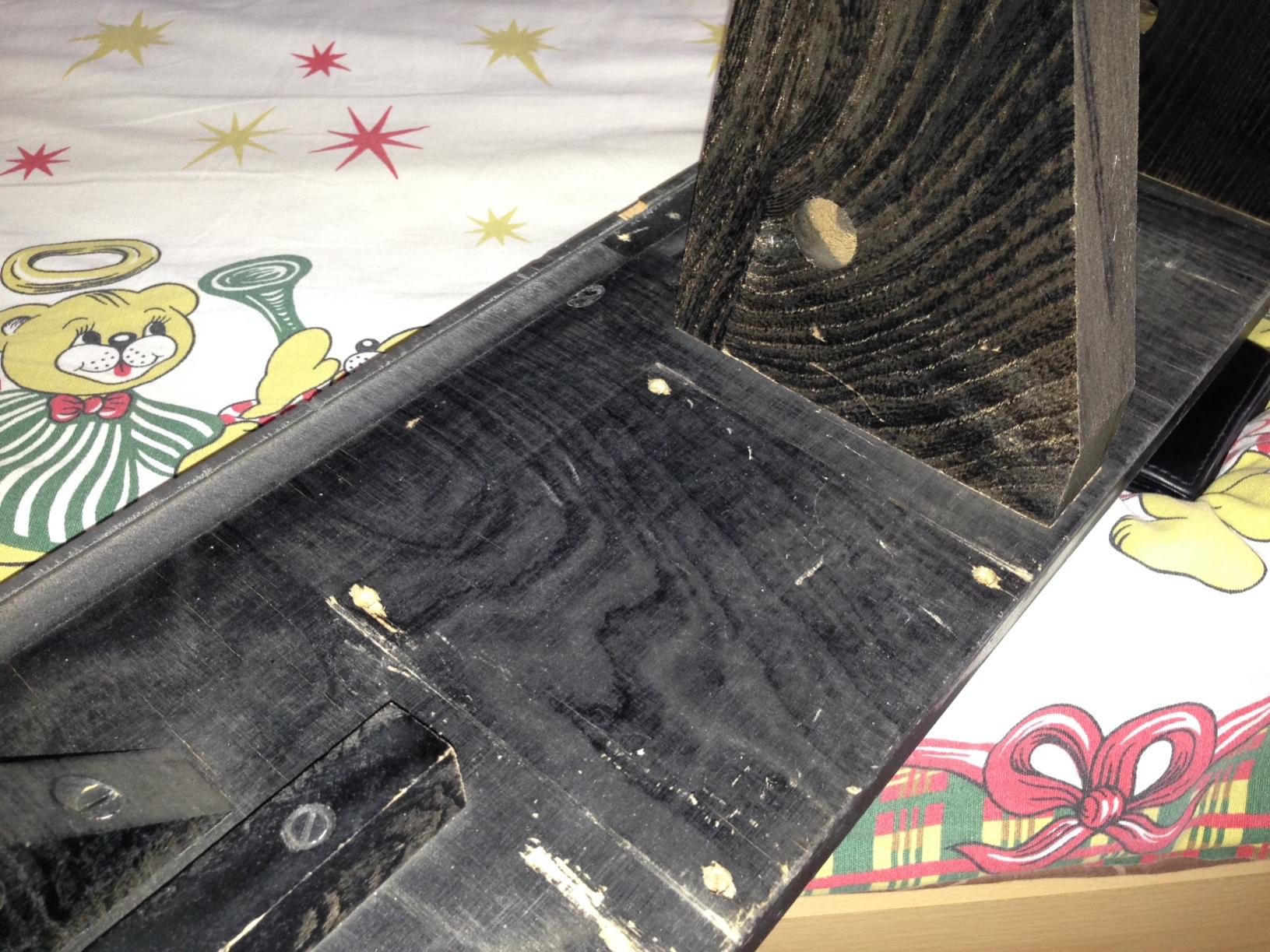

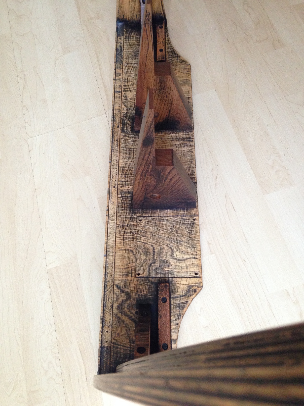

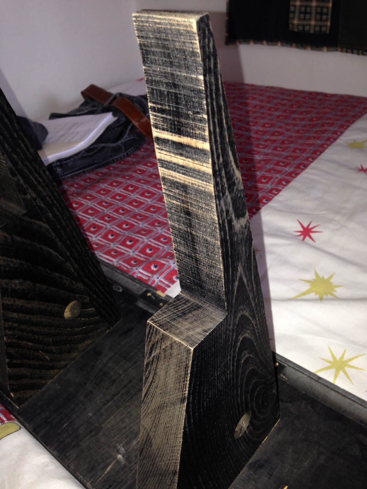

Frame
This was after 2 days of sanding without any e-tool. I am not planning to do it again in the close future...

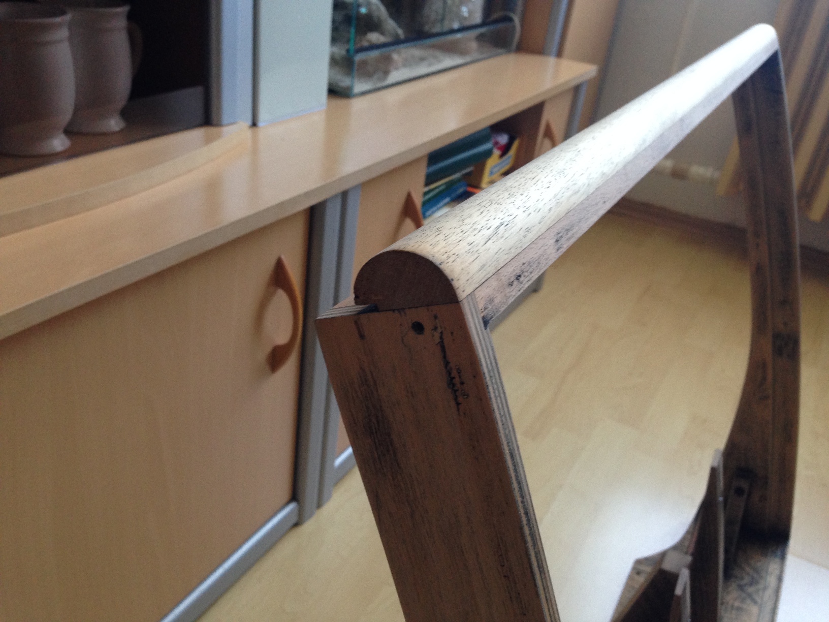

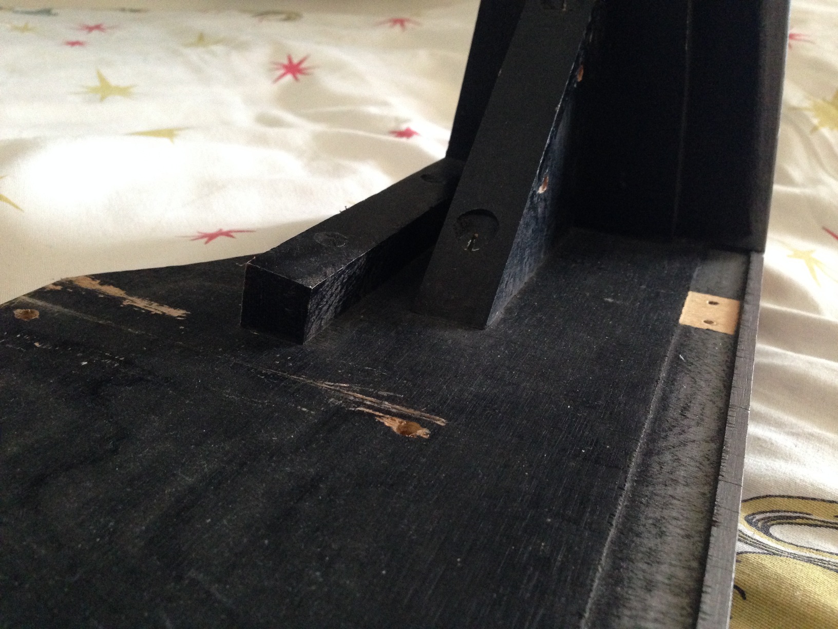

Frame
I used a very little amount of linseed oil this time, not to mess up the acrylic finish at the end

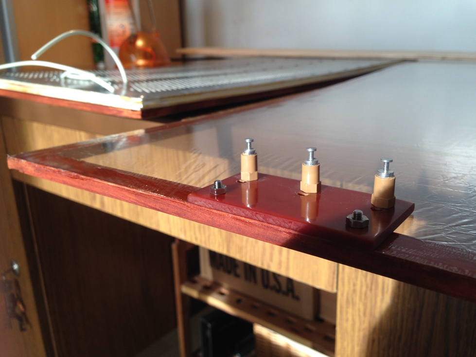

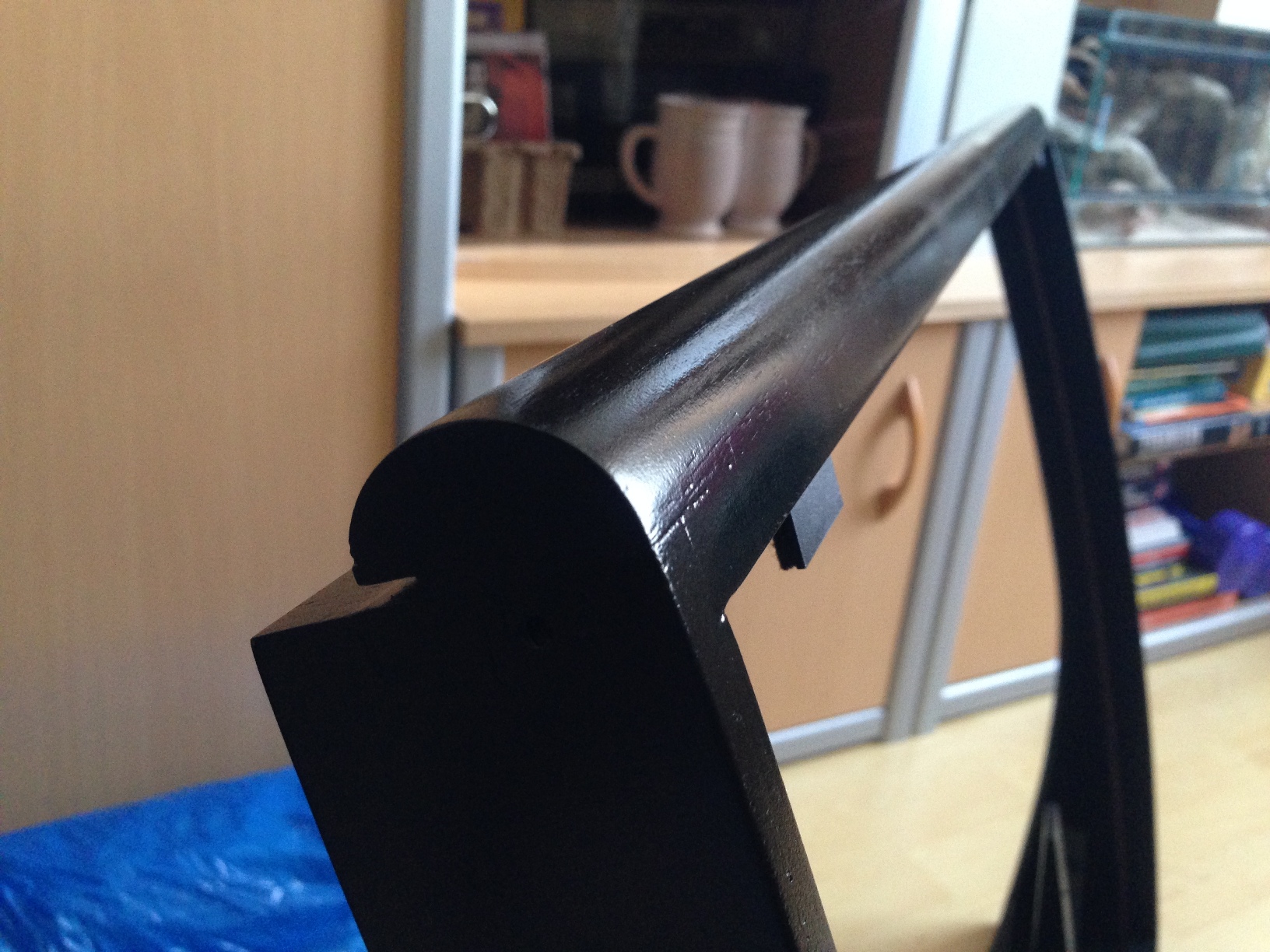

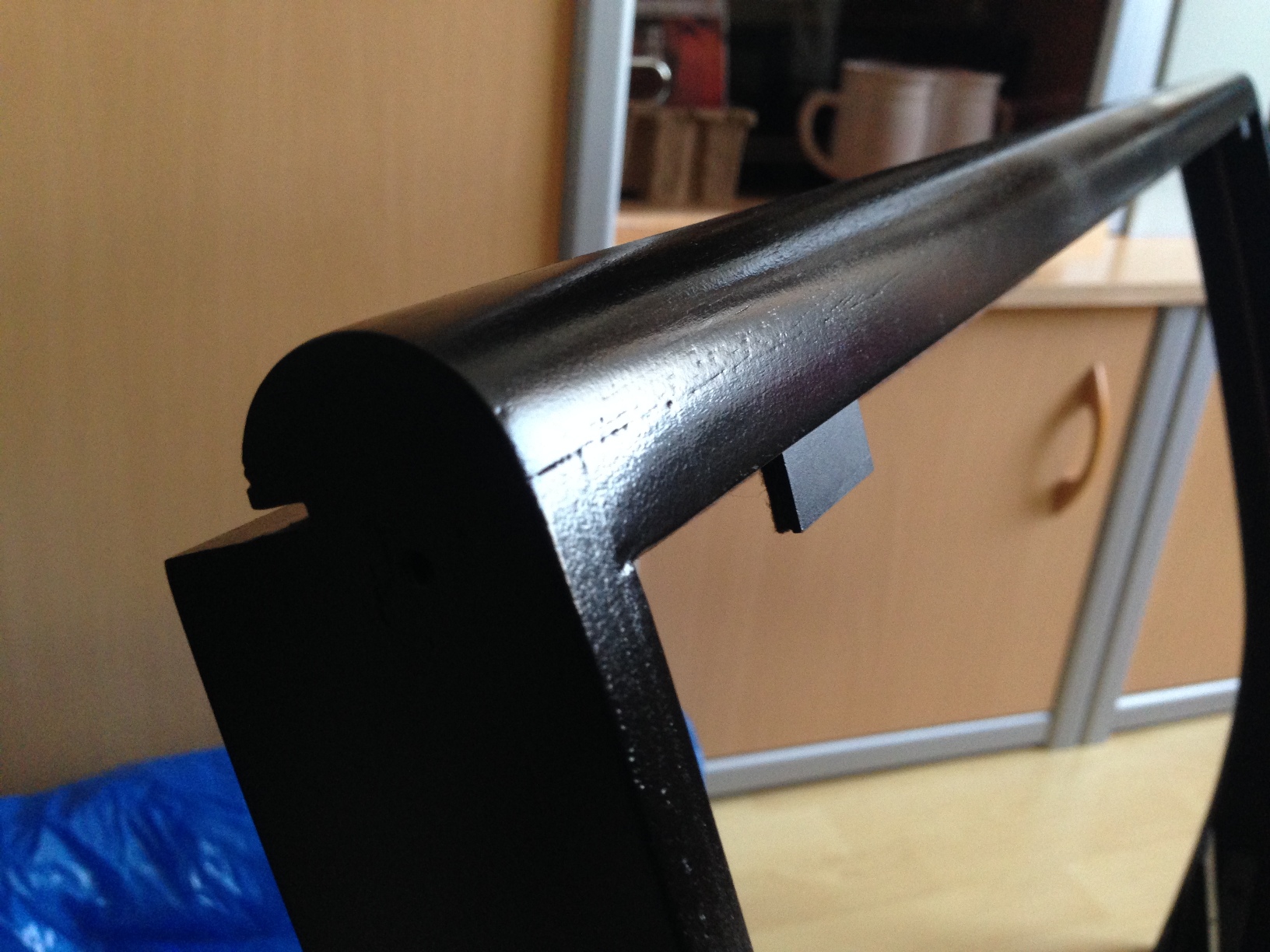

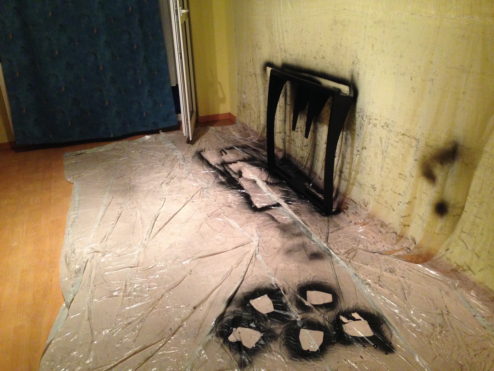

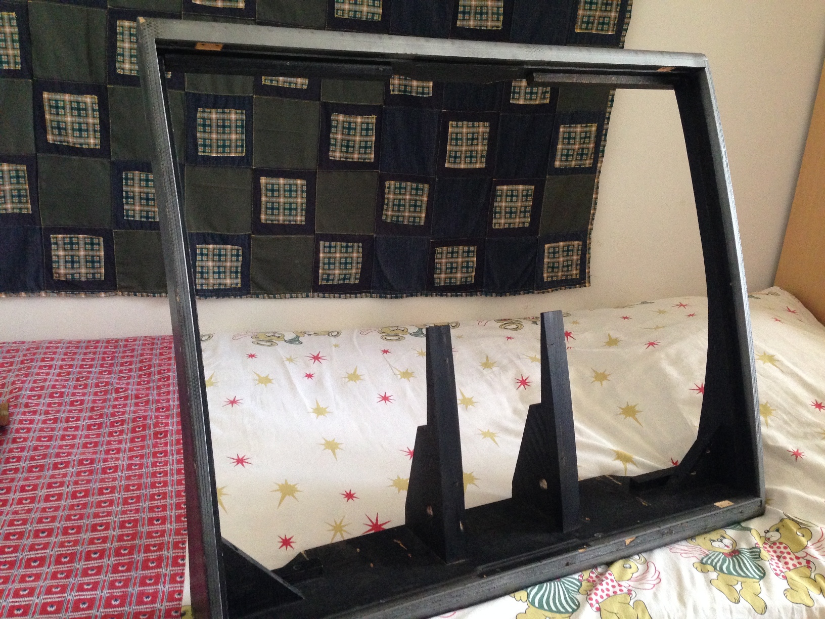

Painted frame
Managed to paint the frame. This time, I did not have any problem with too much oil, it worked well.

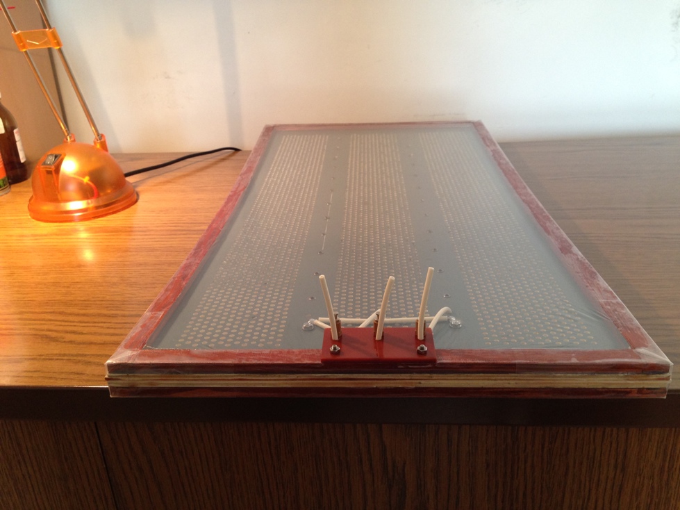

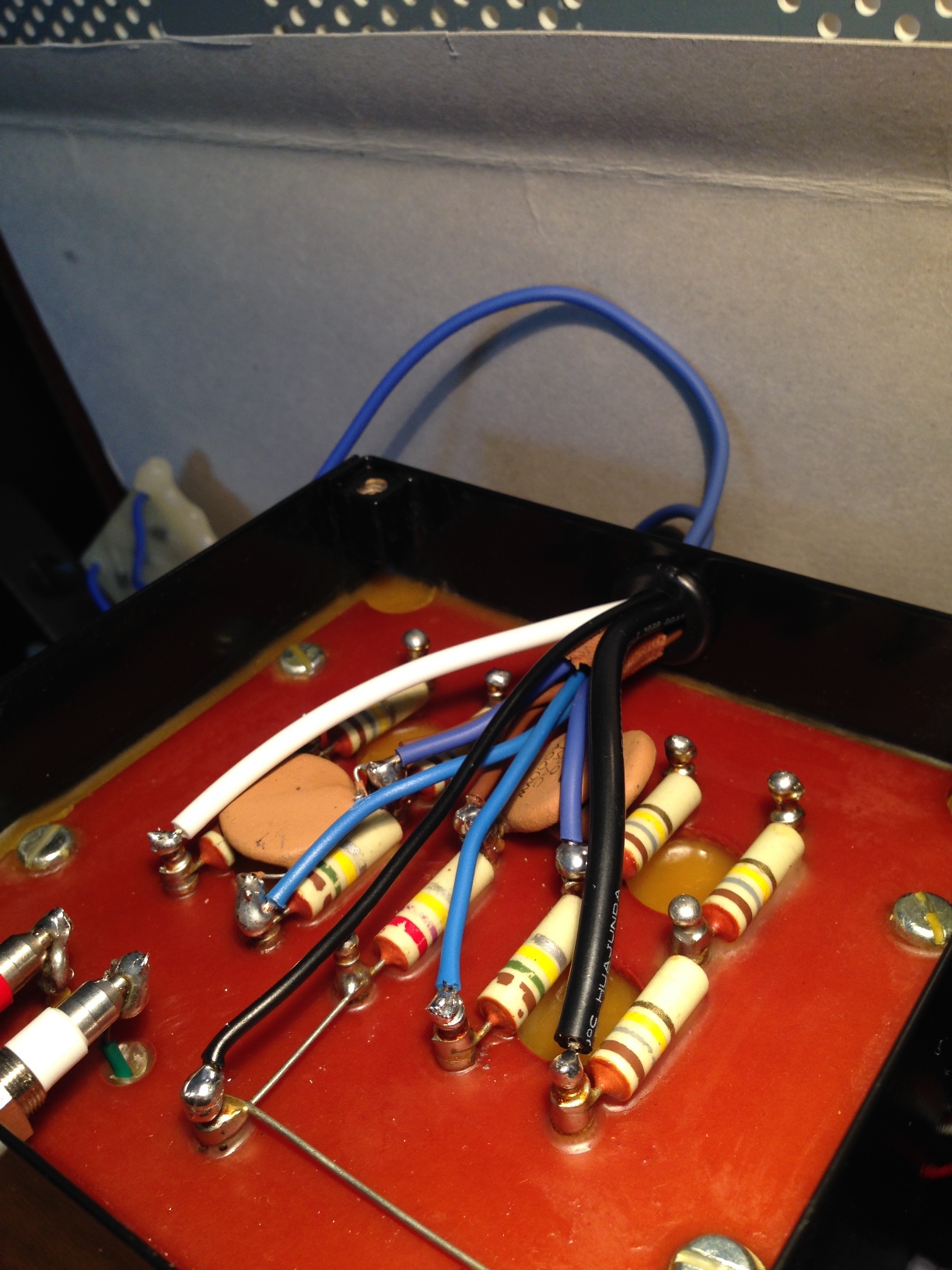

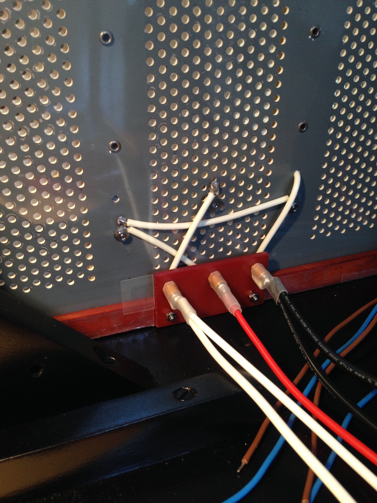

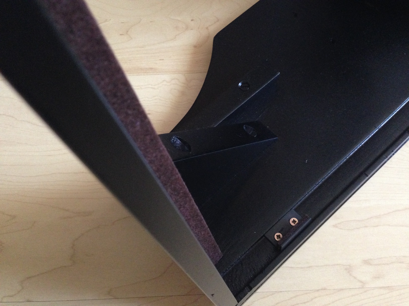

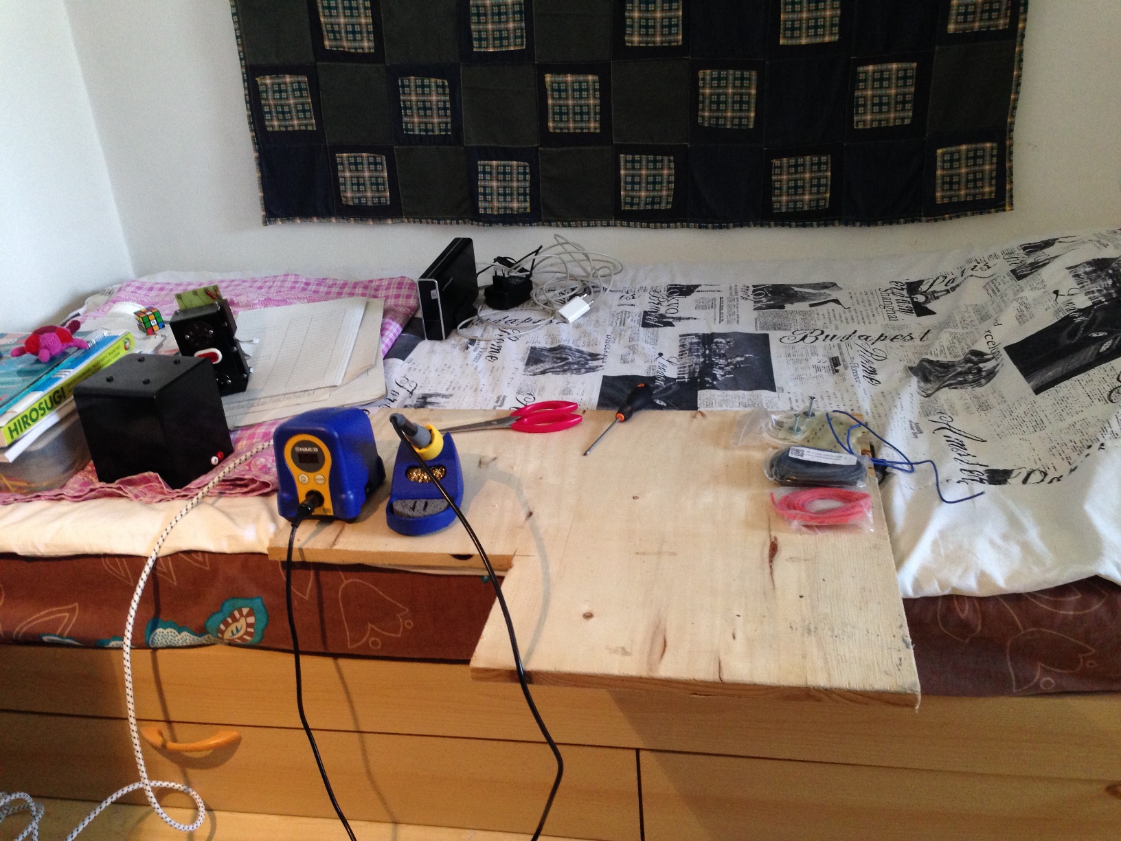

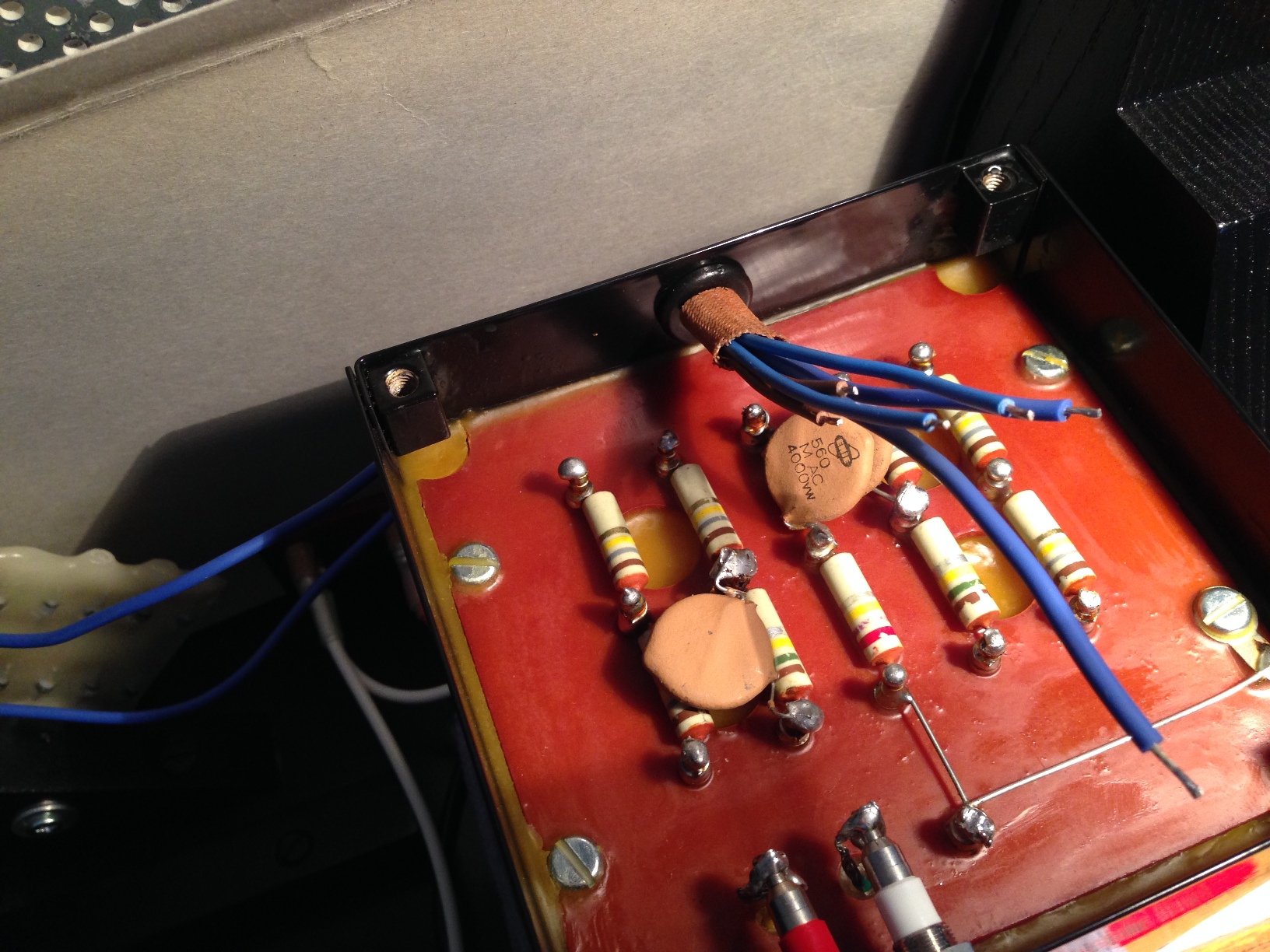

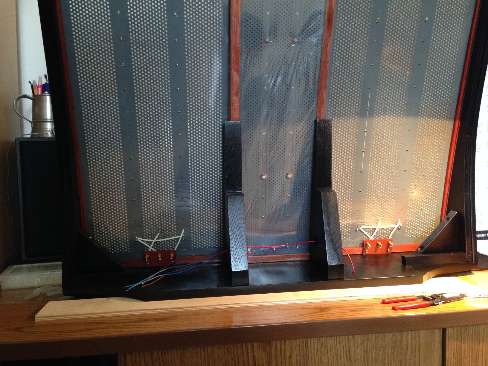

Wiring
I made a mistake while I was heat-shrinking the connections; unfortunately burned a little hole next to the tagboard. Now, I know the purpose of the missed out extra tape at the bottom of the bass panels...

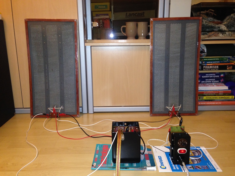

Now, my "impressions", if I can say:
I am not happy. Unfortunately, the right bass panel (viewed from the back) is leaking at the bottom. This is only an assumption, but I think I punctured the insulating tape with the wooden dustcover frame that pressed hard against a rivet while I was assembling the panel into the frame. I assume this as I remember, the dustcover frame's alignment weren't that precise so the edges touched the rivets.I found out that there is a permanent faint clicking noise (about 3-4 per sec.) from the bottom of the panel when my ear is next to the grille. However, the unit charges up, but the treble get up slower than before.
I will do additional tests in the future, like the neon-bulb flasher test for leak, but I do not want to bug the speaker for now, I fed up with the task for a while.

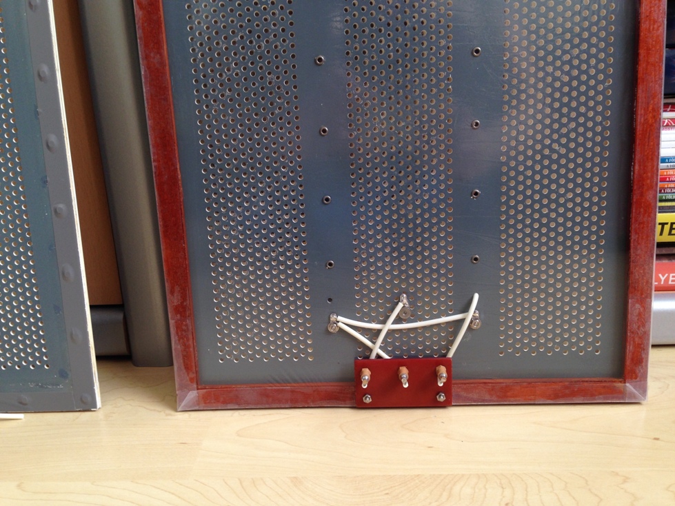

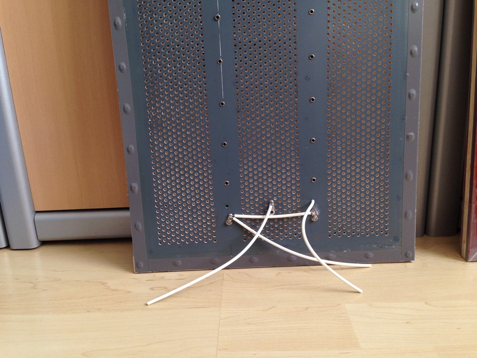

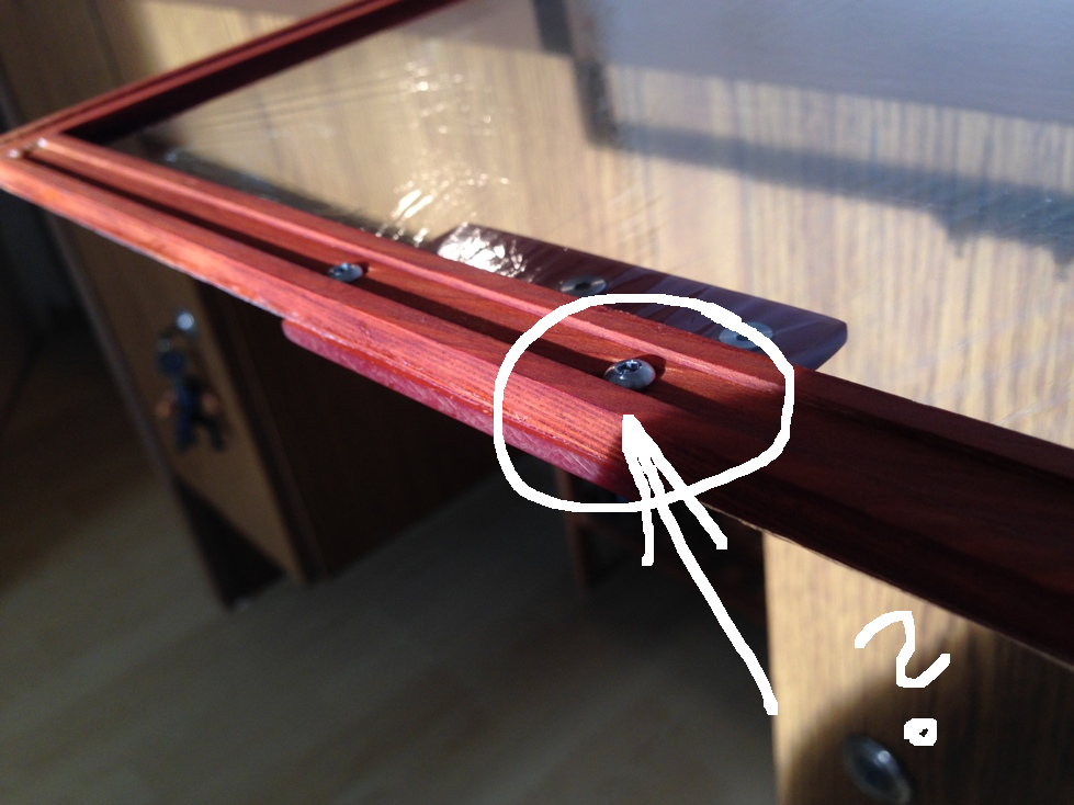

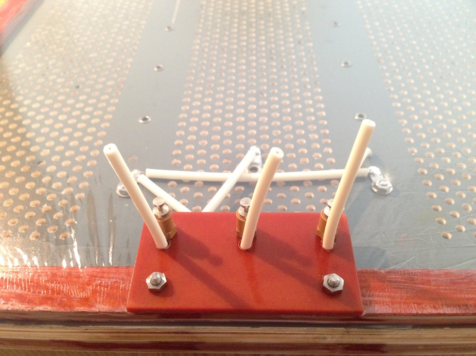

I've checked the faint clicking more closely today, and I assume that it may be come from the tagboard rather than the front. So, I assume that one or two of the rivet or rivets and these tagboard srews touches each other, hence the 'leak'.
Maybe I could try to fasten more these nuts from the outside to see if I enlarge the distance between the rivets and these Ti srews would help me to solve this matter?
I can happily say that after tightening these screws solved the discharging (leaking) problem (permanent popping sound disappeared completely) so I didn't have to take the speaker apart completely again, thank God...
Nonetheless I made some panels for that purpose, I haven't done any neon-bulb tests yet. I think that there isn't any intensive discharge path anywhere as the units get up very fast from zero and they play almost at the same level after 30-45 minutes of being plugged out of the mains. I do not know if my analogy is good.
The treble from the last side is still a bit shy, as the bass at the other side but that could be that It had been discharged for the period of works for 2 and a half months, so time will help, or that could be the unevenness of the coating I saw when the panel was 'naked' compared to the coating evenness of the other panel in the other speaker. Maybe it's just a placebo as the difference in sound (at higher frequencies) is barely noticable between the two speakers for human ears. (I mean when I play mono rec, the sound is almost coming from the origo between the two speakers).
Anyway, I am satisfied with the results. Repainting (paint-patching) the bass panels hasn't made any difference, it plays great as before. The speaker sounds the same that is not a bad thing at all.
So, maybe the whole project wasn't neccessary at all, but was a great journey. I am aware that swapping the diaphragms to new and tightening, coating, heat-conditioning them with the correct factory solutions in all the panels would make a big difference but I think I do not have the proper knowledge and tools for a project of this altitude. That part would be better done by the professionals those have the know-how and materials, etc.
