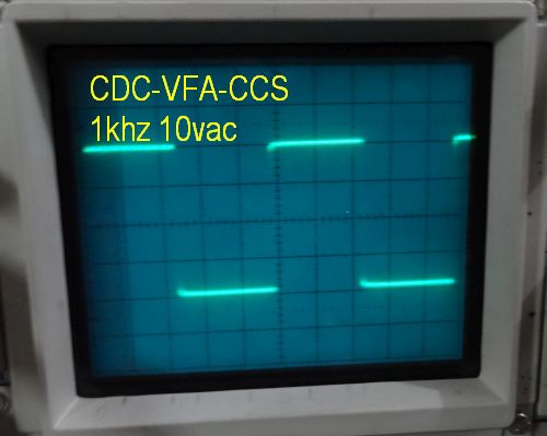

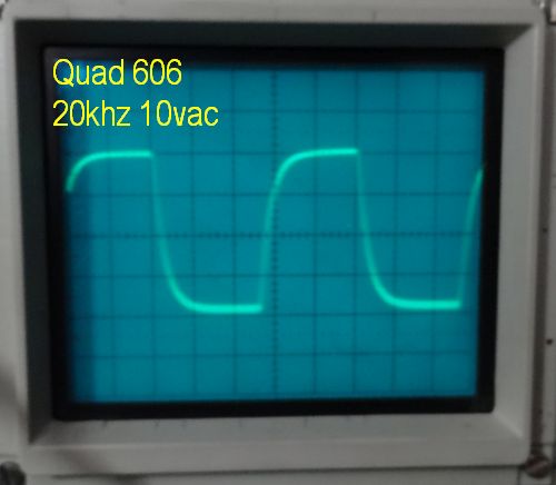

Ah..just one more idea..I'm doing re-cap job and have a lot of time to think..
So basically..before you put 47K inside current was to high which resulted in saturated, distorted sound....now you have resistor, current might be too small and the result is no bass...
Now there is 47K which was used in old version of Quad520, but there are 2 12V zeners used and you have 2 6v8...so maybe it is worth to try and reduce that 47K to some 24k...I would go with let's say 33k first and check......but do't go lower than some 22k
Just quick idea...
Just quick idea...
Terry one more thing.
Check the value of R5. Maybe 12k instead of 120K ?
R5=120k

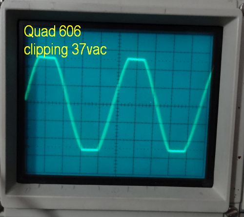

The amp clips at 37vac into 8ohm load. That's 170Wrms. Not shabby
Scope shots as promised.
37V...that's decent...op stage is obviously opening...
i would try that 47k to 24 k or something..and see the bass..
Otherwise I would wait till J503's arrive and than see what happens..
Ah one more thing. Have you removed 1n cap from upper side? Itmight be responsible for that crossover node.

Yes, removed the 1n cap.

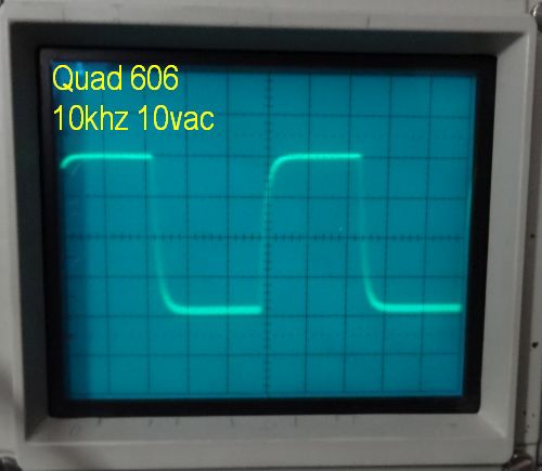

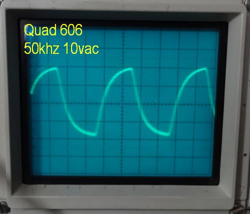

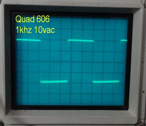

I'll wait for the J503 but I will be surprised if that changes much in the voicing of the amp. These shapes have been constant throughout my testing. The node is gone but the square wave shapes are the same. It maybe due to some of the other choices I made for transistors. I'm not knowledgeable enough to know what sets the voicing.

Aha..at least node is gone..that's great.

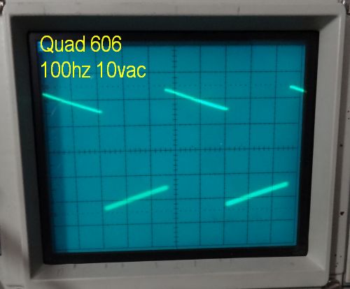

Well my guess is that current is too small through input stage now. Maybe for test just add another 47k in parallel with the first one. If it helps you are on right path. I assure you 606 has really good bass and it is overall really nicely balanced...

Well the J503 is rated at .56mA. I have 6V across the 47k so that is .128mA. I'll try a lower value and see what happens.

I added a 47K so around 23.5k. I see 5.9v across it so that is still only .250mA so If your theory is correct, I need somewhere around 11k if the 6v holds, to see 5.6mA, though I don't know for sure that that is how the J503 works.
I may try a lower value but so far the waveform shape hasn't changed at all.

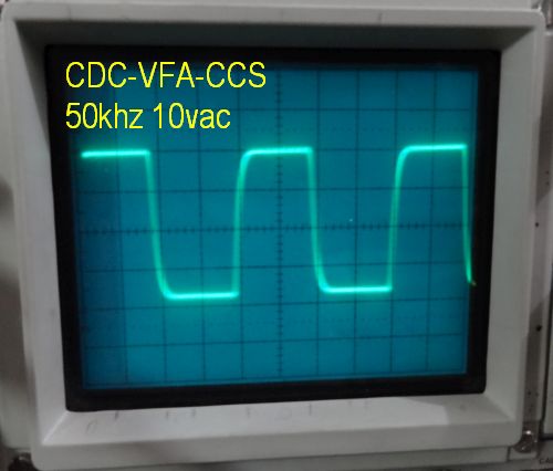

I tried adding a 27k resistor but the node is back. After further inspection the extra 47k resistor brought back the node. The original 47k was all that was needed.

When you have passed the tests, you should connect the amp direct on line.I will try replacing E701 with 47k and see what happens. Besides the distortion the square wave show a weakness in the bass response.

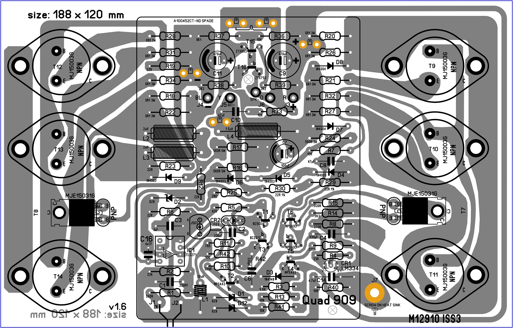

I wonder if my inductors would have an affect on the voicing. I didn't use any kind of scientific method of winding them and I don't know how to measure them. Anyone have an opinion on this?
Thanks, Terry
Thanks, Terry
There are various online calculators, what you need is diameter, thickness etc...and here you go. Even some phone apps will do that. Results are not perfect but close enough for testing. And if you are let's say in +-20% range it probably won't affect sound too much. Just my guess.
I'm not sure of their function but if they are there to curb oscillation they are working OK. If they affect the voicing maybe I should try to get them a little closer to spec.
