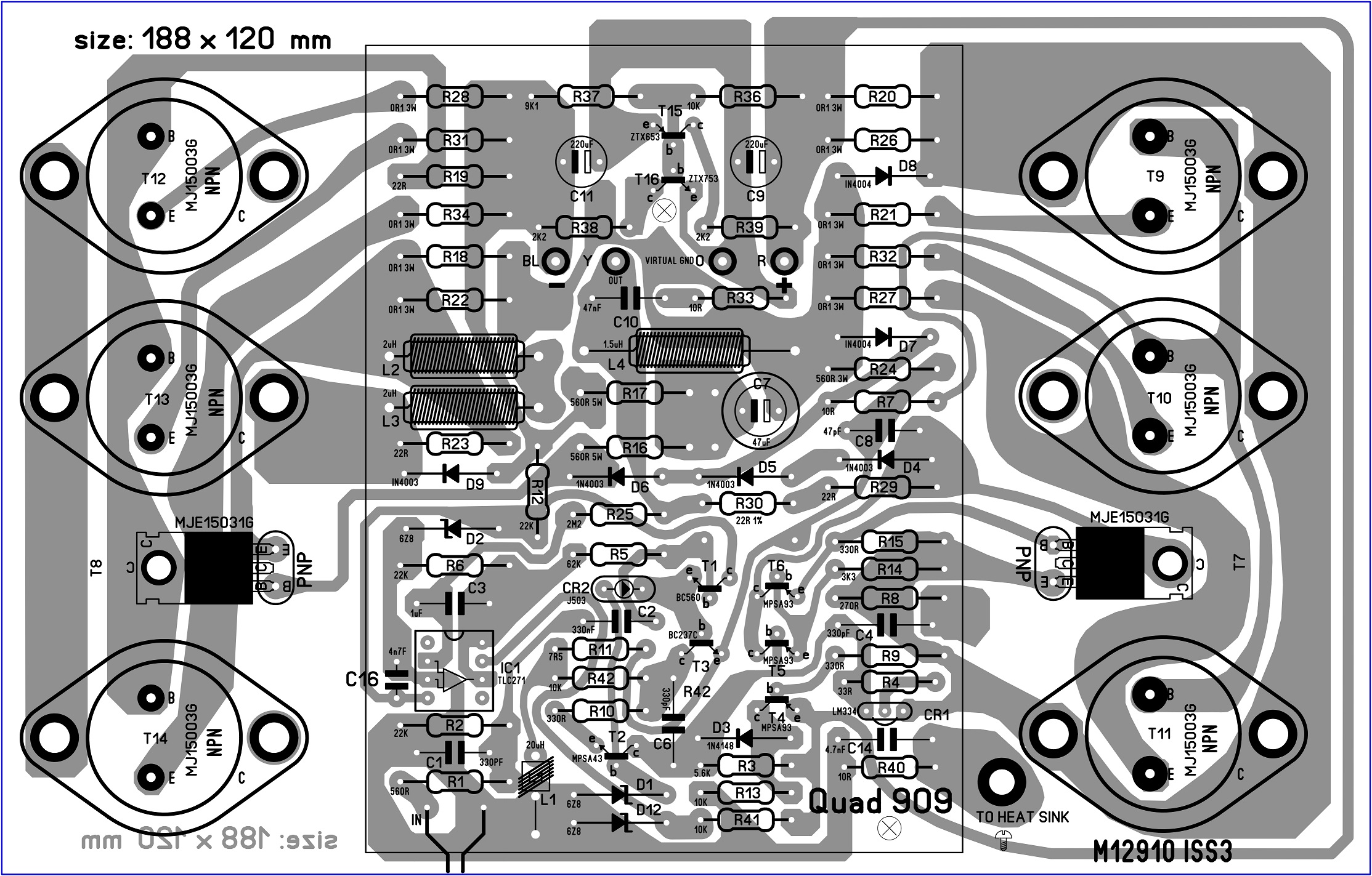

Hello guys
I was reading here and there and I decide to give a try and make a layout from some images that were posted here, here is the Quad 909 the layout is about 120 mm x 188 mm this might not be as accurate as the original one but I decide to post it here please if some one that know well the design can check for errors or possible modification that I do not know about it I will really appreciated any help, I'm just a layout fanatic and I love what I do, I also simulated the circuit in multisim and I think responds really well I mean I'm not an expert but I know the circuit will behave correctly the only components I was not able to place on the simulation is CR1 LM334 and CR2 J503 what I use on the simulation for CR2 is 1N4148 it does work but I think should be there a 500uA controlled current and for CR1 I use a fix resistor "not correct" but I didn't have a choice 😛

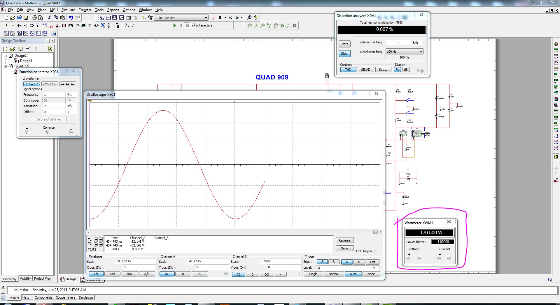

oh so center tapped can be use ? I thought was not possible because of T15 and T16 virtual GND circuit uhmmm ? interesting, I will check that out on the simulation

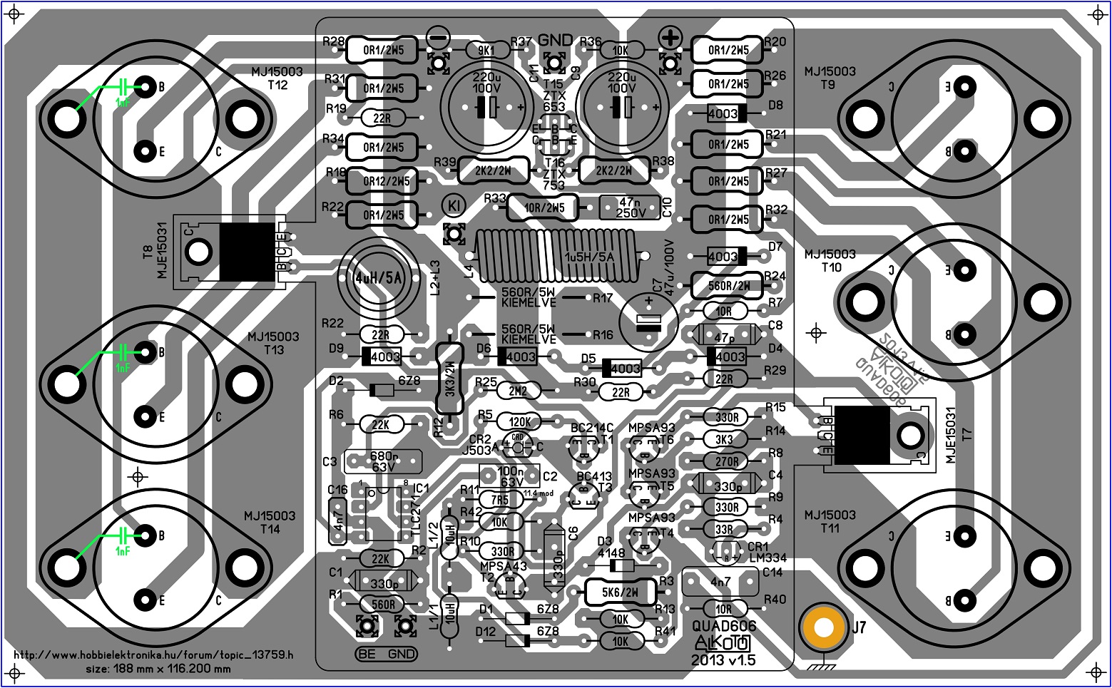

Hi Guys,
I built the Quad 606 from files Juan sent me. I am seeing some oscillation at about 3Mhz. The output inductor is getting very hot. I made some part substitutions based on what I had on hand. These may be causing it so I thought I would come here and ask. If I should start a new thread let me know and I will.
These are the substitutions I made.
2n5551 for MPSA43

Try 1n foil capacitor across T12,T13,T14 (base-collector). One capacitor for whole group. It helped at my clone. Check output zobel C10,R33. Check all grounding. Are both channels the same? I mean oscillation?

Ah.one more thing. MJE15031 might be too fast. Try something slower like BD244. I would generally recommend nice old and slow transistors here. Also T5 and T6..high hfe and really fast transistors will cause trouble.
One more thing crossed my mind. Do you have grounded heatsink?

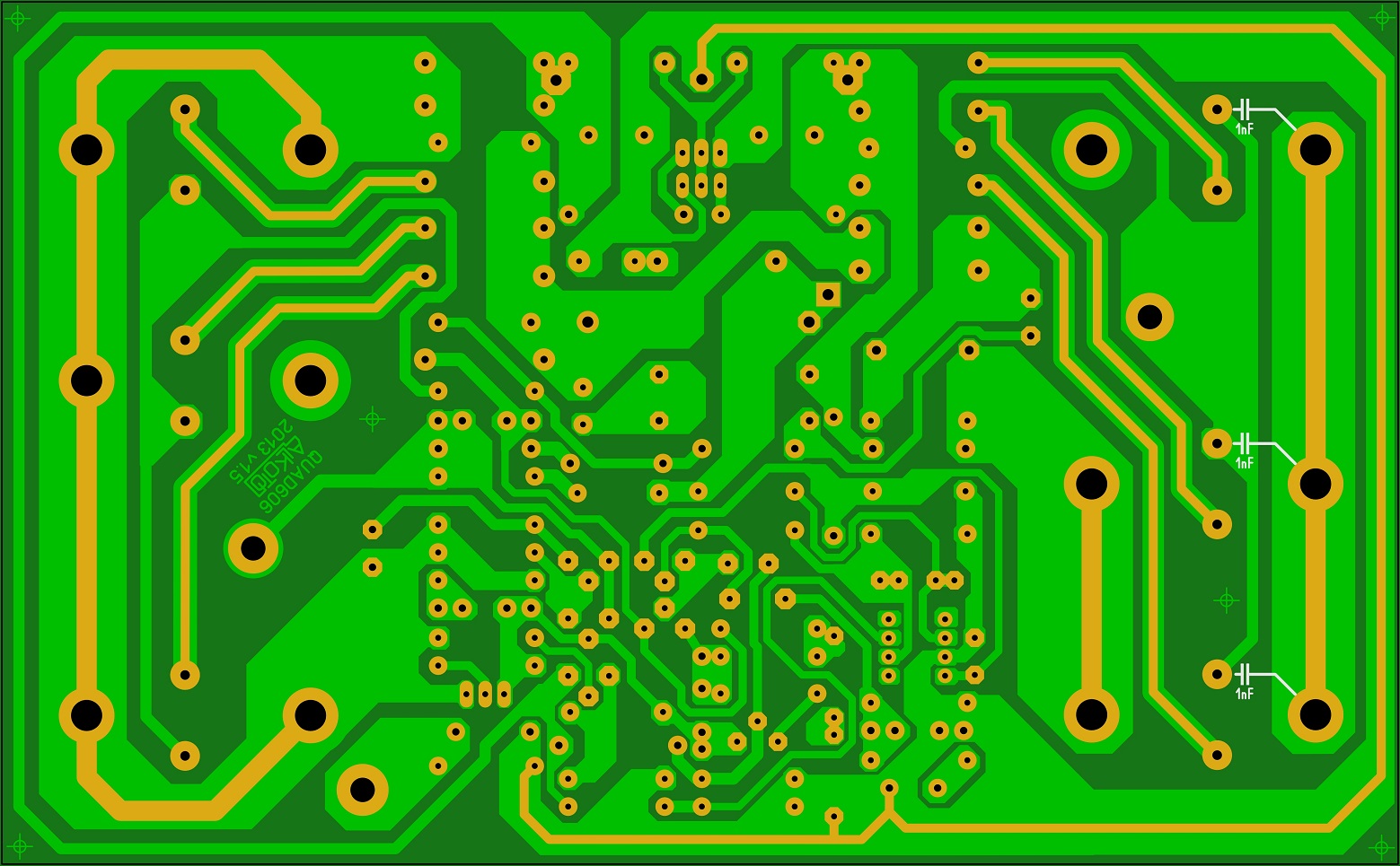

so it will look like this image sir ? 🙂
No no...just one for all three transistors. It helped at my case but it won't necessary at Terry's. I must admit that 606 is one of most problematic amplifiers I tries to clone...really nasty oscillating amp. But also one of the very best sounding. It is really really nice one.
One thing is really important or at least it was in my case. Proper grounding. Heat sink must be grunded. Don't try 2 sinks, one for each group of outputs without attaching together.

oh ! I see now, only one 1nF cap for all 3 power transistors got it 🙂
