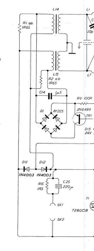

I think I have mentioned I'm modifying a '63 to run on external transformers, in order to easily switch between those step-ups and a direct drive amp.
Since I also run the thing with seperate subs through a DSP'ed multichannel DAC, I omitted both the 1R5 (R15) resistor and the parallel 220uF cap (C25).
To my big surprise, at the first test play, both of the1R65 (R1 ab and R2 ab) resistors in series of the xformer primary popped! (These were the original flat substrate resistors 2 x 3R3 in parallel). WTF??
Anybody have an explanation for that? Are the 1R5 // 220u so critical?
Jan
Jan
The 1R5 prevents large currents to flow into the Xformer at very low frequencies where saturation turns the transformer into a short circuit.
Obviously you must have had those very low frequencies because in my Quads I have shorted the 1R5 for more than 40 years and never had any problem.

Those resistors are quite reliable in my experience. But I always have the 15ohm and 220uf (with film bypass) in place.
You have low frequency energy, and a lot of it, or maybe some sort of DC offset?
Sheldon
Sheldon
Yes, it does make sense, but I have no idea what it could have been.
Start-up pulse from the Purifi class D amps?
No appreciable DC offset.
There is about 2 feet of HV wiring from the transformer secondaries to the stators, I wouldn't think that could cause oscillations?

Jan,
Did you ever had the 1R5//220uF still installed with your external xformer setup and if so what happened than?
Hans
Hans
C14 and the rest of that subsystem is not present.
I didn't have the 1.5R//220u on this system. It is in a non-modified speaker, driven by the same amp, and never had the problem there.
I should also mention that the system played fine at low level during initial testing.
I then turned up the level and - poof!
Jan

C14 is part of the impedance shaping circuit, so you really need that one.
Without, imepance at around 20Khz will be very low.
Hans
Hans
Thanks Hans, I missed that! I thought it was part of the limiting circuit...

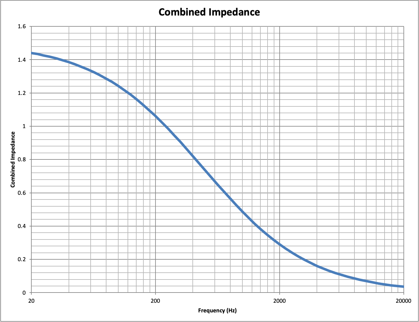

The resistor without the cap isn't a great solution either, as the combined impedance isn't anywhere near flat
Sheldon
Sheldon

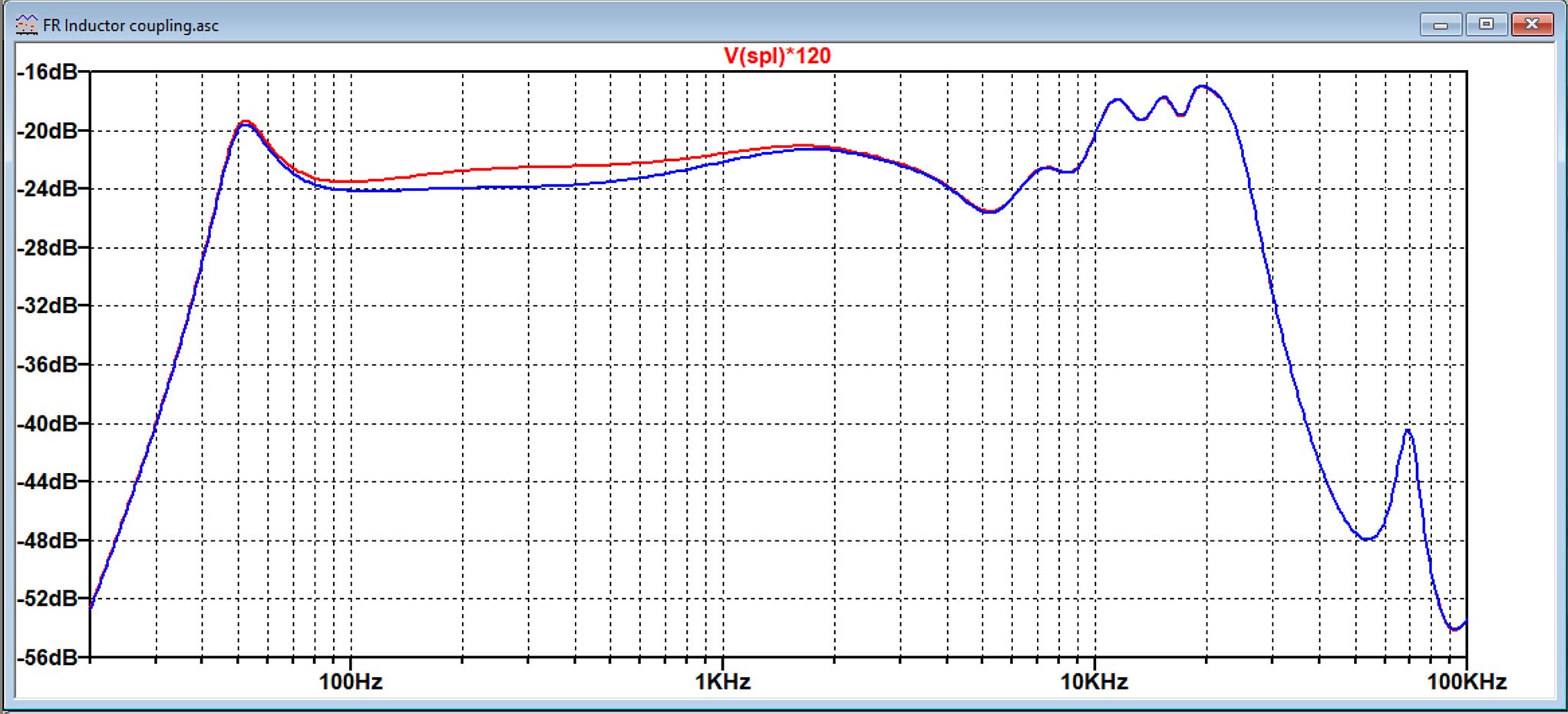

Actually, without the cap the electrical response on the stators rises above 10k.
I'm rolling off the response in the direct drive amp.
So without that cap I may be able to delete that DSP rolloff.
Or partly.
Jan
response
Or partly.
Jan
response
Looking at it from an attenueation point seen from the amp to the speaker.
Assuming that the speaker is nominal 4 ohms (just to get an idea), at DC the attenuation of the output signal is 4 ohms/ 5.5 ohms or about -3dB.
For a high frequency where the cap shorts the 1.5 ohm, the attenuation is 0dB.
So the most the cap does is +3dB at 20kHz.
I can easily take care of that.
Jan
Jan
That's a good point, there is some phase shift associated with it too. Not sure it matters at all, but if it did, you could also take care of it with your DSP as well.
Sheldon
Sheldon
