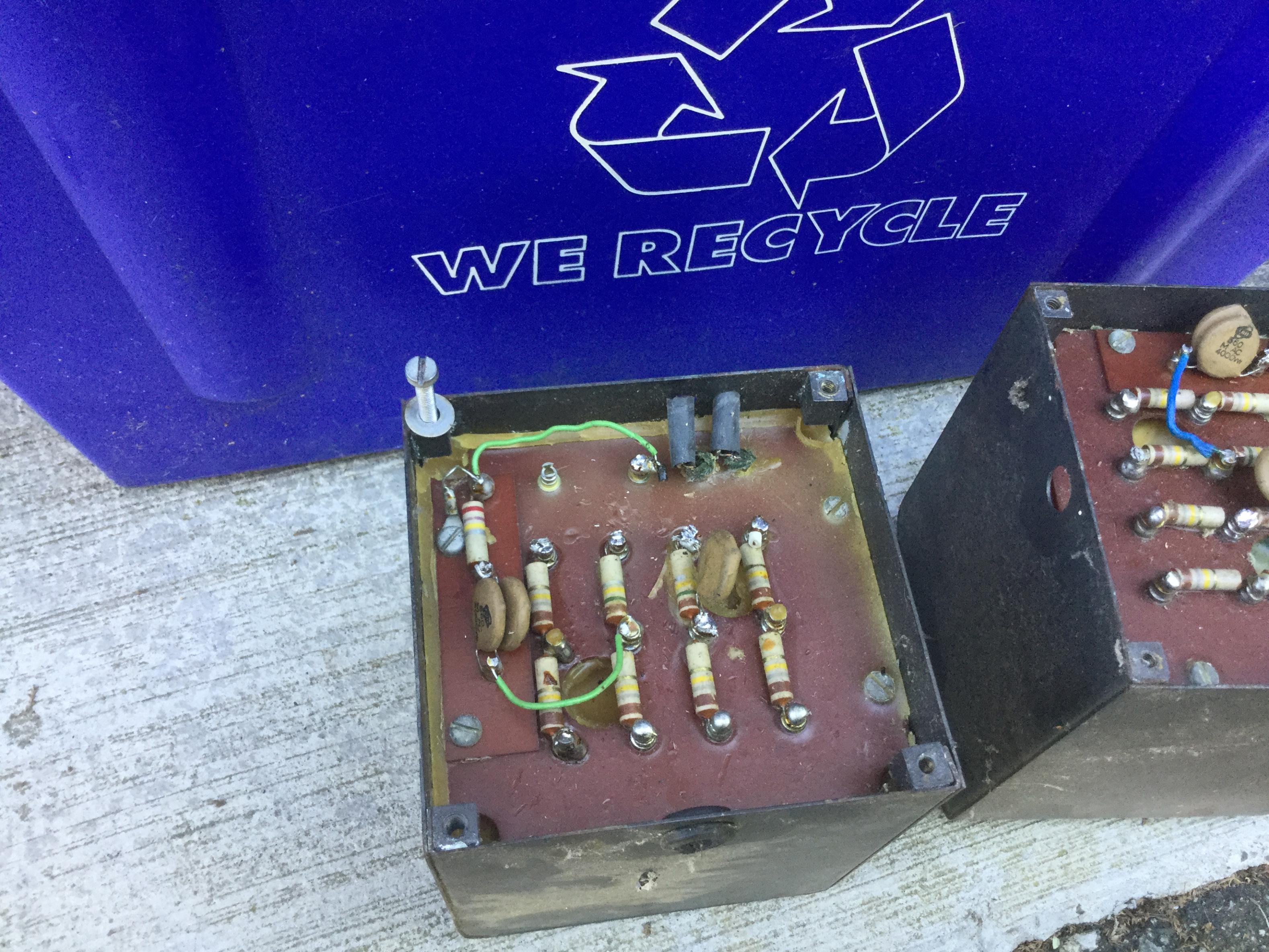

1) There used to be some information online from onethingaudio about the input transformers and ways you can check the capacitors and resistors by checking voltages across pins. Does anyone have that information?

1. Those components never fail, but they could be roughly off tolerance (maybe +/- 25%), it does not make any difference IMHO. I swapped the 560pF capacitors on mine for polystyrene types, but can't hear any difference.
You can desolder them and measure on an LCR meter, not in service. I wouldn't care unless a component is physically broken.

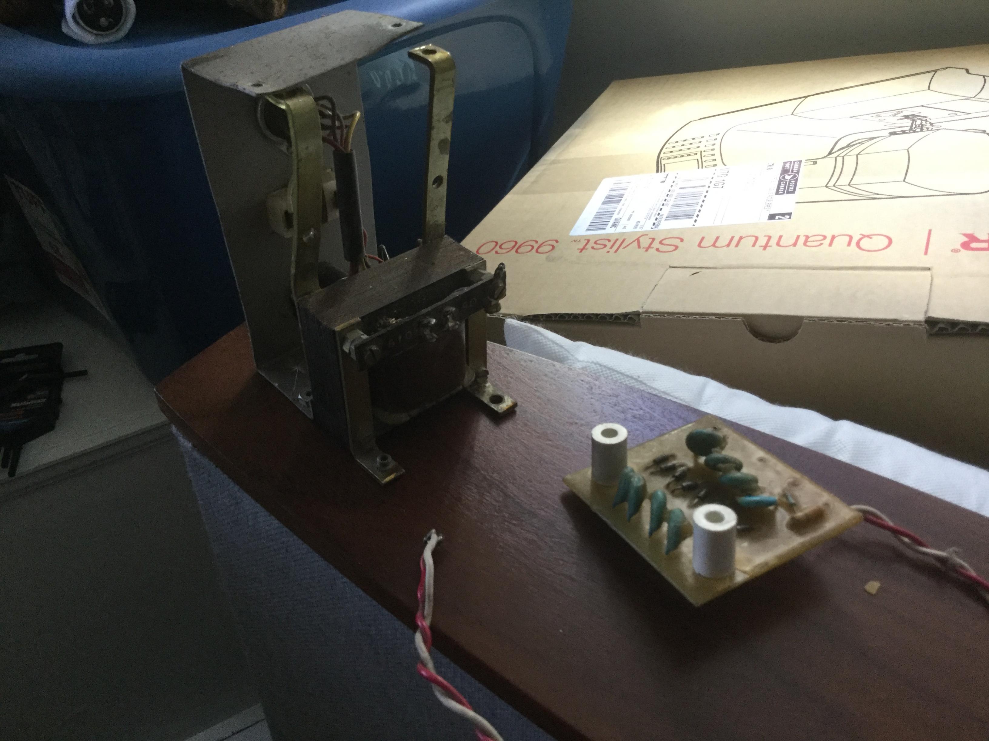

I’ll leave the input transformer for now then. The speakers came with 5 eht boards and two of them look fairly new. They have a number 2277-3 ESL on them that I think is an aftermarket board.
I ended up vacuuming with a short hair brush. The dust is definitely from outside. It went quite well, removed all the visible dust at least. We’ll see though, once I get the eht wired back up and the dust covers on I’ll put some juice to them. That will be the moment of truth.
Not that I'm authentic, but here's my two cents.
It's very hard to get crud out of a treble panel, the diaphragm to stator spacing is really small, and the distance from hole to hole is large compared to the spacing, so blowing them out or vacuuming them out is tough. I never even try, but I am not afraid of drilling out the rivets and rebuilding the panels. So I never spend a lot of time trying to de-crud them.
With respect to the crossover components, my twenty years of rebuilding these speakers I rarely find that the ceramic caps have failed. They are the most reliable thing in those speakers. However the original carbon comp resistors have typically drifted up significantly. I typically replace the resistors with high voltage vishay units, and the difference can be measured. You can get very good pair matching of a set of original quads if the panels aren't warped from heat or age, and the crossovers are updated. This matching leads to better imaging. For most customers, I rebuild the input transformers as follows:
Replace all resistors
Retain ceramic caps to keep speaker "voicing"
Replace banana connectors with modern gold plated banana connectors
Add zener bridge circuit to protect the treble panels.

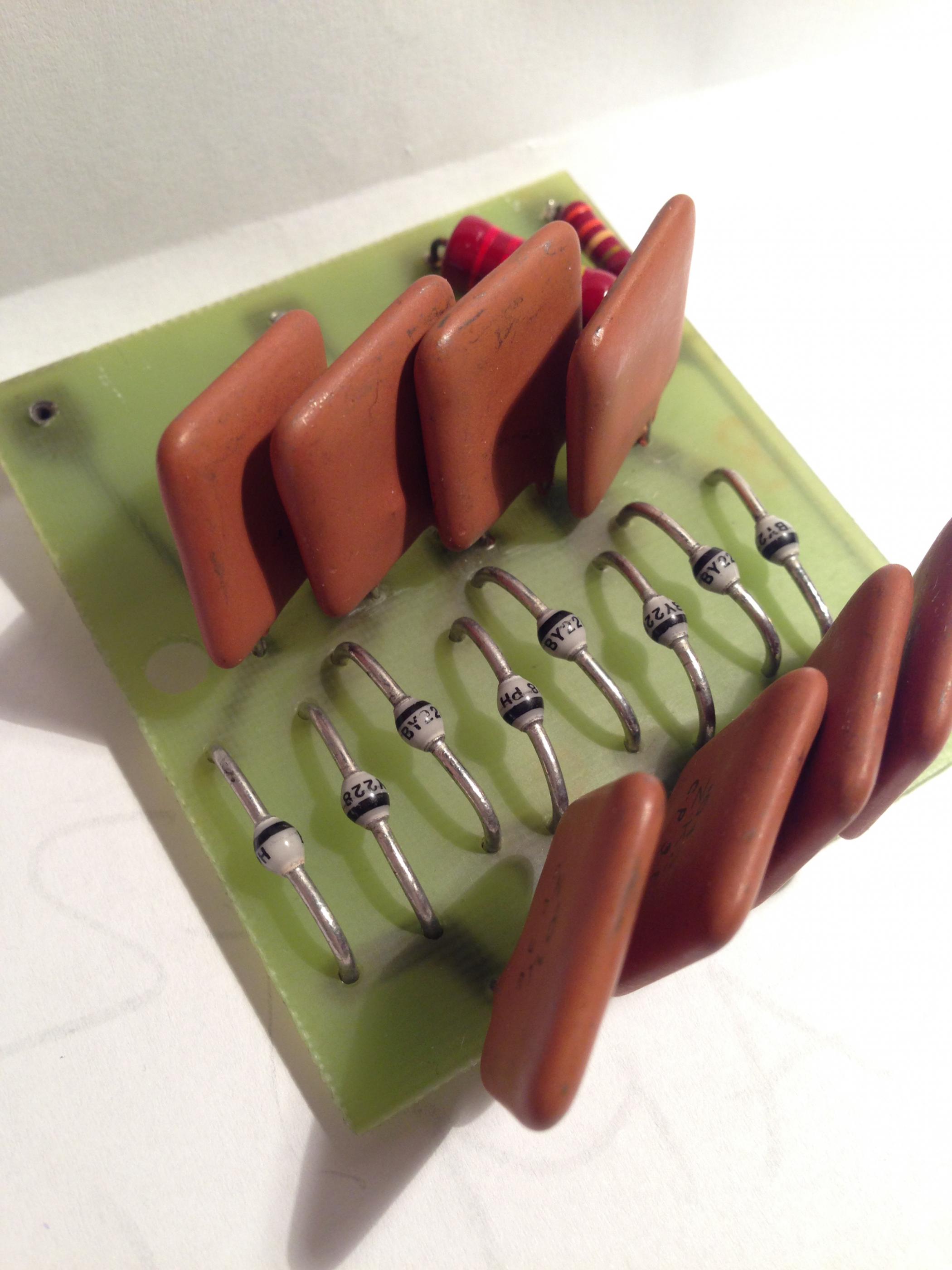

If your output is low, especially the bass, you most likely have rectifier module problems. Don't turn up the volume to compensate for the speaker inefficienty, you'll blow up your treble panels.
hope that helps,
Sheldon

I left them overnight initially and they still sounded quiet. New diodes and they’re instantly way louder. Now the problem is I’m getting quiet ticking and staticky sounds in one treble panel. I suspect it’s the dust I saw on the panels that I tried to vacuum out. It doesn’t seem to affect the sound which is beautiful.
Interestingly the quad ESL manual says they charge up about as fast as the Quad II amp warms up or a few minutes longer. But the conductive coating on these speakers wasn't very good and evaporates over time. I've seen quads that keep charging for more than a couple days. I take measurements every few hours and I can watch the SPL increase and increase and increase.
I generally advise people to leave them plugged in for a day, that's a good amount of time that if the speakers are in reasonable shape, they will sound great after that time. If after a day, they are still not up to charge, their time has come.
