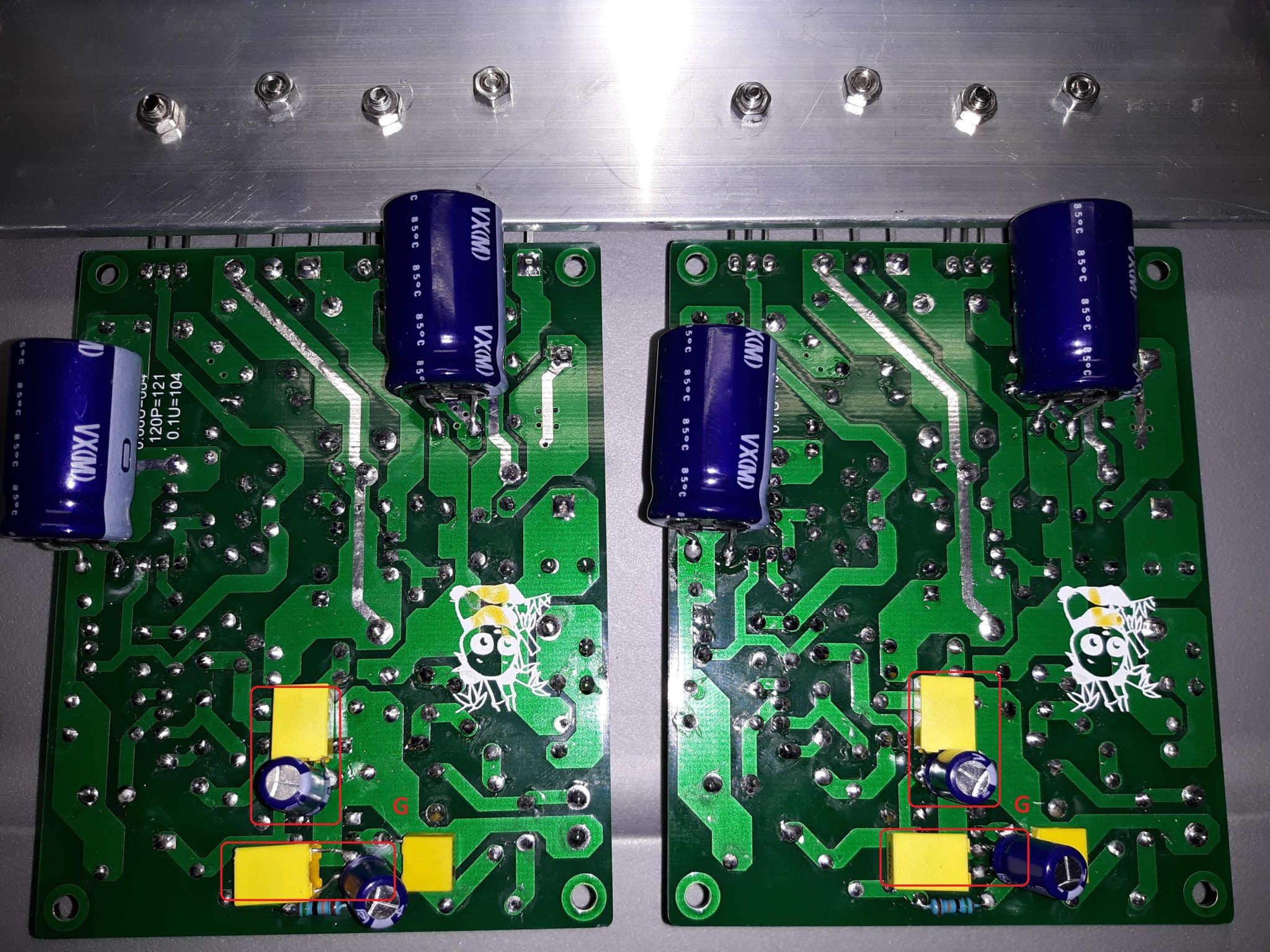

The added op-amp bypass caps are connected to the op-amp socket V+ and V- pins and then the larger copper pattern which is the input ground.
I think a picture is best to clearly explain. The red boxes enclose the added op-amp supply bypass capacitors. The red G is the larger copper pattern which is the input ground.
I used 47uF and 0.47uF because I had them. I don't necessarily know if 10uF or 22uF (etc) is really any better or worse. But 10uF to 47uF should be much better than nothing at all.
The other two components (the resistor and capacitor which are not boxed) are added for the gain modification.
In this picture you can also see the two large added main power supply bypass capacitors.

So there are several different things going on:
1. The simpler issue is replacing existing capacitors with better ones that are on-hand. If it is a 100nF or 0.1uF bypass on a supply then I would use a good quality 100nF or 0.1uF polypropylene as a replacement. WIMA is considered a very good choice. I often don't have any extras left around so sometimes I have used lesser but still polypro models.
2. The op-amp has zener supplies but no bypass capacitors. So I added 47uF Panasonic M and 0.47uF polypro capacitors as bypasses. Pana FM are even better and WIMA would be great too. If one has the money and this is a priority hobby then it is sometimes nice to pick the best components. 10uF and 0.1uF might be perfectly ok too.
3. The gain change where I modified the resistors and scaled the capacitor in the signal path. For this I would refer you to the sites dedicated to the 405 modifications for explanation and details.
I tend not to use ceramic capacitors due to piezo electric effects, voltage coefficients, etc. Polypro is much better and affordable.
Also my board arrived with the lesser quality yellow film caps but the better driver transistors. I suspect your orange film capacitors are better than the yellow caps. Perhaps different vintage boards or clones of clones?

Thanks! You are decoupling the opamp by soldering a cap, one on opamp V+ and another cap on V-, and the other end of the caps goes to the input ground.The added op-amp bypass caps are connected to the op-amp socket V+ and V- pins and then the larger copper pattern which is the input ground.
I noticed the third pin down, on the right hand side of the opamp, which is labelled as +IN, this also seems to go to the input ground ? So could I solder caps across the opamps, one cap to V+ , the other cap to V-, then the two remaining cap leads opamp +IN to get the decoupling

Just connect the capacitors to that island of copper I labeled as "G" (input ground) and then the +/- pins on the op-amp socket.
