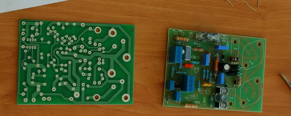

Hi Roger,
Unfortunately I haven't finished my Quad yet cause I didn't have enough free time. Hopefully tomorrow I will do a first burn-in test with one of the boards.
I ordered the boards from a Romanian pcb manufacturing company and they cost me ~32euros for 2 boards (plus the shipping another 13 😡 ...). Probably you can find a company closer to you.
You can see an image of the boards in the attachment.
Zsolt

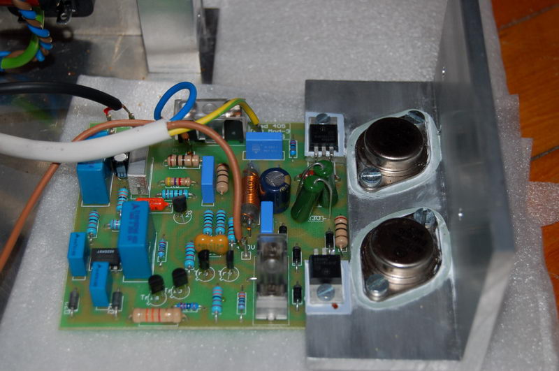

The alpha test of the finished Quads. I'm very satisfied with them. In the near future I have to put a push-button on the front of box as I cannot turn it on/off only from the power cord 🙄
