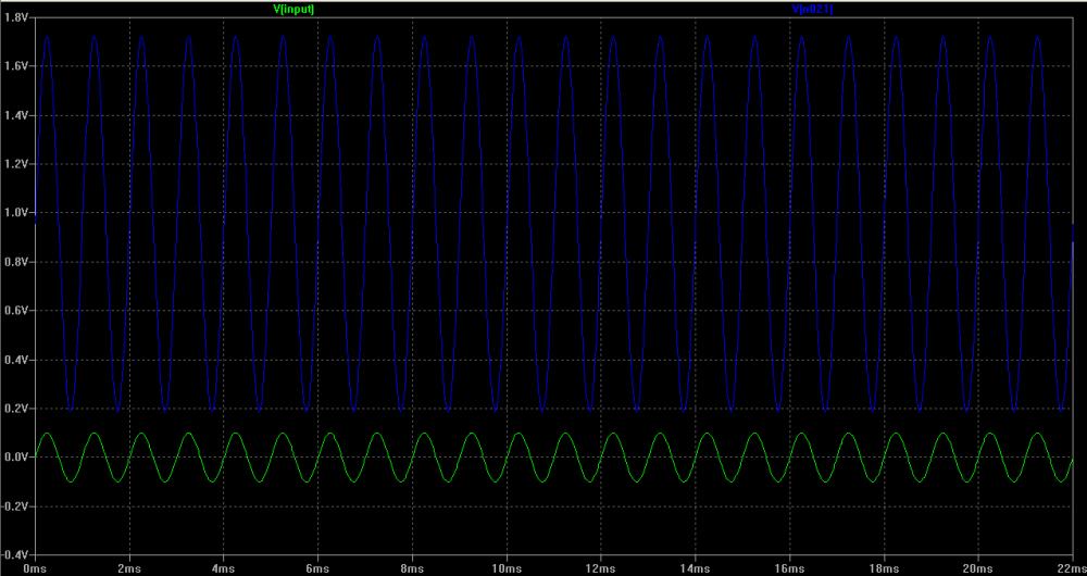

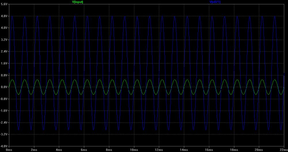

Hello Keith,
You are partially right. 🙂
The op-amp will be forced to work into class A only al low input signals and this is only valid for your input stage where the gain is lower (gain=7,6).
In original QUAD405 (gain=15) opamp will run most of the time in asimetric classB.
The asimetric output is due Vbe Tr2.
Attached you have two simulations with 0.1Vpp input and 0.5Vpp.
Tibi
Tibi

I guess in the world of voltage only analysis I am only about 9% right when considering Tr2 Vbe plus the voltage across R16 [ 180Ω ] compared to the required negative voltage swing at Tr2 base for full output
But what amounts to crossover distortion in say an op-amp output ? With no load on the output or the output current never changing direction is the crossover measurable ?
From the superficial viewpoint of simply accepting that the base of Tr2 cannot go negative or even close to negative the op-amp output would appear to be "class A" and this is where I started
Extend the analysis back into the op-amp output circuit and accept that it will have 2 output "devices" one TOP between +supply and out and one BOT between -supply and out

Keith,
You are right. My analysis was superficial and indeed opamp will run only in class A.
Tibi
Tibi

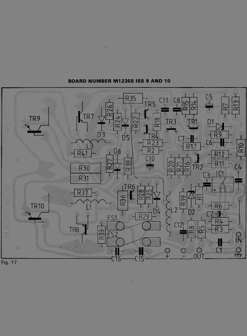

Dear Sirs
I am seeking the Quad 405 M12368 ISS10 PCB Drawing (Original).
Does any one have it?
I am ready to buy a copy .
Best Regards
Jose Paulo Beltrao Serra Pinto

eliminate L3 and L1
Hi,my question is about L1 and L3/6,8 uH/.Why do you eliminate this elements and use L4,R37 in Tr8 emiter circuit?
