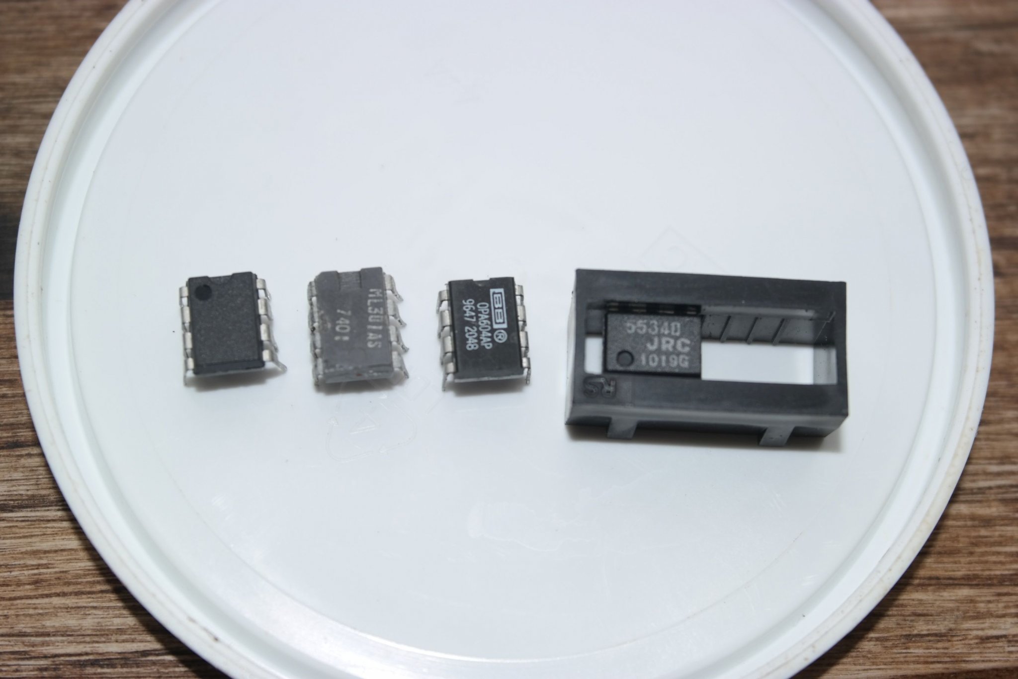

Yes! took a few tries and some serious rooting around in the parts box but the fourth one worked (JRC) so no smoking hot r30/31 and less than a milivolt at the speaker out. I have some TL071CP if I want to use those I take it some component changes are required?

The OPA604 could be an excellent choice I would have thought as long as you are sure they are genuine. No modifications should be needed apart from making sure you remove any cap fitted between pins 1 and 8. The LM301 needed that. Not sure the 5534 would need anything like that because it is being used at high gain here and in any case it would be pins 8 and 5 for the cap on the 5534. We'll say no cap.
If you are saying only the 5534 worked out of all those then you have to question whether the others are genuine/fake or look at the other possibility which is that ALL are good and the amp has a problem with stability and the 5534 is just one that happens to work. You would need to use a scope to check on that.

No scope I,m afraid but your point re Genuine/fake is something I will careful about when buying parts. Many thanks to you and all who contributed to resolving this problem.
