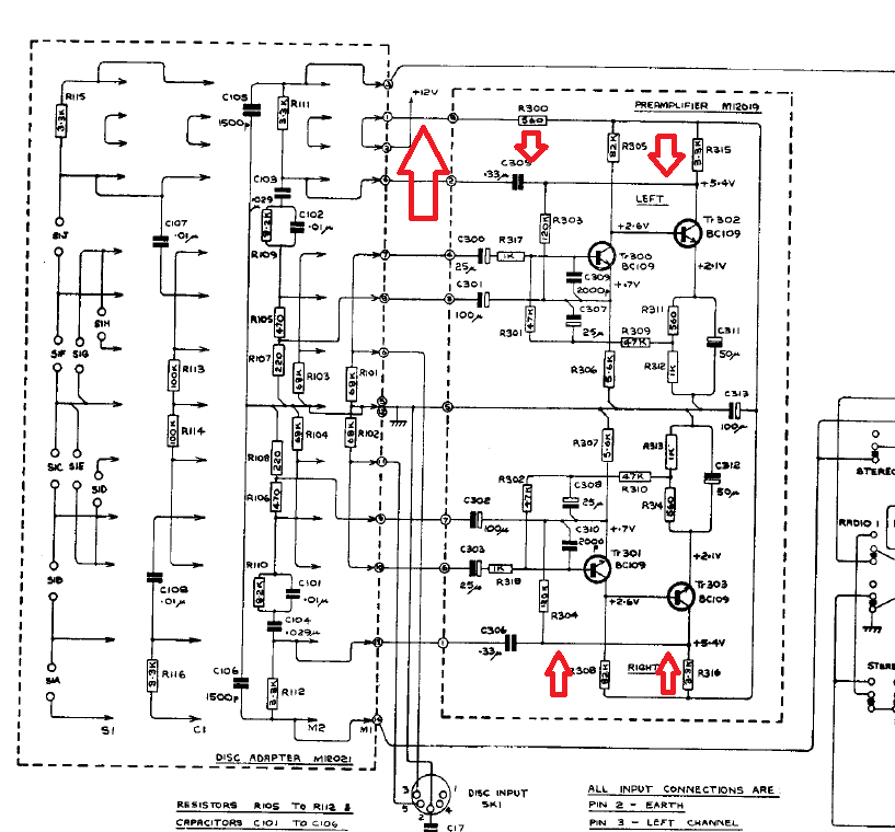

0V is OK for the top of C306, which is connected directly to pin 1, but the other one should be 5.4V, so something isn't drawing current. What do you measure at the top the central 100uF capacitor (C313)? Should be 10.4V. But as a matter of course I would change all 9 caps on this board, especially if they are still the original plastic ones. Also R300 and any other one that measures wrong.
Both should be similar. Maybe remeasure and make sure of a good connection. Sometimes lacquer or flux can insulate a component lead. 6.7 volts sounds a viable voltage given the 12 volt supply.
If by chance it is still at zero then that would be strange because if it were a one off definite fault then the other channel should still work. Two faults suggest something other than a natural failure somewhere.
Ideally you would use a scope now to trace the signal through the phono stage.
Not at the measurement points you suggested. The top of C306 is grounded via pin 1 and R112. The top of C305 isn't. The voltage marked on the schematic at that point is 5.4V, not 6.7V,, and the voltage on this board is not 12V but ~10.4V due to R300.Both should be similar.
Fair enough on R300 🙂 although the board is supplied by 12 volts according to the diagram.
6.7V doesn't sound to far off the voltage in the manual and its in the right ball park. The 12v is from a simple Zener shunt supply by the looks of its so could be a bit higher or lower than marked.
So we have to be sure on the two caps and be sure both channels are biased correctly. Just measure on the other end of the cap then to confirm the same voltage as the other cap. The service data manual I'm working from hasn't got PCB layouts in it unfortunately.

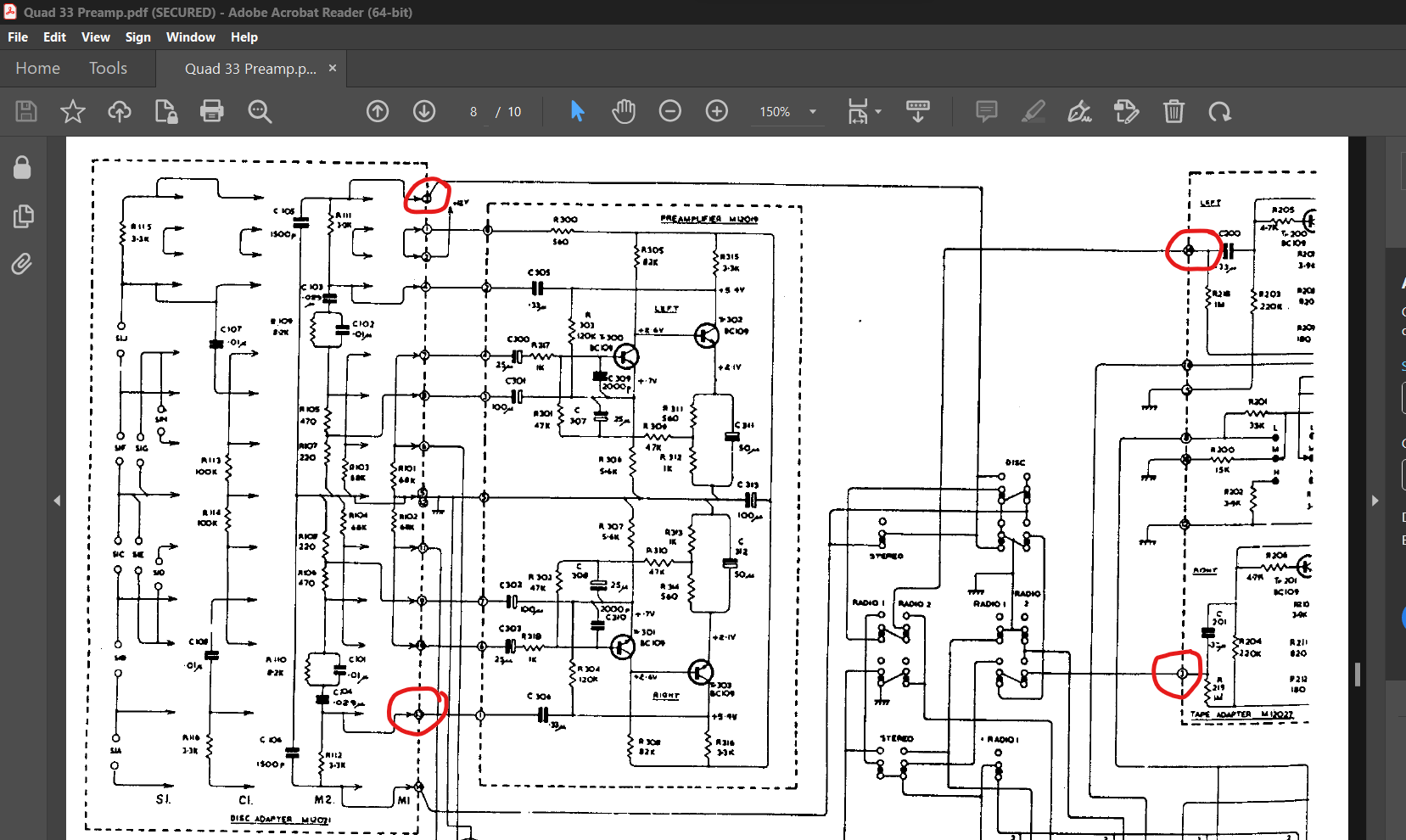

These things are never easy without having one in front of you. You could also look at some continuity checks. You know the line inputs work. The phono stage ultimately feeds into the what becomes the line stage.
The switches are not easy to draw a path through but I think you should expect to find continuity between these points when you select phono.
The two circled points at the right are the left and right inputs to the line stages.
The two circled points at the left appear to be the outputs of the phono stage.
Either of the the points at the left should have continuity to one of the points at the right when you select phono.

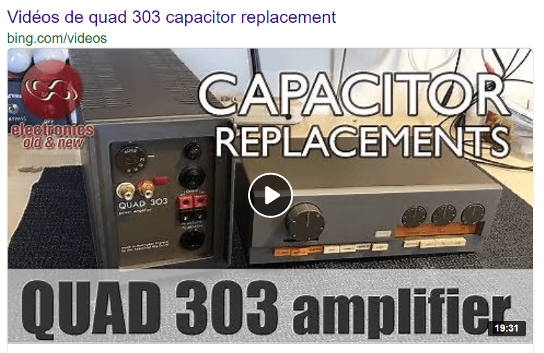

OK. Since this thread is about VINTAGE audio, let's write VINTAGE problems. Capacitors issue is a vintage problem in old audio. In 1989 on a summer job at Radio-Canada in an audio repair department, QUAD 303 amplifier was used from wall to wall. In the VINTAGE time, many constructors were using single supply on their audio. Meaning for the QUAD 303 here that speaker had to be coupled threw a 6800uF capacitor which with time will lead to a limited frequency response cutting from bass to mid and eventually ending open circuit with no sound. I repaired approx. 22 amplifier that summer!

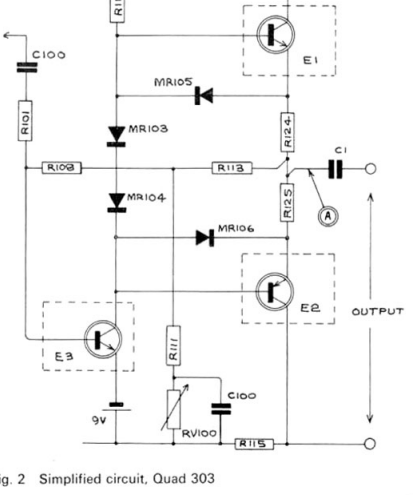

I joined pictures of the 303 and look at C1. Because my repaired has been done like 34 years ago I forgot model... now yes this thread in on QUAD 33 and the 33 uF that I talk about is at the input of the QUAD 33. Also the 2.2 uF are at the output of the QUAD 33, Now let's say that generally any preamp or amp that has a single polarity power supply MUST be coupled via capacitors because the inside circuit in mainly held at half the power supply, in order to give maximum amplitude at output and the QUAD 33 is no exception. The swing will be given from 0V to +12V here inside the QUAD 33 but at the output connector it will be seen like +/- 6V. Now try to open schematic of the QUAD 33 and take a good look. And yes QUAD 33 only! In the 1970-80 design with single polarity power supply was very popular in audio!
