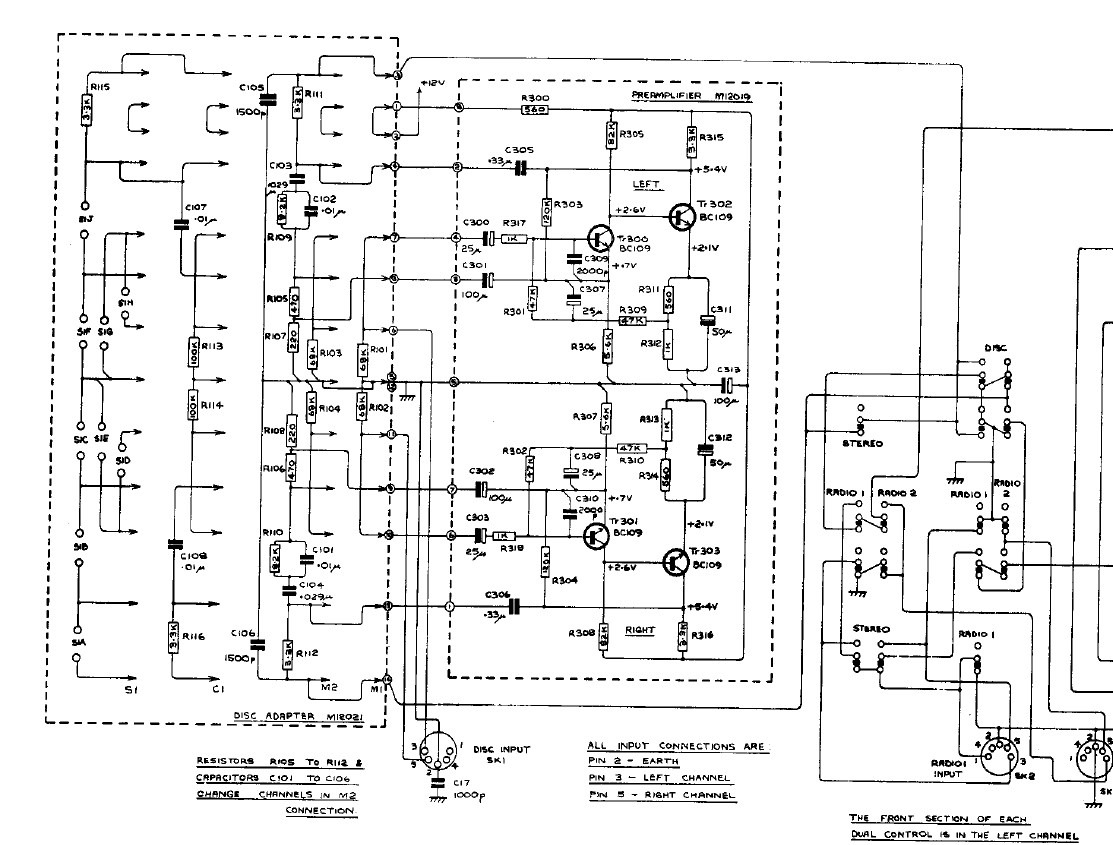

Tr201 is not a Class A amplifier but an emitter follower, and you've left out Tr400 and Tr401 completely, the latter providing all the gain. Let's be accurate please.The QUAD 33 has a single transistor TR201 hook as a Class A amplifier and buffering is achieved by TR402 as a emitter follower to boost current output.
The Precision Preamp '96 has variable frequency first-order tone controls. Not variable slope. There is no similarlty.When I look at QUAD 33 I see similarities with a newer design (1996) made by m.Douglas Self. I joined a PDF and you'll see that both have variable SLOPE in filter except that the precision preamp of m.Self has that slope control on both bass and treble.
Thanks ejp for your comments... it forces me to revisit QUAD 33 web sites and understand goals behind design. I give reference address of web sites visited. Schematic of QUAD 33 was taken from web site and in fact TR200-201 doesn't exist in the one I re-looked up. I join PDF redrawing of chematic and web address for reference of viewing! PDF is now showing TR400 as input buffer input and TR402 as output buffer with their collector tied to +12V, leaving TR401 as Class A amplifier. No comments about DISC input. Just change electrolitic caps.

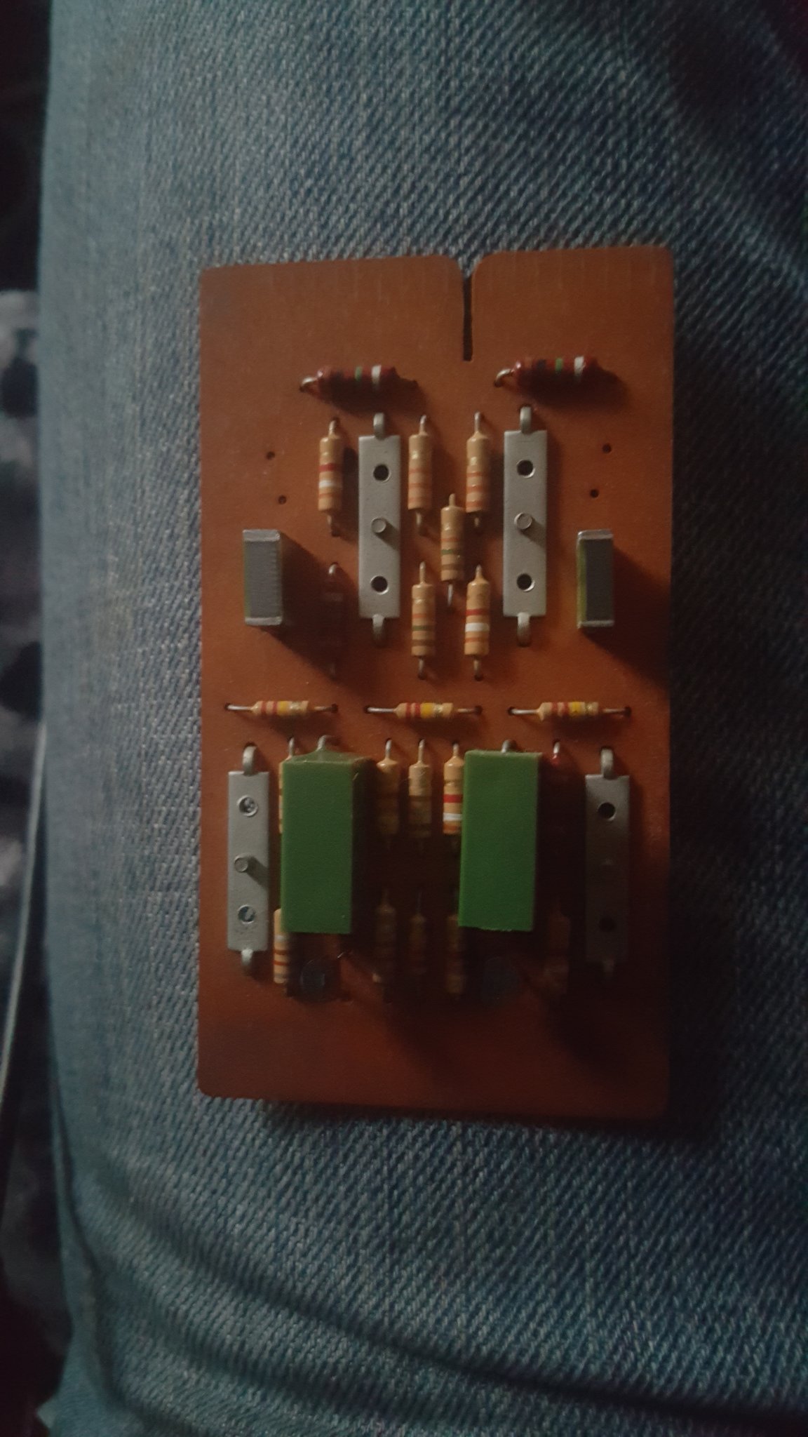

so to thank everyone and report results - i tried my friend phono board -
sounds perfect - so caps definately need replacement - got an NOS board of
ebay £80 - cheers all

The schematic you posted is only a schematic of the amplifier board. There are four other boards and a motherboard in the Quad 33, and full schematics of the whole thing are available all over the place. Tr200-201 are on the Phono Amplifier board.Schematic of QUAD 33 was taken from web site and in fact TR200-201 doesn't exist in the one I re-looked up.
