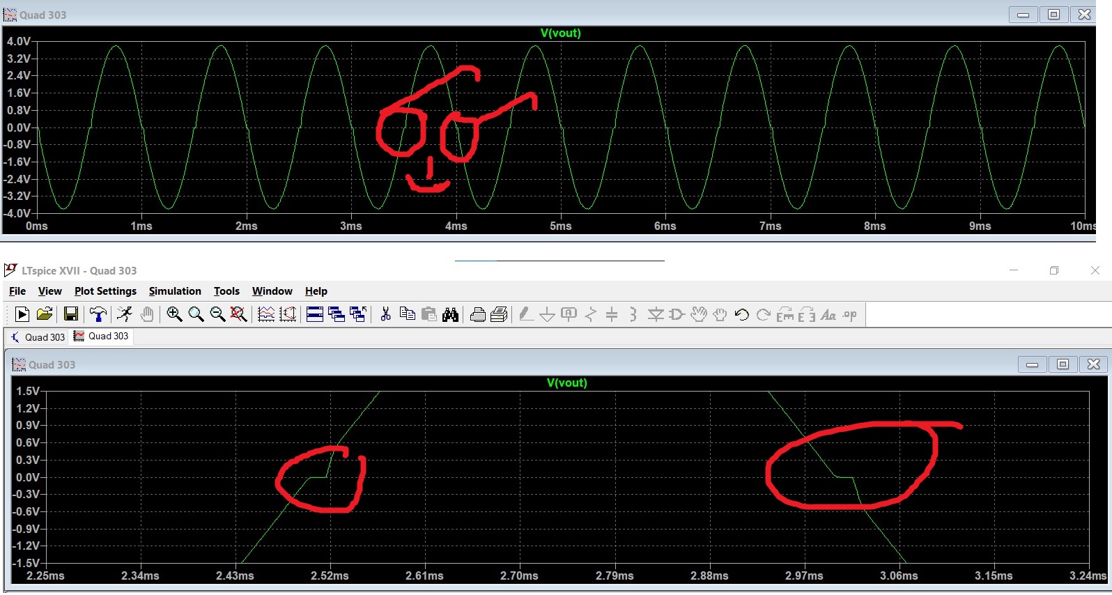

The board with no bias current will sound distorted. It takes less distortion than you can easily see on a scope for a sine to sound distorted. If you look at the zero crossings closely you might see the distortion.
The board with 185ma current needs careful measurement around the output stage to see if there is a fault or if it is just a problem with differing device characteristics.

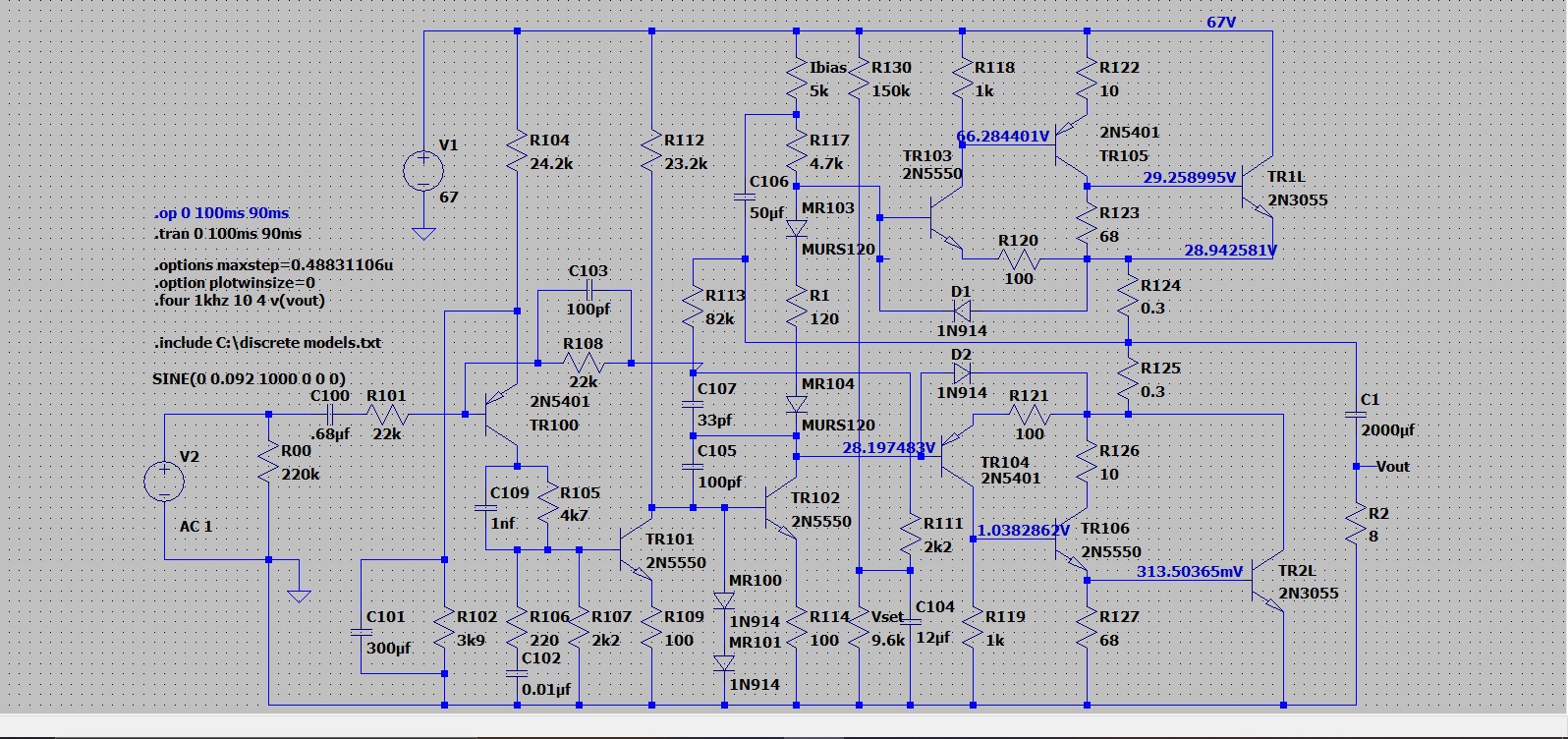

Be logical with your measurements.
With the bias preset turned up there has to initially be enough voltage between the bases of TR103 and TR104.
If that condition is met then current flows in TR103 and TR104 and that in turn develops a volt drop across R118 and R119.
The voltage across these resistors has to also reach at least around 0.7 volts and then when that happens TR105 and TR106 in turn also conduct and in turn they develop around 0.7 volts across R123 and R127 and so bring the output transistors in to conduction.
Of the 10 milliamps bias current around half of that is flowing the final output transistors and the rest in the drivers TR105 and TR106.
Look at the voltages here. These are not absolutes in themselves but what is an absolute is the differences between various points such as the all important B-E volt drops and the voltages across the resistors in the output stage.

I followed your circuit diagram and did an A-B comparison on various voltage points, although voltages differed slightly from the drawing, they were pretty much spot on with each other.
