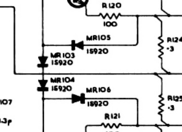

Hi all.
Hope somebody can help.
I have a Quad 303 which was faulty but i've fixed the fault ( open cct resistor on one of the driver boards ) and I intend to make 2 new amplifier boards and PSU board from scratch with HQ components throughout. Im puzzled by the schematic for the 303 and the actual board ? - The schematic shows 4 diodes around transistors tr103 and 104, but the actual amplifier has only 2 diodes ? I havent as yet verified why there are only 2 diodes fitted , but I will trace the tracks - any ideas what s going on with just the 2 diodes. Thanks . attached is a portion of the schematic im talking about

Hi all,
The serial # of the driver boards is 67986
it looks like its the version with the transistor , 2 diodes, and a preset for the bias. The boards serial # is M12038 rev 10
Ultimately, the problem i foresee is that after Ive re manufactured the driver amps, i wont be able to set the bias correctly ( i got rid of my dual beam oscilloscope ages ago ) ? - there is literature regarding the bias adjustment with simply a multimeter , Ill read up on that one.
