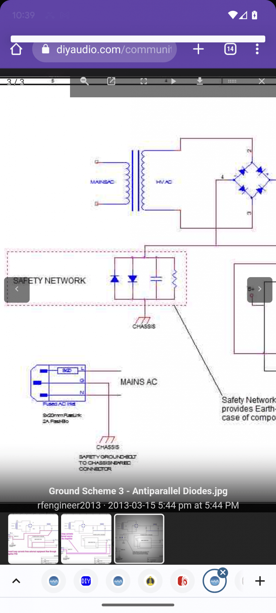

When you call it an 'earth lift' it seems like you are mixing up earthing and grounding. There are devices to break an earth loop, and a ground lift for elevating ground above earth potential.

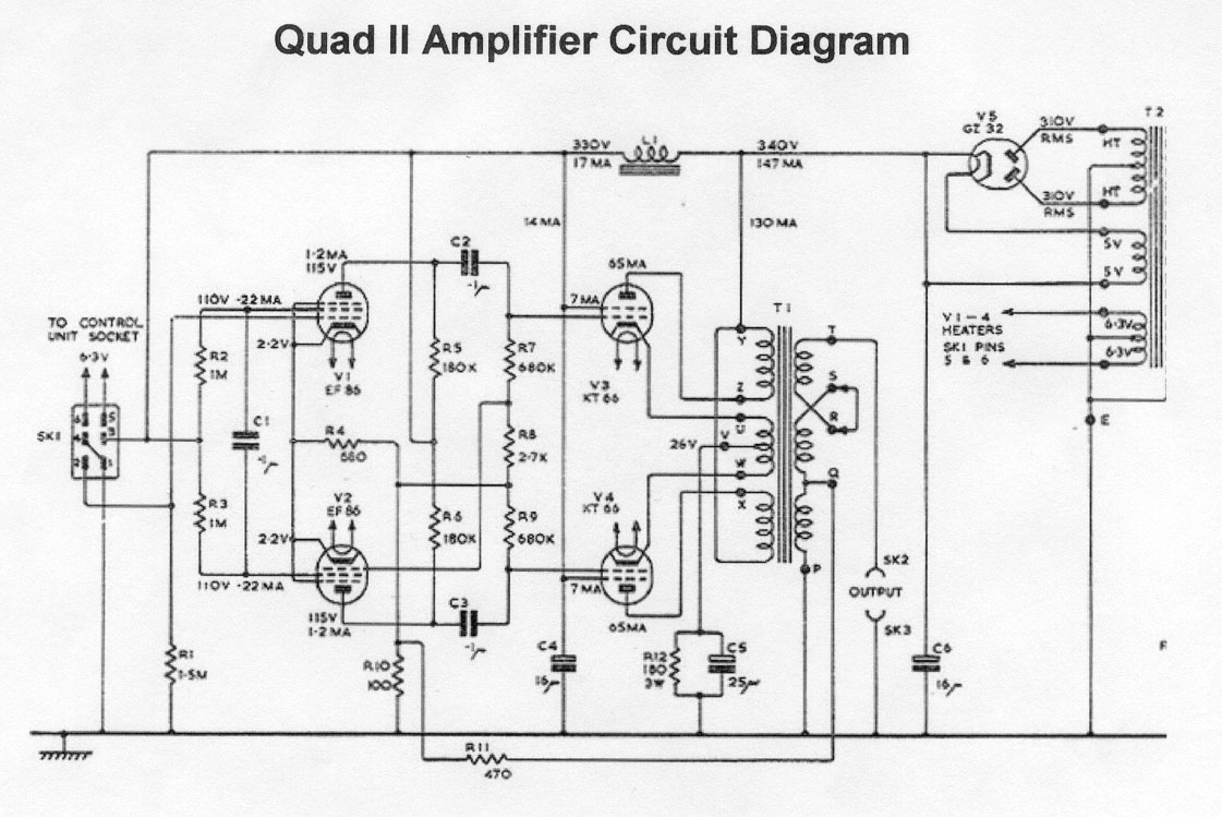

I read the thread again from the start. From what has been posted, your plate voltage is only a little high, the grid voltage is 345 mV without the outputs. You have +40 VDC on pin 5 (grids) with the output tubes installed. Is this correct?
Therefore, this must be a fault with oscillation since your DC connections with the feedback broken (outputs removed). Strong oscillation to put it mildly. So test #1, disconnect R11 (470R) to break feedback. That was suggested earlier. If you still see a strong positive voltage on the grid, you must have a defective output tube.
I also noticed that you were told these amplifiers were working properly before you rebuilt them. Did you actually test them in their "as received" condition?

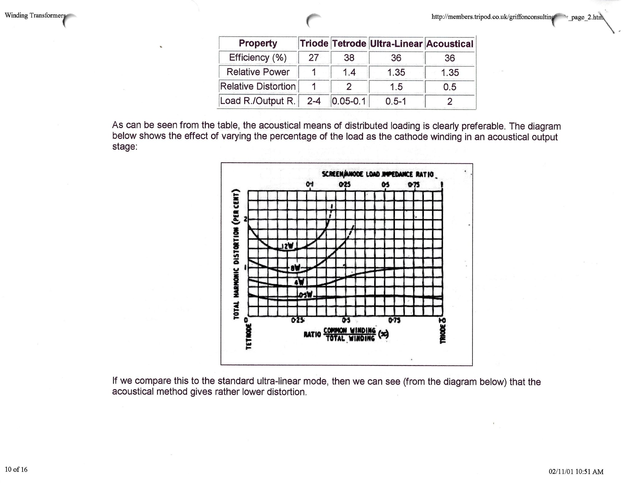

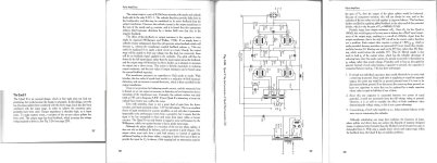

Coming in late on this thread but here are some items for the curious, lurkers & others.
A very thorough item by Patrick Turner. And comments by Morgan Jones.
The cathode resister I found was in a limited space, not able to dissipate heat.
Should be rated at least 5W.. Heat sinking resister to the chassis if possible would be a useful fix.

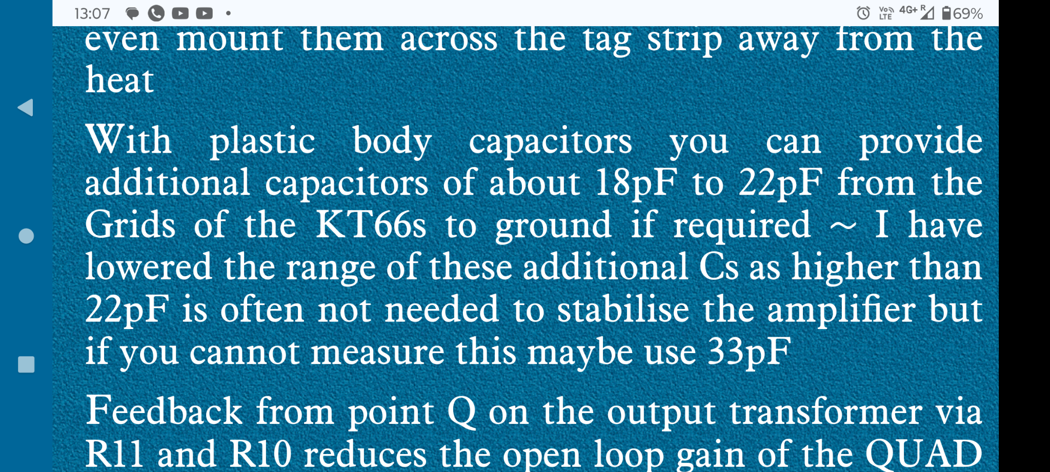

The 22pf cap mod could be this.
The complete discussion is here.

About "ground lift" I have no idea but I do know that an alternative "safety earth" connection is required if the original Quad 22 pre is not used to drive the amps. This is necessary as it is the pre that provides the " safety earth" . As I do not use the pre , I use a three core wire with a three pin plug on the wall socket side , a two pin female to on the amp side and then tie the earth wire to the nearest chassis screw.
Thanks for all the replies. Now back from Easter and back to the amp. I removed the earth lift circuit and ran it up on the Variac. Same result.
Swapped out the valves for some known good but old ones and all works perfectly. Restored the earth lift circuit and all works perfectly. I'm only surprised that both amps acted identically! But glad it had a simple solution!
