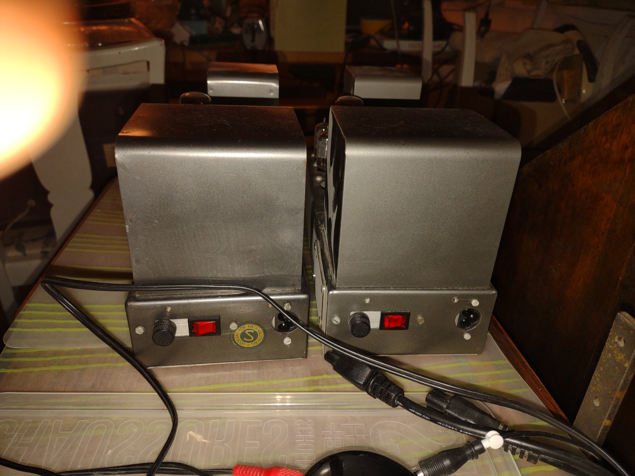

I have restored a couple of these, and found that it was possible to have a neat solution with the power entry at the end by the power transformer, which saves the wires going the length of the amp. Also I discovered a laptop style IEC socket could be attached behind the large fuse holder, so I use a laptop lead with mine. The mains selector is no use with the voltages of today, so I removed that and put a new 35mm fuse holder in there, along with an illuminated toggle switch.
I fitted a ground lift too, but it was just a 5W 10R resistor. What are the two polystyrene capacitors in there for?

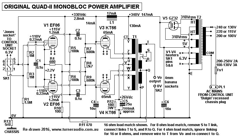

I've got many different GE KT66s. I'm not sure what you mean about writing down numbers. I know what the spec readings should be and the issue is these monos aren't stable enough to get any sensible readings when under powerWhich KT66 are you using?
I've quite a few Sovtek 6L6WXT that are way out of specs, requiring over -17V in stead of the nominal -14V for a nominal Ia of 72mA.
Generally speaking, it's good to write down the numbers while you're tracing the circuit. The original Quad II schematic gives all the V's and mA's for debugging.
Not silver micas. they are 22pf polystyrene which are recommended for possible stability issuesSorry have to go don't know what the smaller silver micas are for.

Actually was baudouin0 onto something about the caps My eyes are not great but, I think I am seeing 1uF which does seem high for a valve amp. I havent got the quad schematic handy at the moment to check.

0.1uf but it is difficult to make outActually was baudouin0 onto something about the caps My eyes are not great but, I think I am seeing 1uF which does seem high for a valve amp. I havent got the quad schematic handy at the moment to check.
please With the amplifier off and the power capacitors discharged, measure the resistance of pin 5 of the kt 66 socket to the e ground.
Where does your mains supply come from? I see two brown wires is this from an autotransformer?
Also you have metal can coupling caps, are the 22pf caps redundant because the metal caps will have something similar 15-22pf to ground leakage?
The amps allegedly worked, did you check this before the rebuild.
The valves you have are 6L6G Russian equivalents, are they 100% pin compatible? has the amp been previously modded to run with different valves. I.e. was the wiring that you have replaced 100% correct?
