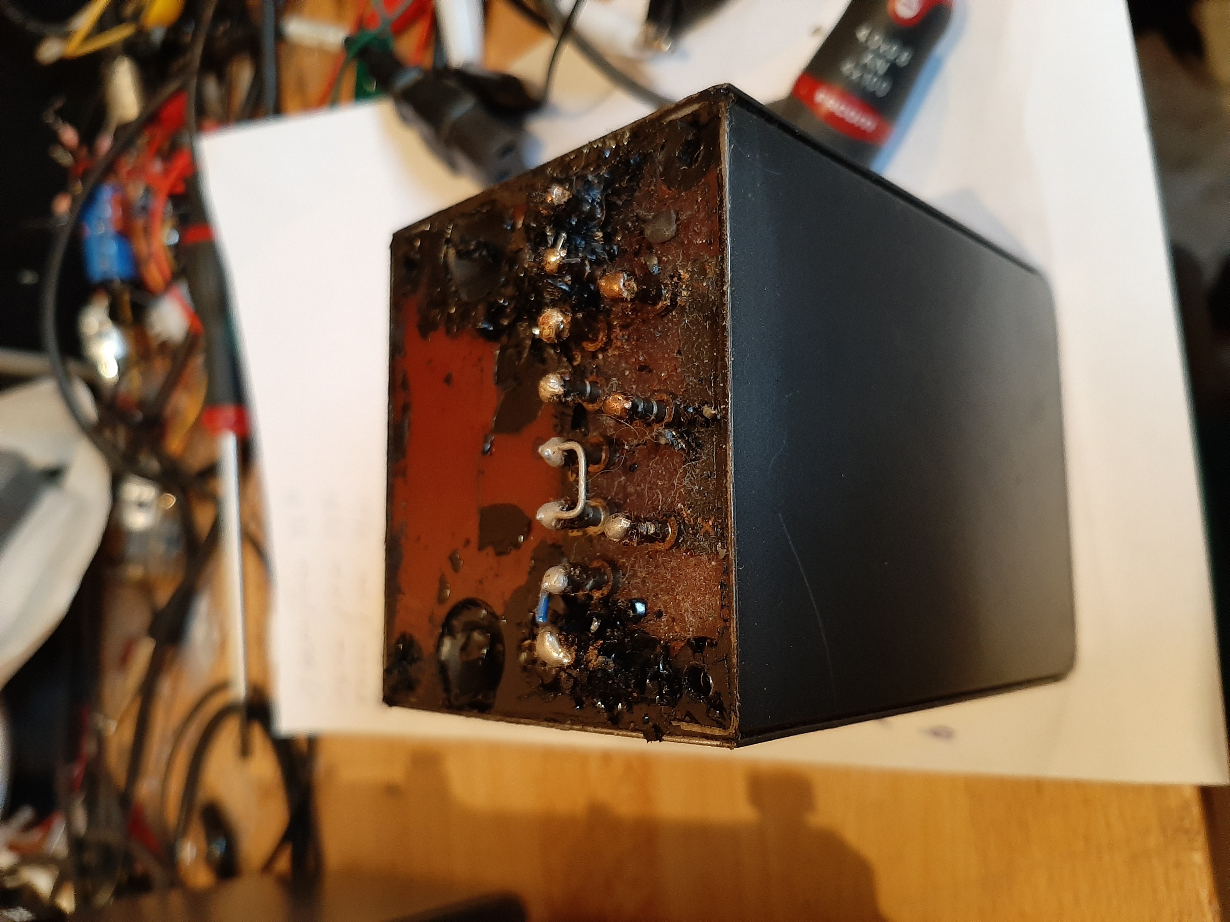

So I have a repair/refurbish of some original Quad II amplifiers.
One of them is in decent condition the other one is under transformer goo.....
A picture of the OPT
Power transformer is about the same. The inductor is better.
Measurement of DC resistance looks like they could still be good.
So I was thinking of getting alle the goo out (how would I do that? probably heating them...).

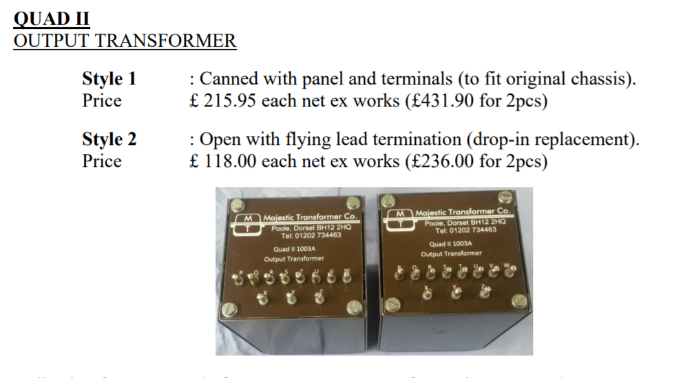

Or when I was reading it appears there is a company called majestic transformer who make complete replacements.
According to keith snook his website they should be better then the originals.
I also tought about using a lundahl that has CFB windings but then I also need to pot them etc.....
Anyone has experience with these replacements from majestic transformers?

I have a couple of QIIs that I've been taking my time refurbishing. Here's what I've learned:
GZ34 will run the B+ at a slightly higher level, meaning the KT66s will run hotter. The Quad IIs 'cheat' a bit on the spec sheets for the KT66s, which says that 1) the valves should be mounted at least 3.5" centre-to-centre apart, and 2) separate cathode bias resistors should be used. It should be OK, but this means you should definitely up the wattage rating on the cathode resistor, and make sure that the top of the amps are properly ventilated. A common mod that is made for reliability reasons is to install dedicated 220Ω resistors with parallel capacitors, replacing the common cathode resistor. The output valves are mounted in a recessed pocket, which should mean that they can draw air up through the chassis -- except that Quad didn't make any holes in the bottom to draw air in!
A common cause of 'goo' leakage in the transformers is that they get hot due to excessively leaky coupling capacitors, causing the output valves to draw more current through the OTs. AFAIK the potting material is tar, so you should be able to (carefully) use tar remover to clean them up. If they're not shorted you should definitely keep them around. People have also been able to get them rewound, which might be slightly cheaper than an outright new OT purchase. I haven't heard of anyone getting off-the-shelf transformers from another manufacturer -- not saying you can't, but it doesn't seem to be very common practice.

I asked the company what would be the price for new OPT's

I have old quad 11 that leaked goo due to being used in hot climates. The trafos were 'tropicalised' and it worked, but they have leaked just though general usage. Mine are 100% fine, no dodgy capacitors - all original still - just heat. If they measure OK then don't feel you can easily improve on them, at least within the original can's dimensions.

Let us know what new OPTs cost when you get the quote please.
I had a quote from Majestic just before Xmas ...
I have one Quad II with an old style OPT (marked ABCDEFGHIJ) so I was considering new OPTs in order to have them matched. There are actually quite a few Quad IIs over here that were used by the Swedish Telephone company, that have line level OPTs. The ones I bought came from Sverige Radio, and they had been modded to have solid state rectification, and some other changes for working in racks.

Yes, if the potting is not too tricky, then for what is meant to be an improvement on the original, I think that is a very fair price.
It would be nice to take the potted ones, but I have noticed the Quads come in quite a few hues of grey anyway, so I'll try and repurpose my old ones.

I have gotten the prices from majestic transformers they are as follows:
Mains: 223.30£/piece
Output: 215.95£/piece
Choke: 117.65£/piece
