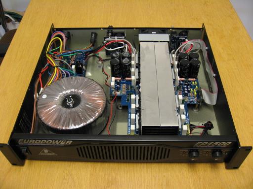

I do own a Behringer EP-1500 and everything corresponds in a perfect way to schematic of QSC RMX-1450 both of them running class AB. QSC RMX-2450 and Behringer EP-2500 also alike (class H). They commonly share "flying rail" topology.
I am interested to compare size of transformer in EP-1500 and RMX-1450. Does anybody here have a RMX-1450 and willing to take some photos or measure transformer dimensions?

Anyway here is one lowres pic of Behringer EP 1500 that should at least show dimensions of transformer and general layout.
If we are going to exchange big high res pics we have to mail.
