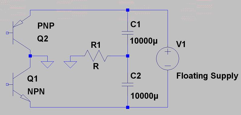

shown below is a simplified output section
actually it's still an emitter follower, since it's the emitters are the driven element........ i figured that out after a while of standing on my head.......

yes output Q current loops complete through the xfmr/rect - as always
your Qs are upside down

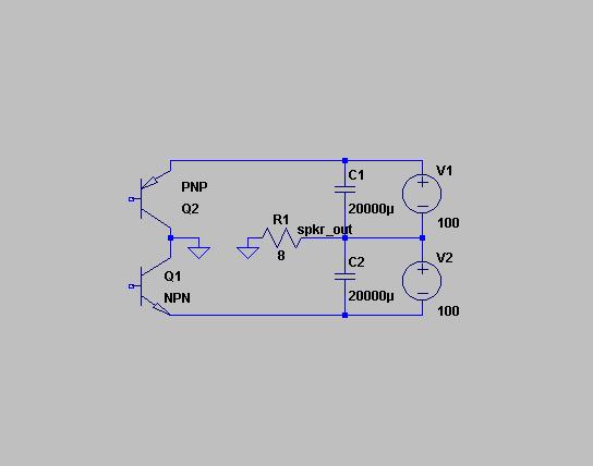

try this:
you can plot the V1 and V2 floating Vsource currents to see the usual Class AB current in each
the feedback is unitygain and the E1 source also has gain 1; the output Qs provide the large loop gain (~ 20) in CE mode that holds the distortion to -50 dB in this sim

Simplified drawing of AC coupling as QSC uses on their smaller amps, no (~) need for DC protection:
Absolutely right.q's aren't upside down..... c's are grounded, emitters "drive" the rails......

your referenced qsc schematic follows my simplified circuit sketch
the output of the qsc amp is a pair of Sziklai/cpf compound transistors connected as per my schematic, replacing my Q1,4 with the composite (Q933 + Q903-910 = my Q1, Q934 + Q911-916 = my Q4)
http://www.dself.dsl.pipex.com/ampins/discrete/cfp.htm
for the advantages Cherry described my schematic shows the simplified output Q equivalent and is the "correct" connection for illustrating the operating principle
Your interests may differ, but there is little to be gained (pun) by driving the ps with ef - you still have to come up with the full output V swing in preceeding circuitry and the bias must be established with the full floating supply in the middle
