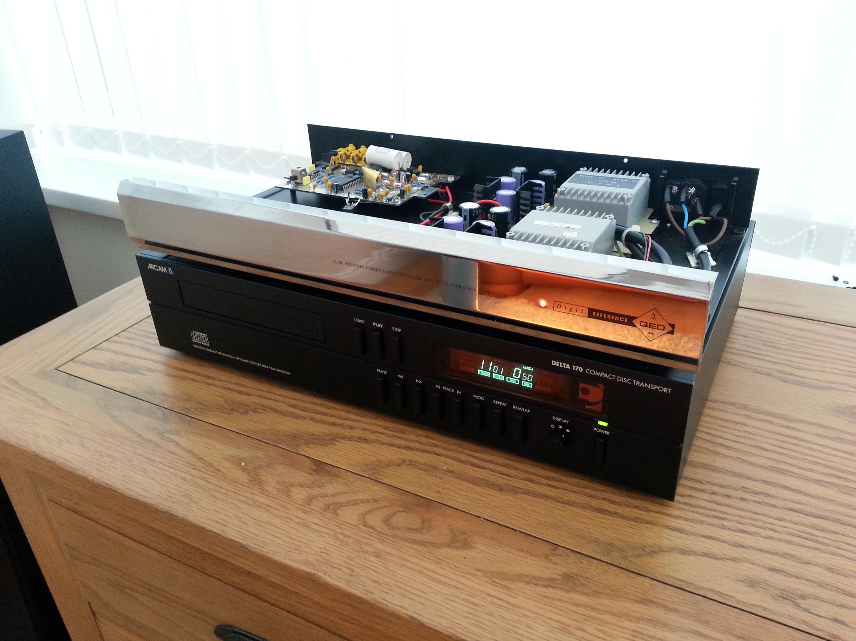

Well, found 5 mins to swap the op amp for an LME49720 today (my first op amp swap!)
Very pleased.. this thing really sings now! I think a lot of the performance of my beresford is due to these I'd say..

Hi I've swapped the 627s into the Digit and changed the smoothing caps to Panasonic FC.
Quite a diffrerence and it's looking good to carry on modding.

Hi Taff, kept the same size caps but used Panasonic FC.
Not tested the caps mod yet but there should be a little difference as Panasonic FC's are good for smoothing in my experience although Oscons are good for digital supplies so I may change one.
I've found that a standard design of power supply, transformer, rectifier, caps, is probably best to power the Digit. I'm making two supplies and using this thread for the regulator and cap mods.🙂
